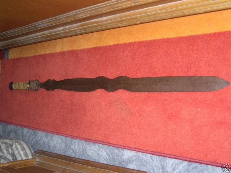

It appears to me at first glance, to be a Chinese spear head mounted for use in the hand, I have 2 Yanyuedao blades that have been used as swords.

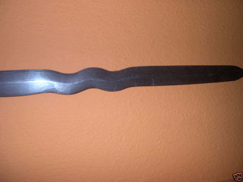

The blade does look well made....the curves are nice and symmetrical...clean, neat mid rib ....probably a flattened diamond cross section. If forged, it seems to have quality....if made by stock removal..much, much less so.
Its the 'strange' forte area.....either deliberately or unfortunately the pictures do not show where the blade and forte meet, forge welded ? arc welded ? The blade seems to be a different to this 'section' both in the structure of the steel and the workmanship.
If a 'composite' made for profit ...why not just attach the Nagan styled blade to a Tulwar or Khanda hilt ? They always seem to sell well on eBay

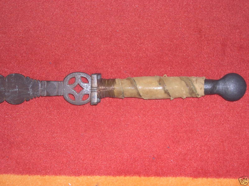

I believe the hilt/forte section of the sword is West African, I too have seen the cross symbol before....and like you and Tim cannot 'place' it. The 'guard' looks like some of the Akan goldweight designs ....and I wouldn't be surprised if the 'cross' symbol is Akan (or neighbouring regions). Although not in this 'sample' of symbols, here are a few which are quite stylised ...and some similar....

Its the main section of the blade that seems to be the .....yes perfect for the symbolism of the snake....but seems unlikely to be locally made. Could such blades been supplied as imported 'trade blades' ? ....I think unlikely. Perhaps the blade was traded with the East Coast (via India, trade between India and the West coast has been well established for hundreds of years)... and carried overland to the West via the numerous trade routes.

Been looking at this. 130cm by 6cm @ 12lbs. So it's a little over 3 feet and about 2.5 insches wide. Do not know how thick it is but where is the 12 pounds coming from? What is it made out of lead? The given dimensions put it at about the size of a kaskara.
Old 29th January 2010, 09:51 PM   #12
CourseEight
CourseEight's Avatar
Join Date: Feb 2007
Location: Coral Springs, FL
Posts: 222
130 cm is 51.2 inches, or about 4 and a quarter ft.

working from the dimensions given....and scaling the hilt so as to be able to get the dimensions of the grip and pommel...I have roughly deduced this ...
The hilt is approx 30cms long, therefore the blade is 100cms (1m). Density of steel is 7.8grams per cubic centimetre.
Blade 100cms x 6cms x 0.6cms ( 1/4") should be approx 6.2 lbs. (as the edges taper it would be less than this, so probably nearer 4 lbs would be more accurate)
If the blade was slightly thicker (at the mid rib )
100 X 6 x 0.8 (1/3 ") the weight should be approx 8.2 lbs again due to blade taper to the edge would mean 5 lbs or slightly less would be more accurate.
The hilt is approx 30 cms long, handle section 24 cms the pommel 6cms diameter. The volume of the hilt is approx. 328 cms cubed.
If solid steel it should weigh 5.5lbs (which would include the tang as it would be the 'same' material)
If solid lead it should weigh 8.2 lbs (because it would not be 'solid' lead because some of the volume would be taken by the tang which would be the lighter density steel/iron......lead is 11.4 grams per cm cubed....so would be less than 8.2 lbs dependant on the size of the tang)
So....if the blade is around 1/4" thick at the midrib.... the hilt would have to weigh around 8 lbs
if the blade is 8mm thick at the mid rib, the hilt should weigh around 7lbs
So if a betting man.....its a sure fire bet that the hilt is completely or substantially composed of lead.
Have Chinese swords ever used lead for hilts, if not, Africa (possibly) could be the source... as I have seen a 'status' sword with a lead hilt.

Although the geometric device that comprises the neck type section between blade and hilt may be stylistically similar to such symbols in many places, it would be hard to say that these influences did not enter the presumed African tribal sphere via many avenues of trade contact. These kinds of symbolic elements are well known in art and material culture in Saharan regions to the east (see "Africa Adorned", Angela Fisher, a great work on jewelry and its symbolism in Africa). The cross of varying types is well known, and rather than religiously observed, often refers to the four cardinal directions, north, south, east and west.
This symbolic device placed at the root of the blade, as David has noted, resembles geometric symbols seen in these regions, and as the bearing sword in ceremony would be held upright with blade up, suggesting the arising or power of the blade out of the symbol, in metaphoric sense.
It should be noted that many of the falchion type swords out of the Congo/Zaire regions use this effect on thier blades with an open, bisected disc shape between the blade and hilt.
At the point in the blade above the 'nagan curve' there are what appear to be serrations on both sides of the blade, as seen on the Dahomean ceremonial swords known as 'hwi' (see "African Arms & Armour" C. Spring, and the reference to Palau Marti).

Hmmm, I still say Chinese, the serpentine blade, the coin motif, the structure, the size, the cross guard has the same patern found on rectangular Tibatan sword guards....the hide and copper wire have no patina so maybe it was someones interperatation of something from Africa? Although I am sure there are super quality and well finished African swords etc out there, weren't most trade blades and native crafted pieces? This seems to be lacking either of these African facets.
David you calculations put it in better perspective to me as being a ceremonial spear head from China.

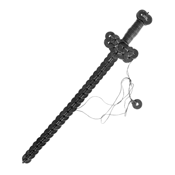

all the Chinese coins I can find pictures of have a singular hole...usually square. Also pictured below is a coin sword 18thC-19thC British museum.....again notice the singular hole
"....Coin-swords were a form of talisman used in southern China to ward off evil influences, especially those causing fever. They were made by tying together 'cash' (the pidgin term for Chinese coins with a square hole in the middle) on to an iron rod......"

Some images as promised. The red background of from an ebay item sold a little while ago, the Hudiedao varient is from my personal gallery collection and the other was offered to me some time back.

thanks for the conclusive proof, I knew I had seen this design (coin) before and from memory believed I had seen it on an African weapon.
Strangely, the first polearm has two bands of a zig zag design ....almost identical to the decoration on one of my African spears....go figure .
