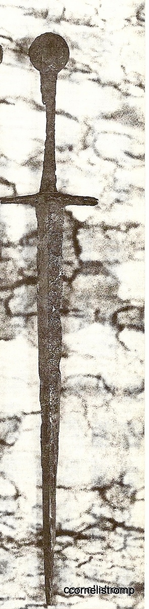

Both daggers have been found in Amsterdam in the 70ths.

Originally Posted by Marc
The ballock dagger looks fantastic, indeed. The blade is peculiar but not unheard of in this type of weapons.
Now the other dagger... well, it's just my opinion, but it suspiciously looks like a put-together with what could be a genuine medieval pommel, a cross-guard about which I couldn't pass a reliable judgement without examining it more closely, and a blade that looks like a cut-down blade from a 18th c. smallsword, down to the style of inlaid decoration... maybe it's just me...

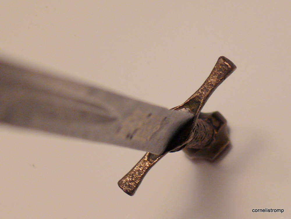

Hi Marc,
thank you for the compliment for the ballock.

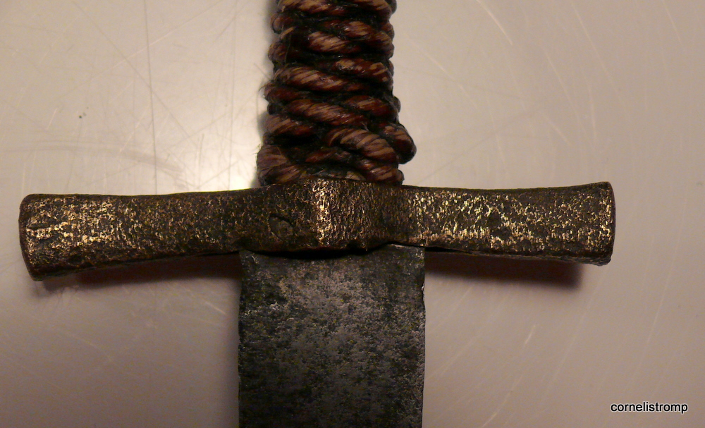

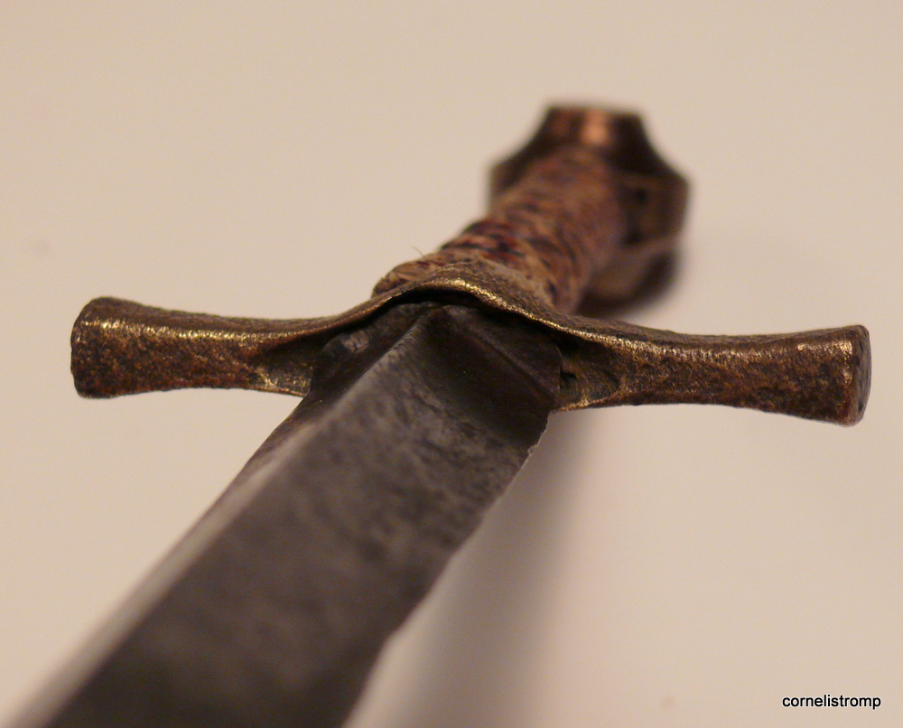

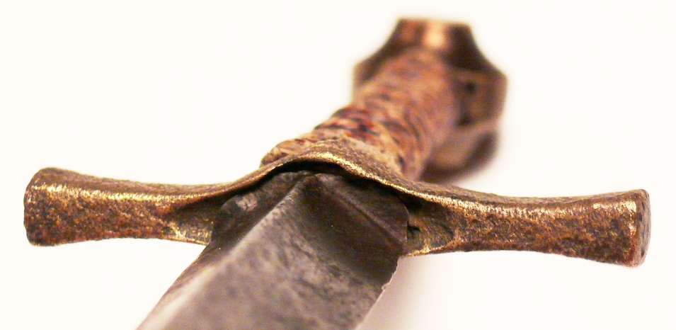

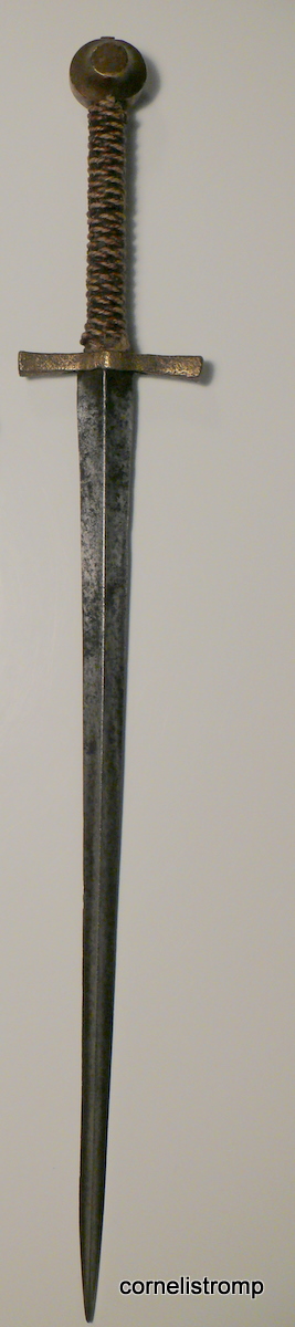

RE: the quillon dagger I think it is just you
Don't let the condition fool you, it is also 100% genuine. the authenticity has been confirmed by the curator of the Dutch army museum.
This is how it is found in the the river Rijn. (only the robe grip is added)
it is not a genuine pommel but a medieval dagger wheel-pommel 3cmx2,5cm
I also found the same type of small dagger wheel-pommel offered at an arms dealer and more convincing a similar dagger is published in Francis laking part 3.
This type of blade of hollow triangular section can be found on the majority of the same period rondel daggers.(around 1400)
I will post some pictures in order to explain.

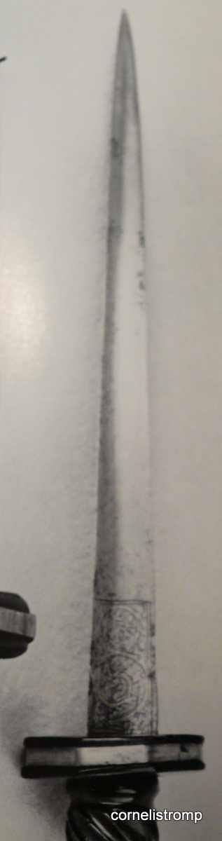

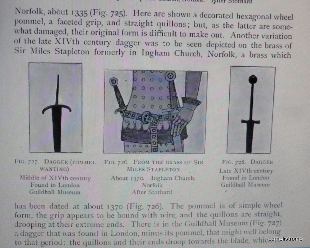

see picture Francis Laking part 3 page 3 guillon dagger fig 728 , this dagger from the guildhall museum has the same pommel and same guillons however a longer grip and a diamond shaped blade.
The construction of the guillon; the way the blade fits into the guillon is a feature of medieval swords. On later 15thC examples the shoulder of the blade rests on the guillons.
Best regards

Hi Cornelis,
I have gone quite crazy over those fascinating pictures - man, I wish these beauties were mine! Personally, I like the ballock dagger (Nierendolch) best for its wonderfully staged blade and great condition of preservation.
Thank you so much for the overwhelming close ups and the documentation, buddy! Very good job for all uf us.

On the quillon dagger I think I would have joined with Marc in his very reasonable observation based on the photos alone, and without the data posted afterwards. The material you provided after his observation is most impressive in illustrating the information on the actual disposition of the weapon. The detail on the provenance and authentication from the Dutch Museum are also impressive additions. A remarkable dagger.

Hi
like Marc, I have reservations regarding the same dagger. I too freely admit I am no expert on medieval daggers....but several features do seem 'alien' to the daggers of the period.
The blade sits 'uneasily' within the cross guard and is not central. Rust and decay in that area could account for this, but with the good 'preservation' suggested, seems unlikely. The forte/tang area ( shoulder) would be shaped to fit the crossguard slot/hole to prevent movement, the handle and pommel once fitted 'locking' the components together.
The relatively deep fuller extends to the point, again AFAIK suggesting the blade has been shortened. Why design a blade that has a weakened point.....especially when it could strike/pierce armour and snap ?
The crossguard recess is almost 'diamond' shaped ....better designed to accommodate a blade that's cross section is square/diamond not a triangular section. This also suggests the crossguard and blade did not 'start life' together.
Also the fort of the blade where it meets the guard is flared .... I have not seen this on a cross guarded dagger of any period (but then this does not mean this is a fact) However, this 'flare' is seen where the blades butt up against a bowl or similar shaped guard.....like the short sword. See photos below.
If you look the size and shaping of these flares seem almost identical.
If this is not a medieval dagger, it is possible that this is a Victorian 'era' 'put together' ....common to the time due to the interest of Romanism and the fascination of the medieval period.
All these observations are from the pictures, which does not necessarily convey the 'whole story'. This is not an attack on the museum curator either, but people make mistakes, so his assessment should only be taken as a guide. After all doctors often seek a 'second opinion' ....even if they are certain their diagnosis is correct.
Look forward to your comments, all the best
Regards David
The flare you mention are the result of hollow grinding. While the technique tends to be associated with three sided, triangular small sword blades it can be found on medieval swords as well. In hallow grinding the grinding wheel is used to create rather than a flat face one that is slightly concave imparting stiffness to the blade. Dr. Jones has a nice 15th century fishtail pommel sword, of the type with a blade that tappers rapidly from forte to point that I had the pleasure of handeling that is hollow ground.
Hi A Senefelder,
thank you for the explaination. Surely though, the 'flares' would be removed....unless it resulted in an added benefit. I think this 'flare' would provide a larger 'surface area' butted up against a bowl/cupped guard....making it more secure....much like a 'washer' fitted under a nut. These 'flares' do not seem to serve any purpose in the recessed cross guard of the dagger shown.
The 15th C fishtailed sword sounds interesting......could you post some pictures ? All the best
Regards David
Old 1st December 2009, 08:56 PM   #20
A Senefelder
Join Date: Jul 2009
Posts: 214
I am not aware of the flares being removed, it simply forms the little bit of forte ( very little in fact ) that exists at least on most of the later smallsword examples i've seen. I cannot find pics of Lee's sword, just one of the two swords of Lee's it was sitting next to. I think this one might be in "Records of the Medieval Sword ", I know a few of Lee's are.
