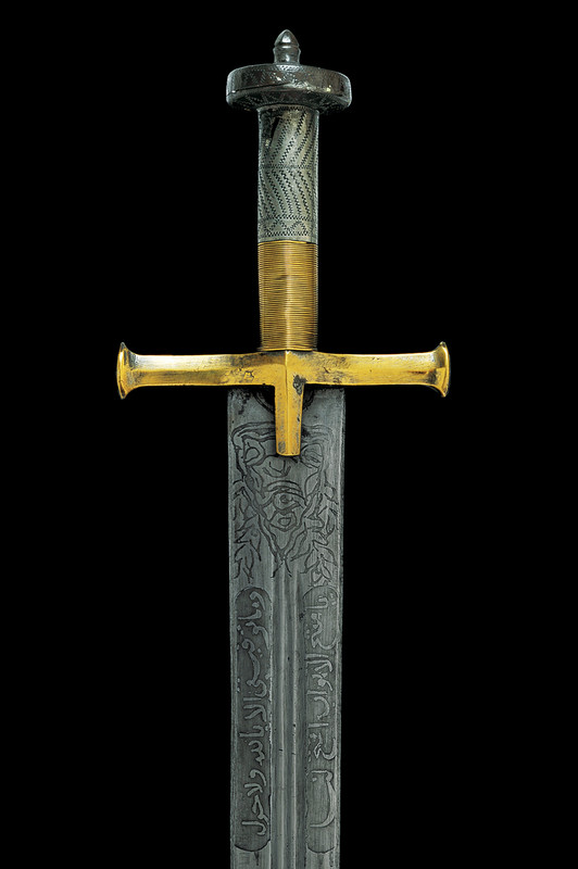

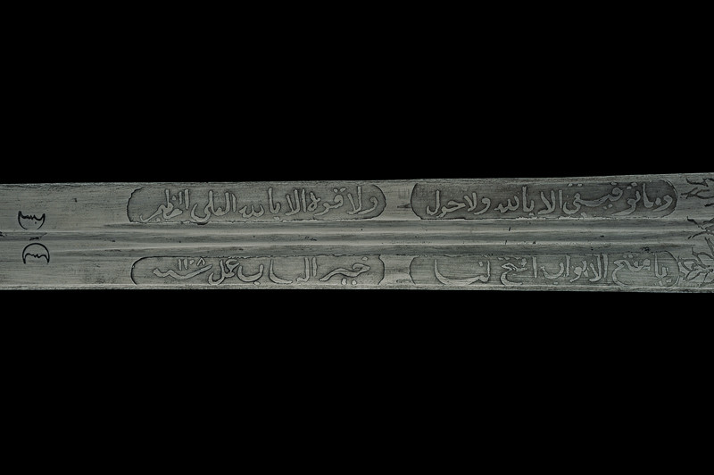

I just bought a kaskara that I suppose is Early XX century. I read the interesting forum on kaskaras and it is c.111 cm long, not the size of the XIX kaskara described by Pallm. It has some arabic phrases that were traslated from a friend of mine. On one side:
My success only thanks to God
There is no strength except by God Almighty.
Lord, opener of doors, the door open to us
best for our work

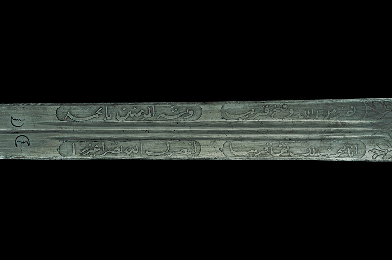

The opposite side:
Victory thanks to God
The triumph soon.
triumph near
God declares our victory
It has a classic stamp, two half moon, that I also have in another sword that I bought personally in Kassala in 1986 from the owner that was still carrying it. At the base of the blade it is decorated with a rose that I suppose it could be some kind of sign of recognition of the owner. Is there any suggestion ??

I have an uneasy feeling about the etchings: don't they look very fresh? The handle is also quite pristine, especially the wire wrapping: impeccably even and tight.
Old 3rd November 2009, 01:10 AM   #4
katana
katana's Avatar
Location: Kent
Posts: 2,658
Hi Mauro,
welcome to the forum, a very nice kaskara ......and excellent photographs .
It is likely the hilt has been replaced/repaired and the blade is older. I really like it.
Regards David

Hi Mauro.
Nice sword, I love the crossguard!!
Gene

Very nice kaskara. Maybe the blade is newer than the hilt - hard to say. The hilt and crossguard look like they have been cleaned bright.
Regards.

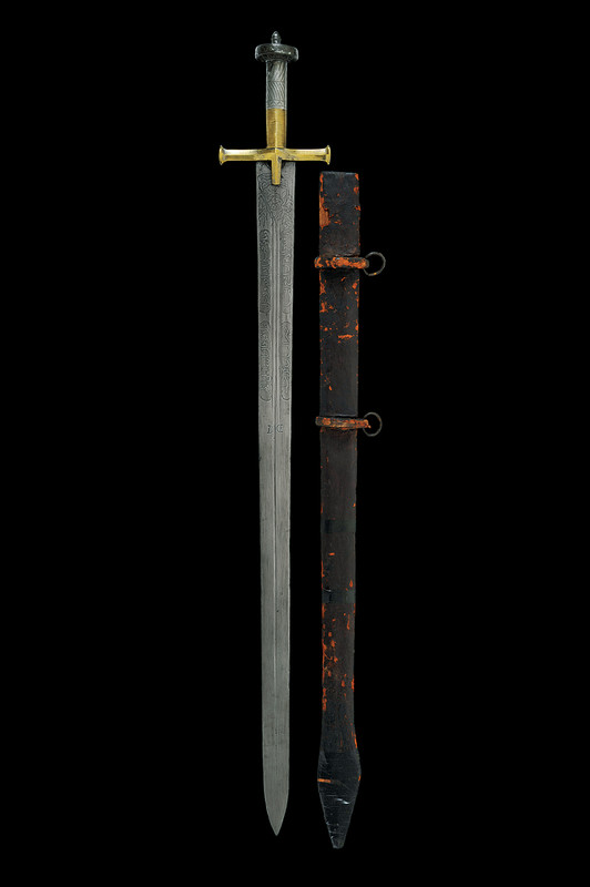

They attributed the sword to the late XIX century. Unfortunately they disabled the right taste and it is not possible to download the image and send it to somebody that could traslate the writings. I did not mentioned the scabbard that is dedicated to the blade and is original.

Hi Mauro,
Thank you for sharing this kaskara example, and for adding the link to the similar example from the earlier auction. It is my impression that this is indeed a quite modern interpretation incorporating various traditional kaskara characteristics of earlier times. As you have noted, these swords remain a traditional accessory which are worn on special occasions, and certainly considered a status symbol among prominant tribal figures.
The style of the hilt is interpretive, and is intended to represent the hilts of Darfur of 19th century, the interesting zigzag decoration loosely recalling the harlequin diamond pattern often seen on these hilts, as well as the discoid pommel also with similar geometric motif. The gold gilt ? or coloring and wire wrap seem unusual.....the crossguard is of what is considered 'Hausa' type with distinctly knob type quillon terminals. These are also contrary to the flared quillons of Darfur examples, and less so, even straight bar crossguards seen on regular Anglo-Egyptian Sudan types.
The blade, also representing earlier European forms shows the acid discoloring from the etched panels and floral motif, popular on earlier Darfur blades and the thuluth etchings on the simpler kaskaras of Mahdist period.
The paired moons, another Hausa distinction on kaskaras (Briggs) are termed 'dukari' and evolved probably talismanically from the blades from Europe in earlier times.
Im not aware of any particular significance of the rose in the Sudan or Darfur as far as being distinctive to a particular owner, but more a decorative floral to enhance the panels with the devotional phrases.
Nicely done example of these very traditional weapons that remain important to tribal figures in these regions. Even the very old blades are, as in many cultures, remounted and refurbished as they change hands as heirlooms.
Scabbards were apparantly often red or brown goatskin, and the black paintover on this is very curious, perhaps whoever acquired it sought to dramatize the gold metal on the hilt.
