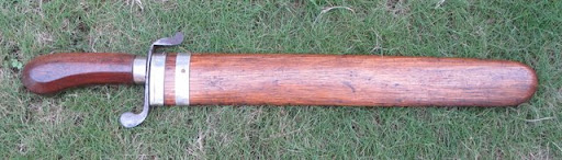

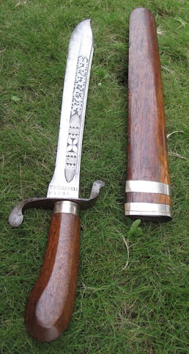

Hello, I acquired this really neat knife/short-sword recently. I don't have much experience with Southeast Asian weapons so thought I should share it here and get expert opinions & feedback. The Oriental-Arms website has similar knives being described as being made in the village of Tjikeroeh (variations in spellings), now called Chikorea (sp?) in Indonesia, targeted at the colonial Dutch population and combining aspects of native Indonesian as well as Western swords. This one has "TJIKEROEH" and "1898" inscribed on the base of the blade near the hilt. I'm guessing that's the year the blade was made, as the Oriental Arms examples also have similar inscriptions with year of manufactures. Everything about this knife looks to be well-made - from the blade, designs on the blade flats & spine, guard, hilt, to the simple scabbard.
So ... what do you all think???

Some more photos:
Is there a specific name for knives/swords like this? Is this an average, above-average, or below-average example? Any additional info? Thank you very much!

Your example seems like "average" quality to me. Is there a scabbard ?

This swords called Golok, your blade is very nice. But it seems like the hilt is from a newer date, please show us the sheat.

Hi guys, thanks so much for the additional info and the links. Lots of info in there, I'll be digesting them slowly. So, you'd call this a Golok variant? I was initially thinking along the lines of Parang, seeing its similarity to a few photos of a Parang Nabur I saw recently. There is such a variety in SEAsian blade forms that it'll probably be a while before a beginner like me can sort them all out.
As for this sword, to my amateurish eyes, the hilt and the scabbard seem to be made of a similar kind of wood (don't know the wood type). One side of the scabbard is lighter color than the other. Also the scabbard and hilt look like they're of around the same age. Don't know if this means that they came with the original blade or if they were replaced around the same time. The tang does not come out of the end of the hilt though, unlike the examples I see in the links posted.
The first two photos I posted above shows the sword next to its wooden scabbard. I'm posting more pics below:

Hullo everybody!
The blade appears to be made in the village/district of Tjikeroeh, which still exists today and is now spelt Cikeruh (any other form of current spelling is either born out of ignorance or a simple typo).
It appears to be of good quality, considering the era and the fact that the manufacturing was a small village operation, which also turned out everyday utensils (i.e. not an armourer). In fact, the operation was generally a sort of village cooperative, with different households being involved in different parts of the manufacturing process.
The blade was made at the end of the period when the village was producing swords for the colonial Dutch para-military/military (the Dutch shifted production of swords to Europe in 1898).
The motif and the clip-point suggests that it was probably made for a European and not as a run-of-the-mill product.
I call it a pedang as it does not follow the golok protocol.

Because this type of daggers was made for the Dutch and after european standards I wouldn't call this nor a Golok nor a Pedang.
The shape of this dagger is more that of a Hartsvanger (Dutch) or as the Germans call it a Hirschfanger.

I agree with Henk.
These weapons where not made for indonesian people.
In that case I can not Imagine that there would be a date and name.
The shape is indeed of a hartsvanger and also the handguards often follow hartvangers designs.

After looking again to the complete piece I have to agree with Henk and Willem, it look indeed like a "Hirschfänger" and in this case the handle and sheat would be original.

It is definitely not a golok.
However, it was made in Soenda and it is a short sword (by European standards). The Soenda generic word for sword is 'pedang'.(BTW... I should emphasise that the piece is a good quality commercial piece, not as good as a military piece )
Are we going to quibble and be pedantic about whether it should be called a shortsword/hunting-sword/hunting-dagger/forestry-sword/forestry-dagger (English), hirschfanger (German) or hartsvanger (Dutch)?
