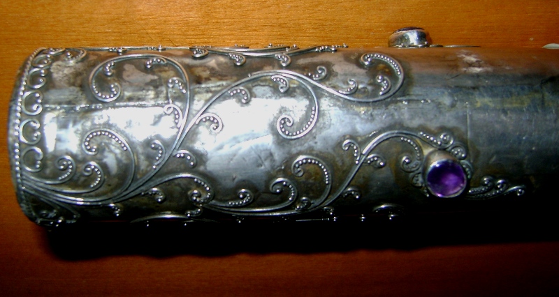

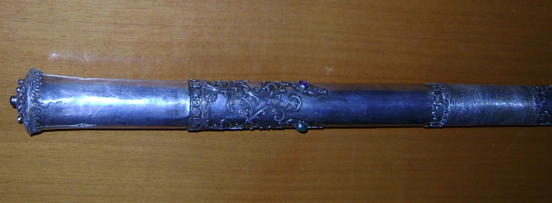

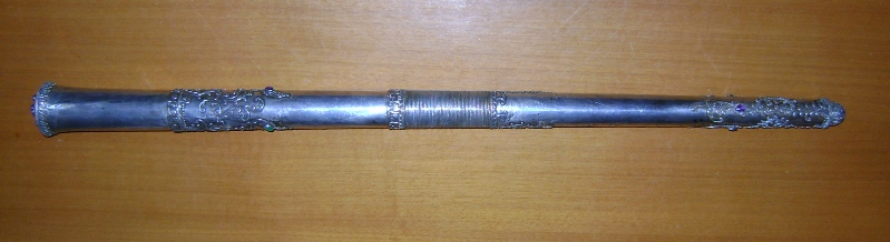

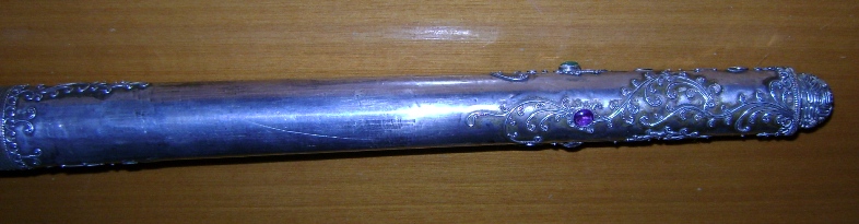

Said to be from trhe 19th century, which i beleived.

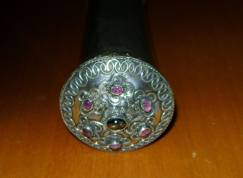

It has thirteen (precious?) stones all over the scabbard, in various colours.
Scabbard said to be silver, which i have also beleived.
Origin said to be Malay, which i wouldn't know for myself.
It has total 68 cms (27") length, blade measures 45 cms (18").
Coments will be so much welcome, namely whether this type of 'weapon' is a common item, or something not often seen; or would this be a tourist thing or an apparatus for a person with status?
Also i would like to know how you name these things, both in english but specially in the origin language ... certainly transliterated.
Thanks a lot in advance.
Fernando

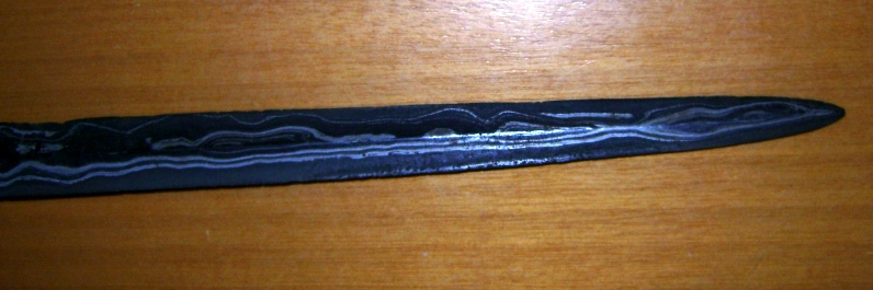

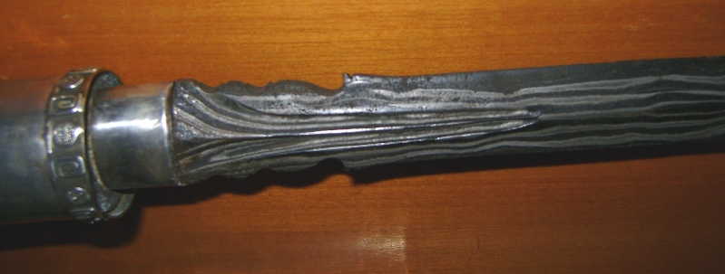

The blade seems to be a keris blade, without gonjo and heavily reshaped at the base, but two sogokan and bungkul are there. You even can see the remains of pejetan on the upper side (in these pictures). Here a diagramm for the terms: http://www.kerisattosanaji.com/kerisdiagram.html
This pamor is called aiq ngelek (in Sasak language) and seems to be typical for Lombok (according to book "Keris di Lombok" of Ir. H. Lalu Djelenga, page 233).

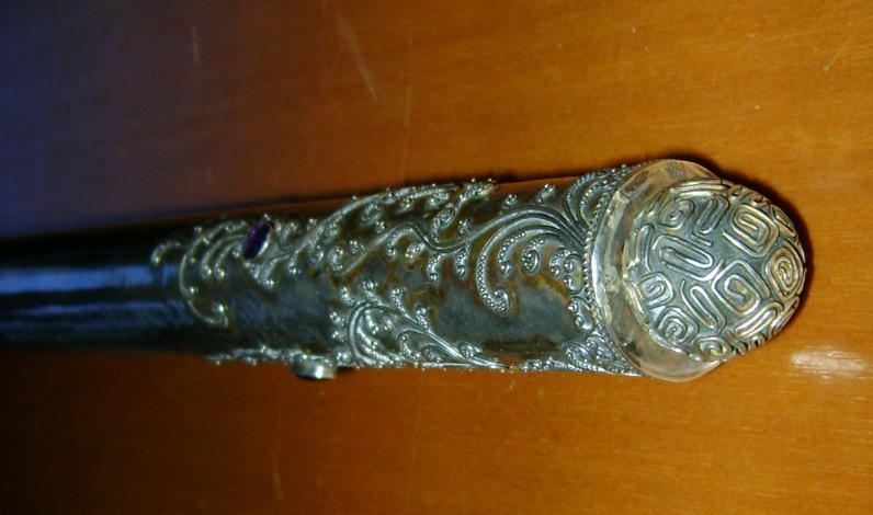

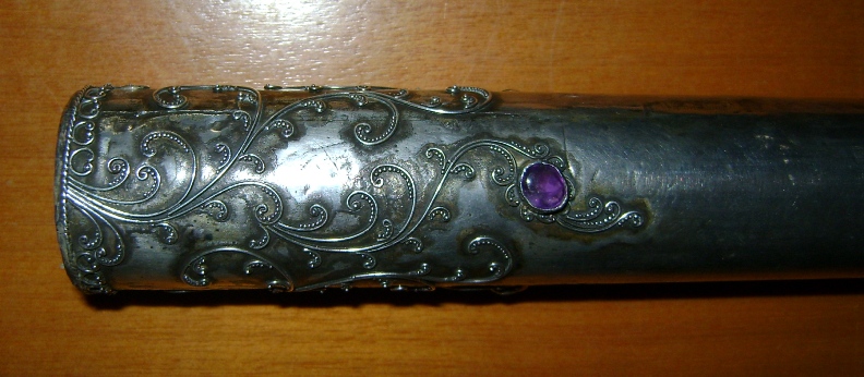

I don't have experience in modern working with silver (?) in Indonesia (pendok, selut etc.), but my guess would be the last twenty years for the scabbard, looking at this wire work. Not the newest work, but also not so old. But this is really a guess

Thank you Gustav, for the diagnosis on the blade; i will register that. Concerning the silver work, probably you know much more than me about it, but i woul go for some more age, not excluding 19th century. I will try and get some appreciation by a local smith, at naked eye.

I was advised by a person well situated in this subject that this item is what they call in Jawa a "stok comando", a command baton popularized by Sukarno, and often used by ex-military people.
The use of an old or damaged keris or tombak blade seems to be the current practice. In this case, one practicaly as described by Gustav.
Indeed Lombok would have been the place of origin for the silver work.
In view of its recent age, in contrast with the 19th century pretended by the seller, i have returned it in exchange for an item of equal price.
