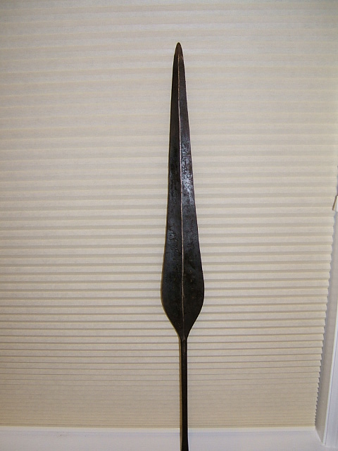

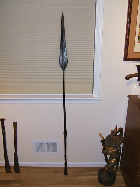

This is the other item I picked up this week. A nice example of Ngbandi spear?
It seems a bit short to me even though it measures 68" long is it possible that it was shortened at some point in it's life? Let me know what you think.

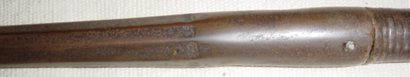

That spear looks absolutely fine to me, a close up of the end would be helpful. From what we see at the moment it is a really great spear ,super find. Tim+Sam

You are quite right : a Ngbandi spear. There's nothing wrong with the length of your spear. I have a similar one which measures about 63 inches (157,5 cm).
Don't forget these were weapons for close combat, stabbing spears. The long blades of Ngbandi spears were used for thrusting through the shield of the opponent.
I see some nice carving on the handle.

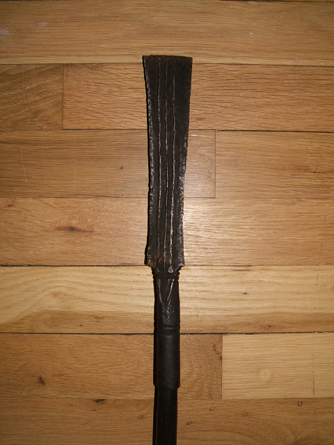

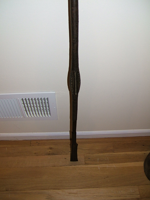

The metal 'shovel-type' butt is not typical, but spear blades were traded all over Central Africa. It's possible that the owner preferred that type of butt end to the more conventional one. Nothing wrong with that either.

This spear butt is also from the congo. A heavy octagonal spike, the pin in the female socket also seems to be a congo thing. You do not see it in southern spears or those from the east and the horn, I have not seen it from the western trade coasts or the north though I have seen a pin in the blade socket in Hausa and other northern spears. Tim
