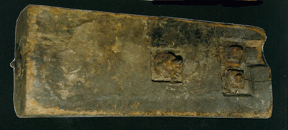

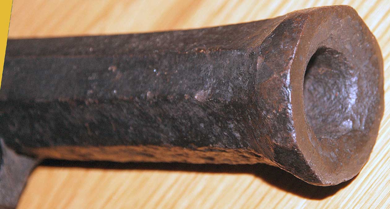

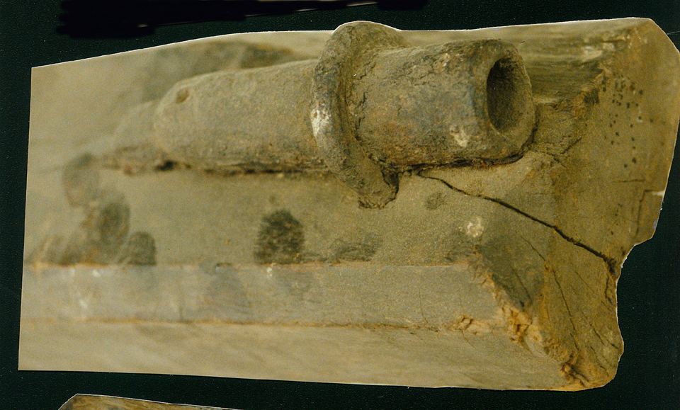

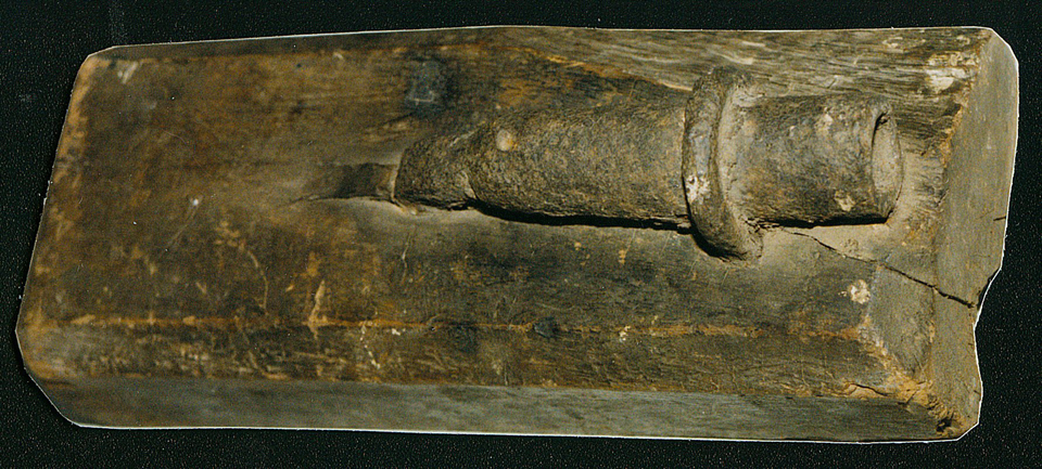

Wrought iron and oak wood. Overall length 40.6 cm, barrel length 19.8 cm (including bent stick), cal. 25 mm, weight 4 kg.
That (now short) round barrel was originally part of a long wrought iron Nuremberg haquebut with a long iron grip stick made in ca. 1500. It got probably damaged in its early working life and, as a consequence, got shortened and restocked in oak in is present form during the Peasant Wars in 1523-5 (Nischengeschütz, small alcove cannon).

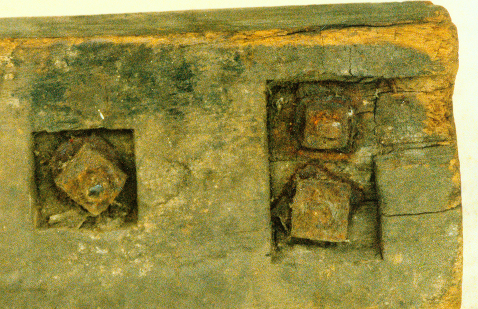

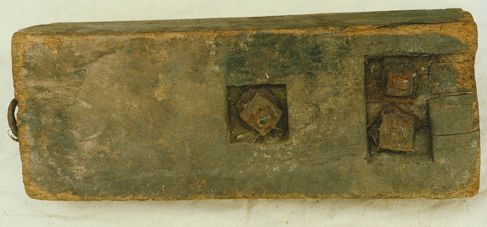

Believe it or not, it is fastened to the wood with three bolts and nuts. Screwing nuts have been around since at least the late 15th century.
I attach some photos taken 20 years ago. I do have a new digital camera now but for some reason or other the USB connection does not seem to fit my computer. As soon as I can make somebody get here and fix this I will post better images.

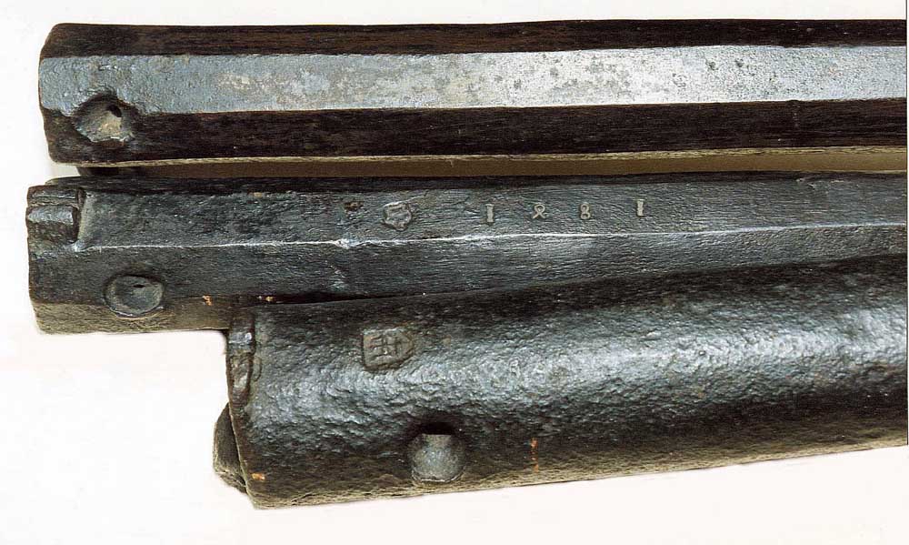

I also iclude images of a very similar barrel of ca. 1500 which is preserved in its original unaltered shape at the Bavarian Army Museum. These images are owed to Robert Brooker.

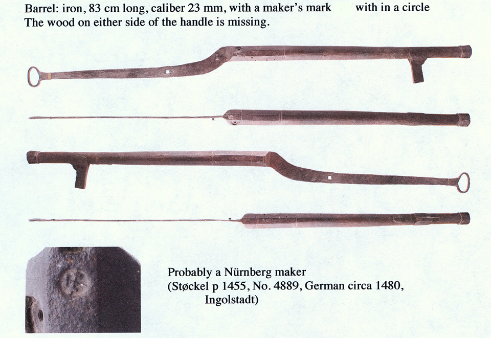

Last barrel is amasing! what is the mass of this? Do you have a hight quality photo?

The measurements are as the text states:
barrel length 83 cm, cal. 23 mm.
These are the only photos I have.

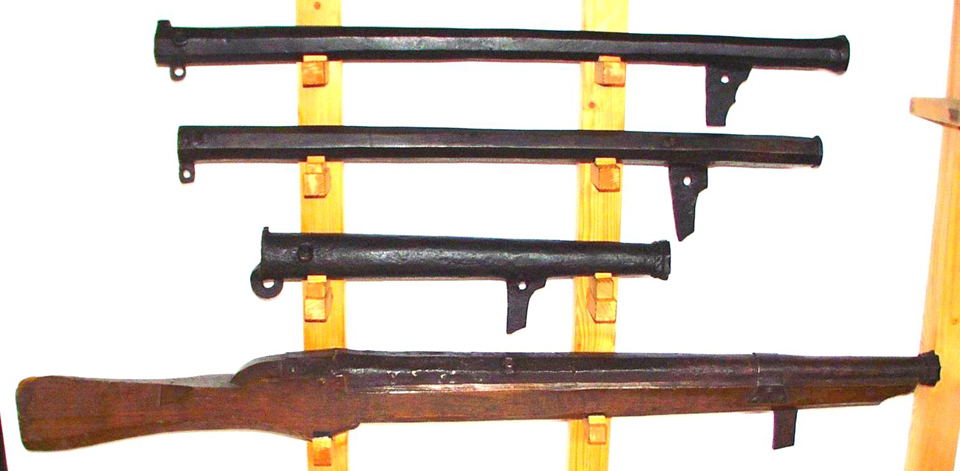

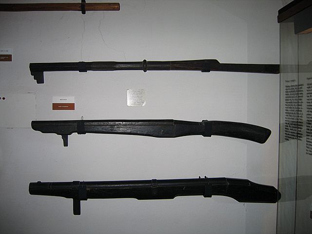

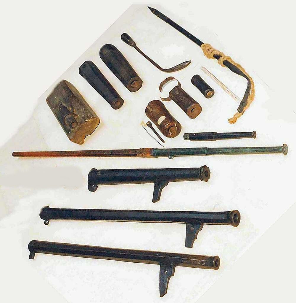

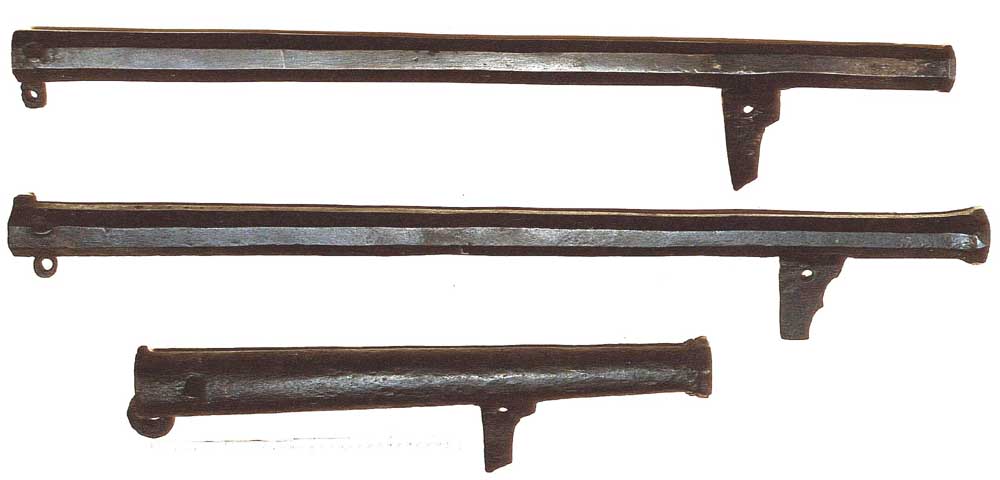

Thanks. I have understood all. It is a pity that this wallgun is later than I thought. So do you have photos of wallguns of the period wich interesting me? Especially with calibres about 21-25 mm and barrel length about 600-800 mm.
Wthat is the date and parametras of this (look at photo)?
Sorry that i have too many questions.
Spiridonov is offline   Reply With Quote

I will be glad to tell you everything I can about those three haquebuts but can you get more images and in much higher resolution? In what museum are they? The Army Museum of St. Petersburg?

This fotos from museum of Tabor.Czechia. Sorry, I have no another photos of this

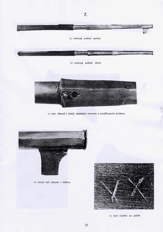

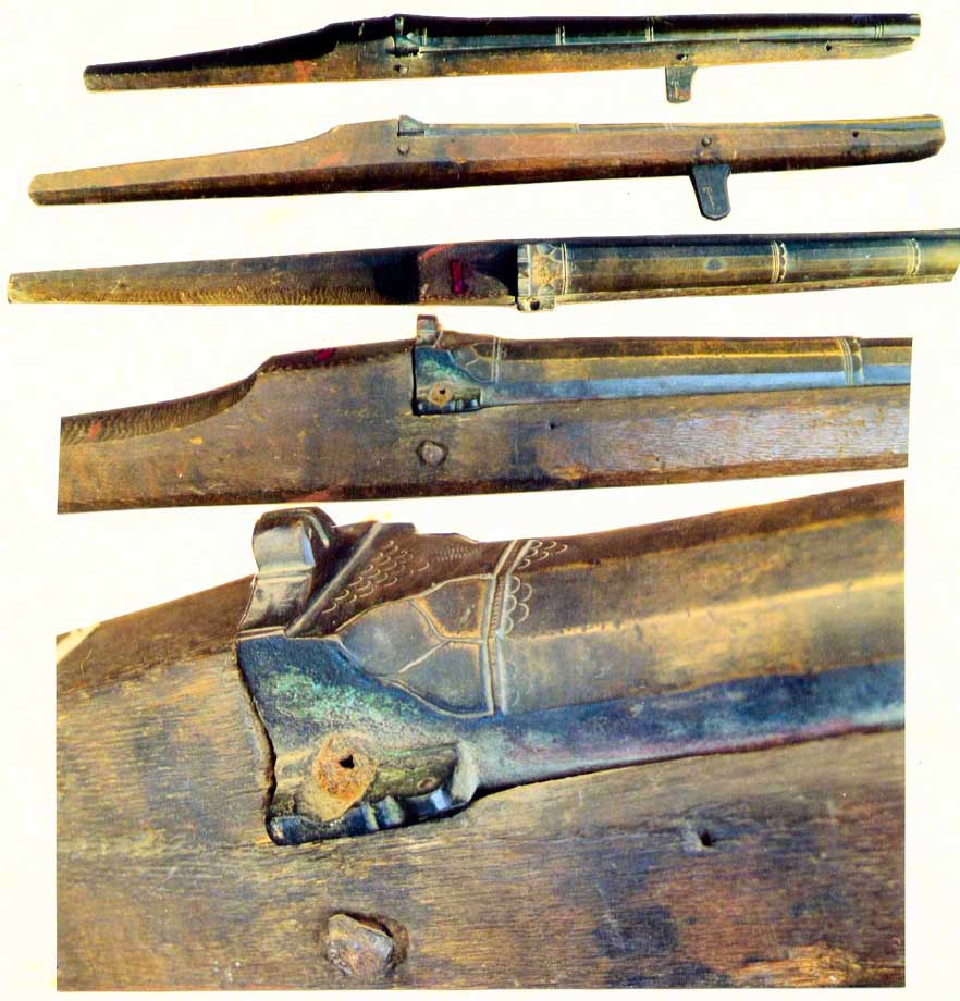

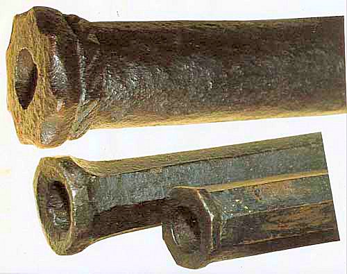

O.k. then, Spiridonov,
Here is what I can tell from looking at your photo.

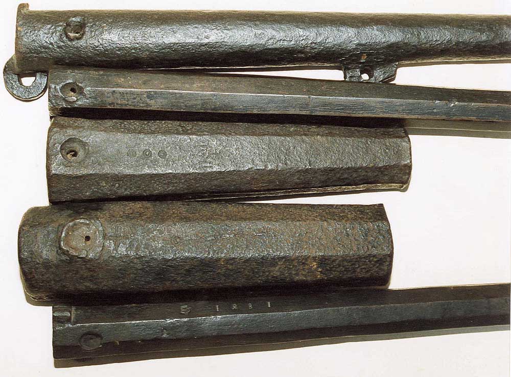

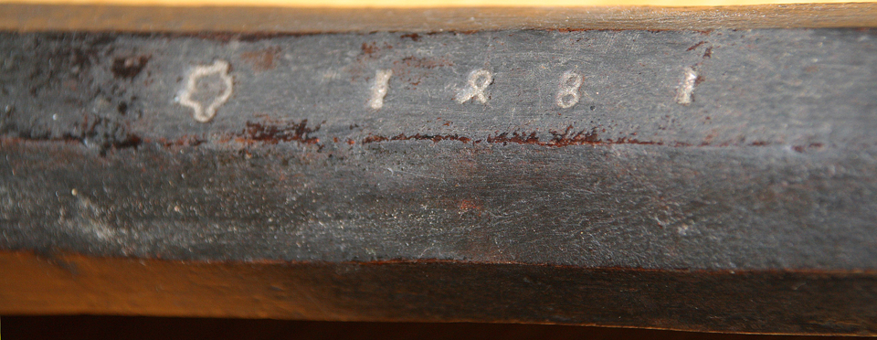

The one on top: as I wrote in today's prviate message to you the barrel is wrought iron and was almost certainly made in Bohemia. Its multi staging, the small hook immediately below the muzzle, and its general form make a date of ca. 1440-60 highly probable. I do not think that the tiller stock is original.
The central one: barrel octagonal throughout, of wrought iron, sadly without any clear criteria such as staging, a swamped muzzle section and/or sighting, touch hole not visible in image. Most probably made between ca. 1470 and 1500.
The one at the bottom: Barrel possibly of cast copper alloy ('brass' or 'bronze'), and if so, almost certainly cast in a Nuremberg workshop, the long sighted staged muzzle section denoting a manufacturing date of ca. 1520-30. Two things are highly unusual about this form of barrel: the hook has been added by means of a loop, and there is no visibly staged rear section as one would expect. Maybe the barrel was altered during its early working life and restocked. The unusually short butt stock resembles the butts of the well known group of the short Basle harquebuses.

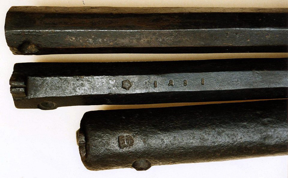

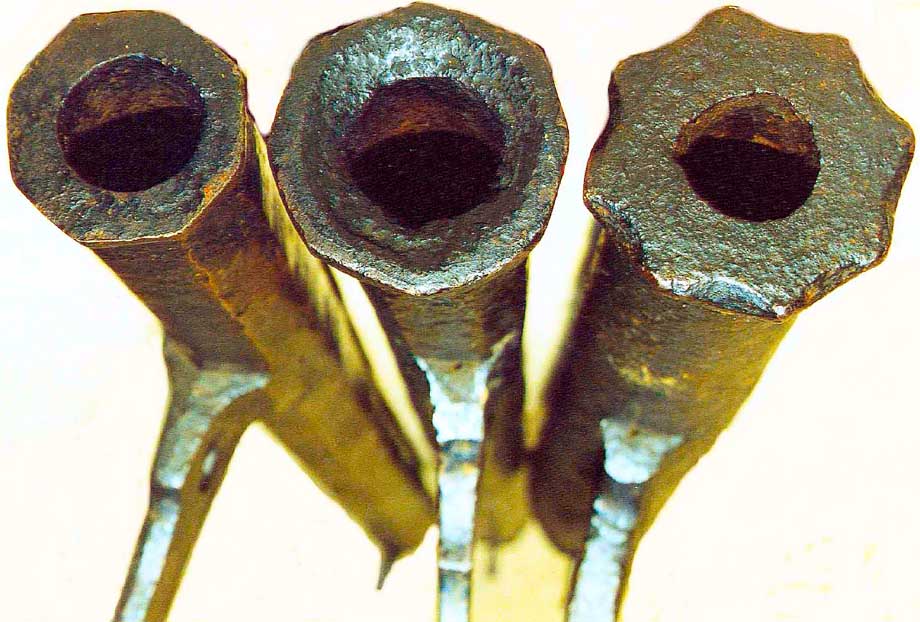

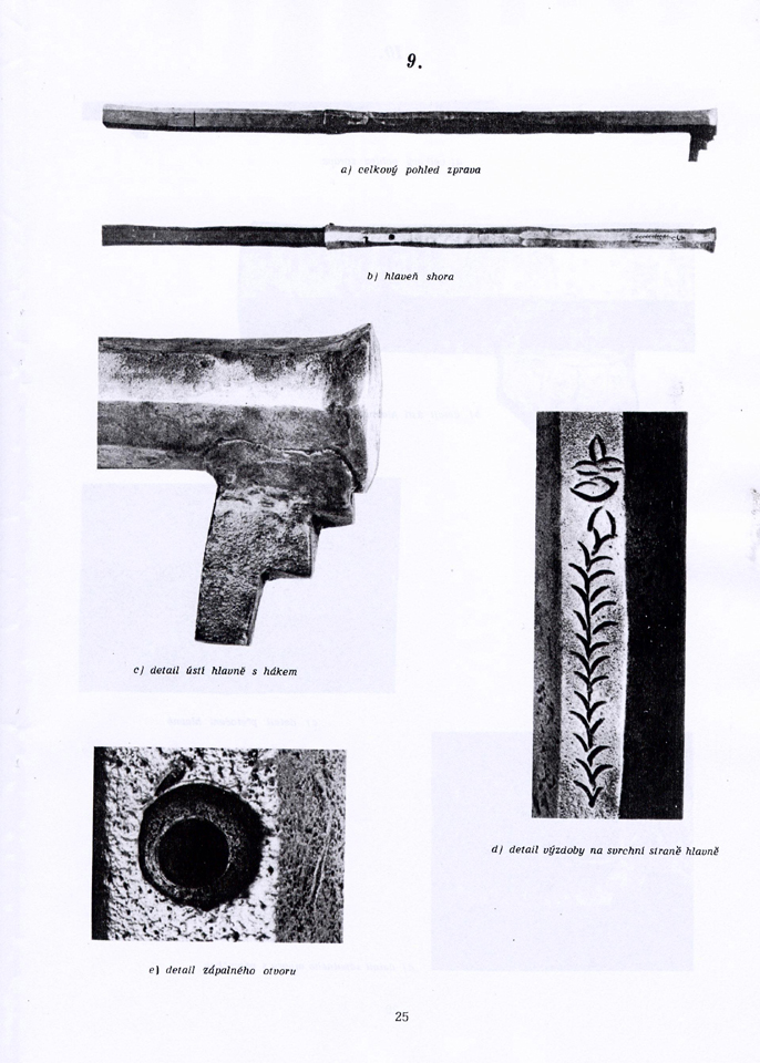

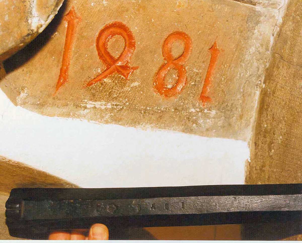

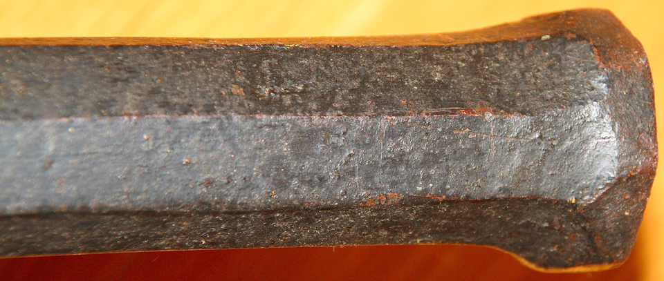

I include photos of similar Bohemian barrels from the Pilsen museum (all b/w copies from an unprinted manusrcript), of two barrels from my collection, ca. 1460-70 and dated 1481, and a huge Nuremberg haquebut of ca. 1515-20 in my collection. This is also done complying with your desire to see barrrels of the second half of the 15th century.

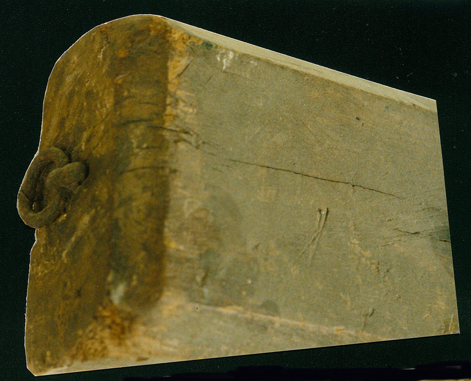

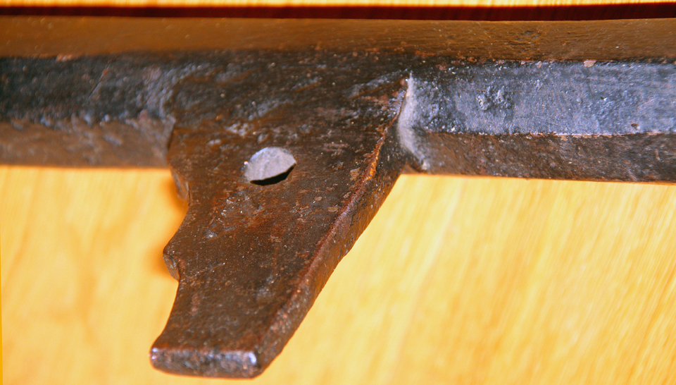

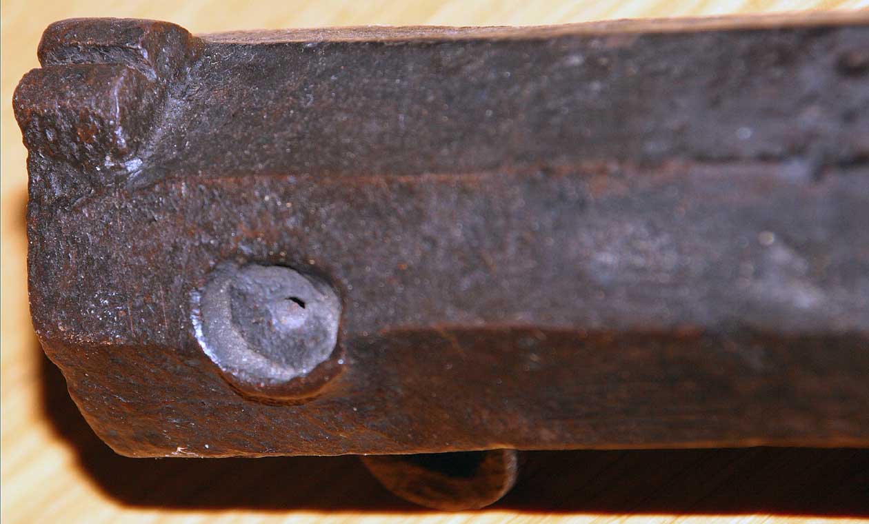

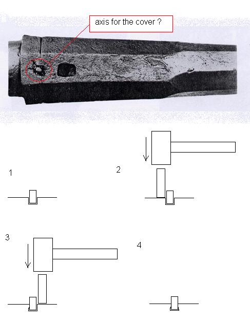

what date of this barrel? http://www.vikingsword.com/vb/attach...id=48227&stc=1
Is the wood original or not? What calibre and length? How did the clutch and back plugis was attached?

As I stated, ca. 1440-60, formally.
As to the rest of your queries: Dear Spiridonov, please do accept the fact that I am not a clairvoyant - neither do I have access to better images nor am I able to 'see' and explain hidden features.
I may have been the most avid student of earliest guns during the past 30 years (at least I hope so, otherwise my life might have been sorta wasted during that long period!) but I'm not the Pope of firearms, meaning that I am not claiming to be infallible ...
Alright, okay?
Sorry to have to disapoint you, my Russian pal - I understand you seem to be searching for a universal authority to present dead easy answers to your complex queries - but believe me: it ain't me you're lookin' for ...
There sadly ain't no no way to prevent you from going thru a period of long, hard and painfully doubtin' studyin', and all I can offer is to try and guide you along. Learnin' means believin' a damn whole lot though. The only other possible way is doin' it all on your own.

I think that it is the axis for the cover. I had ilustraded suppositional technology to fixing os this
Sorry, Spiridonov, but: no.
This is not an axis for a missing touch hole cover but a nail to fix the stick stock to the iron socket.

I think that (2) is the nail to fix the stick stock to the iron socket, but (1) is too far from stock to be a nail.

Well, whatever function (1) may have, it is certainly not an axis for a touch hole cover.
