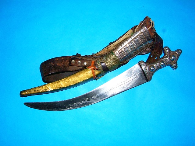

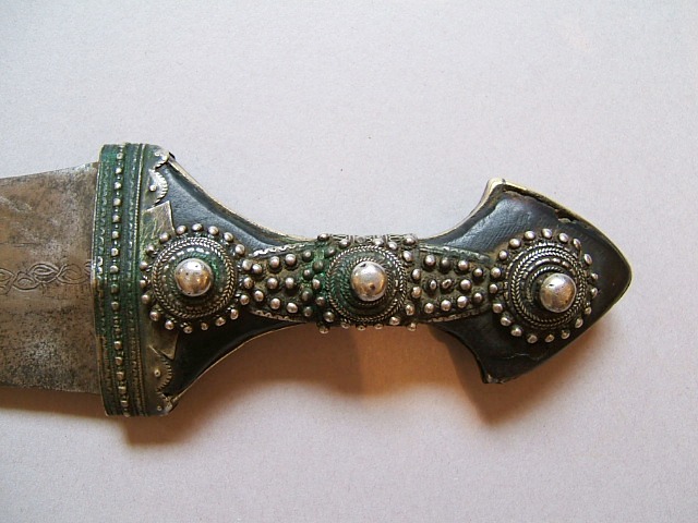

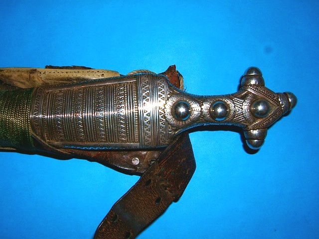

Just finished on epray and on its way to a new home down under. A large Western Arabian Jambiya from from Hijaz/Asir region and dating to the late 19th or early 20th century. Overall 560mm or 22'' depending on way of thinking. Pics from seller.

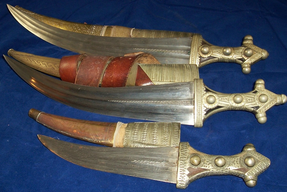

Hi Stuart ,i think it is Wahabite i have one very similar will post pics tomorrow when battery is charged .

Hi Graeme, Wahabite is only one of the tribes who use/used these big blades. There are many West Arabian tribes who used them I have always regarded the term Wahabite as one used by collectors to describe this type. They are more correctly called either Sabak or Sabiki. Refer Elgood Arabian Arms and Armor.

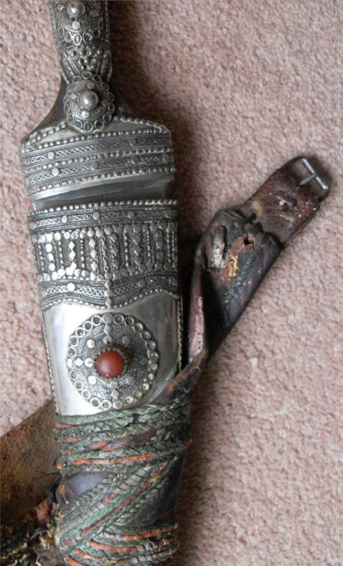

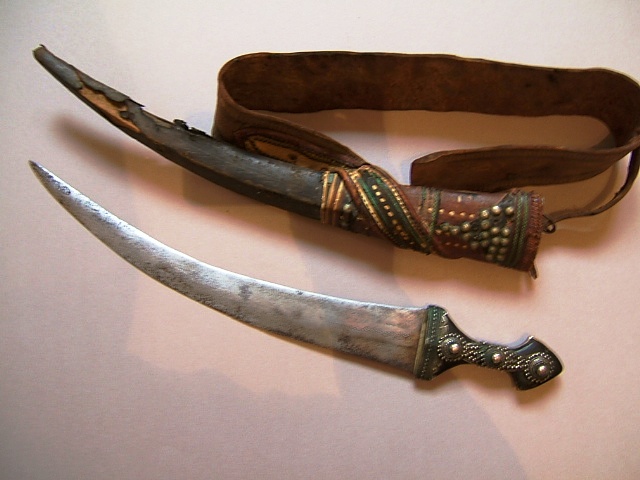

Hi Stuart ,i bow to your superior knowledge here are my two hope you find them of intrest cheers G .

Graeme, the lower and smaller one of your jambiyas has been identified as coming from Asir, which prior to the Saudi conquest, was part of Yemen. So actually, this jambiya likely belonged to someone whow as resisting the wahabits. Assuming of course it dates back to the first half of the 20th century.
regards,
Teodor

Big one is 26" long

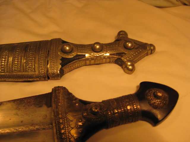

Interesting contrast between these similar pieces.
I notice Stuarts does not have the central rib, and I've been trying to see if the blade has a thickened tip?
Also Graemes, whilst having the central rib, has incised decoration cut into it, similar to that on Stu's.
Are these two similar but distinct 'styles' indicative of specific respective areas, or timeframes, or are their differences purely 'coincidental' manufacturing choices of their makers?

The lower one is very similar to one of mine, which according to Elgood is from the Asir/Hijaz region, and dating to the 20th century, Bani Malik and Bani Shahr Tribes.
The upper one appears to be from the Hijaz region, and my guess would be 20th century.
As far as the blades of these particular long bladed Jambiyas are concerned, I have always believed that the flat blades are of earlier vintage than the ribbed ones, but that is only my opinion based on the viewed age of the total piece. I have used as "rule of thumb" that flat blade is 19th or very early 20th century and ribbed a little later. I have nothing concrete to base this on other than gut instinct. Perhaps others here can elaborate.

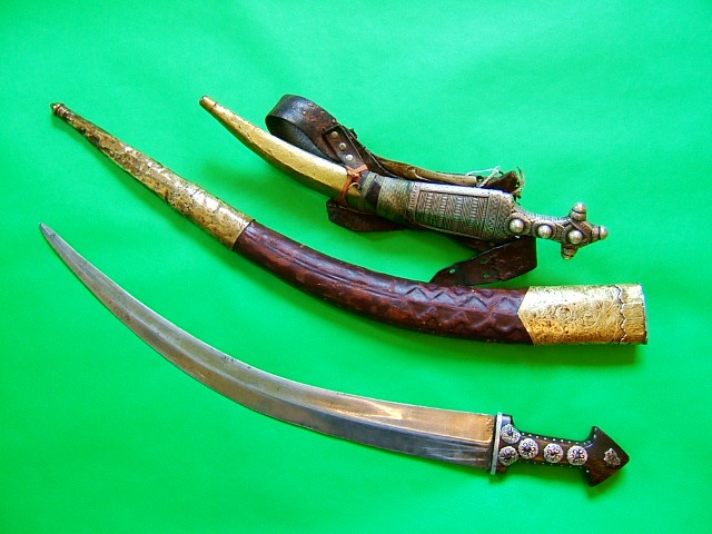

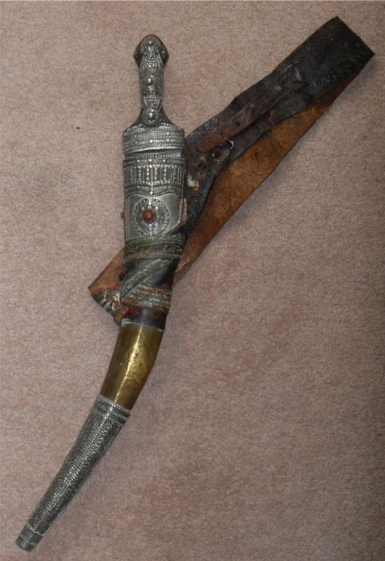

I agree with Artzi on this forged ribbed blades need a high skill level to create the flat ones seem to appear after WW1 Stuart's piece seems to fit in between 1920-40. I have a similar one but a bit more worn. I included a pic of a large jamibiya with a 24" blade whick I am pretty sure is late 19th century?

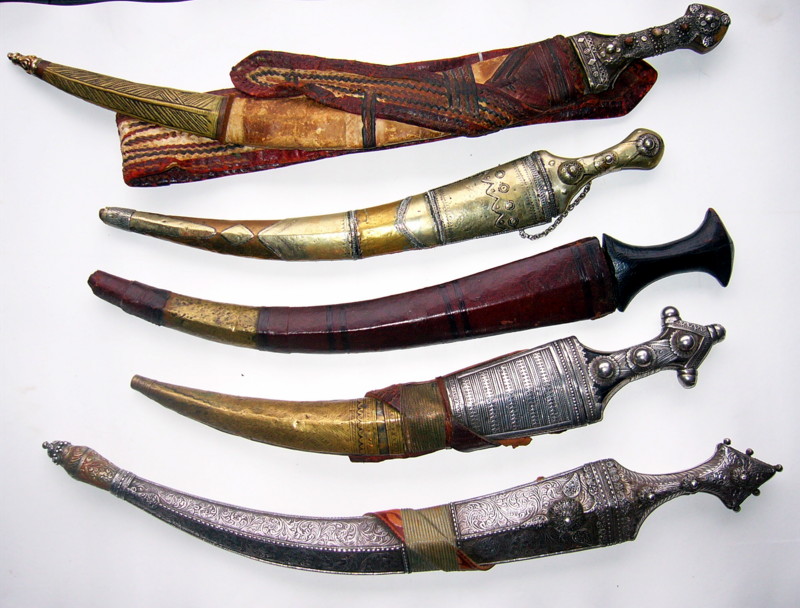

I had 4 of these. The largest I have sold and is not pictured. It had a flat blade and no fullers. Exterior looked the same but blade was far inferior to the top 2 pictured.
The two larger pictured both have fullers/ribs and fine quality blades.
The bottom piece I believe would have been a boy's as its very small for these. It is flat with poorer decoration and weak fullers .

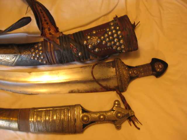

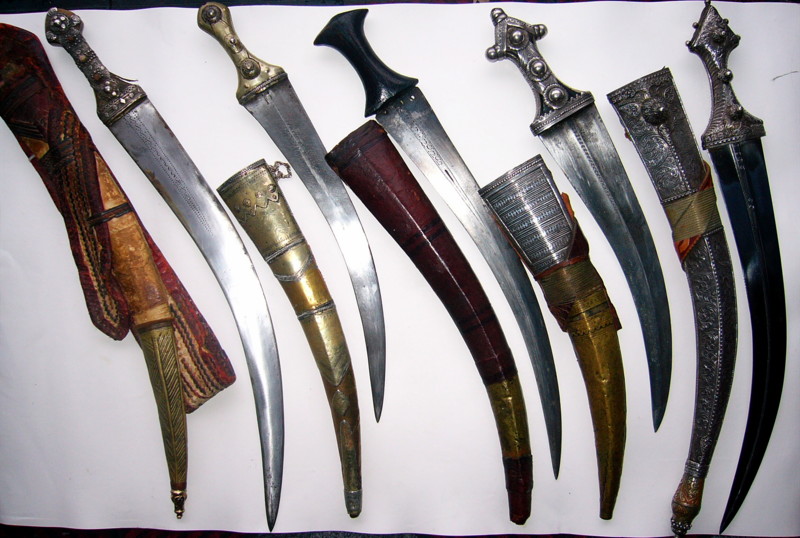

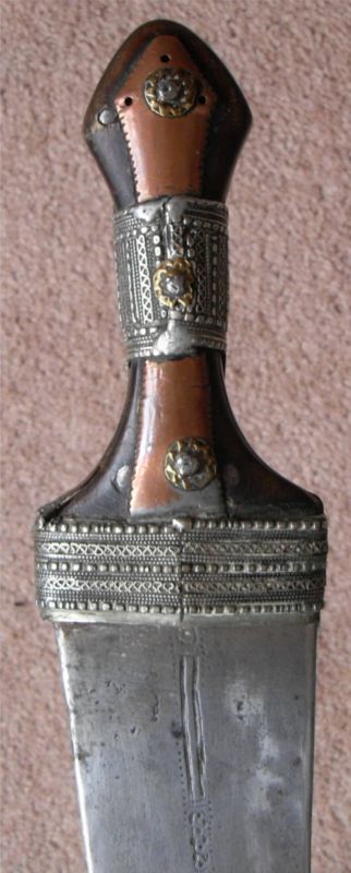

Thanks Artzi for coming in on this discussion. I have no doubt that you have done more study than the rest of us as this is your business. We can only be guided by publications, such as they are, about these weapons. I can see that flat blades would be easier (and cheaper) to forge than ribbed ones. From that point of view, my train of thought was that the EARLIER ones would be flat as the forger would perhaps not been exposed to the technology required to make the ribbed version. I guess we will never know for certain but I am finding this discussion extremely interesting. As I have said before on this Forum, we are all still, and always will be, learning.
Just to add a little more, here are some pics of the rest of my long Jambiyas. The one with the "Sudanese type" hilt has been rehilted at some stage but the whole item shows good age, so it is not a recent happening.
Regards Stuart
