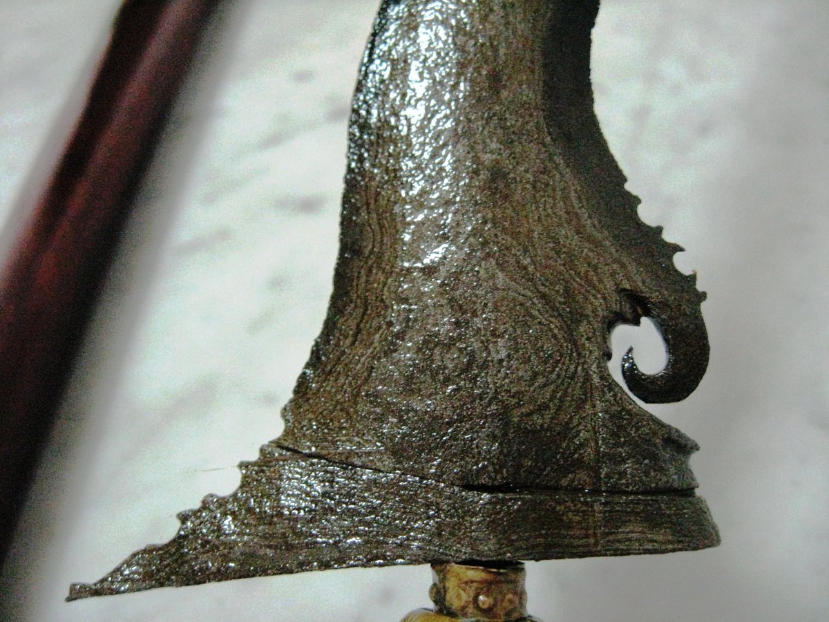

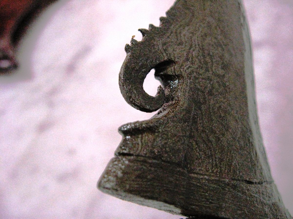

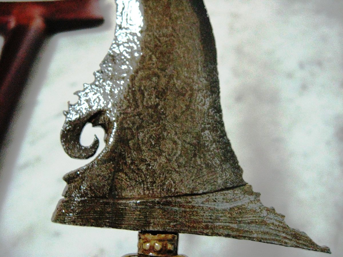

Thumbs up A fine old Bugis Sulawesi
Interesting layering of metal & condensed pamor.
Welcome all for comments & discussion.

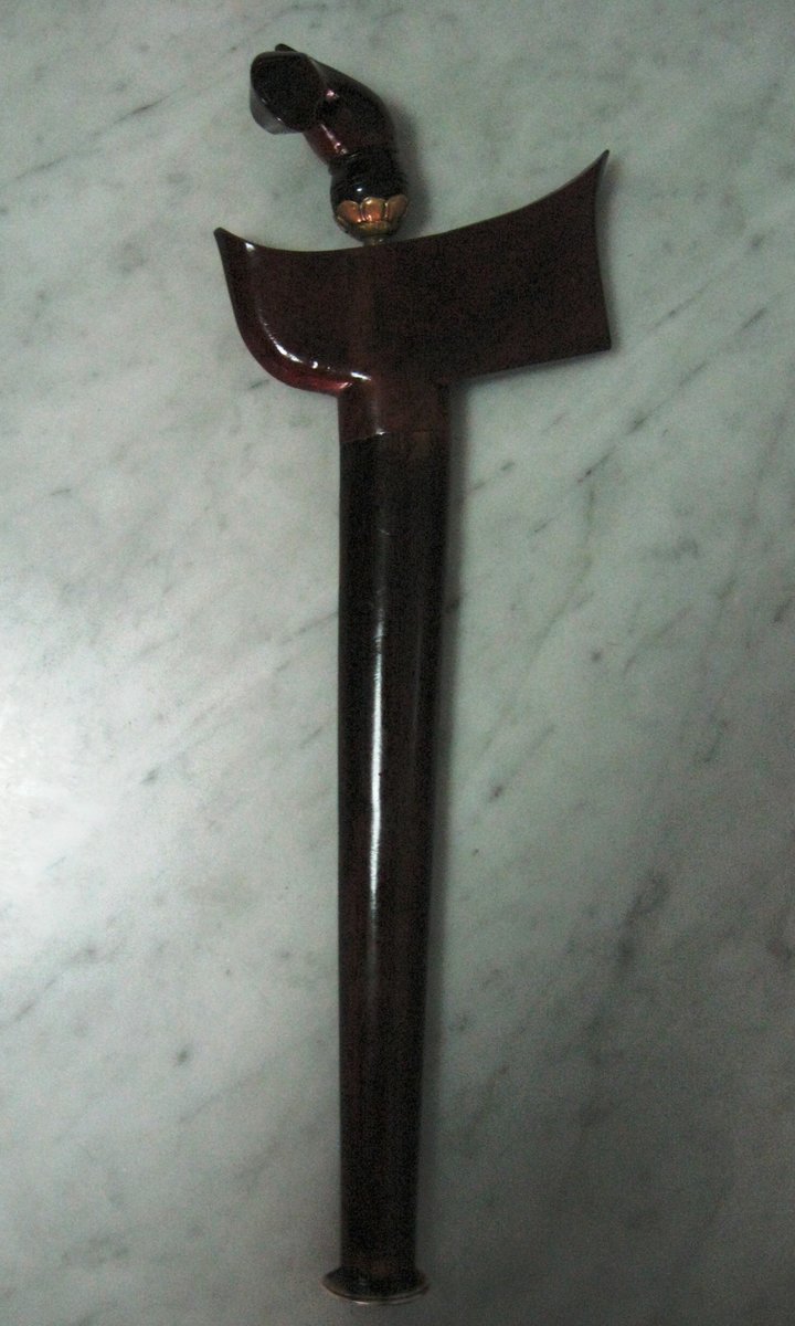

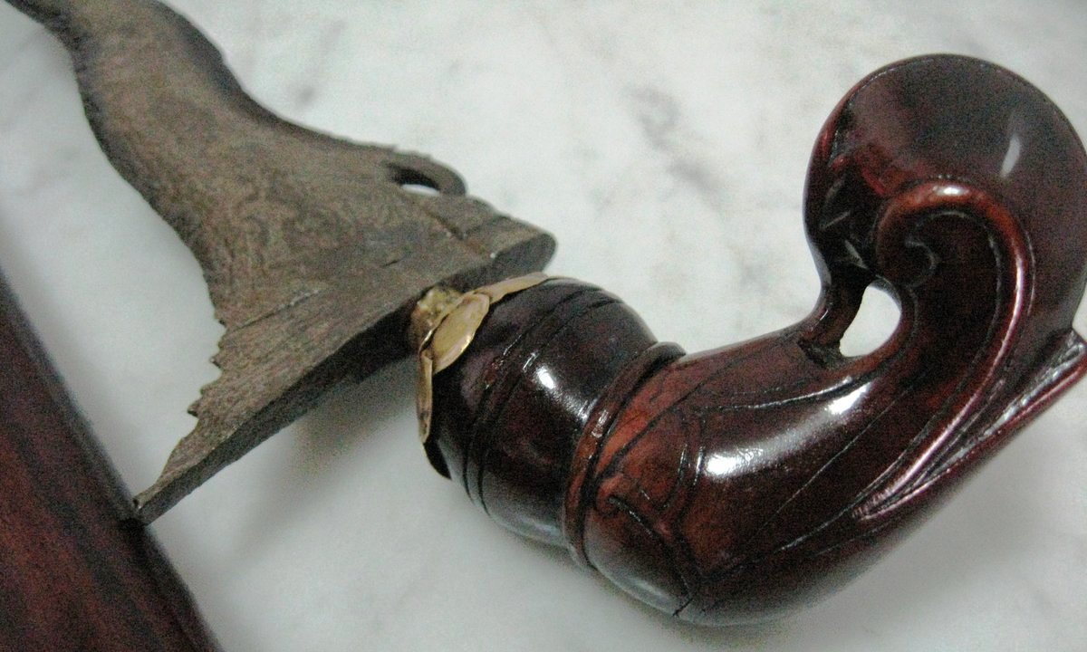

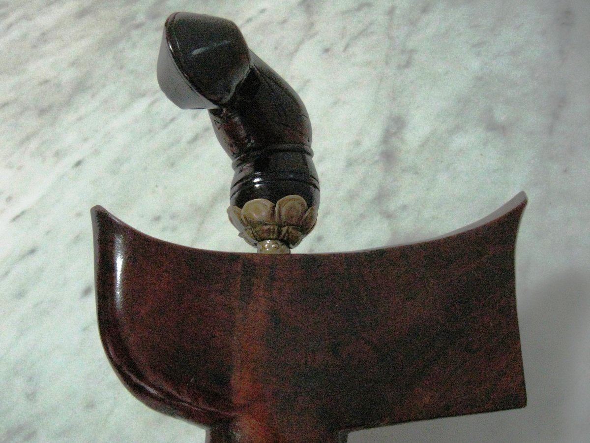

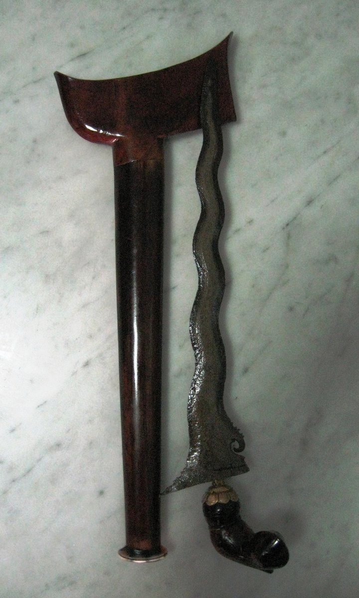

welcome to the forum! Look's like a nice keris. I like this specific form of the hilt. Is the buntut of the sheat from a old coin? When I am you I would change the Pendoko.
sajen
thanks for the welcome, the buntut of the sheath is actually from water buffalo horn.

Selamt pagi! On the pictures it look like metal so my question.

Very robust Sulawesi Bugis keris. The kind that would boost one's confidence.
just a gentle advice - don't cover the keris blade and sheath/hilt in oil. Too much is bad the sheath and hilt, and ultimately the keris, when gunk builds up and decomposition takes place. A little spread out evenly but regularly goes a long way.

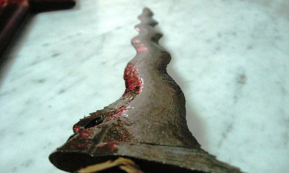

Thanks for the advice bro, it's been (& should) the practice of slight oil application blade. As for this pic, the blade had just completed the process of cleaning & traditional drying. Letting the oil seap thru within pamor while the blade is hot and letting it dry for a while before it was kept in its sheath.
