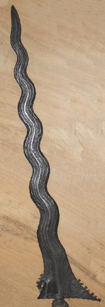

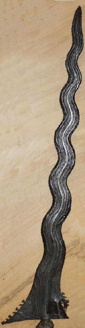

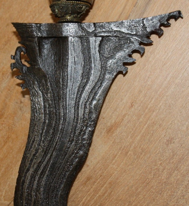

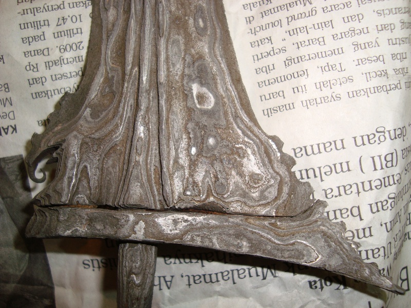

I am looking for more info on this keris. It has very distinct greneng.
Based on this greneng I have heard two stories - unfortunately very different ones....
Story one was - this is very typical for early Sumenep kerisses
Story two was - this is very typical - signature like for an Empu called Tandju Bari - supposedly early 19th century eastern Java.
This keris is one of my personal favorites in my small collection - would like to hear more opinions!

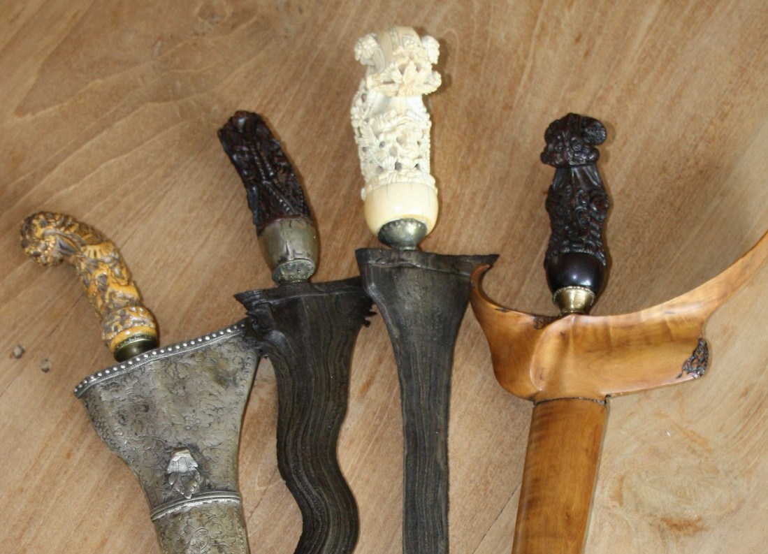

And just for fun a picture of some other kerisses from the same region!
All favorites of sorts
1 favorite sheath - very nice floral decoration on the silver coloured metal
2 one of my favorite blades as discussed above
3 one of my favorite blades (raja abela raja pamor) and handles - extremely finely carved floral donoriko
4 favorite madura total package of sheath/handle/blade/mendak

Looks like a lovely keris Erik. Unfortunately i cannot solve your mystery. I would recommend however that you post more photos of this keris that include an overall view as well as details.

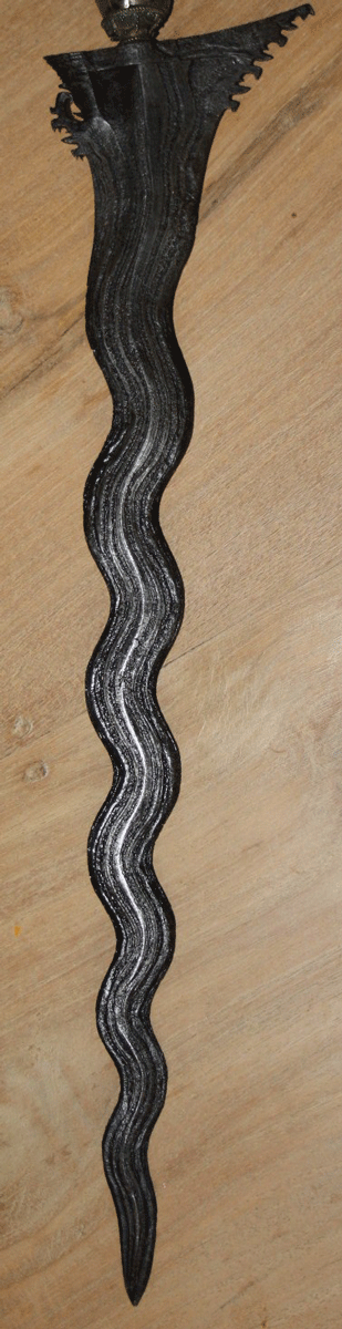

and the full blade

No ideas about the background of this blade?

Old 16th July 2009, 01:15 AM   #7
Posts: 7,230
In my opinion this is an old Madura blade.
I have taken the liberty of putting this blade into an orientation that permits me to form an opinion.
Note the way the gandik tends to lean towards the centre of the blade; this is in most cases a characteristic of old Madura blades. Combined with the forward lean of the blade,and the type of pamor that has been used, as well as the form of the greneng, I would be comfortable with a classification of old Madura.

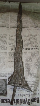

Old 16th July 2009, 01:17 AM   #8
Posts: 7,230
For some reason the photo did not upload.
Here's another try.
Old 16th July 2009, 01:21 AM   #9
Posts: 7,230
Nope, it will not upload. Might be something to do with the file type which I think is a GIF.
Anyway, to correctly view a blade the blade base should be parrallel with the ground, the gandik should be to the viewer's left, and we need to be able to see the lines that demarcate the ricikan.
The way this blade has been presented makes it upside down and back to front. Very, very difficult to form any opinion about a blade when viewed in this orientation.

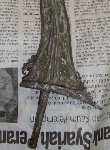

Originally Posted by erikscollectables
and the full blade
Hi Eric, I really like your keris. I have to say this keris has a very fascinating shape. the greneng and jenggot are still in a good shape. wonderful keris it is. I bet it has a thick blade couse I can see the odo-odo on it.
the odo-odo runs from the sor-soran to the pucukan ( the tip of the keris).
the pamor on its edge seem floating run along with the luks and bordering the sogokan.
a few days ago I saw a madura keris with 7 luks which also has thick blade, thick pamor and has odo-odo on it. We can see the tippical style of the gandik, the kembang kacang and hoe the first luk run from the gandik toward the middle of the keris.I manage to take the photograph before it has the warangan. here it is. the blade has 37,5 cm lenght

Posts: 7,297
Forgive me Alan, but you seem to have reversed the orientation of the blade during your photoshopping so i took another crack at it.
Old 16th July 2009, 04:15 AM   #14
Posts: 7,230
Yes David, I reversed it --- intentionally.
If I had not reversed it it would be back to front, and impossible to properly view.
You see, when you learn all this tangguh and appraisal stuff, you develop something like a set of templates in your mind, so that in order to look at a keris and form any sort of supportable opinion you measure the image against the template that is in your mind.
What I did with the original image was to manipulate it into an orientation where a proper assessment could be made.
In fact, I often do this with published images of keris before I give an opinion, but I have not previously published or explained this.

Alan many thanks for the information on the keris.
I also learned again from the discussion around how to keep the keris to study it. I did not know something as basic as that yet.
