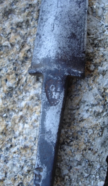

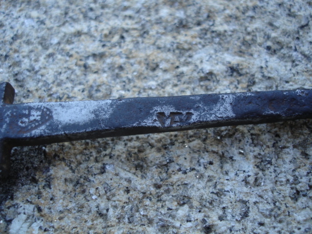

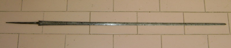

An old blade, possibly rom a rapier, and possibly from the XVII or XVIII century.
I first thought it would be Portuguese or Spanish, but someone sugested Solingen.
May any member discern where and whose these marks are from?
Thanks in advance.
Fernando
The pictures have distinct backgrounds because i had to choose them from various atempts to get reasonable takes ... allways difficult to picture tiny marks.

Hi Fernando,
I think there were a number of these types of rapier blades made in Solingen in the latter 18th century, and these turn up unmounted like this as it seems they were shipped to New Spain for mounting. I have seen these found in shipwreck remains in groupings in number.
The Solingen examples seem to usually have markings in the fuller, such as Jesus on one side and Maria the other, with Toledo type stamps. They are not on the tang as I recall, so this might be genuinely Spanish or possibly Portuguese.
Hopefully someone will recognize the marks, I'll have to dig out the usual references, as always, buried somewhere here in the bookmobile

HI Fernando,

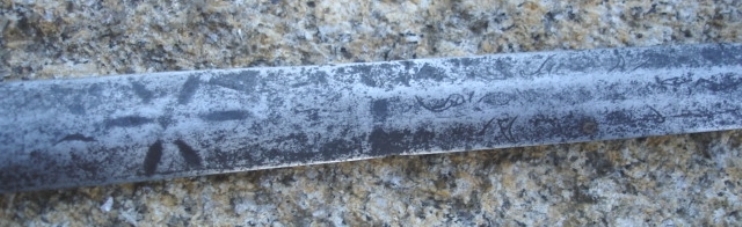

your blade is definitely a Dutch 18thC small sword blade.
(not a rapier blade; a rapier is at least 110cm long and on each rapier the fore-finger touches the blade when holding the rapier, therefore the ricasso is not sharp)
more of importance this star shaped figure has only been found on Dutch small-swords. (cf J.P Puype.... blanke wapens)

I confess i was already pondering on its shape and length, as being more in line with a small sword setup.
But the main thing is that you have identified its origin, for which i am much obliged.
Now i have the door open to try and find who was the smith.
Let me thank you again.
Fernando

Hi Fernando,
thanks
the blade type flat oval to hexagonal was very common for Dutch small swords from the first half of the 18thC. also the star disappeared after approx 1750.
the 18thC Dutch sword makers usually signed there blades not with a stamped mark but with a script. name and address of the shop see picture (jean Hosse Mr swaartveger op de vijgendam tot Amsterdam).

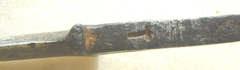

your blade has a stamp GH.
there was a silversmith named Gerrit Hoying who made a lot of beautiful silver hilts for small swords. not the blades but just the hilts.
It can be that your blade has been delivered (by another fourbiseur) to the silversmith with the initials GH.
best regards

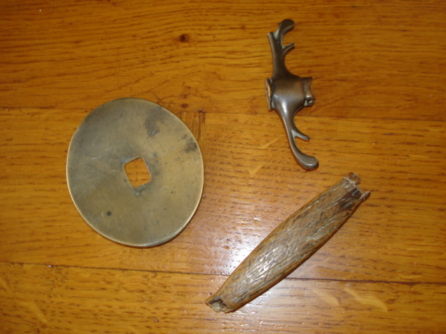

BTW, a few days after i bought the blade, the seller told me it had some ugly broken parts mounted in it and, as he 'knew' they had nothing to do with a real sword, he threw them into the trash depot. As i doubted his knowledge, i asked him to try and recuperate them, which he did, and then i found out the parts are the remnants of an actual small sword ... a humble version, but still real parts.
