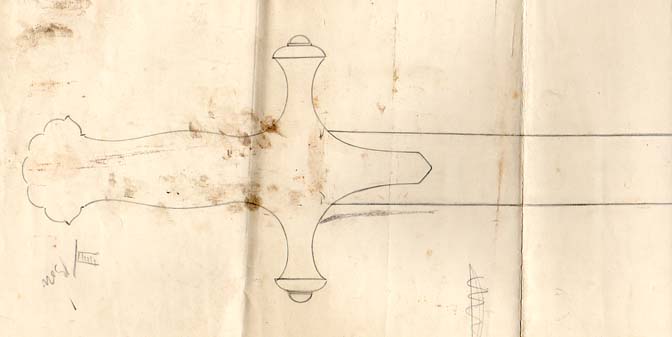

Hi,
Mr Robert Wilkinson Latham of the Wilkinson family has kindly supplied me with the following information which I'm sure some members will find interesting.
Norman.
P.S. Please download the file at the end of the post.
N.B. Mr R.W.Latham owns the copyright to the drawing/image of the Wilkinson Tulwar hilt.

Old 29th June 2009, 03:51 PM   #2
Jeff D
Jeff D's Avatar
Location: B.C. Canada
Posts: 473
Thank you Norman and Robert,
Do you have any of the measurements? I can partially see one one the boarder.
All the Best
Jeff

Old 29th June 2009, 04:00 PM   #3
Norman McCormick
Norman McCormick's Avatar
Posts: 1,618
Hi Jeff,
Try again and download the file I think it is all on this time, sizes and weights are there.
My Regards,
Norman.
Old 29th June 2009, 04:06 PM   #4
Jeff D
Jeff D's Avatar
Posts: 473
Got it!
This is great information thanks again for sharing it!!

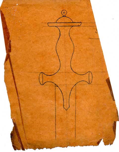

Old 30th June 2009, 08:49 PM   #9
Norman McCormick
Posts: 1,618
Hi,
Berkley, no record of Kukris made by Wilkinson before MK1V, 132,384 sword proof records, so, if individual one made difficult to tell and most probably not.
There are however details of various Presentation Tulwars made e.g. on July 1879 a Colonel Probyn ordered a ' Steel mounted mamaluke tulwar with wood scabbard and polished steel mounts' for an Indian Prince. I'm hoping more details of the presentation swords may become available in due course. In the meantime here is another Wilkinson drawing for a Tulwar hilt, R.W.Latham copyright, and an extract from a Mole catalogue. Hope you will find these interesting.
Norman.
P.S. Stats for sword re the drawing.
Hilt, pommel to bottom of langet 7 1/8 inches
Cross-piece 4 5/8 inches
Blade shoulder (hip under langets) to tip in straight line 30 inches.

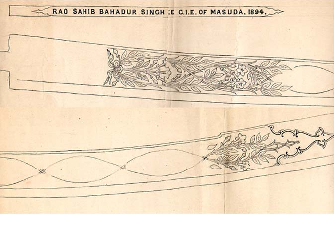

Old 30th June 2009, 09:44 PM   #10
Norman McCormick
Posts: 1,618
Hi,
Details of decoration for a Presentation Tulwar blade 1894.
Norman.

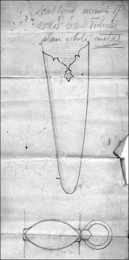

Old 1st July 2009, 03:06 PM   #13
Norman McCormick
Posts: 1,618
Hi,
An interesting drawing of Wilkinson Tulwar scabbard furniture and a partial Proof Entry from 1879.
Norman.
