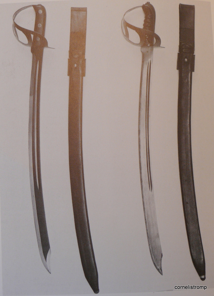

The Dutch had two types.
the left one is klewang no1 , made by A.coppel Solingen
the right one, klewang no2 is made at the Hembrug.

another solingen no. 1.
other side has a small (proofing?) crowned R mark figure. mine was supposedly captured from a german schnellboot (e-boat)
in the channel during ww2, and was apparently confiscated from a dutch supply by the deutsche kriegsmarine. the scabbard may not be the original type shown in the earlier post, possibly they got a bit mixed and matched in the armoury. i had a relative by marriage who was a royal navy officer and captained a british mtb boat at the time, so this one has some personal meaning. he lost a leg in combat with a schnellboot. the e-boat capt, apparently lost an arm, and after the war they managed to meet each other over a few beers and discussed the battle where they injured each other & parted friends...
see also the concurrent forum post here. i've also posted pics of the cold steel copy of the 'USN 1917 cutlass' which was the milsco one. i've seen an online copy of the original plans for the klewang somewhere, and milsco copied it almost exactly. i think a search here on 'klewang' may bring it up. there is also a rather nice book in dutch and/or english on the whole subject of the dutch klewang.
we have discussed these ones in great depth earlier. the history is fascinating and worldwide. the same model was apparently used by the dutch, germans, japanese and americans at approx. the same time. (the japanese shortened a bunch of captured ones, butchered the shell guard & issued them as an nco's sidearm.)

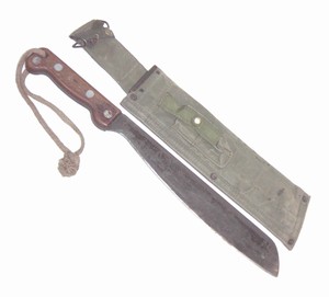

Another example, of the opposite way, can be seen in the former (1960's-1980's) British issue Golok machete for tropical area.

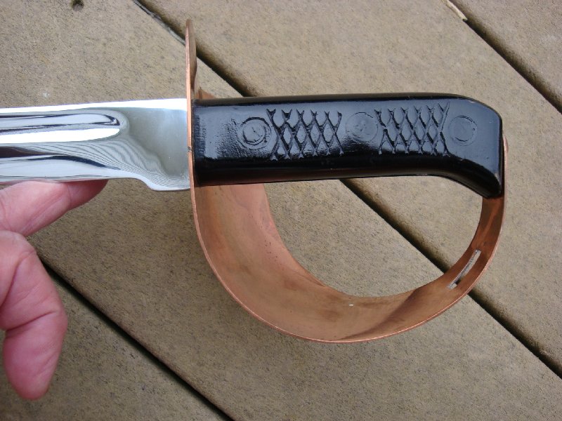

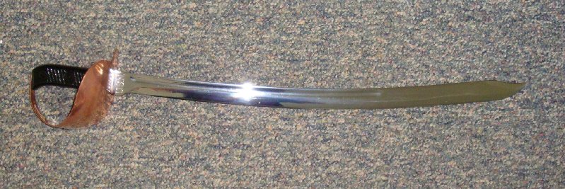

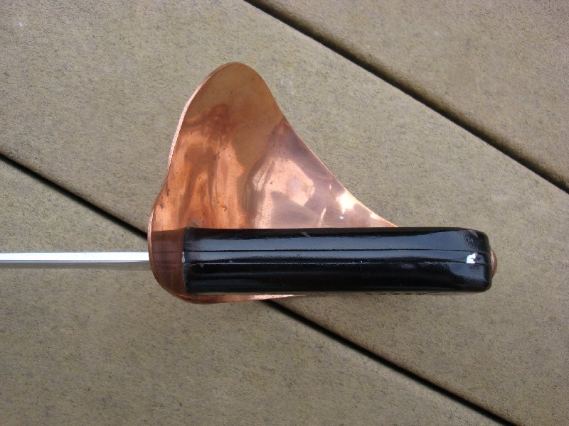

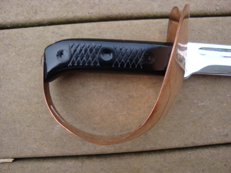

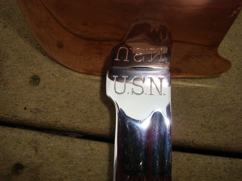

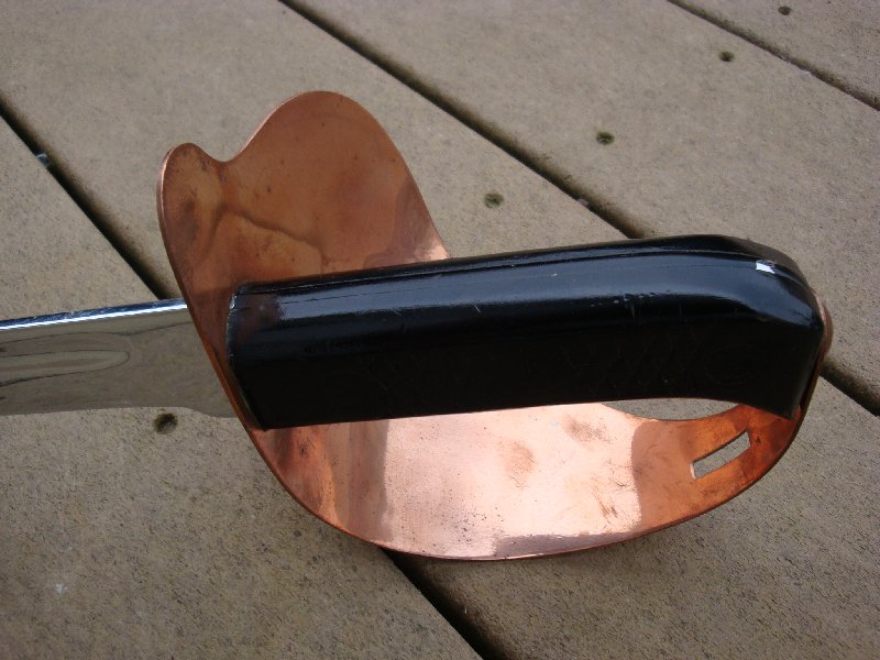

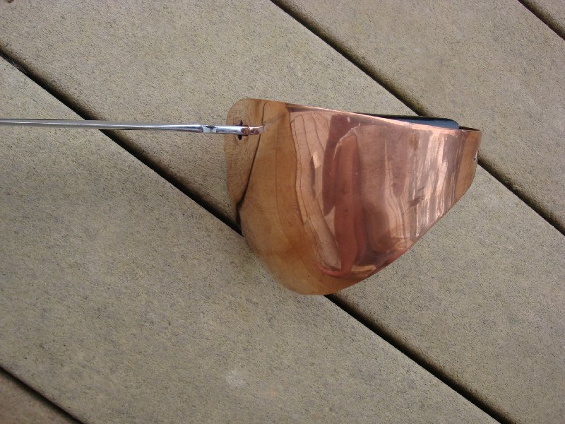

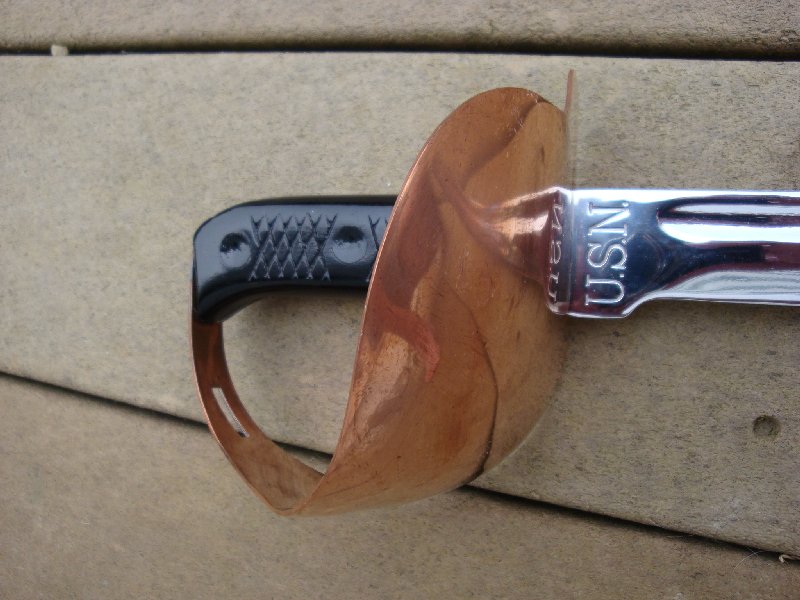

The American 1917 has the blade similar to these but the 1917 had a solid basket. What Lynn Thompson of Cold Steel lists his as a 1917, is actually the Milsco version made later in the century. I was suprised by one recently that had a copper basket and shiny blade. According to another respondant, those plated American 1917 versions were truly done up that way for parade and such.
Cheers
Hotspur; I think Mike McWatters pages still have similar information

here's a ref. on the 1917 cutlass. LINKY
while officially declared obsolete in 1949, it apparently was still in use for ceremonial purposes at certain navy schools for long after. i understand some of those may have been plated and otherwise gussied up for display value. the US Navy Ceremonial Guard in Washington, DC (Anacostia Annex) still uses the 1860/61 model of modern mfg.

The copper and nickle plated job that surfaced and a ringer of a Neumann 18th century piece that I couldn't pass up and have adopted.
Cheers
