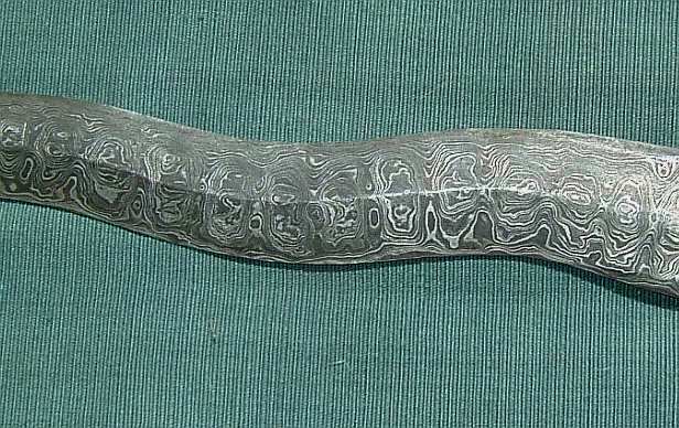

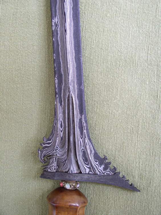

Hi Guys
This just ended. http://cgi.ebay.com/kris-knife-keris...QQcmdZViewItem
It looks more recent but of good quality it shows a nice pamor. Here are some close ups of the blade.

Old 3rd August 2005, 12:59 PM   #2
Posts: 6,436
Thumbs up Same Seller
Hi Lew , I bought this piece from the same Seller :
http://cgi.ebay.com/ws/eBayISAPI.dll...tem=6544786628
The workmanship is quite good .
I'm pretty pleased with it for new Madura work , those guys are getting pretty advanced .
Only problem I had with my piece is that the gandar had twisted making for a poor,and very tight fit for the blade . I have been adderessing this problem with 60 grit sandpaper and the fit has improved quite a bit .
Instead of that funky deerhorn it now sports an ebony Kocet kocetan .
I like the pamor on mine (it's chatoyant) , but is probably not correct for a Bali blade .
Pictures when I get my computer back .

Hey Lew, like Rick's example from the same dealer, this one is also recent and not Balinese work. There are file marks on it that you would never find on Balinese pieces. It probably comes from Madura. I do agree that the workmanship is fairly nice on it.

Hei Lew, I agree with Nechesh and Rick opinions. Your blade came from Madura, and a fairly nice piece too.
The Madura makers have fairly advanced today. Some of them have became specialists, only doing the cold working or only work on the forging process. By doing so, their mastery in this art will be quite high. Today first-class work of Madura would almost 100% identic with the Java nem-neman works, from late 19 - early 20 c. But for the Bali style, well, it is probably not that good and still easily identifies.
best regards.

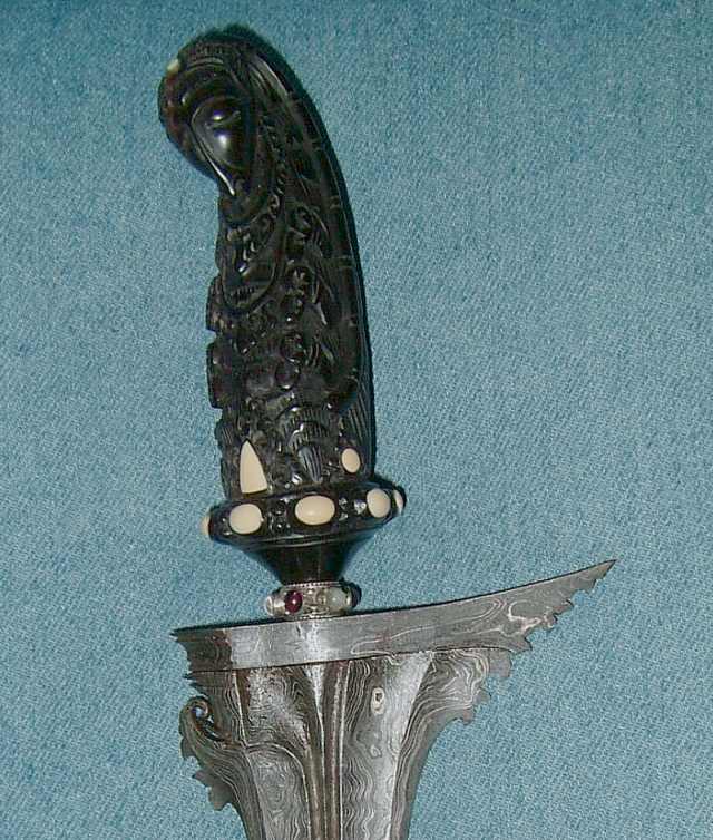

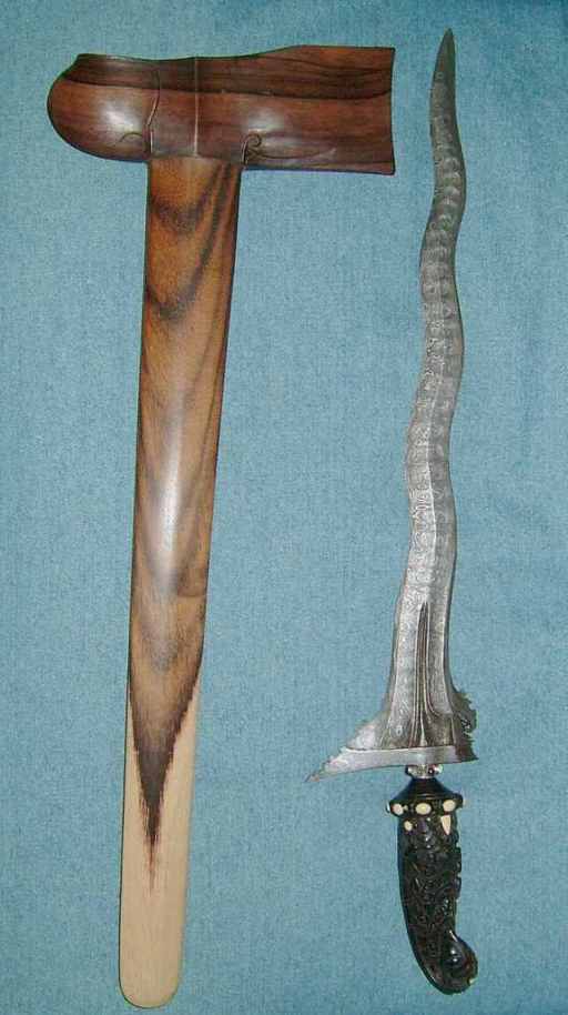

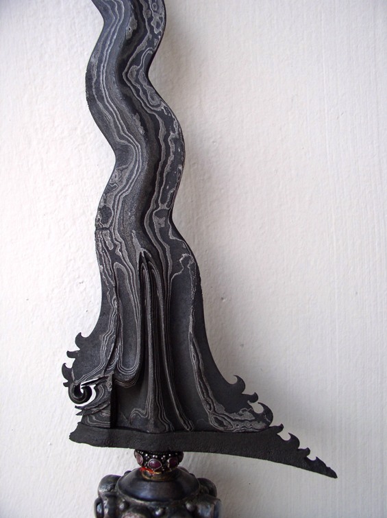

Finally got up and running again , it only cost me a new CPU .
Trying out a picture of my new Bali keris .

It's stunning! Were did you get that hilt?
Lew

Beautiful piece Rick. Also have been told the Kocet kocetan was only allowed (?) for the priests in Bali (brahmin caste) once upon a time athough it has been unclear to me why or how so. If anyone know?

Nice hilt Rick. Is that horn with the ivory or ebony? I wouldn't mind seeing some close-ups of your blade.
Mans, the pamor on your example is very intricate and interesting, but there isn't much chance of mistaking it for Balinese work. Both the dapur and the pamor don't seem right for a Balinese piece. Only the dress appears Balinese and even there they used the wrong mendak.
As i'm sure you know Rick, i don't really have a problem with Madurese perfecting Balinese type blades as long as they are not passed off as the real deal. The problem, of course, is that once they leave the smith there is little control as to how they will be presented to the collecting public. But clearly it is these Madurese smith and i believe a few in Jawa who are keeping the art alive. Sadly, it is doubtful that the very few empus that are left will be able to keep that level of keris making alive for very much longer.
I don't think this necessarily means an end to high quality keris making, but it may mean an end to the keris as a true cultural and spiritual object.

Posts: 6,436
Hi Lew,
I'd rather not say where the hilt was purchased .
We can discuss it via PM though .
John , here's a little information I gleaned from Google about Kocet kocetan .
http://www.nikhef.nl/~tonvr/keris/ke...ris_gal02.html
Nechesh , it's ebony .
I do agree with you about the loss of the x factor in the new pieces .
On the other hand couldn't a 'talent' (practioner of majik) imbue the new keris with an x factor himself ?

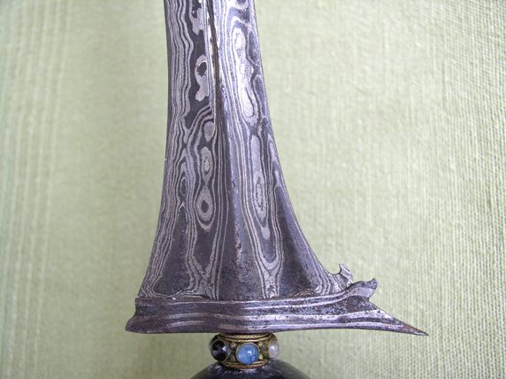

I'll try to get another picture in this post of the pamor ; it is chatoyant .
Finally , yes the auction pictures were barely adequate .
Pamor close up added :

Hi Rick,
Its a nice keris. I especially like the graceful curl of the kembang kacang and the way the jalen underneath stretches out, almost like an elephant's lips opening to receive something from the trunk.
I have been noticing kerises with a 'look' that's similar to this piece, appearing on ebay and other auction houses recently. Very interesting observation is that the pamor lines are the 'thin' sort, not the 'thick' sort I usually see. The luks also look similar - shallow, stretched out, and quite equidistant from base to tip; not quite the sort seen in the books. Finally, the sheaths on these kerises also have a similar 'look'. I can only clumsily describe it as broader vertically, but more compact horizontally. And the wood -- usually not kayu pelet.
I wonder if this sort of kerises comes from E Java instead (ok, its a guess)? Presumably E Javanese kerises have significant influences from Balinese/Lombok kerises, but still retaining some special characteristics of their own?
Old 9th August 2005, 03:12 PM   #15
BluErf
BluErf's Avatar
Location: Singapore
Posts: 1,180
Btw, I thought Rick's keris has a level higher of artistry than typical Madurese work, and the sheath is made from different materials usually seen on Madurese work, hence, I thought there may be another centre of keris crafting near Bali/Lombok that is producing these Balinese kerises. Somewhere on Easterb Java seems likely. Of course, I could be mistaken. There could be a village on Madura specialising in Balinese kerises, and they use different wood from the villages making Javanese kerises. But anyhow, just compare Rick's keris with Mans' keris, and you can see some difference in style already.
Madura or another centre of keris crafting?
One more point -- Rick's keris is more 'fine-boned' than the Balinese kerises I've seen. Not in terms of finese of work, but it has this compact feel, like something between a Javanese keris and a Balinese keris.
See below for examples of 'thick-lined' pamors on Balinese/Lombok kerises I have.

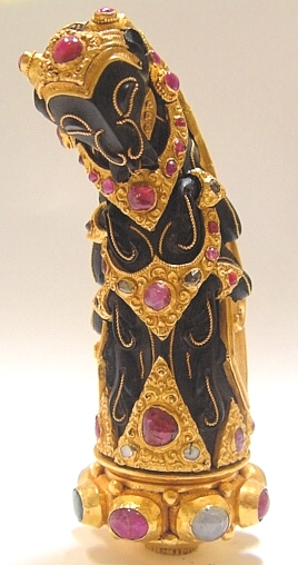

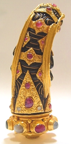

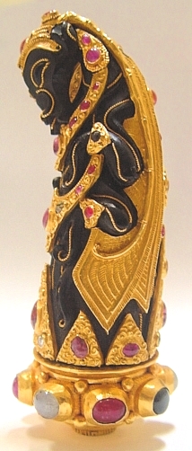

Gentlemen
Here is what a good one looks like.
Mick is offline   Reply With Quote
Old 10th August 2005, 06:33 PM   #20
BSMStar
BSMStar's Avatar
Join Date: Jan 2005
Location: Kansas City, MO USA
Posts: 312
Default WOW!
Originally Posted by Mick
Gentlemen
Hey Mick.......
Just in case you hear any noises.... that was me having a heart attack!!!
A gorgeous hilt!!!!!!!!!!
BSMStar is offline   Reply With Quote
Old 10th August 2005, 06:51 PM   #21
Posts: 6,436
Very good indeed Mick !
Would that I could afford such goodness .
Old 10th August 2005, 10:02 PM   #22
nechesh
nechesh's Avatar
Location: Cincinnati, OH
Posts: 940
Hey Mick, i think you should qualify the use of the term "good one" here. Maybe "here's what a nice gold and bejewelled one looks like"
Frankly, i find yours a bit too much for my tastes and much prefer Rick's. This would also be an incorrect hilt for Rick's blade (but then so would Rick's since this isn't a priest's blade ) as it far outshines the blade itself. It is, however, beautifully executed and i thank you for showing it.

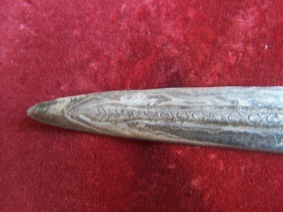

I've only become a member today. I am a sword collector and by chance got in possession of I think a beautiful Keris Bali with a silver/gold? Brahmaan hilt. I am preparing some pics which I will put on the forum later so hoping that you can give me some more interesting details. I think it is more than 100 years old and what I am most curious about is if the Brahmaan symbol has often been used as a hilt for keris. Myself I have done some research on the internet but couldn't find any keris yet with such a Brahmaan (Brahmin) hilt.
thanks.
Rocarnice is offline   Reply With Quote

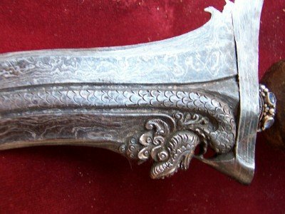

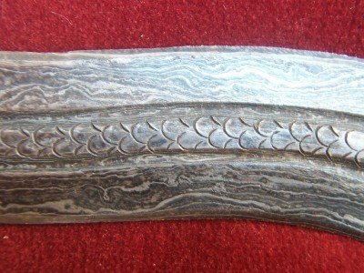

Hi Rick,
Here are some pics, hope they're of good quality in order to do a first assessment. Please let me know if more pics are necessary, for instance of the blade... Thanks

Hi Rocarnice, pretty looking keris you've got there.
The photos aren't great, but i would hazzard a guess that this is a fairly recent creation, especially the hilt. This isn't to say it doesn't have value and the silver, gold and all those stones are very nice.
I would also bet this is not a Balinese keris, inspite of it's initial appearence. The kinatah work (gold) on the blade does not look like Balinese work (i think only very few Bali keris have kinatah at all and those patterns and execution are different) and the keris does not appear to have the type of polished finish which is common on Balinese keris. Perhaps another recent Madurese blade? It is possible that the blade is older and it's just the kinatah that's new, but for somehow i doubt that. From the last photo it appears to have that even wear finish that is common on artifically aged Madurese keris. This looks like the type of flashy keris that is created to attract the western collectors. Pretty and certainly worth it's weight in gold, silver and gemstones.
