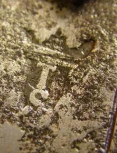

Can anybody tell me more about those maker marking? German?

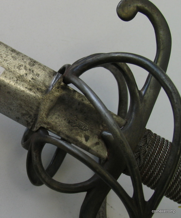

All the Original 2 character Toledo marks have the name Character above the Town character (T for Toledo as the lowest character).
(This is also copied by Wolfgang Stantler, Muenchen).
your mark can be the mark of Clemens Tesche Solingen 17thC or Wilhelm Tesche Solingen early 17thC, it is published that they both have copied Toledo marks (Alonso de Sahagun, S under crown, Tomas de Ayala ST under crown).
The name of the maker T(esche) above the town mark S(olingen) makes sense if they copied well.
I think the type of the hilt and blade can give more outcome, can you place a
picture in this thread?
best regards

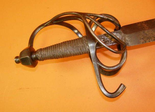

Here it is.
Is that the so called muenchen town watch sword?

Posts: 1,071
Wink
HI,
100% a German Sword, those swords are also made in other German cities,
I think stantler initiated those type end of 16thC in Munich.
your sword is a (later) variation of the town watch sword.
the pommel is atypical for what you would expect at the Munich town watch sword and the sword can be dated a bit later 1625-1640.
(so difficult to proof but it can be made by Tesche Solingen as mentioned in my previous reply, .....................it also can be not)

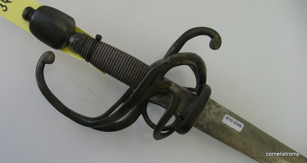

I found a Town watch sword for your reference with the characters reversed (as the Toledo Tomas de Ayala and Wolfgang Stantler marks)
regards from Holland

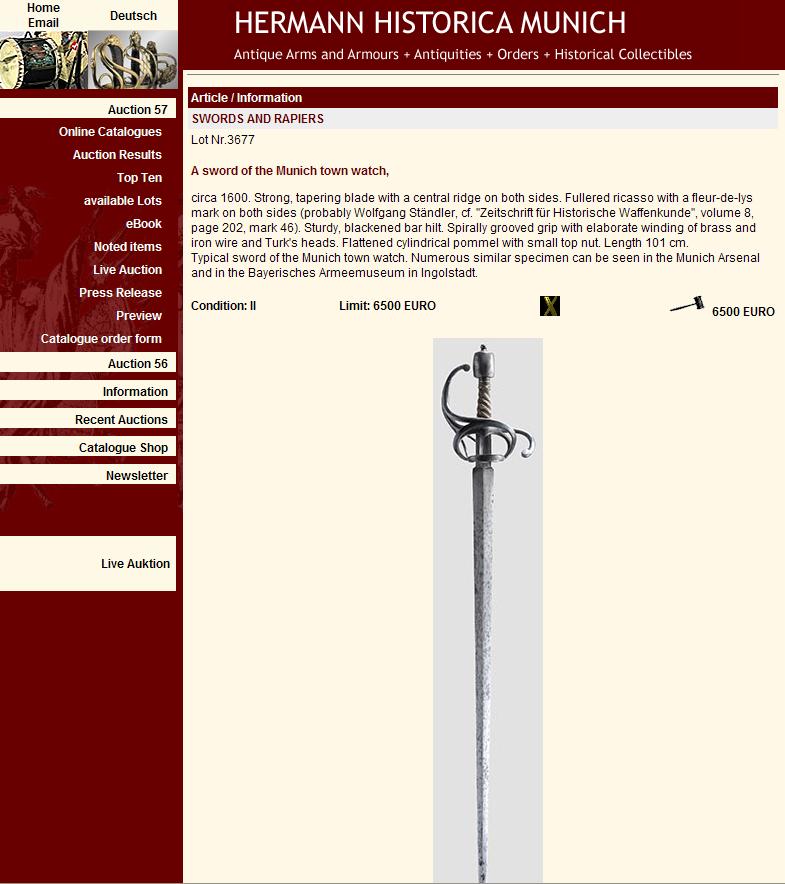

Rembrandt's night watch the compagnie of Frans Banning Cocq was painted in 1642. The tasks/power of the schutters was already reduced to control the streets in the evening and nights. Due to frequent misbehaviors of those schutters during the night duty all the tasks were taken from them a bit later.
I understood the German Munich Town guards/watch were formed after a military model and were all provided with the same armour and a Stantler type town watch sword/rapier. Maybe Michael can tell us more about this.
for this sword type see the last auction of
http://www.hermann-historica.com/
lot 3677
best regards

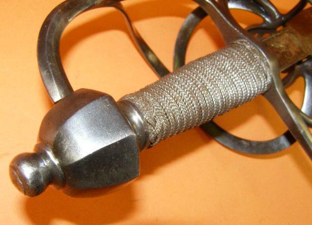

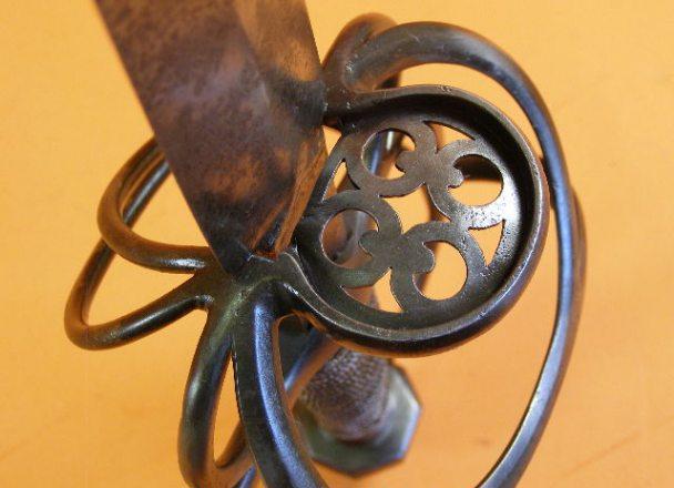

Posts: 692

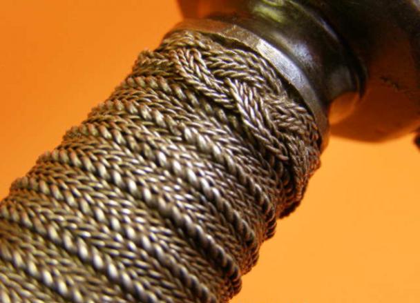

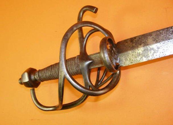

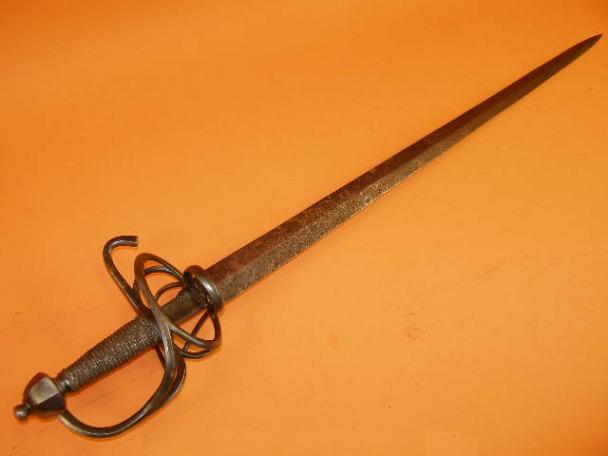

Gents, many thanks to all of you, especially to cornelistromp, for your research and comments.
Having that gem in my collection, I've became somehow interested in that field. Can you advise with some literature?
Thank you!
Here are the rest of the pics:
