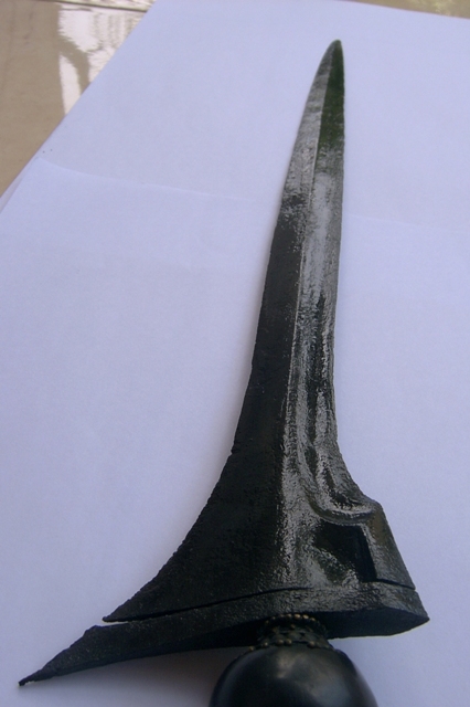

recently got this pamorless keris.
I always wondering about kelengan keris, and finally I got one.
I've been trying to find out whether it has a hiddden pamor. the result comes to zero, but I found small area in the middle of the blade surface showing tiny little materials ( like a very smooth sands). what is it? .
the new warangan work seem just fine.

I'm quite pleased with the warangan work.
the black colour seem strong and deep. specially after I put some keris oil on it. I took tho pisture immediately after the oiling, and it result nicely.

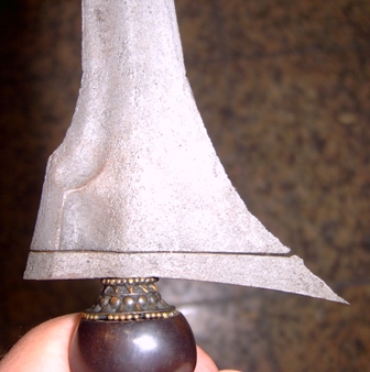

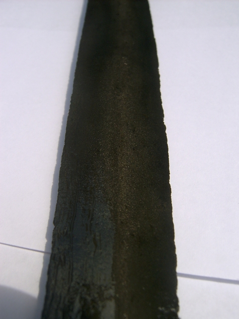

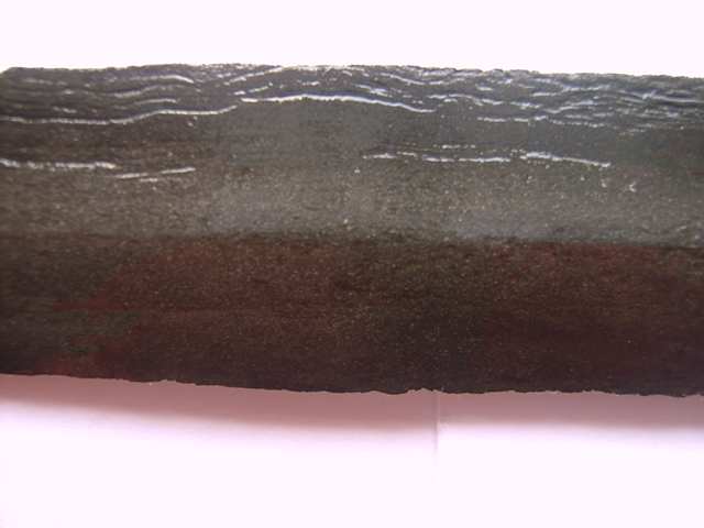

here are some pictures before the warangan process. I hope you all enjoying the picture as I do.
the third picture shows some lines as a result of the forging process.
really love those lines. I've been looking for keris with lines.

the 'sand' like appearance you see is just the crystal structure of the steel/iron revealed by the etch. Probably a forest of pearlite crystals. Nice blade.

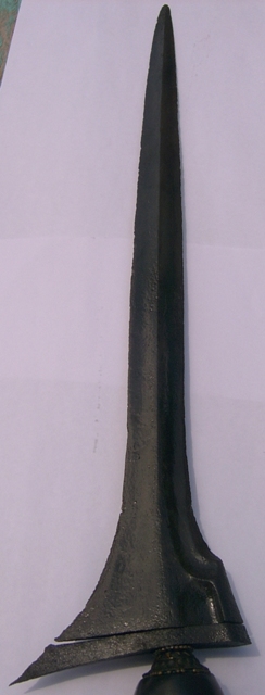

Ferry, I know you to be quite knowledgeable in the field of keris, you have this keris in your hand, and your opinion is that it is early HB.
However, I would ask you to consider this:-
is it legitimate to give a kraton based tangguh to a keris that is obviously of far less than kraton quality?
is it possible to give a supportable opinion in respect of tangguh when we are dealing with a keris that lacks many of the indicators that we would normally use to establish an opinion?
is it possible that we are looking at a keris that might be able to be categorised as Kajoran, or perhaps Godean --- or maybe, just maybe, Palembang?
I myself am not prepared to offer an opinion on this keris, simply because it is far too difficult to form an opinion from just a photo. I cannot accurately appraise the pawakan, I have no idea at all of the tanting, I cannot feel the texture, I cannot see if the ganja is sebit ron or nguceng mati, I do not know the form of the sirah cecak---its just too hard from a photo, especially for a blade like this.
What I think I can see is what appears to be a fairly substantial blade with a sharply defined ada-ada running full length of the blade, no kruwingan, a square blumbangan, a ganja with a mid line curve, but a small and harsh tungkakan. This is sufficient to point my mind along a certain road, but at the end of that road there are a number of gateways. I do not know from the photos which one to choose.

Hai Alan, I finally got your attention.
I define the tangguh to be early HB since its original warangka is a Jogjanese brangah. sorry I didnt include the warangka ini the picture.
I also understand its very hard to judge tangguh using photograph.
we must feel the surface, the tantingan, etc.
I try my best to provide these good pictures for us to discuss.
I rarely meet palembang keris. the last palembang keris I met is much much thicker with sharply defined ada-ada which is also running full lenght of the blade. using a kinatah gonjo, very beautiful keris ( a saw the keris 2 weeks ago) .
I hope this discussion would continue a bit longer. I really apreciate any opinion about this keris. I try my best to provide a decent keris to be discussed.

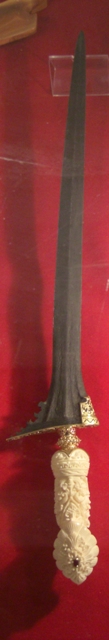

I found a comparison palembang keris for our further discussion.
how do you think?
ferrylaki is offline   Reply With Quote

Looks like a nice keris.

The anak alang above is very nice, but is rather unusual in the context of Palembang. Anak alang forms are more commonly found in Central Sumatra, worn by the Minangs, but even then, the anak alangs are of slightly different form and generally not as refined as this. Note that the hilt is new ivory, and the bit of sheath I can see on the top left corner seems to show a Palembang sampir's although it looks also a bit stiff. The hilt form does not match that sampir form. This in turn could suggest that this keris is a put together, and I do not rule out recent 'enhancements' to the keris. In which case, the use of this keris for comparison is not 'safe', in my opinion.
