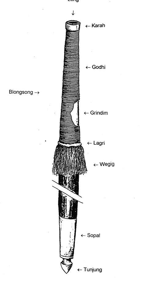

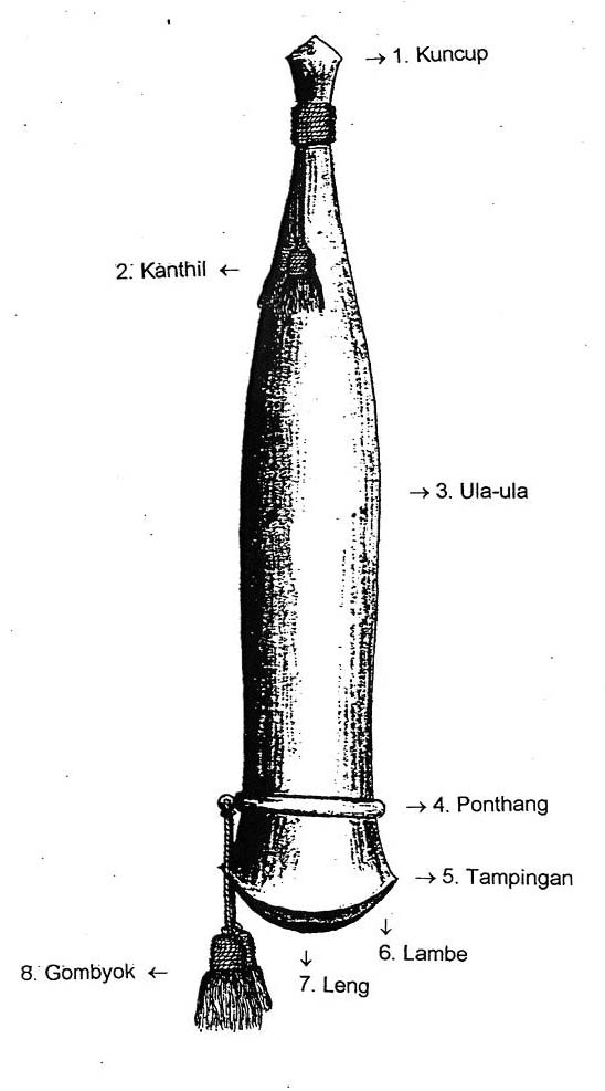

Freddy,
It is a tombak. The scabbard is the scabbard for a spear. I think you should remove the leather and I think a tombak scabbard will appear. of course I'm not 100% certain because i cann't look and feel through a picture. But the leather is not original and maybe some european owner before you had nothing to do on a rainy evening. The grip isn't an original either. I think the tombak came with the scabbard but without a the shaft. If the scabbard is a tombak scabbard it was mounted as a spear. The shaft could be a long one or a short one.

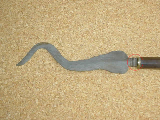

It is a tombak. Henk's pictures does illustrate the features of the scabbard and shaft. The red circle is a feature of a tombak. Normally, the tang (pesi) is longer than a keris blade. I've seen pieces with the tang almost half of the blade length.

Alam Shah is right about the tang. I have two tombaks that have a peksi as long as the half of the blade length. If it is possible for you to let it perform, it needs a good wash. I bet you will get a beatiful pamor out of it.

The dapur of the tombak is a variation of Banyak Angrem or Panggang Lele. These are some of the artistic tombak form. Most of these tombak are found in the Pajajaran period. (I'm not implying that this is a pajajaran piece, but merely when many of these were produced ).
Due to it impractical form for combat, it is not meant to be used as a weapon, but rather prized for its talismanic properties and as a pusaka.
