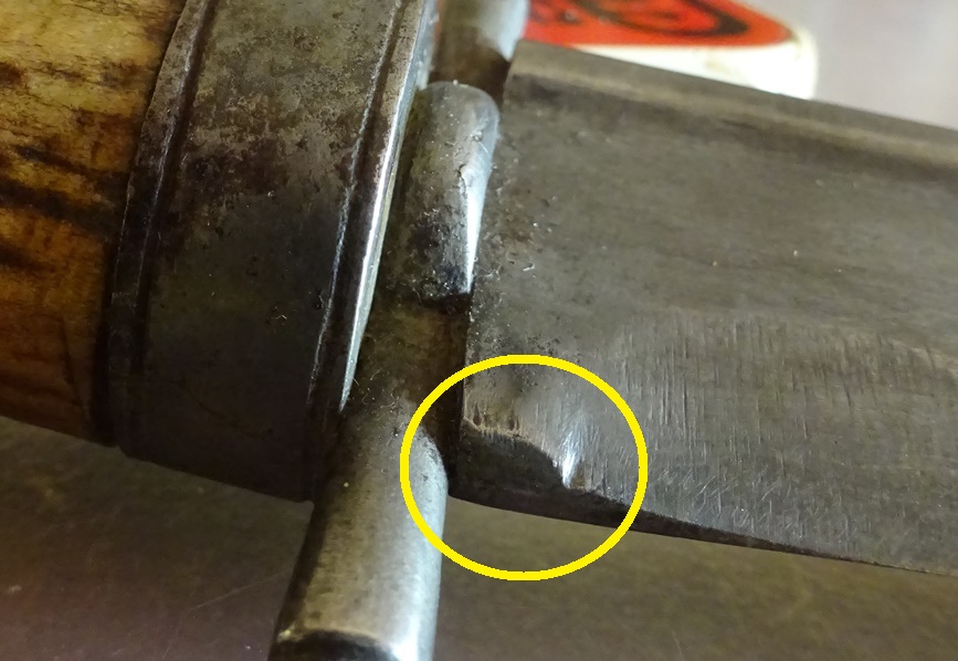

Default A hunting knife for comments

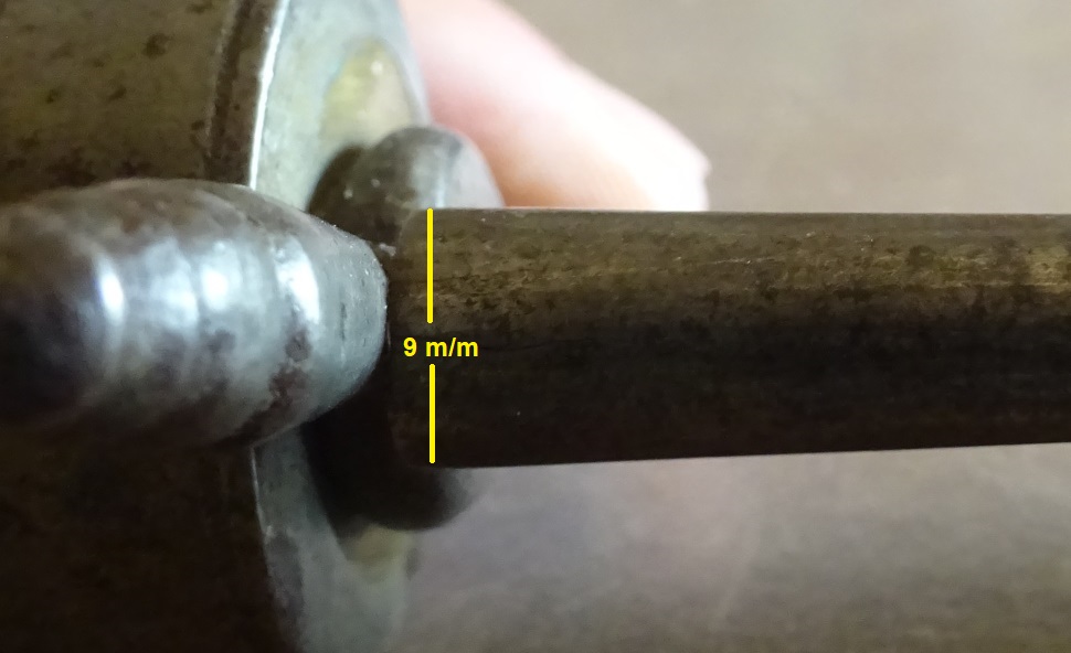

I wonder if, by the pictures and details, you Gentlemen could tell me where this one comes from and its estimated age. In fact judging by the scabbard i would, within my limitations, place it in the (end)18th century. On the other hand, i see by some marks on the leather in that, the locket had a previous fixation, of one centimeter distant from the present one, which i would not assume this scabbard to be from a different knife but an 'elongation' of its length due to leather extreme shrinkage ... if you Gentlemen agree to that.
I am less surprised with the blade deep wide fuller than with is strong roundish back, both stopping less than 1/4 from the tip.
It would be so nice to receive your comments.
Blade length: 26 cms.
Total length:37 cms.
Width at forte: 37 m/m.
Thickness at forte: 9 m/m.
Wight: 357 grams.

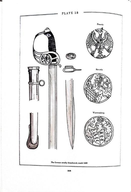

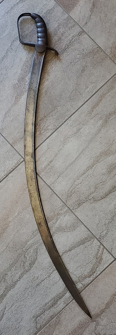

Just to add a few things, blades of this type cross section were often referred to as 'pipe back' or 'ram rod' and seem to have first appeared noticeably in the latter 18th into 19th c. in England. This was a period of innovation as types of blades and sword patterns were being tested and becoming the first of various regulation patterns there.
The ramrod (pipe back) blade I have is unusual in that it is dramatically parabolic in its shamshir like curve, and is an early variation of the M1796 light cavalry saber, probably c. 1795-1805.
These ramrod blades became popular on a number of British sabers, but as noted it did become known on M1822 officers sabers for infantry and remained on many until c. 1840s.
Interestingly, this 'pipe back' type blade reappeared in Germany on swords from c.1870s along with the 'yelman' tips (expanded point).
The fabrication of this knife, recalling the 'hirschfanger' (hunting sword) form of Europe, primarily Germany with stag horn suggests of course possible repurposing there. The scabbard seems fashioned out of a military type which indeed does resemble British examples, except with the carry ring on the throat.
With these things considered, it is hard to say exactly when and where this was fabricated, but these notes on the components are established.
The photo is of the parabolic saber with ramrod blade c. 1795-1805
The images of German cavalry sabers are from "Cut and Thrust Weapons", Eduard Wagner, Prague, 1967, and the blades are described as 'round back'.

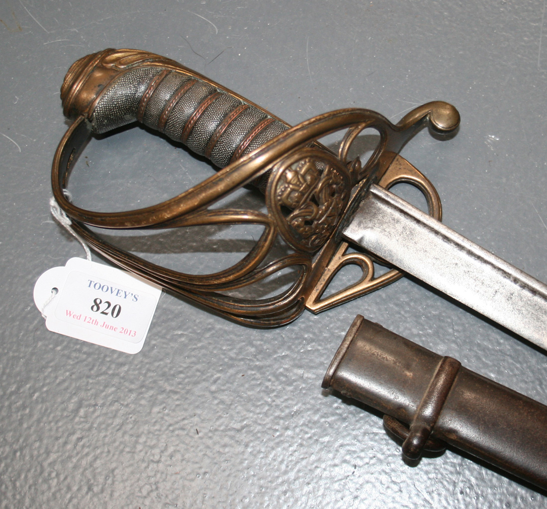

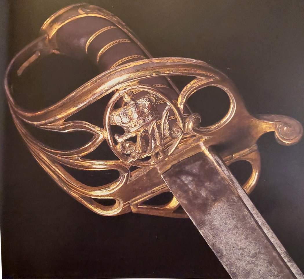

Old 6th November 2021, 08:15 PM   #10
Default Coincidence ...
Thank you for your input, Jim.
As a curiosity, let me here show the Portuguese version of the 1822 pipe back, mounted with a Queen Dona Maria II (1834-1853) guard.
It is said to be known that, despite its round back (cota) this sword pattern was fragile. To confirm that, this specific blade was (also) broken by one third of its extension.
(Courtesy As Armas e os Barões by Eduardo Nobre)

Old 7th November 2021, 07:05 PM   #12
Default Broken blades ...
... Interesting that these were regarded as 'fragile' but these primarily infantry swords were actually never thought of as particularly 'combat' oriented...
Jim, do you mean to say that infantry swords were not meant for combat, or this pattern in particular ?
Call it a flaw from the abovementioned book author but, in fact, Queen Dona Maria II reigned twice, the first period between 1826-1828, ended by an uprise followed by a Civil War, that lasted until 1834.
This would give place for a 1822 (pipe-back) sword hilted with this Queen cartouche to be present in such episodes and break in combat; or as well be broken for another zillion reasons.

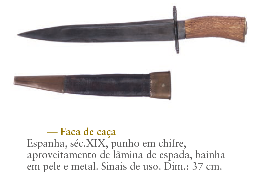

Default At last ...
I would like to say that i found the support text of this item when it was last included in an auction.
"Spanish, with a repurposed sword blade".
Judging by the fact that also the Spanish had their version of the 1822 pipe-back, it all makes sense ... i would say.
Old 9th November 2021, 03:53 PM   #16
Posts: 10,736
