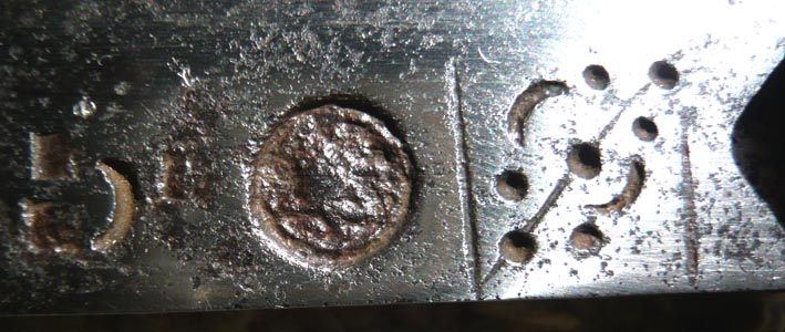

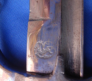

what I'm seing .... is a stamp ...
stamp for blacksmith, I suppose
unfortunatly, if it's looks a little bite like letters,
it's just a design without signification
I mean for arabic readers or speakers
those stamps may be find
on tin objects
or brass coffee pot,
even in silvery
not strange to find stamp of craftsman, or blacksmith
stamp could be ;
- initials
but also design;
- "lion" for Assad Allah for instance .. famous Irako-Syrian blancksmith for blades
Rgds

Thank you for coming in on this. Very interesting comments on this stamp, and the reference to the familiar Assad Allah stamps on many of the trade blades which became commonly used in so many regions.

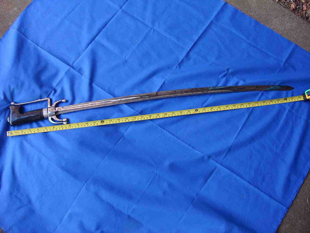

David, may i have the size of the blade only, the thickness of the back and if possible a close-up of the blade showing the fuller. The shape looks very near from one of mine.
As for the stamp, never seen this round type in maghrig craftmen markings. In fact, only Morocco should be seriously concerned, but for the barrels stamped sometimes with test and factory's marks (little square stamp of Tetouan, ...) . The stronger way may be a craftman'mark...

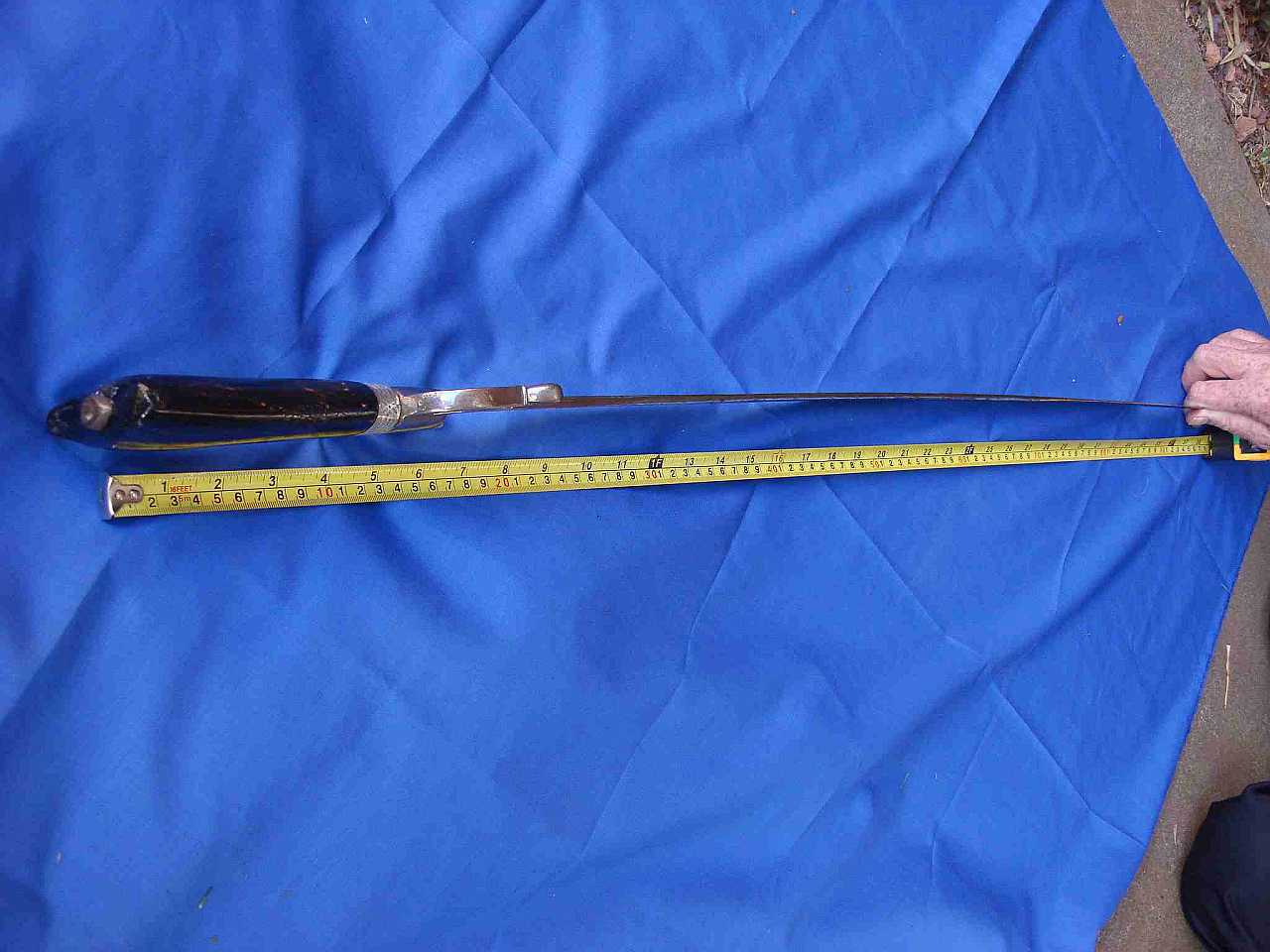

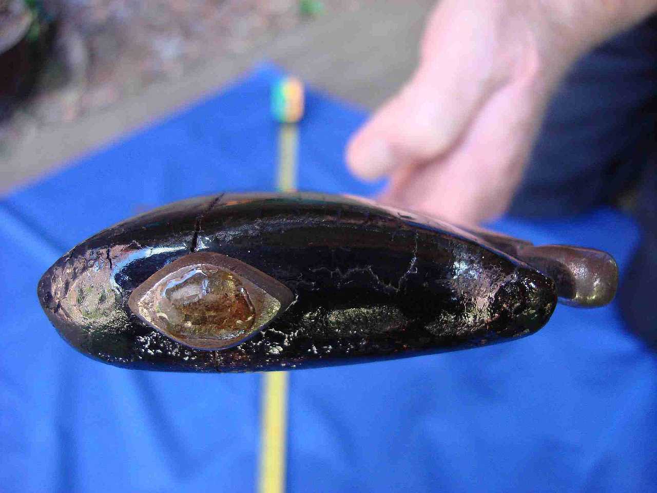

1. the length of the blade from where it attaches to the hilt (correct term?)(along a straight line so not allowing for the curve is abour 80 cms

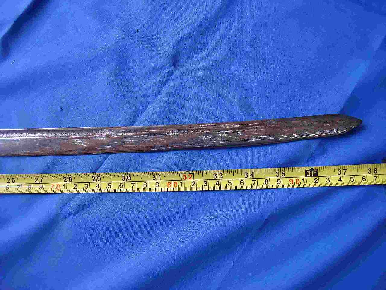

2. The fuller is (sort of) shown in pic called "sword13" attached. It ends about 8 cms from the tip of the sword
3. The best I can do on the 'back' of the sword is the attached photo "sword12"
4. I have added another photo of the 'butt' of the sword if of any help.
Many thanks to you and all of you who are helping me.....I cannot express properly my thanks and appreciation. I love how you are so passionate about this subject (mine are French & English antiques, golf and wine....different but as long as one has a passion for something then that is fullfilling )

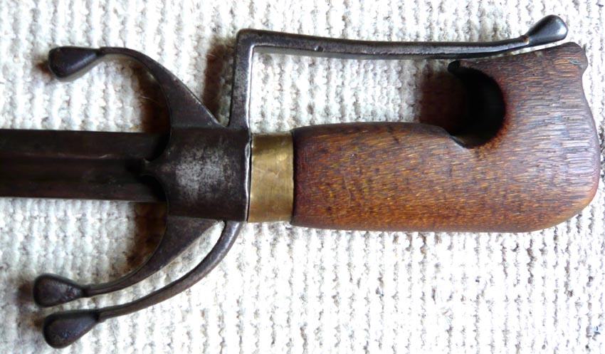

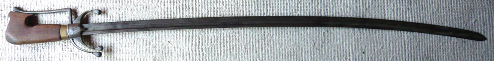

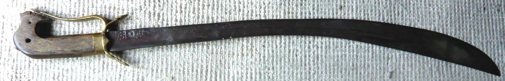

Length of mine (see images 1 & 2) from guard to tip is 90cm.+/-, so it's longer, but a same blade's profile. I wonder about the black color of your hilt (seems painted...) What is it ? is that wood under this color?.
As for the marking, it seems to be as like a stamp of a craftman, not translatable and i agree with Dom.
I have the same problem with this sa¨f-nimcha made in Zanzibar for Peninsula (Oman). As you can see, it is a short & heavy blade done for maritime purpose.
It illustrates perfectly the term NIMCHA - short blade-.
I would say with prudence that usually a cavalry nimcha from Morocco has a pure long blade without any markings. i observed that difference is done by embellishments of the guard (koftghari) or of the ring on the base of the handle (silver) and of course of the material of the hilt itself (rhino horn, ...) and of the scabbard. Otherwise , they are very sober.
What is different is the use by the pirates ( bararesques ) of nimcha with foreign blades.

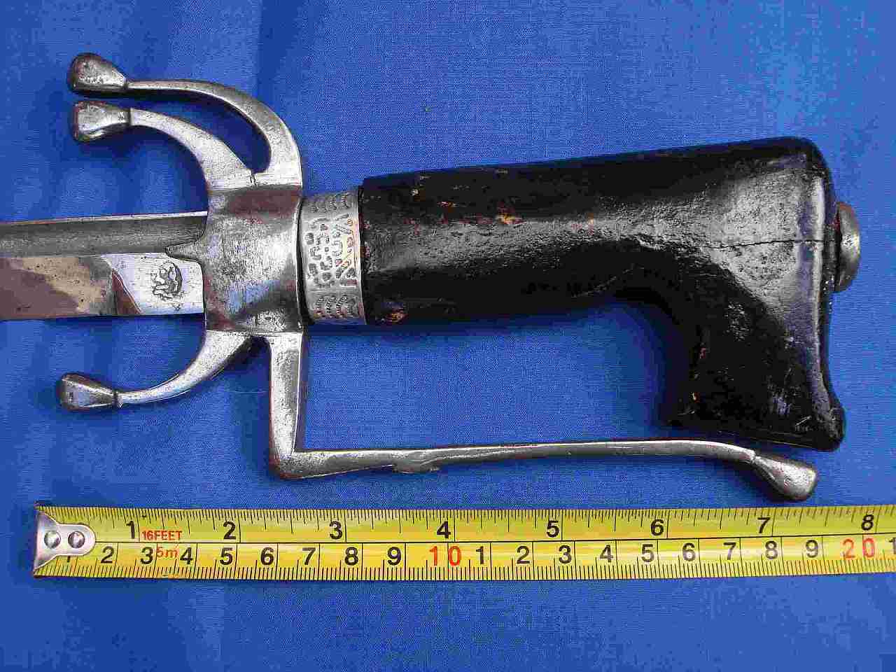

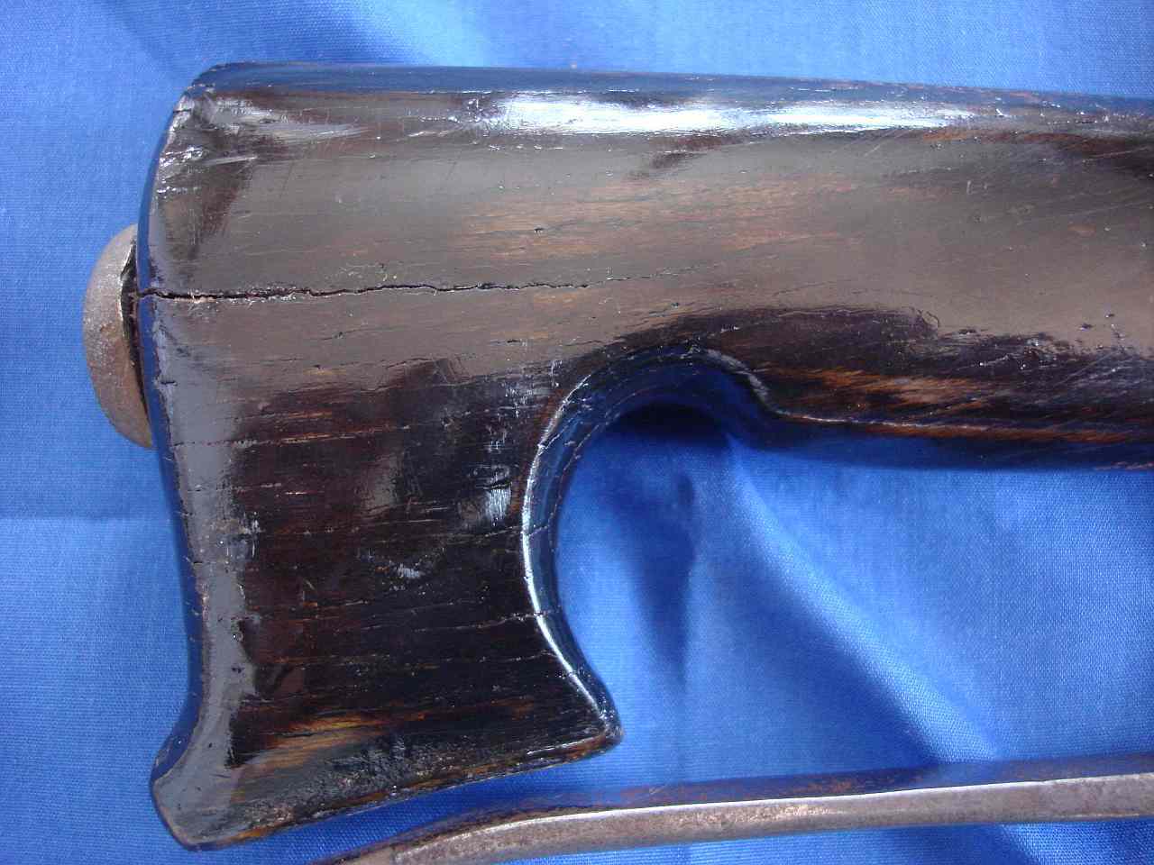

The handle of this nimcha is just lacquer that has been burned. You would have to strip it to find if it is horn or wood. Regarding weapons workshops in Morrocco they are there and were in some of the larger cities. The french,portugese,and spanish have all invaded sections of Morocco at one time or another. Some of these european blades yes were captured in conflict but it is more likely most came from trade.

My apologes for the delay. I think I said in my first post that the sword was in a house fire approximately 40 years ago here in Australia. My initial logic had been, "if it is a wooden handle it would have surely suffered more damage than I can see.....so maybe it is bone/rhino horn". Not that I know what sort of grains horn material has! However, looking at the photo attached I'm now leaning towards wood. Any thoughts anyone please.
Thank you "Ward" for your info on the covering being burned lacquer. Were these handles originally lacquered??

In reviewing the excellent work that Louis Pierre has compiled on the nimcha, there is an 18th century example identified as Moroccan, which has similar blade form, and a stamped mark similar to yours in like location on the blade.
It would seem to further emphasize the Moroccan origin and of the correct period.
Also, in looking at the interesting style of the blade sectioning, there seems to be a particular 'stepped' effect that reminds me a great deal of the blades found on the 'koummya' daggers, also Moroccan. While these, like the nimcha can be found in use throughout the Maghreb as far as Tunis, the key centers for manufacture were typically in Moroccan regions.
A note on the lacquering, in my experience, very old weapons collections often seem to have swords etc. painted over with lacquer, as a preservative. I have seen many extremely old swords covered in yellowed lacquer as they were auctioned from very old estate sales.
Whether horn or wood, I would defer to Louis Pierre or Ward, but it is my impression these hilts were usually with horn grips.

As for the hilt, usually they are horn made. Those with rhino horn (imported from sub-desert areas) were mostly reserved to sultan's guard (as for Koummiya hilts) and officers or special order for rich people.
So, David, I suggest your hilt is not wood but horn or rhino horn (they resist better to high temperature). Easy to know it you sand smoothly your hilt.

Regarding laquer do not sand you will lose the patina underneath. use a little acetone on a rag and it should take it off. If it is resistant soak it for a few minutes it will get sticky at first and then you can rub it or use a toothbrush with it gentle cleanings are much better than sandings.
