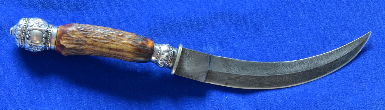

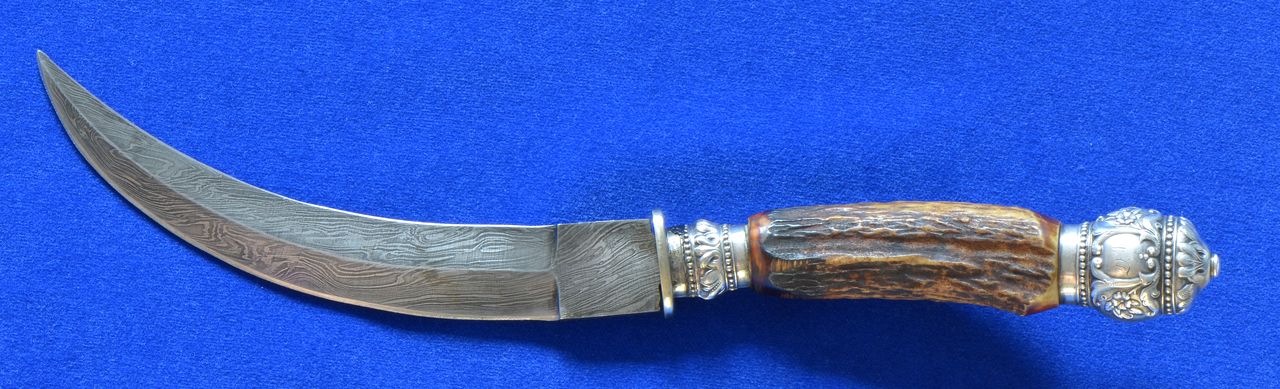

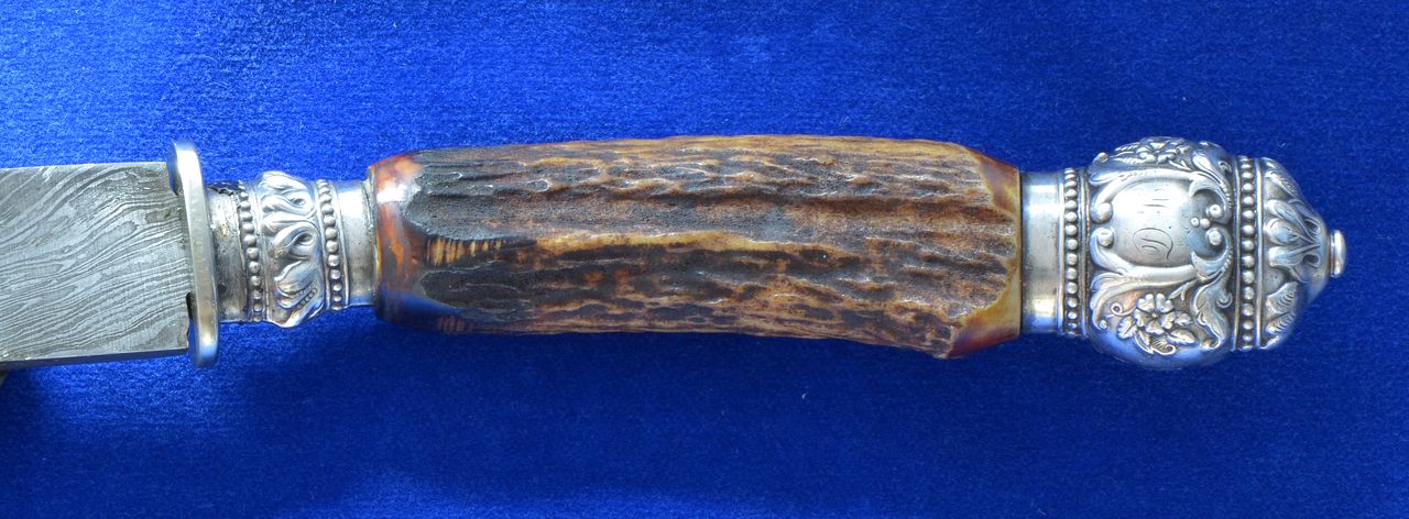

Hi all,
here is an unusual pattern welded curved dagger of european origin. According to the description the dagger was made in Sheffield. Length is 33 cm (13"), blade only 17,5 cm (7"). No markings at all, except the initials "DK". The massive silver pommel is a good counterweight to the heavy blade. The handle looks strange curved but lies very good in hand.

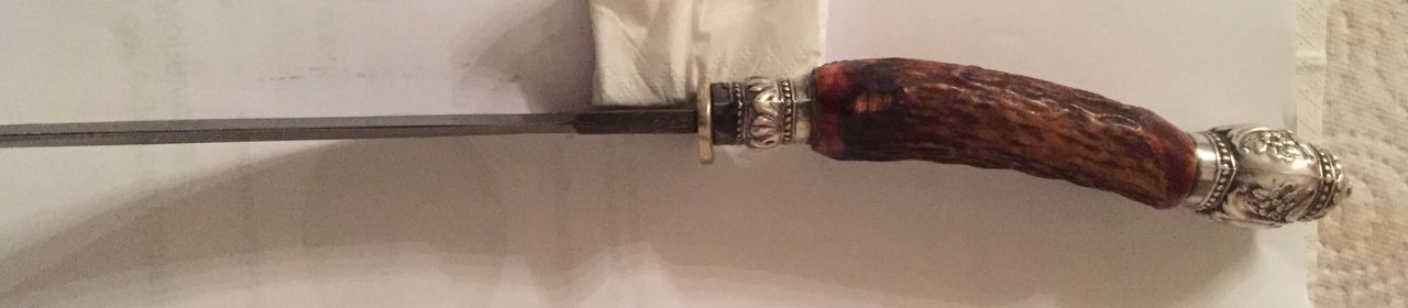

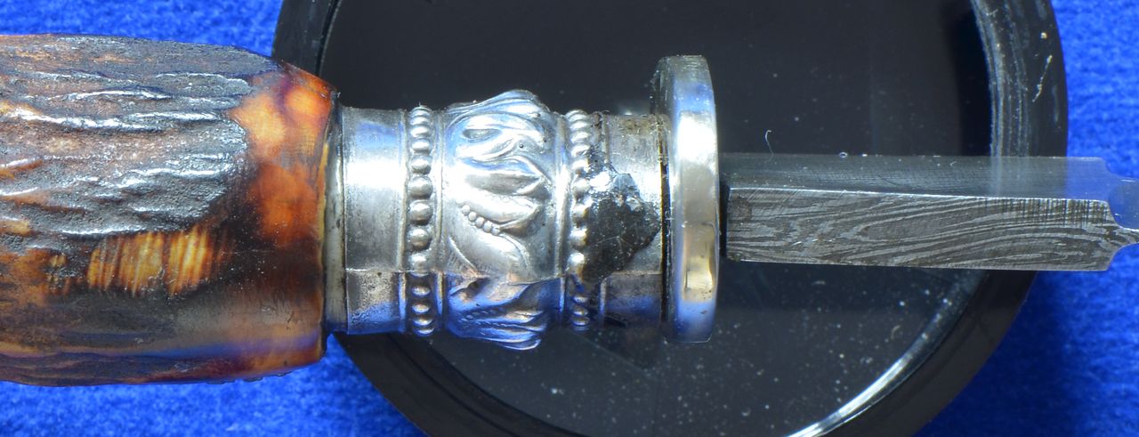

One picture shows some remains of black laquer, which indicates some decades of age. I think the dagger was made before WW1, around 100 years ago or more.
I hope, someone can say more. The only thing I could found is a similar hilt from Sheffield and late 19th ct..
Hope you enjoy the pictures.

I would be very surprised if this blade / handle combination had been made in Sheffield in times past . It would be very surprising if a Sheffield maker of a knife blade of this quality did not put both their name and Sheffield address on it . Additionally it is most unusual for English knives of the 19th century to be curved . There is also no crossguard , something which would never be the case in an English dagger , but would be typical in a domestic table cutlery carving knife . The marked curve of the handle is typical English carving knives of the late 19th century , affording a very postive forward grip required for carving a joint of meat at the table. This may be a European knife , I dont know, I have no expertise in non-British European knives of this period , but to me it looks as though it could be a relatively modern blade that has been married to a good quality Sheffield 19th Century carving knife handle ..... along the lines of the handle of the one in the photograph below ....

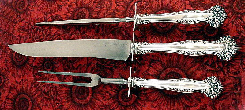

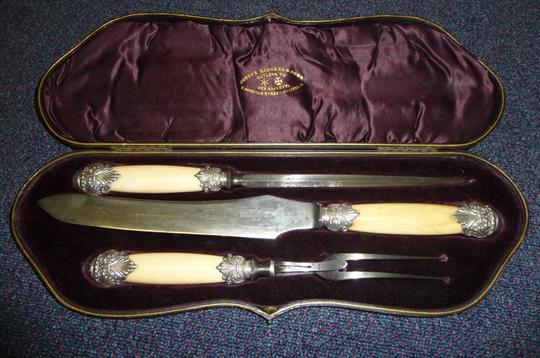

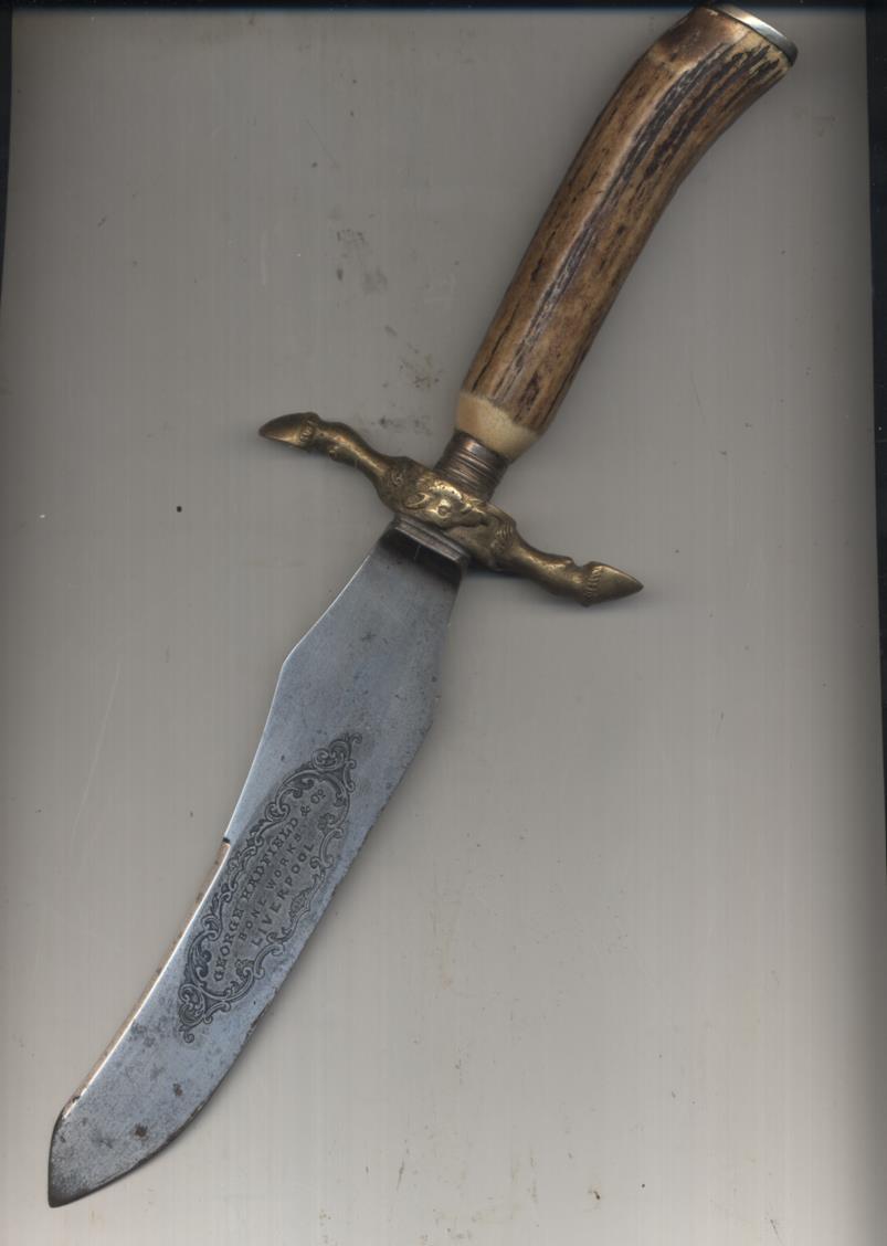

here is another example of a Victorian Sheffield carving knife which has been badly recently remodelled as a 'bowie' knife with the intent to deceive .

Acknowledging that my two cents are not worth a hay-penny, the Damascus looks very modern to me. I'm curious if others can offer insights into how valid my gut feeling is, and why or why not.
Still a handsome kit, even if reconstituted from spare bits, as thinread suggests.

Looks like a modern Pakistani or Indian damascus blade to me. If it was old, I'd expect the stain (used to enhance the contrast) to have been polished off.

I agree the blade looks modern, the handle most likely taken from a carving set either the steel, fork or carving knife.
Looks like an interesting mating of handle and blade.

I am relieved that there is agreement with my opinion that this is most likely to be a marriage of a modern blade and an old handle from a cutlery set . These modern blades are appearing at all the arms fairs in the UK and I have seen many examples offered for sale as 'Victorian' daggers once completed with older grips from cutlery.

thinredline, i think your deceptive bowie was made like that in sheffield as part of a high end carving set, possibly a hunting trousse, similar to the other boxed set. just because it has a guard doesn't make it a fighting knife. it should not be sold as a combat 'tactical' 'bowie' knife tho, even tho it would serve in a pinch. it's cutlery. the original bowie knife was of course, also cutlery, and likely a guardless chef's knife with a partially sharpened spine. a victorian carving set with short guards on knife, and the fork & sharpener steel )or is it a spike) is below. you can buy a very similar knife/fork carving set now, sadly in stainless.
the knife in post one looks new however, may be a new blade in an old handle, that doesn't mean it's bad tho, just not old. the chemical staining as noted would have worn off if it were used and cleaned often.compare the blade/guard join to the others posted, also. the original posted one, the join is gappy and should have been fitted better and gapless or silver soldered closed.

true enough .... yes the carving knife I found at a show in Belgium ... I had to buy it as it has a Liverpool address ! There is an English guy who is very skilled at reshaping and ageing Victorian carving knives into classic bowie shapes.... they often have good Sheffield names with Victorian cyphers and crowns. He then re mounts them( often with old horsehead cutlery hilts and makes a suitable cross guard . He is well known as an accomplished forger ... many of his efforts he claims are in Manions and illustrated in Abels books . He has been inside for his efforts more than once .

Thanks for all opinions, I appreciate them very much.
The blade could be Asian origin, I dont know.
All I can say is that the blade is not just intended as a wallhanger, because it shows traces of wear and was resharpened at least one time. I think it might be a skinning knife.

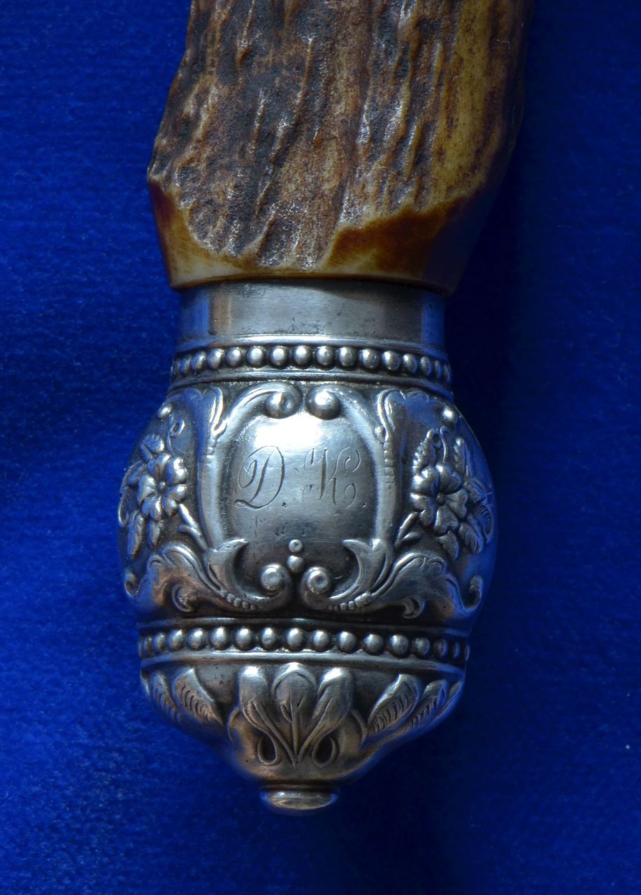

The pommel is neither screwed nor glued to the hilt, it is riveted and covered with silver.
Maybe the seller made a mistake in the description. I bought two daggers from an inheritance from him. He sold me this dagger as a Sheffield dagger and a true marked wonderful Sheffield Bestsilversteel-dagger as American dagger.
Thats all I know.

I have asked the seller and he says probably English hilt and blade from India or Pakistan.

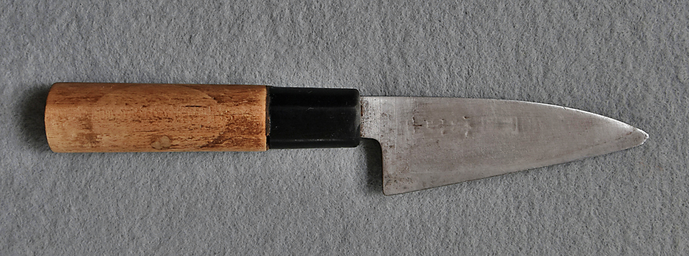

In respect of Japanese kitchen knives, in fact any Japanese bladed tool that has been properly made ( many are not) will really be a very, very good blade, whether mechanical damascus or unpatterned steel.
The very best knife I have ever used is Japanese. It is one of my kitchen knives, it gets used every day for all sorts of food preparation, blade about 4" long X 1mm. thick at its thickest point, san mai construction, I bought it +30 years ago in a Japanese supermarket in Sydney, it cost $12. This wonder-knife has been on a stone no more than 3 or 4 times in +30 years, the last time was more than 5 years ago. It gets touched up a couple of times a week on a Dick butchers steel, a few passes on the steel and it presents a shaving edge.
Any hand made tool depends on the maker's skill, the material, and the objectives.

Image of the best knife I have ever used
