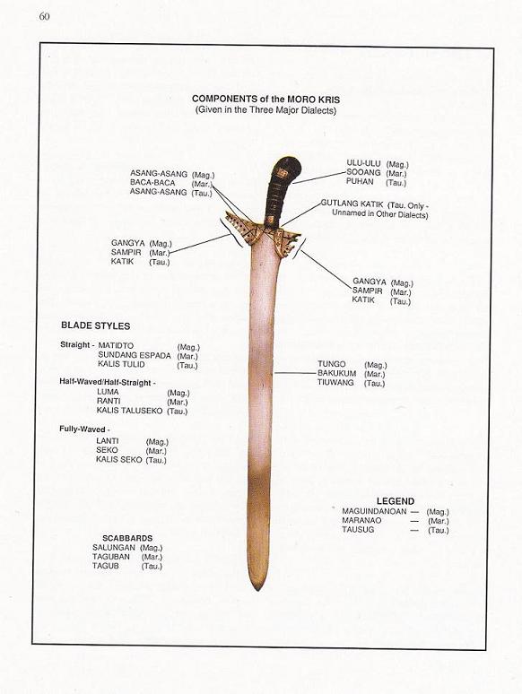

Default Here is some more
David,
Glad they are of use.
Google image searches revealed these some time back and I am sure Lorenz complied these in the one place on his website too.
Alan, scanned is page 60 from Robert Cato's book Moro swords, I hope the links and this scan can give you the direction you need.
Gav

Posts: 7,258
Thanks Gavin.
I do have Robert Cato's book, in fact when he was writing it we corresponded, and he let me have some material from European museums that he had used during its writing.
However, I have recently had some doubts cast upon by some of the terms he has used, or perhaps it could just be the spelling of some terms, by a couple of people who, although not keris or weapons orientated , do most definitely know the languages involved.
What I am hoping for is some current local knowledge.
