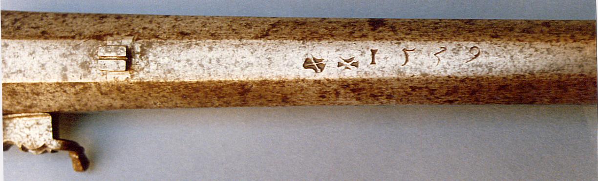

For stylistc comparison I attach two details of the barrel of my Nuremberg matchlock harquebus dated 1539 (more on that piece in my post on matchlock harquebuses earlier today): you can see the same two-stage style featuring the pronounced, staged long forward section, i.e. the muzzle head.

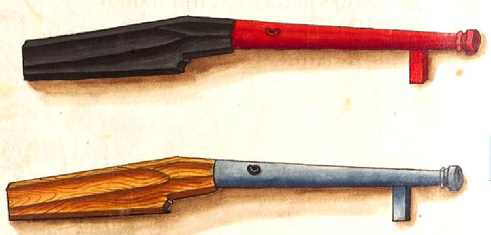

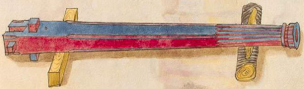

Rarely enough, your beautiful piece retains considerable remains of its original minium (red lead) paint, which, in late Gothic and early Renaissance, was applied not only as an anti-rust protection but simultaneously reflected the period taste for the colors red and green in all arts and crafts alike.
In order to get an idea of how colorful arsenal firearms of ca. 1500 actually looked, see katana's reply of Sept. 5 - thank you, katana! - to Ed's Early Hand Cannon post, showing water colors by Jörg Kölderer, Innsbruck, who illustrated the Maximilianische Zeugbücher after the original pieces in the various arsenals of the Holy Roman Emperor Maximilian I. from ca. 1507 to 1511. I am enclosing three more.

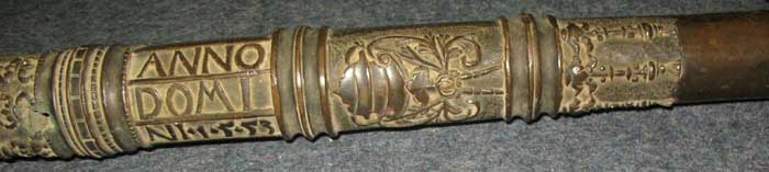

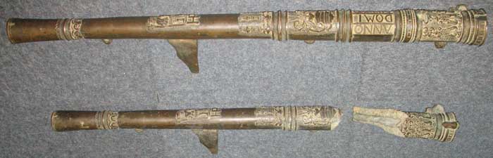

Interestingly, shortly after this exchange the barrel below came up on Thomas del Mar:
Dated 1553

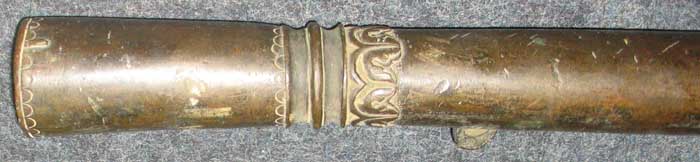

I would like to add a few detailed images of the bronze cannon barrel dated 1553 from Tom Del Mar's London sale that Ed posted.
Actually, there was a pair of barrels in that lot, one of them heavily damaged.
Please note the significant staging of the barrels, the inscription ANNO DOMI/NI
and the date 1553, plus an owner's coat-of-arms, all cast and chiseled in high relief. The prolongated muzzle head closely corresponds to Ed's iron barrel of ca. 1540, although bronze barrels usually follow a more refined style scheme.
Matchlock
