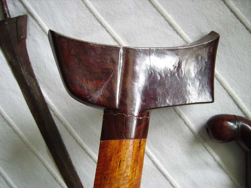

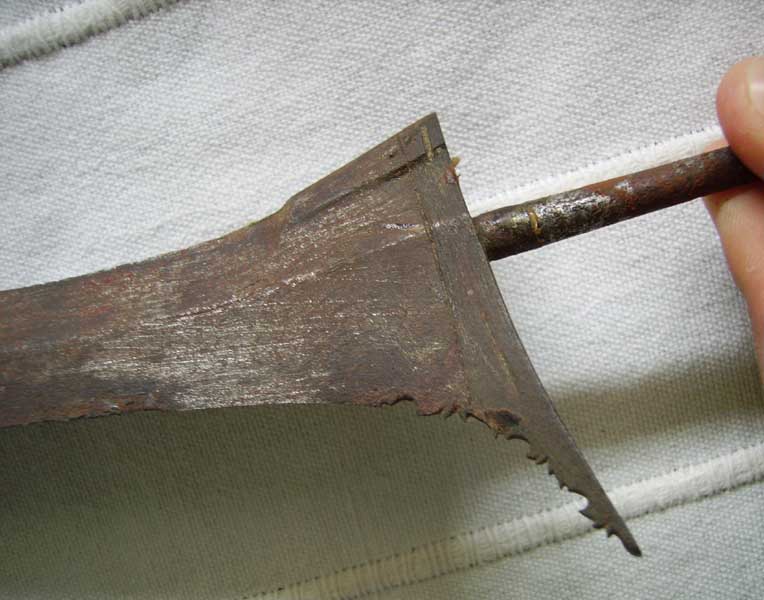

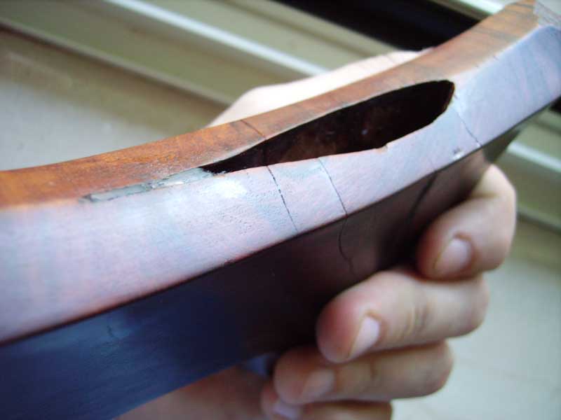

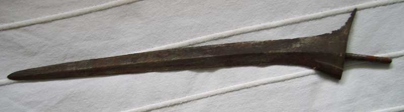

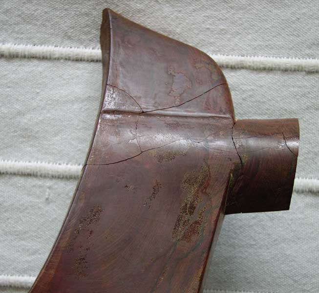

Hi all, here is another of my keris purchases The situation it's quite tragic: the mendak-selut is lost, the warangka was broken and bad glued together, the "point" of the scabbard is also lost. But take a look at the blade: is beautiful and so I think that is worth of a good restoration - work. Any help is welcome (where I can find a nice mendak - selut?) Thank you

http://www.kampungnet.com.sg/modules...view_album.php
The keris is "Pattani" in origin, but the way the blade arcs in both examples suggest that they come from the same area. Even amongst the "Pattani" blades, there are stylistic differences.
You can easily find a brass pendoko like this:
http://www.kampungnet.com.sg/modules...view_photo.php

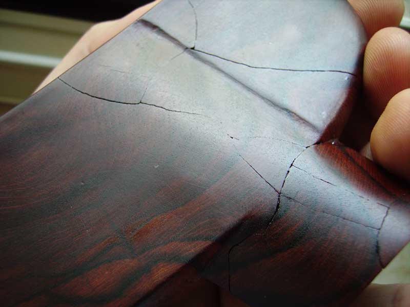

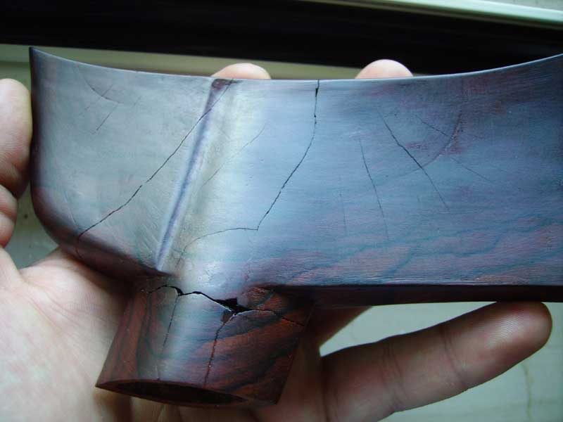

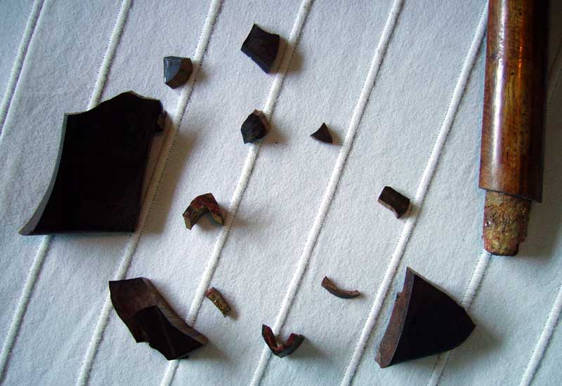

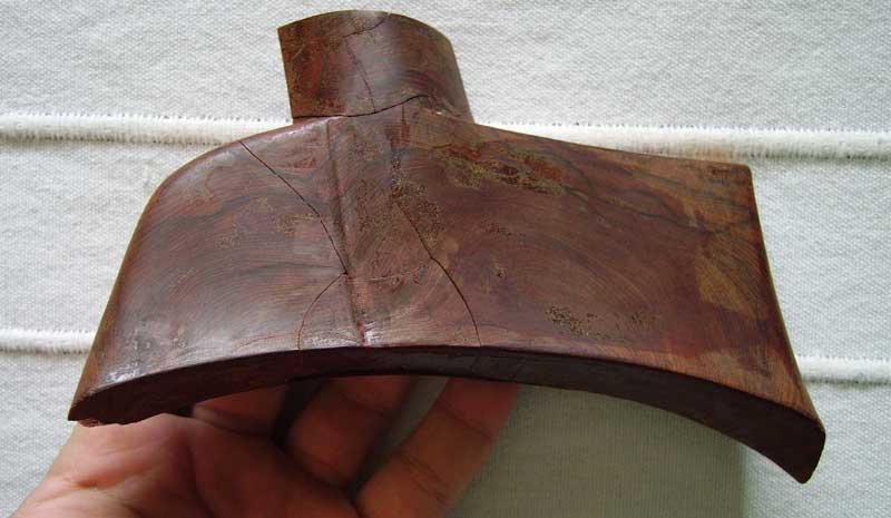

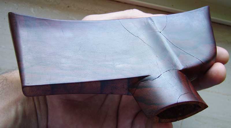

Hi all, well the restoration proceeed: I have unglued the pieces leaving two days in alcohol the warangka and so I have a puzzle to put together Well the next step is to glue in right position all the pieces, to fill all the small cracks, to polish the surface and to use the shellac (I hope that the term in english is right - in italian is GOMMALACCA) that with the alcohol is gone. I think that at the end the result will be fine .
Ah, nobody could indicate me where I can find a pendoko?
In the meantime the blade is in its bath of pineapple juice to remove all the rust...

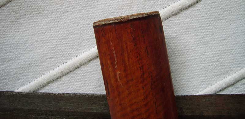

Another question: nobody can post a picture to show me as the end of the scabbard should look like? Thank you
I hope that at he end of all this work the keris will be happy and it will bring me fortune !!

This is how it should look like. The end-piece (buntut). [ picture ]

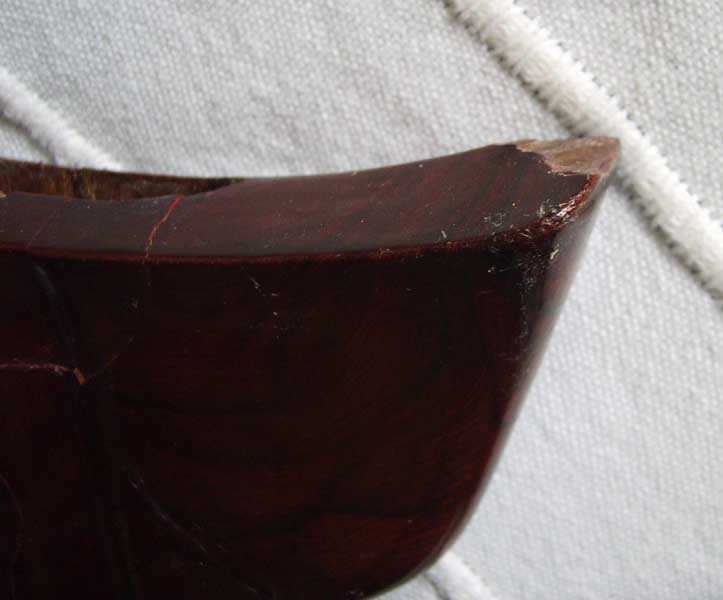

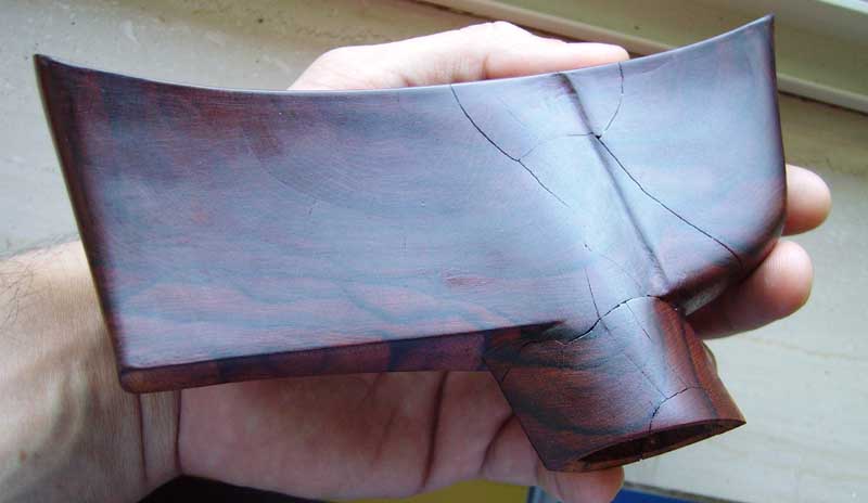

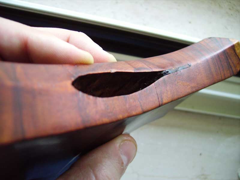

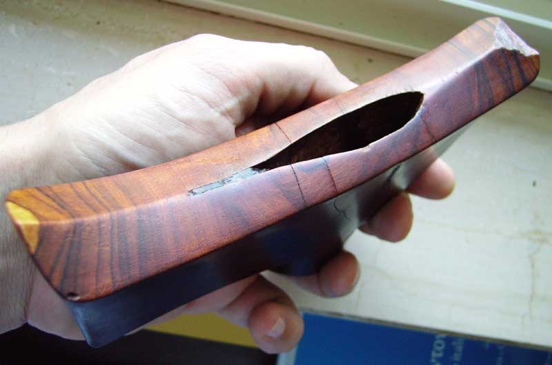

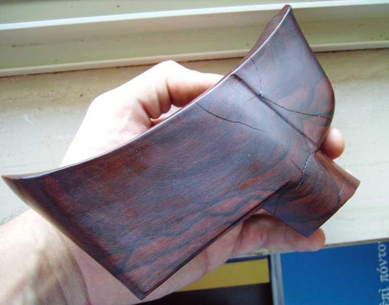

Hi all, another step on the long way of restoration the puzzle is recomposed. Now, first I have to smooth the microscopic scabrousness in some areas...

Alam, I'm agree with you, but I hope that the final result is at least worth of all the work...

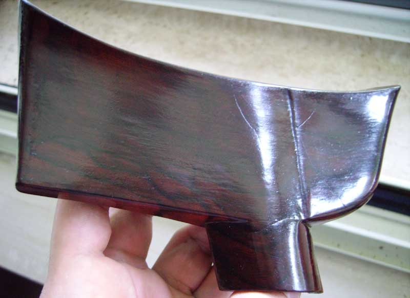

Anyway I've polished the surface: some of the cracks already to this point are visible just a little

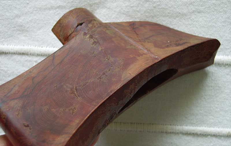

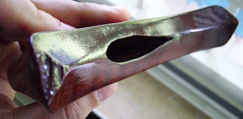

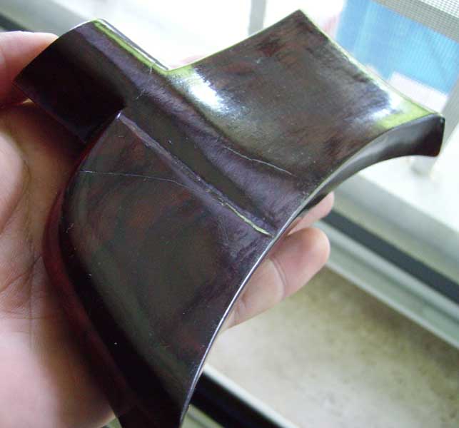

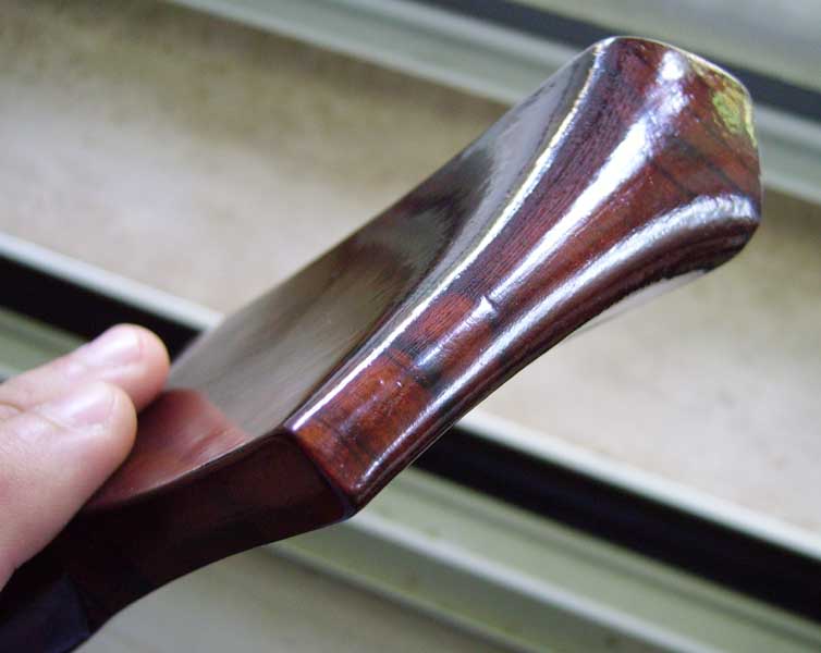

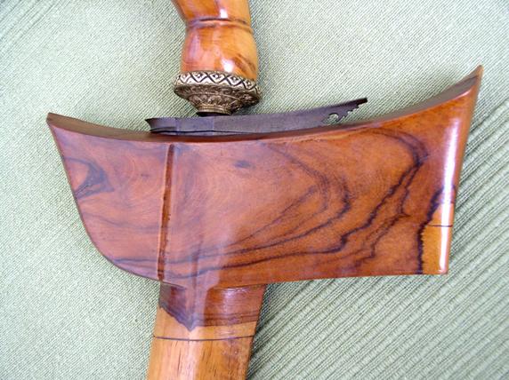

Here we go! The restoration on this part of the scabbard is finished! Shirlak (thank you Marco ) and wax. Also the blade is well cleaned now.

Very nice work Flavio!

Posts: 1,180
Oh, the wood used for the sampir is actually quite good. Pity that it shattered into so many pieces. I wonder if it was because of the limitation in the wood that the carver had to orientate it in such a way that the grains run through the sampir rather than along the sampir.

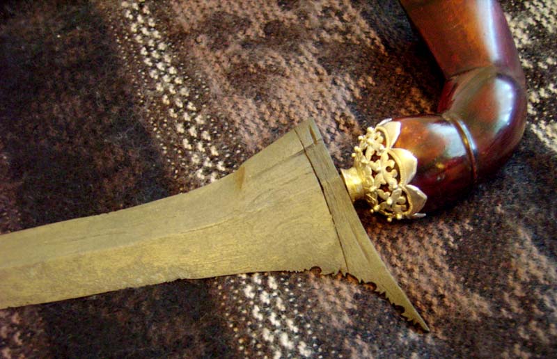

Posts: 1,243

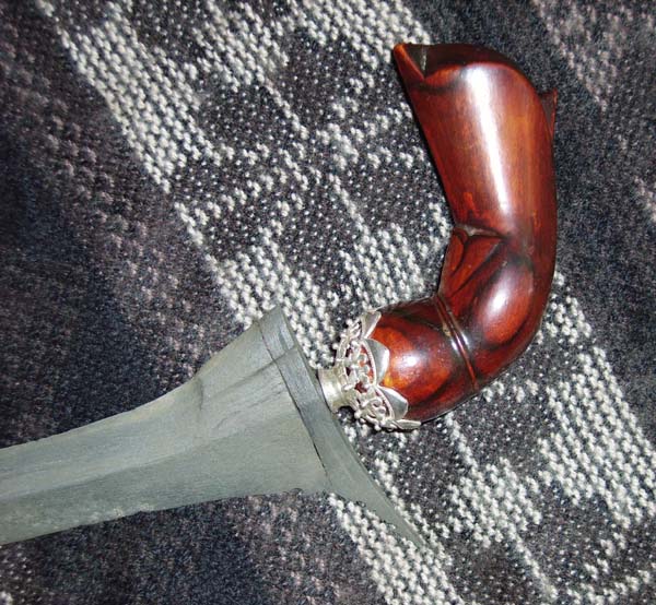

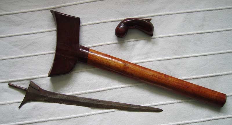

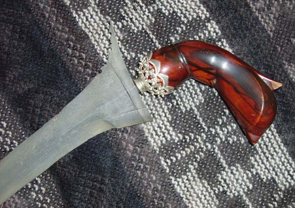

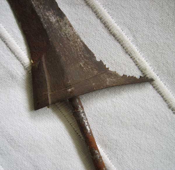

Hi All!! Just to let you know that the restoration proceeds!!! Here are some pics of the keris with its new beautiful pendoko (thanks to all the members that help me and to Mr. Adni ). Soon pictures of the scabbard, thank you
Old 28th July 2007, 01:26 PM   #17
Alam Shah
Alam Shah's Avatar
Join Date: Jan 2005
Location: Singapore
Posts: 1,248
Hi Flavio,
Very nice impressive results.
The silver pendongkok (hilt cup) fits nicely, 'hugging' the base of the hilt.
But I guess, there is a slight gap at the base, which should be acceptable.
The blade looks nicely cleaned up...
The silver hilt cup with openworks design and 'fish eggs' decoration, brightens it, making the entire ensemble looks pretty. Love the background cloth as well...
Looking forward for the pictures with the sheath. Btw, what did you use for the sheath's end-piece?

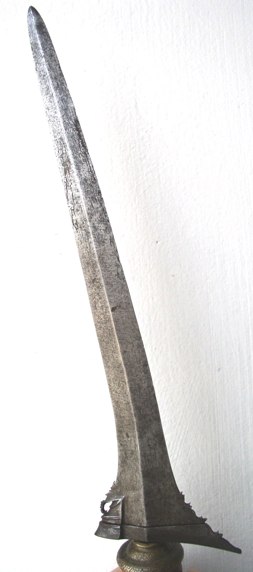

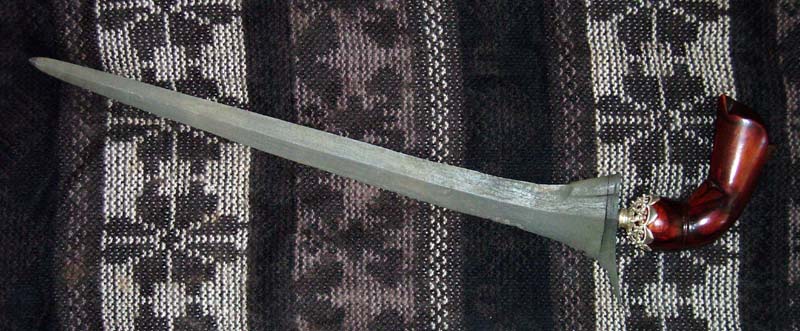

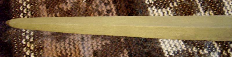

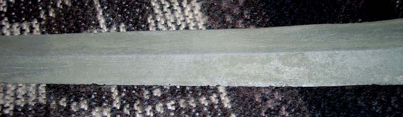

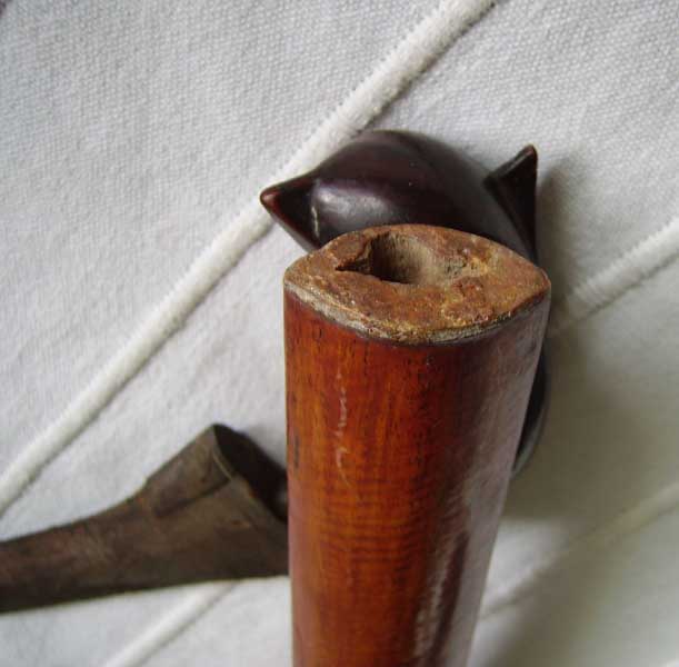

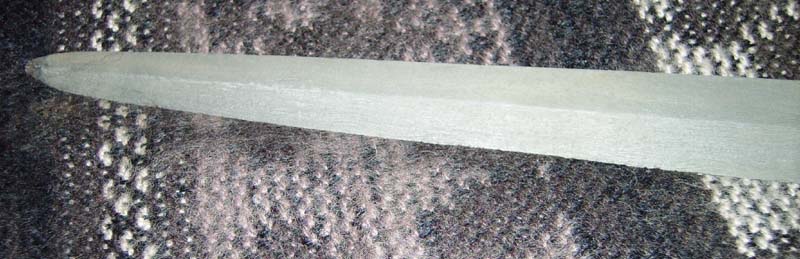

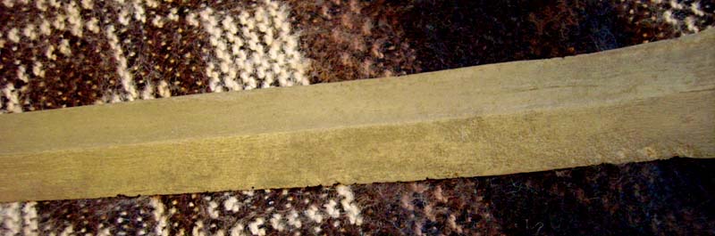

Some shots of the blade

Posts: 7,289
Bravo Flavio! You must be very pleased with yourself. Nicely done!

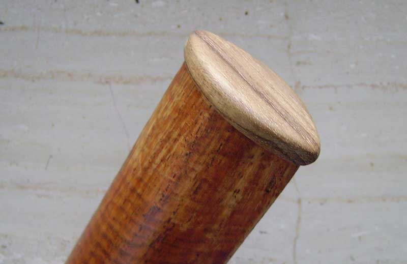

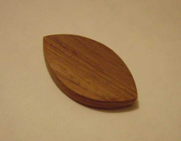

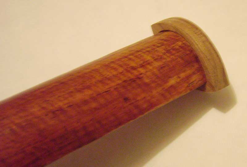

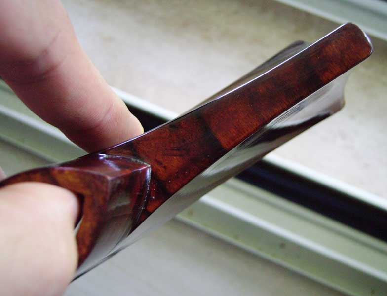

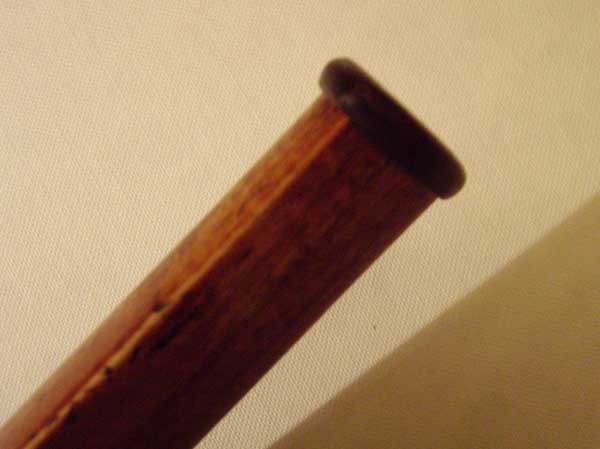

Question

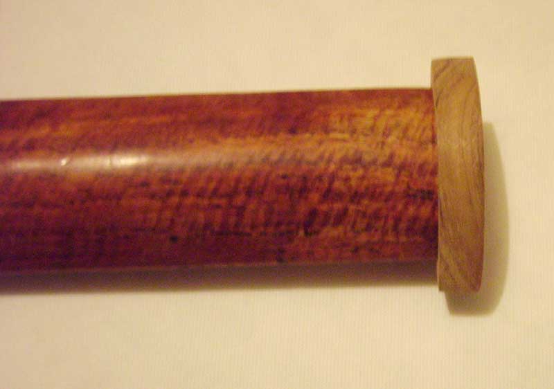

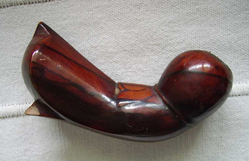

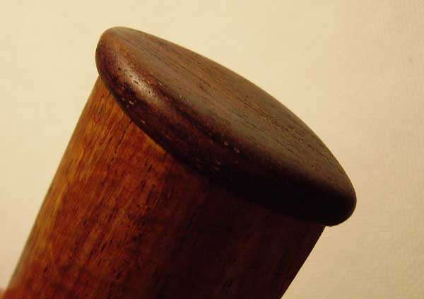

Hi all, what do you think? It's too much big? I have to reduce the dimensions? Thank you
Old 2nd August 2007, 12:27 AM   #23
Alam Shah
Alam Shah's Avatar
Join Date: Jan 2005
Location: Singapore
Posts: 1,248
Hi Flavio,
It should be smaller, currently looks like a bugis styled end-piece.
From MAG archives:
http://www.geocities.com/keris4u/ker...alsarasbig.jpg
http://www.geocities.com/keris4u/ker...gisluk7big.jpg
http://www.geocities.com/keris4u/ker...rasluk9big.jpg
http://www.geocities.com/keris4u/ker...layluk7big.jpg
http://www.geocities.com/keris4u/ker...9caritabig.jpg
http://www.geocities.com/keris4u/ker...ritalurbig.jpg
From these references, you should get an idea of an ideal size.

Posts: 1,243
Thank you sooo much, Alam !!!! I will reduce the dimensions. Thank again - GRAZIE INFINITE

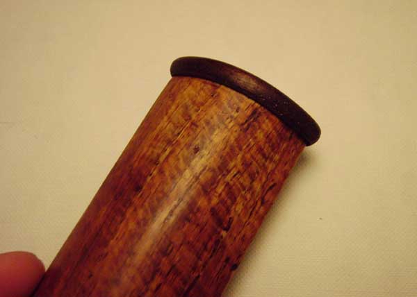

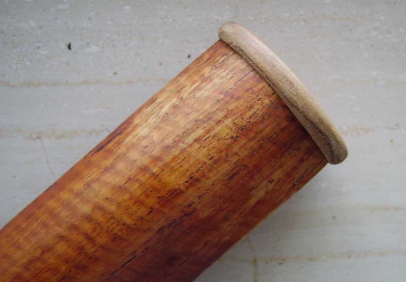

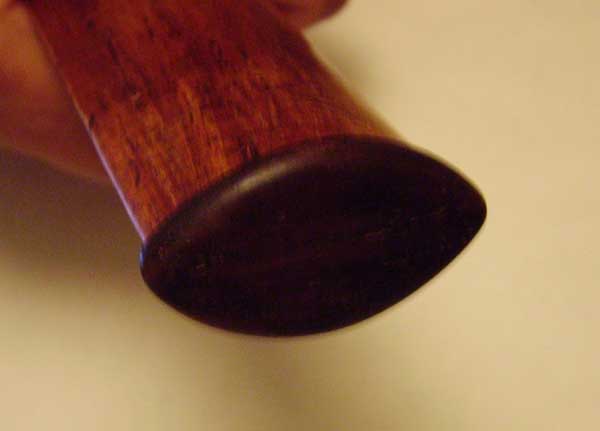

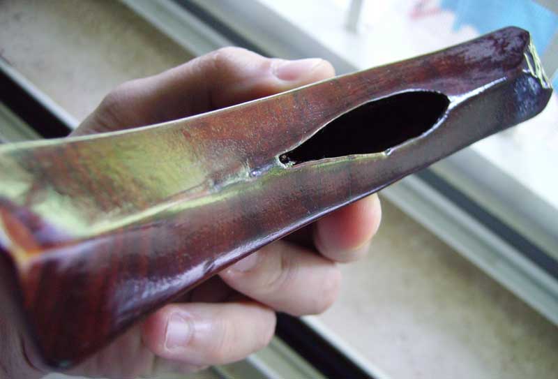

Here are some other pictures of the end piece: this is the best I can do

Flavio,
I think you did very well. Good job!!

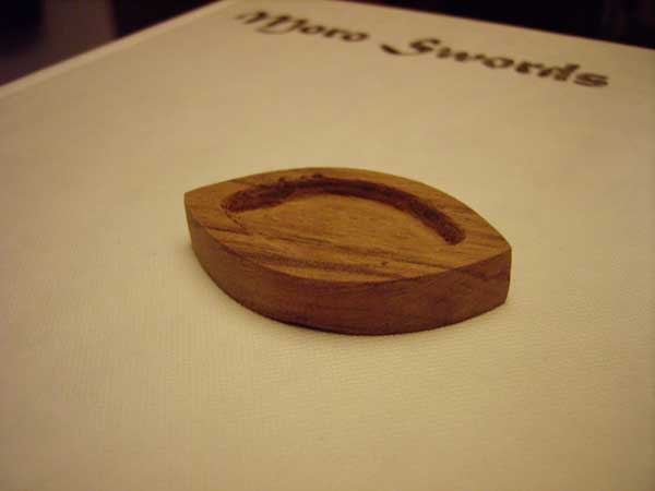

A description how you made the buntun would be nice and a source of inspiration. It is not the only buntun missing on such a scabbard .
Old 2nd August 2007, 09:19 PM   #29
Flavio
Flavio's Avatar
Location: Italia
Posts: 1,243

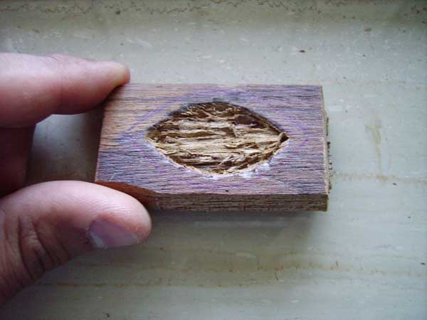

Hello Henk,

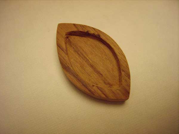

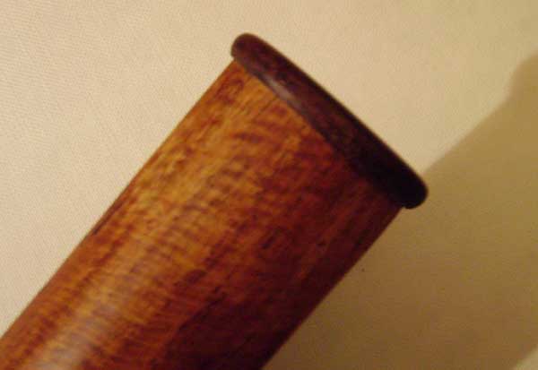

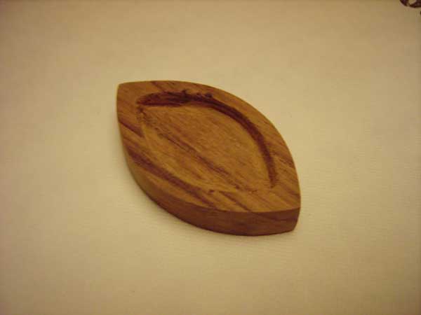

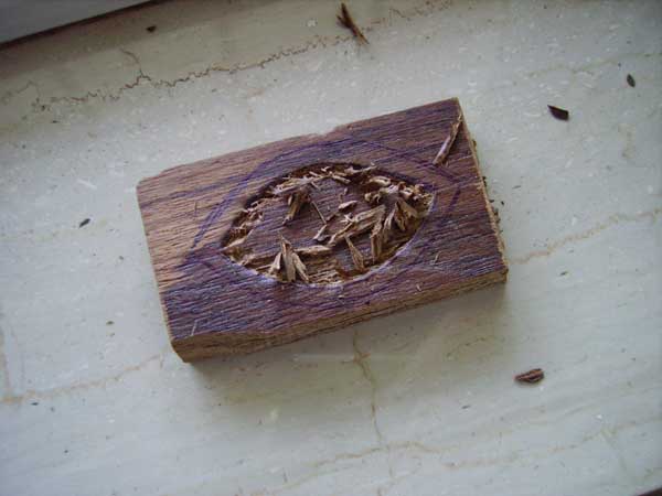

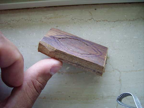

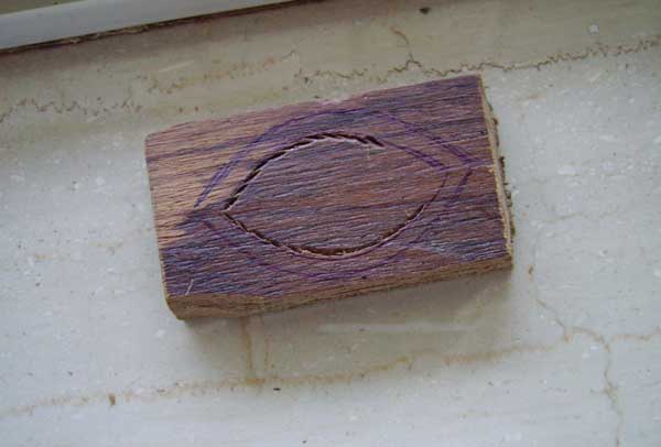

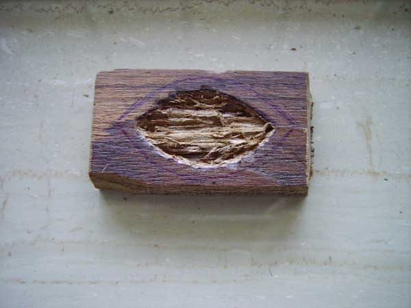

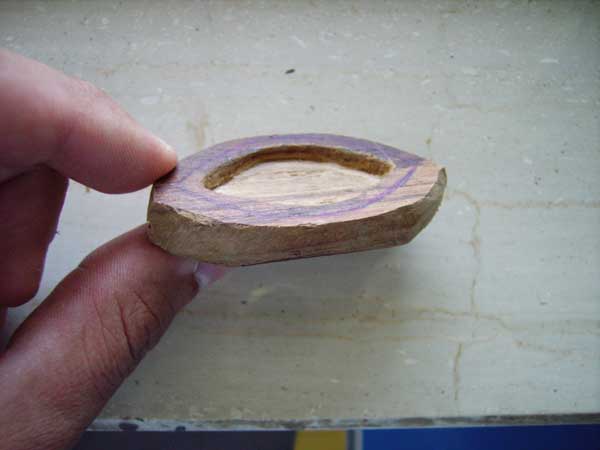

Thank you very much Ok, I try to explain:
first of all I have found a tablet of teak wood (like the ones for the parquet). I have drawn the profile on the wood and I have removed some wood in the inner portion with a screwdriver that I have re-sharpened on a file....
Old 2nd August 2007, 09:31 PM   #30
Flavio
Flavio's Avatar
Location: Italia
Posts: 1,243

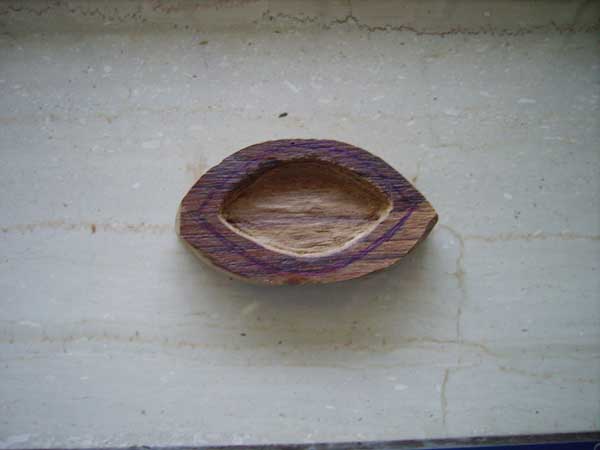

....Than I have modeled the wood with sand paper. The last pictures show the buntun colored with mordant dark brown. Now the next step is to glue the buntun with natural resin and than to give two or three hands of shirluk.
