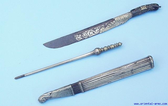

Default A question...
Is there any cultural, geographical or temporal distinction between the pihas with a tip that angles towards the edge, and those that curve towards the spine? I noticed this in a number of pieces and I am wondering whether the backwards sweep is due to the blade having been broken.
For comparisons, I'm adding a picture from Oriental-Arms. In this example the sheath follows the same curvature, possibly indicating it was original.
Emanuel
Old 2nd April 2007, 03:01 AM   #12
derek
derek's Avatar
Posts: 215
Hi Manolo,
Take a look at this article:
http://www.pihakaetta.com/sinhala_weapons_armor_low.pdf
Page 8 mentions different names for piha variations. I've noted this before, but "piha kaetta" is a Stone term that is a little contradictory in Sinhalese, but it is in fact used to describe one specific type of chopping knife. "Piha" denotes the decorative knife like we are discussing. "Da Kaetta" is a more utilitarian chopping knife.
Anyway, to answer your question, yes there are many specific names for piha variations such as Ul Piha (the slender straight example you posted), Gal Mita Piha (the kind with the crystal or jade handles), Vak Piha (curved blade), etc.

Tim,
I have never seen a wootz blade on a piha. Most look to be laminated and possibly some were differentially hardened similar to a Japanese sword. Many of mine have striations in steel very much like the older kukris I have.
I have one piha with very distinct streaks of nickel in the blade.
There is a reference to the fine quality ore found in Ceylon in at least one of my articles. I'll see if I can find it. Most people don't think that quality was reflected in the blades produced there.
From what I've read, the more ornate metalwork on the scarbbards (like yours) came later. That and the elaborate work on the knife itself would be indicative of a gift to honour a person of rank, possibly worn by a chief. I doubt it would have been a useful fighting knife! The phrase "just sit there and look pretty" comes to mind.
I don't know for certain what a fighting piha would be, but maybe it was a plainer version like this:
