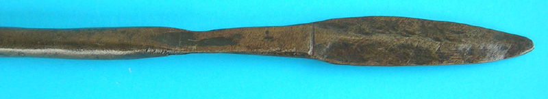

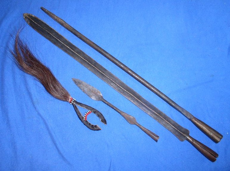

Hi,
I got these weapons a few years ago. Are they genuine weapons from Africa or just some modern tourist stuff?
Any help appreciated. Many thanks in advance.
- Peter

Hi,
the 2 long points are Masai from Kenya-Tanzania.
Danny

Posts: 1,243
Yes, also the shorter is masai but all are tourist stuff
regards
FLavio

Old 3rd January 2007, 05:50 PM   #5

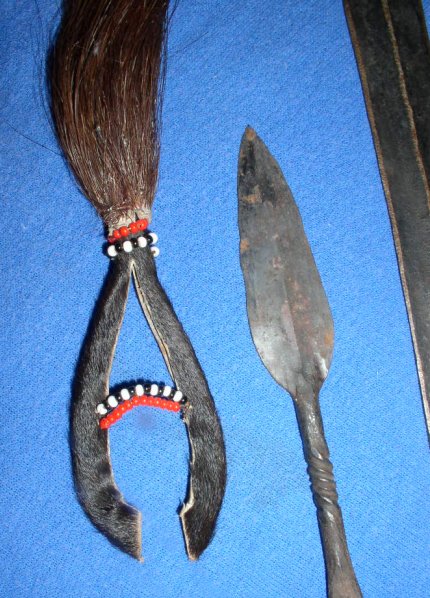

THEY ARE ALL MASAI ITEMS, THE HIDE COVER WITH BEADS GOES ON THE SMALL SPEAR POINT. THE LARGER SPEAR POINT IS THE BLADE OF A MASAI LION SPEAR AND THE SPIKE IS THE OTHER END OF THE SAME SPEAR(THE BUTT SPIKE). THERE WOULD HAVE BEEN A SHORT PIECE OF WOOD CONECTING THE TWO PARTS. THE SPEARS ARE STILL CARRIED AND USED BY THE MASAI AND ARE ALSO SOLD TO TOURISTS. THE MAIN DIFFERENCE IN THE SPEARS IS IF THE MASAI BUYS IT FROM THE SHOP AND CARRIES IT THEN ITS THE REAL THING IF ON THE OTHER HAND A TOURIST BUYS IT FROM THE SAME SHOP IT IS A TOURIST SOUVINEER.
PICTURE OF MASAI WITH OLD FORMS OF LION SPEARS NOTE HOW LONG THE BLADES ARE.

Posts: 5,988
I would agree generally about whether an African buys the spear or a tourist does, except that I think there is quite a discernable difference from the tourist models and modern real ones. Just look at the surface finish the lack of file marks, the quality of forging. This is seriously sharp.

Flavio
Flavio's Avatar
Location: Italia
Posts: 1,243
Tim, seems to me that this one isn't so modern (maybe 50-60 years old or more). If i remember correctly Spring say somethig on the signs on the square part, like that are signs to identify a spicific tribe. It's a nice spear!

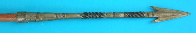

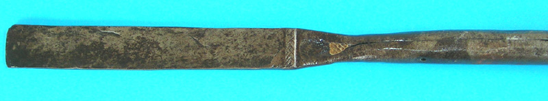

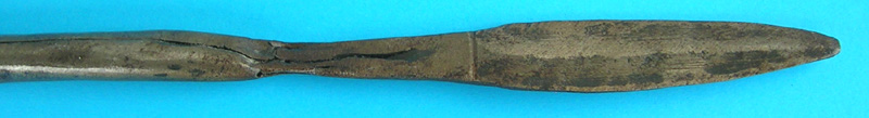

paolo
Join Date: Dec 2006

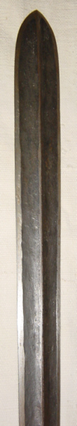

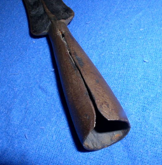

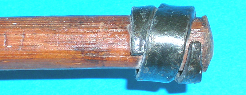

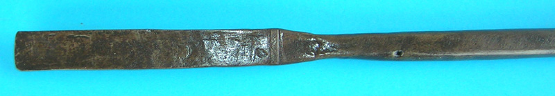

Posts: 173

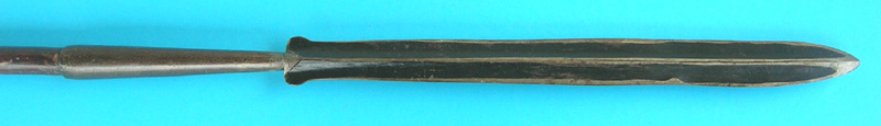

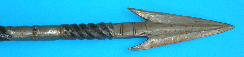

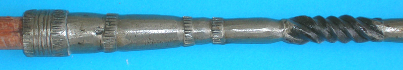

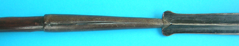

I think my one was a tourist stuff. But I'm interested to your opinion about this other two ( I'll send the pics). One was in an italian official (during 1936 Ethiopian campaign) collection and was catalogued as White Nile area assegai. The other I suppose was used only for ceremonial dances; in its hollow butt must be some iron little balls, that shakin' the spear, make noise.
Paolo

Posts: 173
Here are the other pics.

Posts: 5,988
These look like real ones to me. I like the White Nile/Ingassana one. The dance spear is very interesting although dare I say a little crude rather than simple. The other one, I can only think it must be the northern extreme of it range of use. Perhaps that is why it does not match the quality of the true Massai type. Especially if you think it was collected in the early 1930s.

Tim,
Let me explain better. Only the last two spears were collected in the early 1930s; I bought the Massai type in the early 1970s, (when I was more inexperienced than now) in an ethnic store of my city, and so I presume it probably is a tourist stuff.

Posts: 5,988
Well that seems more like it. It is not terrible, I have seen far worse tourist spears.

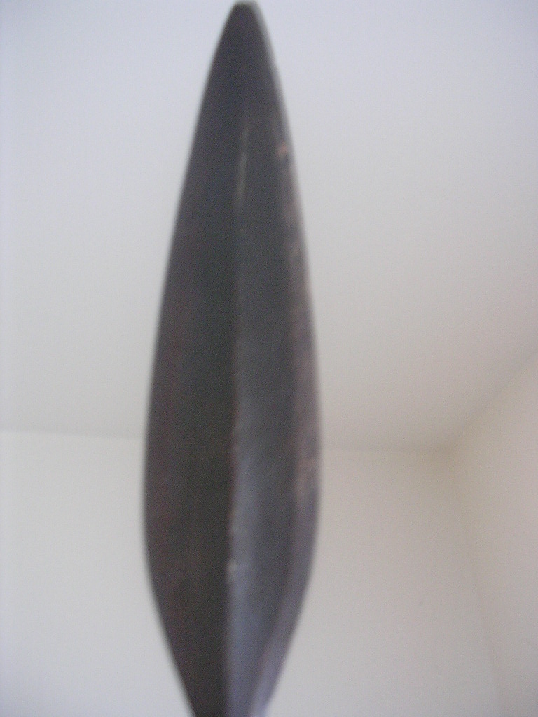

ShayanMirza's Avatar
Join Date: Dec 2006
Location: Charlottesville

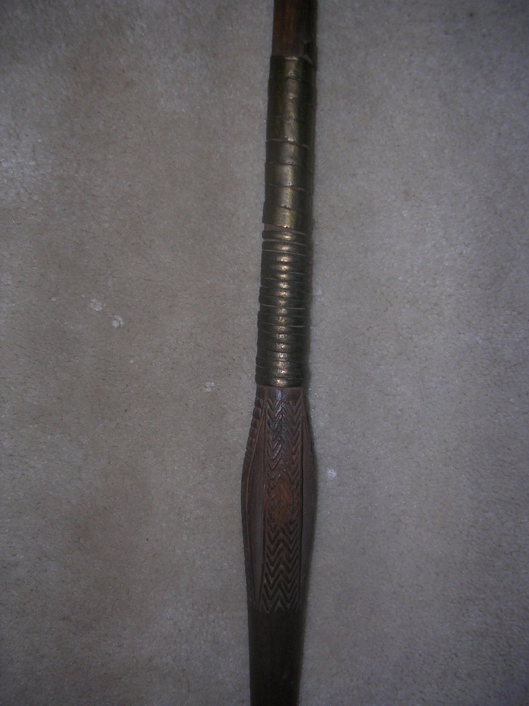

Posts: 25

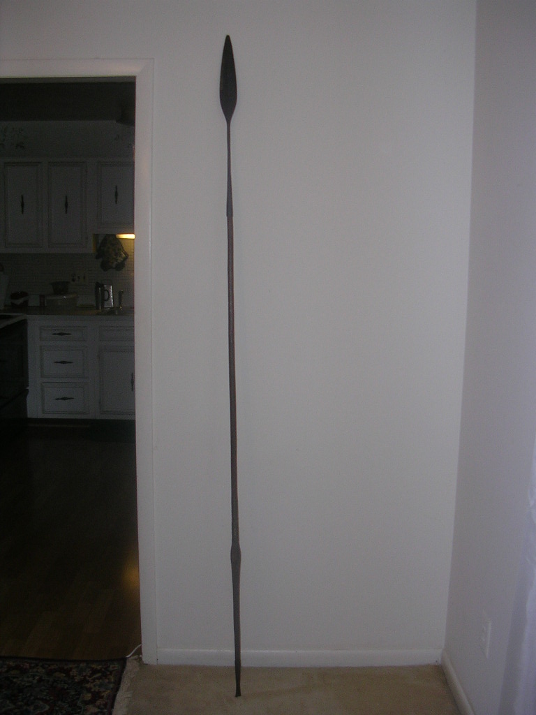

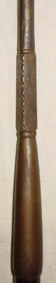

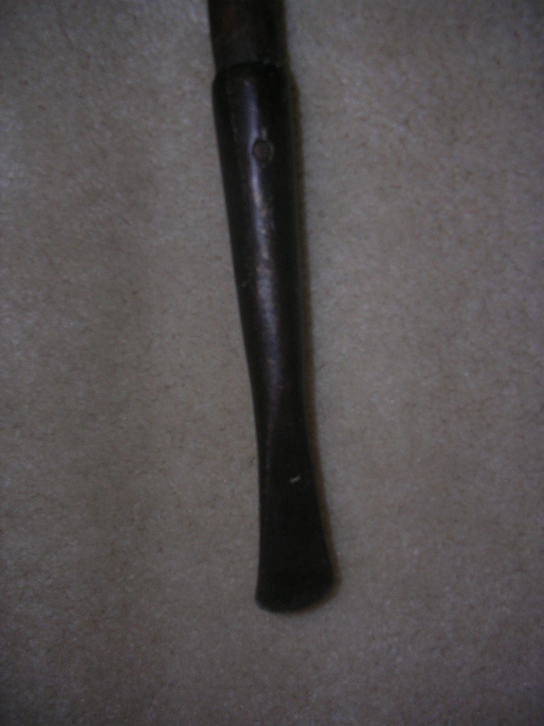

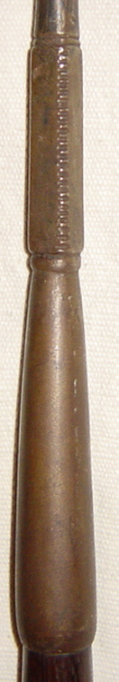

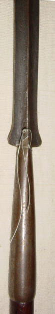

My family tradition holds that this was a lion spear. If it isn't, are there any sources of info on its possible region and background? Is it Maasai? Any info would be grand.
ShayanMirza is offline   Reply With Quote
Old 8th January 2007, 03:37 PM   #24
katana
katana's Avatar
Location: Kent
Posts: 2,658
Hi ShayanMirza,
very nice spear.....although I do not think it is Masai...or at least not a typical Masai spear. AFAIK All their spears have 'spiked' butts yours is flared. Overall the features seem to have a Toureg 'flavour'.....
The length and carved raised section put me in mind of a lance used from horseback......but these are just my observations ...I am sure Tim or Lew are better able to ID this.
Old 8th January 2007, 06:29 PM   #25
Flavio
Flavio's Avatar
Location: Italia
Posts: 1,243
It's from Congo i think ngbandi
Old 8th January 2007, 07:15 PM   #26
ShayanMirza
Join Date: Dec 2006
Posts: 25
Thank you both a lot for the info! Congo would make sense, since my grandfather acquired it in Belgium when he was stationed there after WWII. Any info on what the Ngbandi used it for? It does remind me of a lance, but AFAIK there wasn't a major tradition of lancing in that region's warfare. Did the Ngbandi have lion spears?
