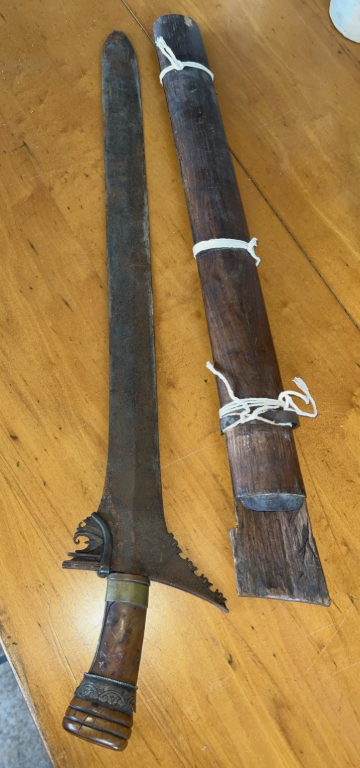

Hi, I've been trying to wrap my head around the kris. I've been following the kris threads of the last few months with interest. Having reread them and Cato hope I am prepped enough to start asking questions and with the forum being slow currently I believe this is a good time to ask.
Here are three recently sold examples of average kris that I thought were interesting for various reasons. This is a comparison overview shot.
Name:  Kalis Comparison Try 2.png
What is your first impression of these swords? Age, designed use, overall cultural impression. Do we have a name for these swords yet?
Now here is the ganja shot. Does Cato's system of analyzing the ganja work? Two seem to me to be two piece ganja one I am uncertain about. If we had a name is it still the same? What else do you all see?
Name:  Screenshot (1024).jpg
Dress. Handles. One is missing a pommel I believe. There are 2 baca baca on each. Would the hilt now change the name of each? What culture would you say each is from? Estimates on the age of handles?
Two examples have the sarong/sampir still. Age/culture? How does this change our perception of these two?
Name:  Dress comparison.png
Sorry for any mistakes in terminology. I misplaced my vocabulary cheat sheet, but I really wanted to post these questions.
For the "ideal" should a kris be light and springy like a butcher knife or heavy and deliberate like a cleaver?
Thanks as always for any and all help towards understanding.
-IP

White metal handle of the middle example. Sorry for the large size it was resizing oddly for some reason.

Hullo IP! Thanks for reading my article (and thanks for the referral as well Ian!)
As you may have noticed in my article, the samples were from a particular era (late 1800s-early 1900s), as those were the kalis and kris that I've been most exposed to, and had the privilege of studying. I believe all the samples you presented in this post fall under that era.
I look at all the details at the base of the blade, particularly the elephant trunk and the 'katik' or notched guard. Then there are secondary considerations... for example, Sulu kalis usually have slightly smaller blades than their Mindanao counterparts; Maguindanao blades have an outline at the elephant's "mouth," Maguindanao and Maranao battle blades have raised spines at the middle, etc.
If I were to label your sample-blades from left to right as A, B, C.
A is a bit blurry, so I can't give an ID. Meanwhile, B is likely Maranao. C is likely Maguindanao.
The dress of A is Sulu; the scabbard, kakatua and proportions to the hilt, the way the asang-asang are attached to the hilt, the ferrule- all Sulu in my eyes. I believe the dress is as old as the blade, or at least belongs to the same era.
The dress of B is also Maranao- but if what I'm guessing is correct (that the material used is aluminum), then it's of WW2 or postwar make.
The dress of C is Maguindanao. I believe the hilt wrap may have been "upgraded" at a later time. The hilt wrap looks like brass wire-wrap with interspersed brass bands. The asang-asang is also brass, possibly upgraded the same time as the hilt.
With regard to performance.
Among the hilts, here's what I observed:
-All hilts traditionally have a wood core; sometimes the pommel and grip are made as one piece, sometimes they're separate. I favor those made as one piece with hemp or rattan wrap- something like C's, but in its "original" version, and not the upgraded one. The brass or silver wires are a literal pain once they fray. There's a reason why the simple hilts were attached to battle blades- because they were the most functional and least likely to break.
-If the pommel is ivory, the hilt comes in 2 pieces. Regardless how well the ivory pommel part is attached, if the hilt suffers a lot of stress (prolonged and repeated use), the middle part (grip) will eventually break. Ivory is usually "heavy" and I'm guessing the physics of having something modular at the end of the hilt results in significant strain on the wooden grip.
-If the pommel is light metal, the hilt will last longer than an ivory-pommel one, although not as comfortable and resilient as wooden pommels.
Among the blades, here's what I observed:
-Not all kris and kalis blades are made equal. Some are too soft, and the edge might misalign easily. Some are too rigid, and the edge might crack because of the brittle-ness. Heat treatments vary. I personally prefer a balance between the two.
-Blades with little to no lamination cracks perform better overall. It's difficult to find a twistcore blade which retains its edge after repeated stress, but such samples exist.
-There are exceedingly rare kris/kalis blades with exceptional heat treatment that perform like in the stories. I've tested one such blade- repeated strikes on dry bamboo, with no damage at all on the edge, very minimal bends after 5 straight minutes of sustained, repeated abuse. A modern smith couldn't believe its performance, and attributed it to the exceptional heat treatment and edge geometry.
Hope this helps!

Thank you for responding! Sorry I took so long to reply. I had to process the answer for a bit.
So two asang-asang do not guarantee a Sulu connection?
I attached a better picture of A.
Do you re-heat treat your blades? Or just find out how they are treated by cut testing? When the edge rolls do you use a finishing steel to realign the edge or grind it true again with a stone?

Sorry for the response delay!
I believe two asang-asang don't necessarily guarantee a Sulu connection. Thanks for the better pic! For the blade itself- I would posit Mindanao (Maranao or Maguindanao); if I'm correct in this, then it's a hybrid piece, Mindanao blade with a Sulu dress.
A Maguindanao elder, Jinnar Salipada, shared that it was a known practice for Mindanao nobility to "import" Sulu kalis blades, then have these dressed up in Mindanao dress, so that their krises would be unique.
Tausug elder Sali Nagarajen confirmed the existence of this practice on the Sulu side (Sulu nobility imported Mindanao kris and dressed these up in Sulu garb), and said that, aside from unique aesthetics, it was also done as a sign of political alliance.
This would account for the cross-pollination that occurred in the melding of Mindanao and Sulu blades and dresses.
Regarding my blades, I lack both the blacksmithing knowledge and hardware to re-heat my blades (and I won't want to, as I want to test their "original" heat treatment). I check the heat treatment in several ways...the first is by gently trying to bend the blade. The tactile response to bending already gives me a clue about the heat treatment and purpose of the kris at hand.
IF the edge misaligns (but not roll backward), I use my hands to hold the spine and bend the kris blade in one direction, then in the other, and finally try to keep the spine "straight." The edge usually straightens out once the spine is straight.
If the edge rolls backward, I re-sharpen with a high-grit diamond stone and re-hone according to the "original" edge (or at least I try to).
After sharpening, I use a honing steel to align the edges. IF it's a full wavy kris, I use the honing steel for everything (sharpening + honing). Sometimes I strop with leather as well.

Thank you again for your responses. Could I ask some follow up questions for clarification?
What is the outline at the elephant's mouth?
Secondly. If the blade of "A" is thin, light, and springy like a butchers knife. Lenticular in cross section. without a distinct raised spine and described in post #7 as "For the blade itself- I would posit Mindanao (Maranao or Maguindanao); if I'm correct in this, then it's a hybrid piece, Mindanao blade with a Sulu dress." What would it be for? Without a raised spine is this a dress piece or could it be for quick slicing movements rather than heavy chopping blows?
"After sharpening, I use a honing steel to align the edges. IF it's a full wavy kris, I use the honing steel for everything (sharpening + honing). Sometimes I strop with leather as well." I have been experimenting with a honing steel this summer on softer chopping blades. Particularly on a small right-handed talibong the size of a large work knife. If you are stropping the blade with leather, should I take that to mean that you are getting your blades razor sharp or almost before cutting tests?

Halloo again!
As a general rule, I was taught that a light and fast Kris blade, especially those without a central spine, would be worn by non-warriors: shopkeepers, dignitaries, business owners, and other members of the nobility. Whereas heavy Krises were more likely to be worn by warriors and officers. A member of the nobility would find a heavy Kris cumbersome to carry around especially during social functions, therefore a light blade is preferred. A warrior would be used to weapon-weight and be able to handle heavy kris built for war.
As with many things, the construction of the sword depends on the owner- his stature (both physical and societal), preferences, and role in society. The attributes of the Kris is more owner-based rather than technique-based.
There are many schools of thought with regard to cutting tests. Some would cut with antique swords with edge as-is. But I favor smoothening out chips and dings, sharpening as much as possible following the original edge geometry, then stropping. I usually prioritize edge geometry over going into high grits; I actually only use a diamond stone with 600 grit on one side, and 1200 on the other, before I hone and strop. I believe in testing antiques in a "fresh" state, just as swords would be before they are subject to the rigors of the battlefield.

Hello IP,
Finally got some time to sit down and write you a response. Apologies for the considerable delay. I put this together over the last few weeks and notice that you have just posted another example, which I will get to in the next day or so.
I labeled your examples 1, 2, and 3 (equivalent to Xasterix’s A, B, And C) and have resized some of the pics to fit the narrative.
To address nomenclature, I would refer you to the discussion in the thread, http://www.vikingsword.com/vb/showthread.php?p=292932, which you have likely read already.
I will focus on the blades you have shown and their dress. These are my own views, and others may well disagree.
Blade # 1.
This is a long, straight-bladed, kris with no prominent midline ridge, fuller, or “arrow head” features. It has two plain asang asang/baca baca. In my experience, twin asang asang are mostly found on Sulu decorated swords, and less commonly on swords of the Mindanao groups. This blade may be the slimmest and oldest of the three you have shown.

The gangya/sampir/katik area has some interesting features. The “elephant trunk” area shows a particularly tall gandhik for a Moro sword (gandhik, Indon., indicated by the vertical white line, extending from the “tusk” down to the line of separation between the blade and katik). The vast majority of Moro kris have a noticeably shorter gandhik. A relatively tall gandhik, such as shown here, is often found on Indonesian keris, and on the heavier Malayan sundang (like this one). Malayan (i.e., Malaysian) culture uses both the keris and sundang.
Another feature of the elephant trunk area is that the shape of the area enclosed by the elephant trunk and gandhik is elliptical. Also, the tusk is angled down with respect to the gandhik. These two features usually reflect a blade of Sulu or Malayan manufacture. This is not surprising given the longstanding trade and geographic proximity of the two. There are also Maguindanao examples that resemble this arrangement, and it’s unclear whether these are Sulu blades dressed in a Maguindanao manner, or Maguindanao-made blades with some Sulu influence. I agree with Xasterix's observation that Moro gentry would take good quality blades made by another tribal group and dress them in their own group’s fashion. Xas has given reasons for this, and his information fits with my own research.
The angle between the midline axis of the hilt and the midline axis of the blade is very small on this example, such that the orientation of the hilt is close to the midline axis of the blade. The midline axis of the hilt is virtually perpendicular to the top of the katik. I think these features, along with the blade length and width, indicate a somewhat older blade.
A Malayan-made blade, or Sulu-made blade showing strong Malayan influence. First half of the 19th C.

As noted above, twin baca baca are often associated with Sulu kris, but not exclusively so.
The hilt is lacking the covering of its grip, and the hilt appears to be a two-piece arrangement with a separate pommel. The pommel is what I would call a “standard, mid-size kakatua” that is found widely on some Sulu kris, as well as some Mindanao kris and some Malayan sundang.
The scabbard is in two parts. The cross piece is probably original to the sword and appears to have been a nice piece of banati wood that has seen better days. The remainder is likely a replacement and made from wood of lesser quality. The shape of the cross piece is consistent with Malayan work and also found on some Sulu kris.
Name:  In scabbard 1.png
I would call this one a Sulu kris or kalis tulid (according to Cato’s information), with evidence of Malayan influence (possibly having a Malayan-made blade).

Default New Kris
I picked this one up a couple months ago and haven't had time to post till now. I believe it is a Magunindanao keris blade. Could the fittings be Maguindanao as well or Mindanao? The pictures are from the seller. Overall length is 25 3/4"/654mm, Blade length is 21 3/4"/554mm, Width 1/2" past gandik 1 1/2"/44mm, width just before tip 1 7/16"/37mm. The blade needs a clean and etch when I have time. The tip has snapped at some point possibly due to cold shuts forming while the smith attempted to create a chevron pattern at the tip from two twisted bars. There is a center ridge line that shows prominently for the first 2/3 of the blade then fades.

As far as the dress goes there is a single copper? asang asang with no signs of a second. The attachment for the asang asang is much less oxidized than the asang asang itself or the strap down the handle. Brass ferule. The wooden handle probably had rattan wraps at one point and there is a possibly silver collar with simple okir. The pommel cross section is ovate. There are two incised lines around its circumference. Attached are two similar pommels I found in the archives and links to their threads:

Any guesses on which Moro groups owned this kris? Does it show characteristics of different groups? Estimates on the ages of the components?\

This piece looks to me to be Maguindanao based on the base blade style and on the okir work. I would also place this in the 1910s-1930s?
The bottom one I would attribute to the same tribe, but perhaps a little earlier, like the 1890s-1900s?
I edited the post and added A, B, C to the pictures so that we can more clearly discuss the items.
Battara thank you for the response. I believe this is referring to item A? "This piece looks to me to be Maguindanao based on the base blade style and on the okir work. I would also place this in the 1910s-1930s?"
While "The bottom one I would attribute to the same tribe, but perhaps a little earlier, like the 1890s-1900s?" Refers to C?
What time period was copper used for asang asang?

In a separate post you said of C: "I say 1920s due to the style of okir work at the base (ganga) of the blade, and the fact that the ganga is not separated from the rest of the blade.
Also it is from the Maguindanao tribe."
I am asking question so that I can get an understanding of time periods for okir and other stylistic elements. And I have been curious about the moons and stemples patterns for a while.
I have wondered if A's blade isn't a different age than the dress.
