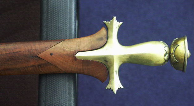

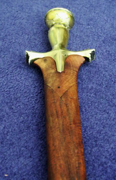

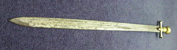

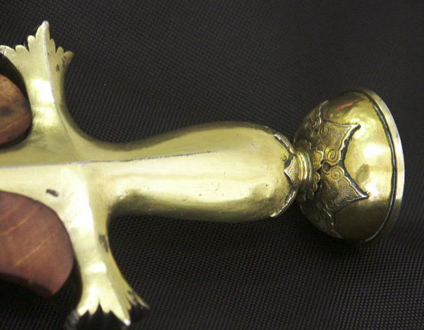

I got this sword from a Malay family in Malaysia. Hopefully to get your professional opinion on what kind of sword is this. Thanks in advance.

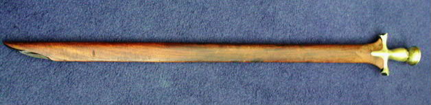

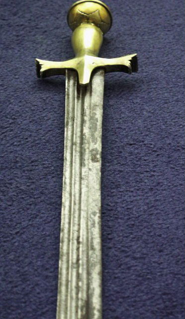

More pictures. Length in scabbard 36 inches, Length of blade 32 1/2 inches, width of blade 1 1/2 inches. About one quarter on top of blade is sharp (like the Malay Tempius) while the bottom edge is very sharp.

I'm no professional, but this is what I think.
The hilt, looks like a Batak Piso Pedang hilt. Normally the blade is curved. This example have a straight blade. The scabbard is unusual but was made for the blade, Malay-styled. Other more knowledgeable forumite can fill-in...
Old 1st September 2006, 03:39 PM   #4
I fully agree. Good catch. I certainly would not kick it out of my collection. I have a Piso Podang with old European straight blade: Portugese?
Is the blade plated?

The hilt has 'similar design' elements to the Tulwar.....but less restrictive...no large disc pommel. Is there any connection?
Old 1st September 2006, 06:00 PM   #6
This is a direct descendant. This hilt was brought to Sumatra by the Hindus. Elgood discusses an Indian sword with the same handle.

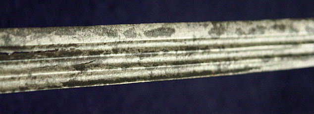

nice sword.
think this is definately rick's (rswords) territory, as i know he's done some research on these. they take direct influence from the early tulwar form of the 16thC (elgood shows a genuine moghul one in his latest book).

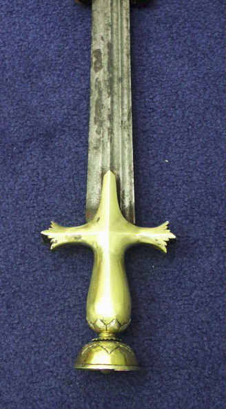

the blade looks as if its been cut down (the fullers travel to the end). wonder if the blade was taken from a firangi, as the style is of the same type.
i've always loved the shape of these things, maybe because i like early indian pieces.

Not unusual at all to have a Euro blade on these.

Thanks for the kind words Ian but I think most of what I could tell them has already been said. I do like the way the woods were mated at the mouth of the scabbard rather than making it all from a single piece of wood. A nice sword,

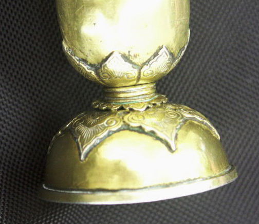

Old 3rd September 2006, 11:00 PM   #12
B.I
Join Date: Jan 2005
Posts: 485
hi,
i cant believe there isnt more information to be offered. if not on this particular sword, but on this type in general. its not indian, and so i have never spent much time with them, but as a descendant from a very important indian form, i think they are fascinating.
jim and rick (stroud) - please step up (sorry, or anyone else?) as i would love to know more.

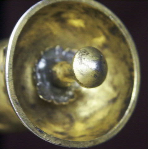

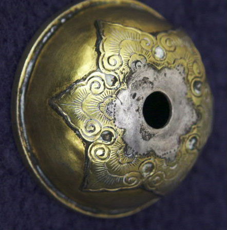

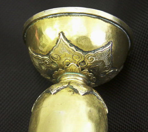

also, i had assumed this to be a brass hilt, as most were. but from the tang button and the detached pommel, it seems to be gilt. is this the case? what material is the hilt made from?

Well as I said above all I know has mostly been added. This is called a piso podang by stone and von Zonneveld , The curved ones are referred to by Gardner as "pedang shamshir" ( G. B. Gardner in KERIS AND OTHER MALAY WEAPONS). Piso may be a variant of the word pisau , and podang peudeung and pedang certainly have similar roots ( in my mind at least ) .
With Piso Podang the hilt is usually cast in one piece where the hilt of many tulwar are cast in two pieces and joined . They are known to have local blades, indian blades, european blades and even rarely wootz blades. These swords (Piso Podang) are most commanly found amongst the Batak in Sumatra. However, there are appearantly some references that do show Iban Dayak carrying Piso Podang. It should be noted that the Batak are non-islamic( Actually Batak is a general name for 6 groups with different cultural and linguistic characteristics, but they believe in a descent of a common ancestor) , and most references to them do not tell of their origin but do talk of the Hindu and Chinese influence. It is believed this sword form came through the Hindu influence as noted above
Some links on it
http://blade.japet.com/Pedang-Podang.htm
http://old.blades.free.fr/swords/pedang_sab/ped08.htm
Some other pictures of these
http://www.oriental-arms.co.il/item.php?id=960
There are variants of the hilt
http://img13.photobucket.com/albums/...d/pisohilt.jpg

the first link is the most interesting, as it appears to have a pretty early example (although i would love to see a closer image). most i have seen seem to be of a later age. as their influence came from an early indian hilt form, which 'died' out, it must have travelled across in the 16thC. so, there must be early examples out there. are you familiar with any. the ont you show is a great and typical example, but cant see it dating before the 18thC (or maybe later?)
the one in elgoods book is definately indian and 16thC, and is a great forerunner of all of these swords, as the form is almost identical.

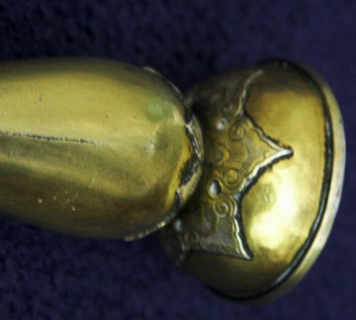

mykeris
Join Date: Jan 2005
Posts: 278
Default More pics
Here some more close-up pics of the hilt. This sword actually was acquired from an old Minangkabau family living in Negeri Sembilan, Malaysia. It was told that it was their only pusaka (heirloom).
Thats interesting. Don't the the Minangkabau also have the strange "horned roof" houses similar to the Batak ? I wonder if there is more of a common heritage there than I ever knew about
Old 4th September 2006, 03:48 AM   #18
RhysMichael
Location: Virginia
Posts: 520
Originally Posted by ariel
My understanding is that the word "podang" comes from Portugese "espadao" (pronounced as espadang).
That could well be arial, I have not been able to find anything on it but podang (Batak), peudeung ( Aceh) and pedang (Javanese) all mean sword don't they ?

The blade is straight and is 36 inches long in scabbard even longer than the ordinary batak's swords of only 27 inches. Dont you think, the blade was originally taken from any English swords or something else?

I think Rhys-Michael and the others have pretty well covered the established data on these swords from N.Sumatran regions and Battak tribes. I see what you're getting at though on the probable origins of the clearly tulwar type hilt. While the typological appearance clearly suggests associations with the tulwar, the cupped pommel rather than disc seems to indicate that there could be a possibility of influence from earlier hilts of the Indian subcontinent.
The complexities of trade around the Subcontinent and the Archipelago may account for the interesting hybrid which we know as the 'piso podang'.The Hindu culture was established in Sumatra from c.7th c. and the Arabs arrived there around the 13th c. The Portuguese had established posts there from the opening of the 16th century and still prevailed in the trade circuits after the Dutch and English dominated the East Indies from the 17th century onward.
It should be recalled that the khanda, well known among the west coast of India, and closely associated the Mahrattas, in turn with Portuguese trade regions, distinctly featured a cupped pommel much as that found on
the piso podang.
It would seem plausible that trade from these regions, might bring the straight bladed khanda swords as well as the curved blade tulwars with arriving Arab trade from Northern India via Malabar Coast. It is known that the piso podang, typically brass , also occurs in iron and although typically with curved hilt, also is found with straight blades.
The blade on this example seems likely a military horsemans blade, and certainly European, thus could have arrived via these trade networks.
Just speculation on my part of course, and I'm sure that the guys who have specialized on these can correct, but seems plausible considering the things I have mentioned.
