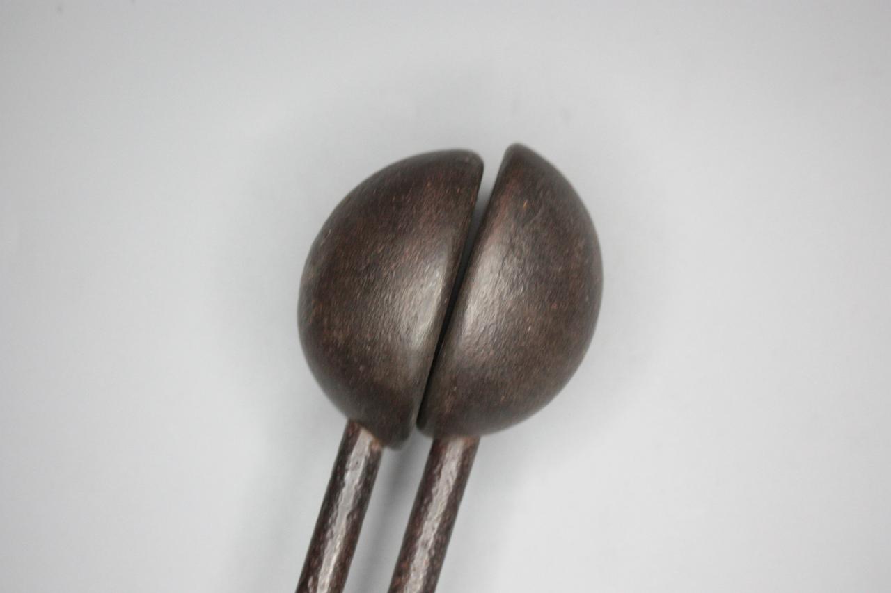

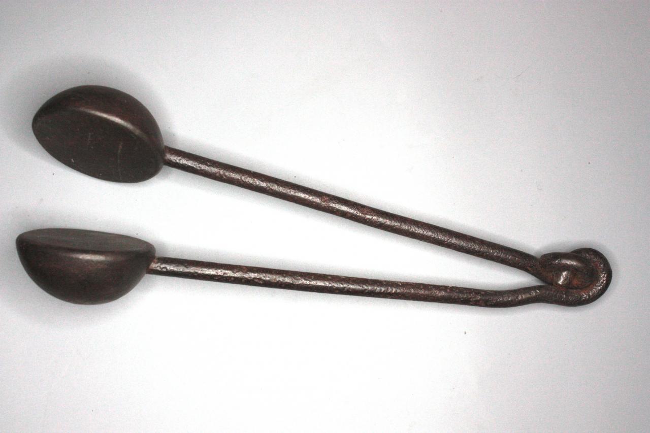

This one has a round "projectile" of ~2.5 inches with an overall length of ~11.5 inches.

These kinds of projectile are most interesting, but it seems not often discussed in general arms and ordnance dialogue in any detail. Is there a way to estimate age or period by the type of shot, manner of joining elements etc. ?
Were these used in any particular period over another, favored by certain forces such as ground troops vs. naval?
It seems, according to some references I have seen, these and chain shot while thought to be naval, and used to destroy rigging, these kinds of shot were often used with horrific anti personnel use even ashore.

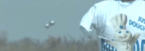

We have something called s bolo round for shotguns. It consists of two lead balls connected by a wire which is supposed to cause "devastating" damage. We carried them for a while and I looked into their performance. The word "marketing" comes to mind. Picture below shows a bolo projectile about 30 yards from the muzzle. As you can see the balls, if I might use the term, have not separated very much. This is consistent with other data that I have come across. Why would they separate? The gauchos twirl their bolos to get the balls separated. Firing from a gun simply shoves them in a general direction. I doubt very much that you see a 5" separation in impact.

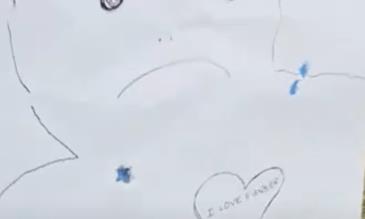

There have been a number of videos that show the "devastating" effects of the 12ga Bolo round. They all show basically the same thing: at the ranges tested (~30 yards or so) the stupid things don't really separate. The pictures attached are representative.

BTW ... the picture on the right shows the impact of two rounds. You can see that the leftmost impact shows both bolo balls with the same entry hole.
