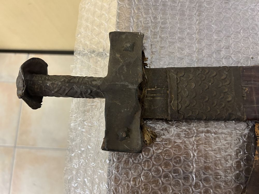

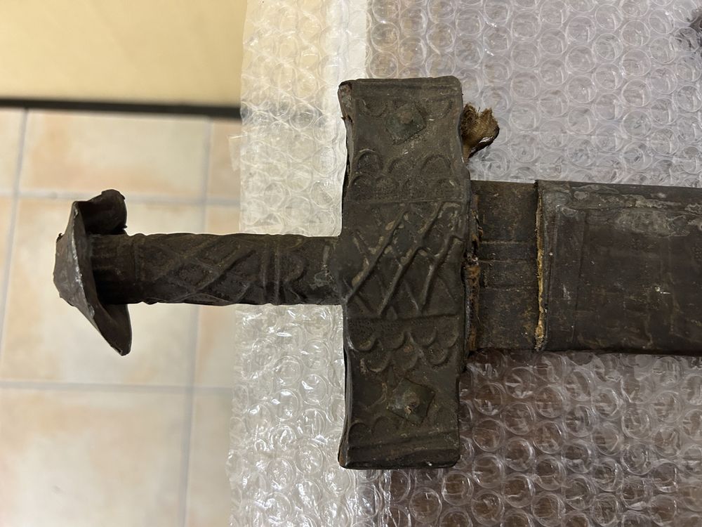

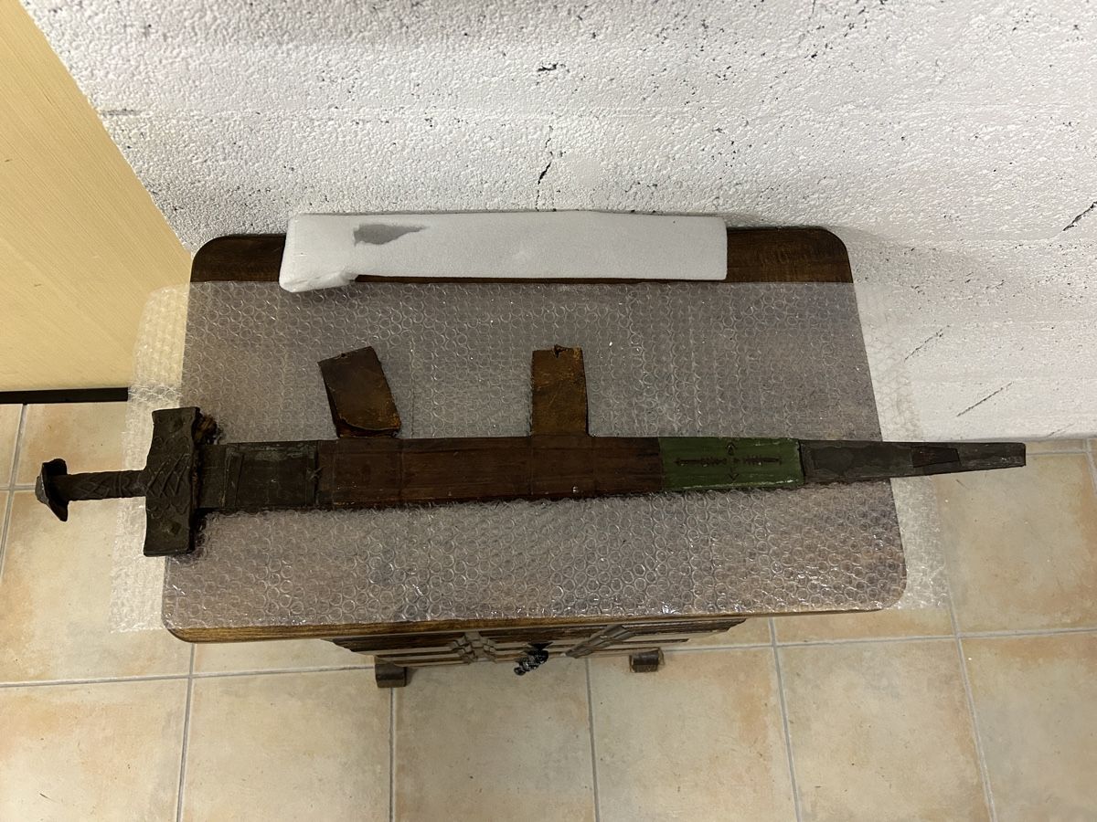

Hello dear members,
I just bought this old takouba sword for few pennies,
Sadly for the moment the blade is completely trapped in the scabbard and the pommel is totally folded / hammered
( thats why it was cheap...)
I first thought the hilt was covered with embosser leather but it is metal, I know that ''southern'' takouba have metal covered hilt, often made of brass.
Good news !!
I wonder first what kind of metal the hilt can be made of ? ( non ferrous/magnet don't work )
Brass oxydation can turn black-dark brown ??
Has someone good clues for clean it and for remove the blade from the leather scabbard ?
I was thinking about a thin and flexible metallic ruler to
introduce step by step in the scabbard ...

The last person who saw the blade put it back upside down in the scabbard...

The hilt are most often brass, copper and zinc sometime a combination of all three layered at the pommel. You would do no harm cleaning the hilt. Getting blade out and not damaging the scabbard could be tricky. A flexible 1m steel rule with a chamfered edge could be slowly and gradually introduced into the scabbard with a releasing agent like WD40 or Plus Gas which I prefere. I have done this with blade in stuck in a wood lined metal scabbard. I think with a leather scabbard this will most likely take some time days. The scabbard will smell for months and the oils will darken the leather but over time all will settle down fine. Good luck. l

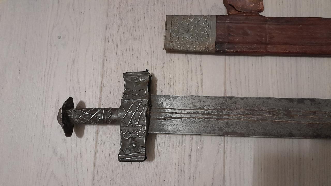

For the hilt has someone a ''magical trick'' for remove oxydation without sanding...
Here it is almost black , 19th century item ?
and I wonder if baking soda and a toothbrush can solve the problem...

One way to remove the blade from the sheath, is to take a soft wooden slatand a small hamer.Gently tap the slatover the entire sheath on all sides.
To clean the brass use a soft brass brush and fine steel wool and/or a brass polish.

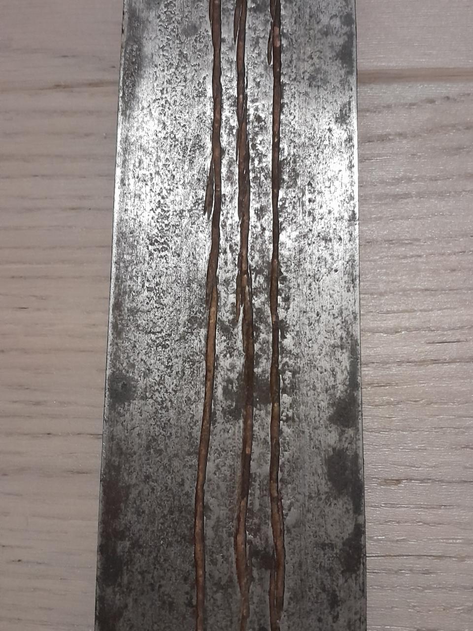

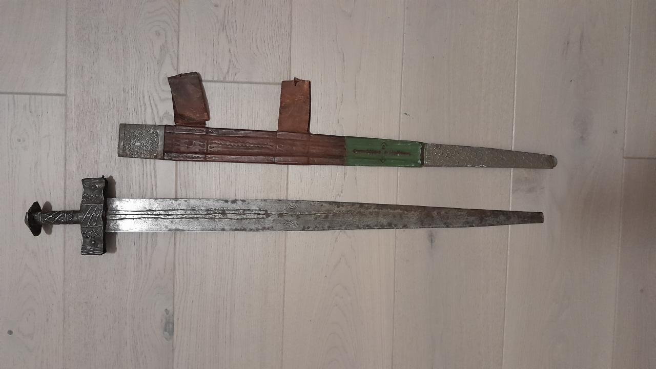

Hello dear members,
I finally got it ! and cleaned it
Sadly not the graal or excalibur, 😐
The blade is unsharped ans local made of poor quality I guess.
It fits to just in the scabbard
that's why it was trapped when all rusty !
I hesitate to sharp the edges so it can fit better in.
A DECORATIVE ITEM , FOR TOURIST EXPORT OR A PARADE. PRESTIGE'' SWORD ?
I DON'T EVEN THINK IT IS NIGERIAN ??

Ps: the hilt is not made with brass ,
Don't know what it is...
Zinc maybe?

Marius, while the blade did not turn out to be an old one, you still did an impressive job of getting it out without damaging the scabbard. How did you do it?

Hello all,
I first placed the metal ruler (without penetrating oil) gradually moving from left to right;
with the leather there was no problem, but it was still stuck at the maximum,
SobI tried to place the sword in the cold for a few hours to contract the metal (winter here) again the ruler about 40cm then I used a small wooden block and a hammer to get everything out by tapping on the brass trim delicately and gradually of course 1-2 mm
Again the ruler then again the wood block and hammer...

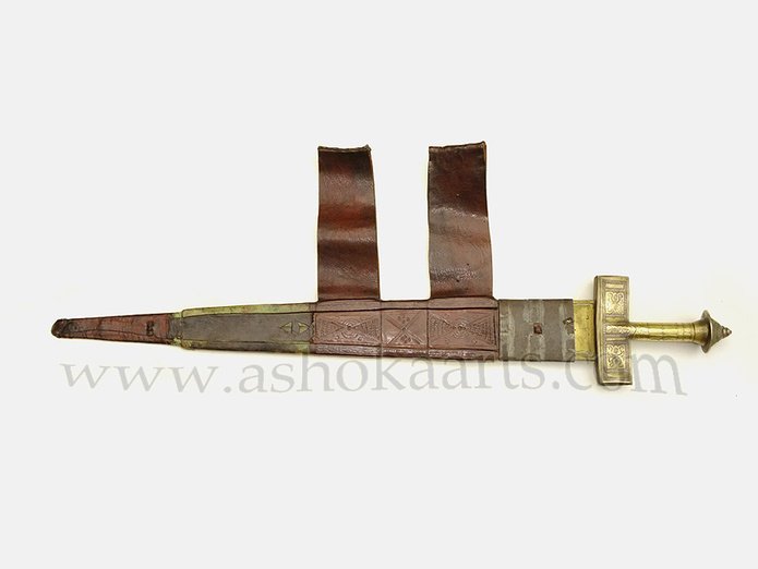

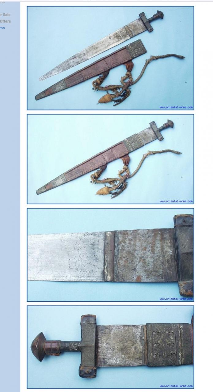

For the extra size of the blade in comparison with the scabbard,
I saw that many of these southern takoubas have the base of the blade staying outside of the scabbard ,
This one richly decorated
Marius66 is offline   Reply With Quote
Old 16th February 2024, 08:48 PM   #16
Marius66
Join Date: Jun 2019
Posts: 131

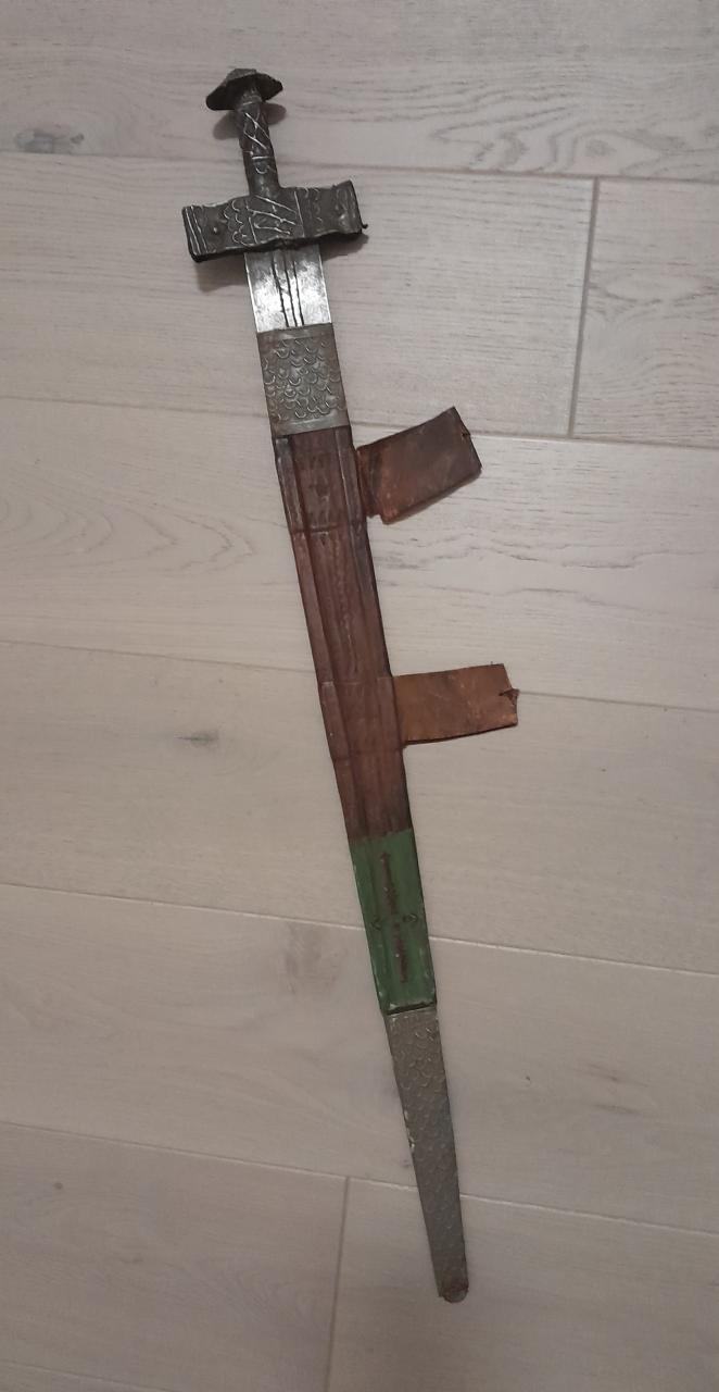

And this one with a brass stopper on the blade,

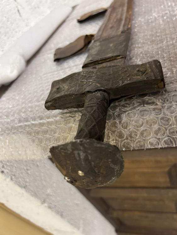

I corrected-adjusted the pommel idem :
hammering on a
small wooden piece that I shaped as a bouterolle and use small rounded pliers
Patience...
