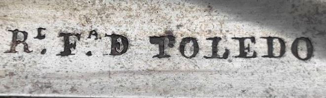

The blade is stamped on one side R.F.D TOLEDO, and on the other ANO D 18833. Also, on the heel of the blade there is a stamp in the form of a knight's head (Gebruder Weyersberg), Solingen. At the end of the guard cup, in the center there is a stamp - L. BORETI.

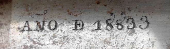

The engraving is puzzling - ANO D 18833. Logically, the year should be 1833, is this a mistake by the master?

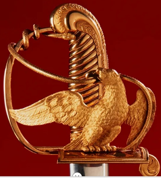

He made sword hilts for nobility, like a magnificent one offered to Portuguese King Dom Miguel by his sister (as hereunder).
But one thing is the hilt, another is the blade. As you notice, the presence of a German mark (Weyersberg) reminds you to could consider that this could be a Solingen trade blade, with inscriptions made with a Spanish taste. Worth to notice, besides the date wrongly written (should be 1833), the font used in one side is different from the one used in the other.
