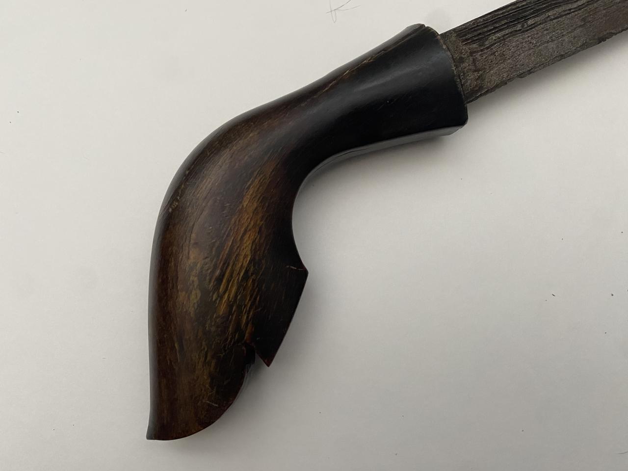

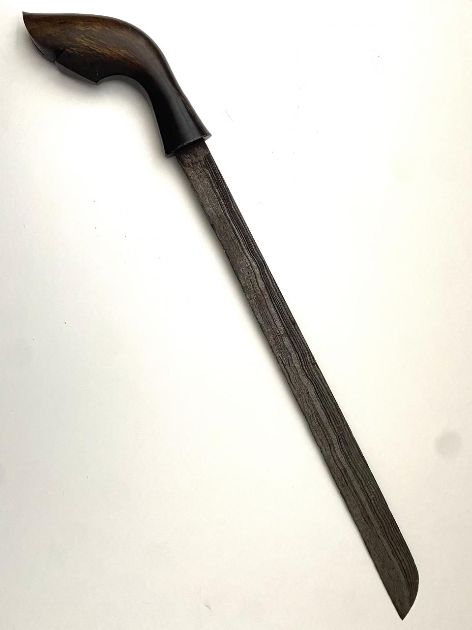

Javanese name for this sword?
Wondering if anyone can improve on van Zonneveld. Closest match is with this sword on page 134 of Traditional Weapons of the Indonesian Archipelago labeled “Sword, West Java”. Dense wood hilt, no scabbard. Nice blade with very coarse texture, obvious pamor. Possibly old blade/new hilt? Would this be lumped under “parang”? Thanks!

No, not parang, but pedang.
Pedang translates as "sword".

Good quality example from western Java, indeed. BTW, I'm quite sure this hilt is from horn.

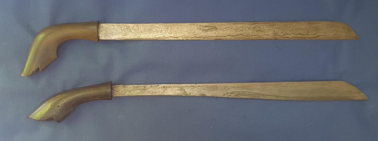

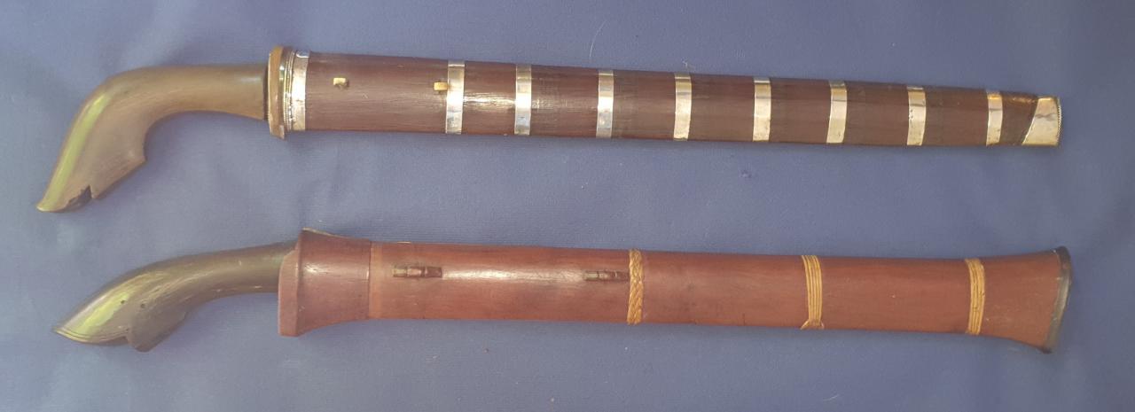

Compare, in up Sunda, down Sulawesi. Both from my collection.

Thanks everyone! Very interesting discussion. I will treat the hilt differently now that I know it’s horn. Much lighter color than the carabao horn I’m more used to seeing.

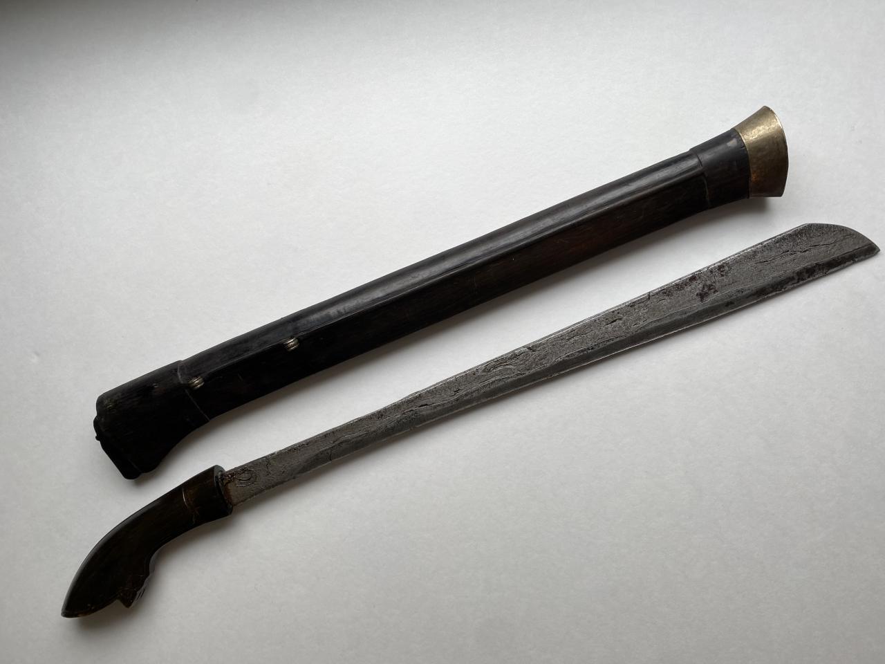

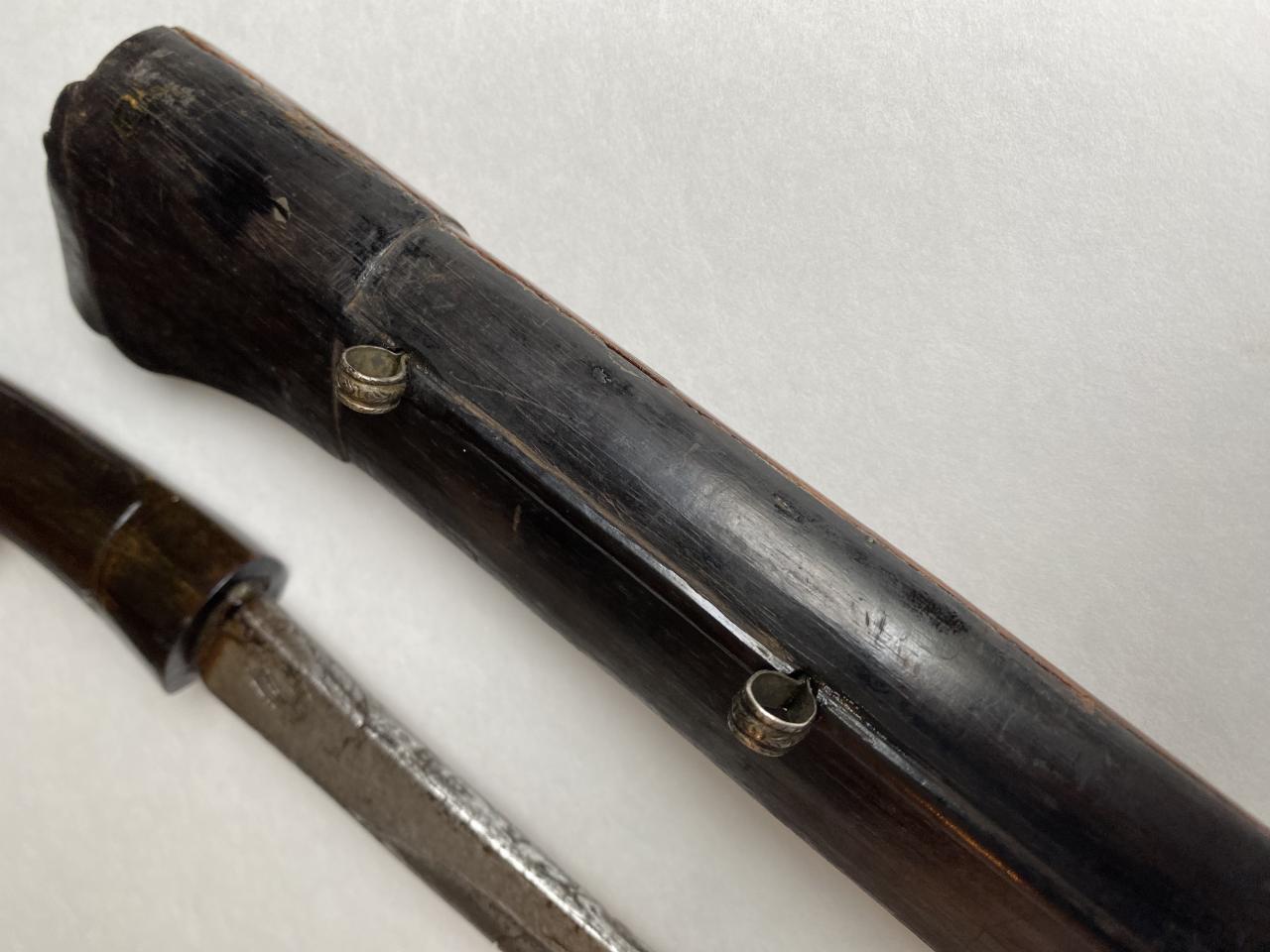

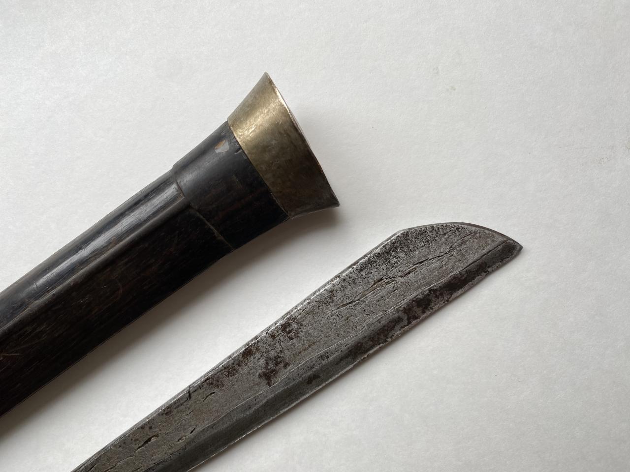

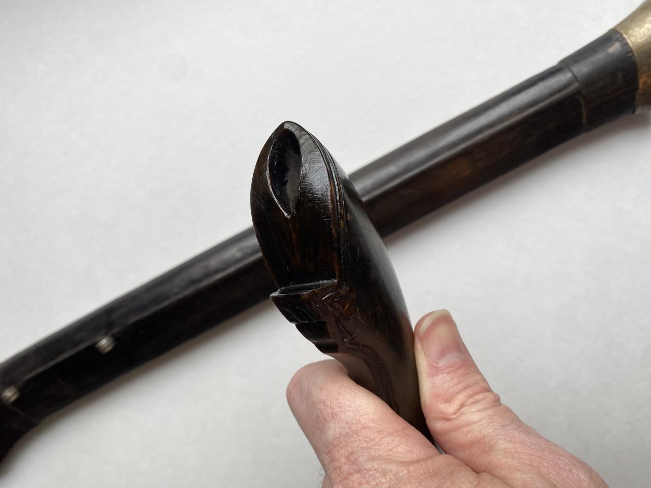

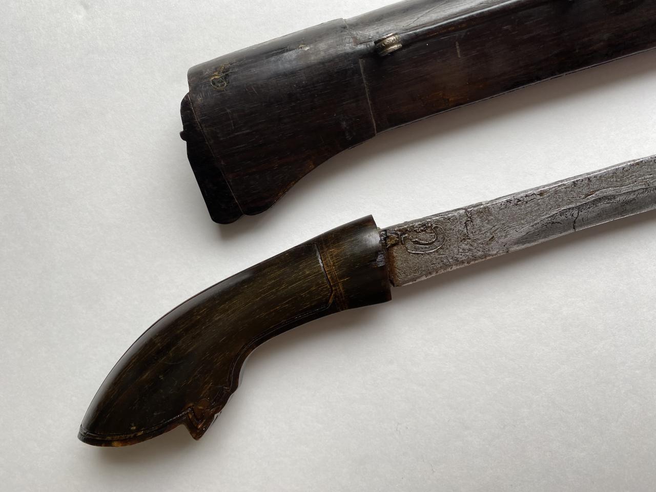

Posts: 145
I just acquired this pedang. Appears to be similar to your Sulawesi example. Scabbard has a couple rings for suspension. Missing bindings on the scabbard, some damage to horn hilt. Really nice sword!
wildwolberine is offline
Old 11th November 2023, 07:58 PM   #13
Yes, good, complete alameng from southwestern Sulawesi. Nice!
