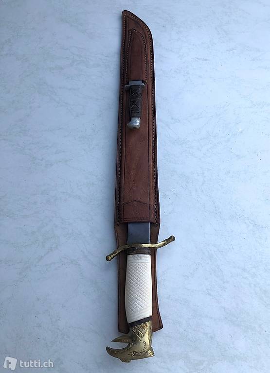

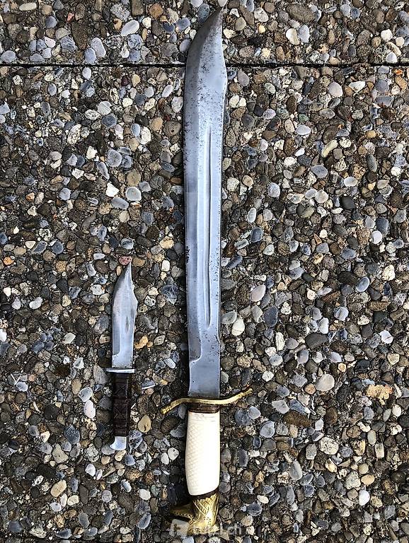

Default A spanish-mexican type large bowie knife ?

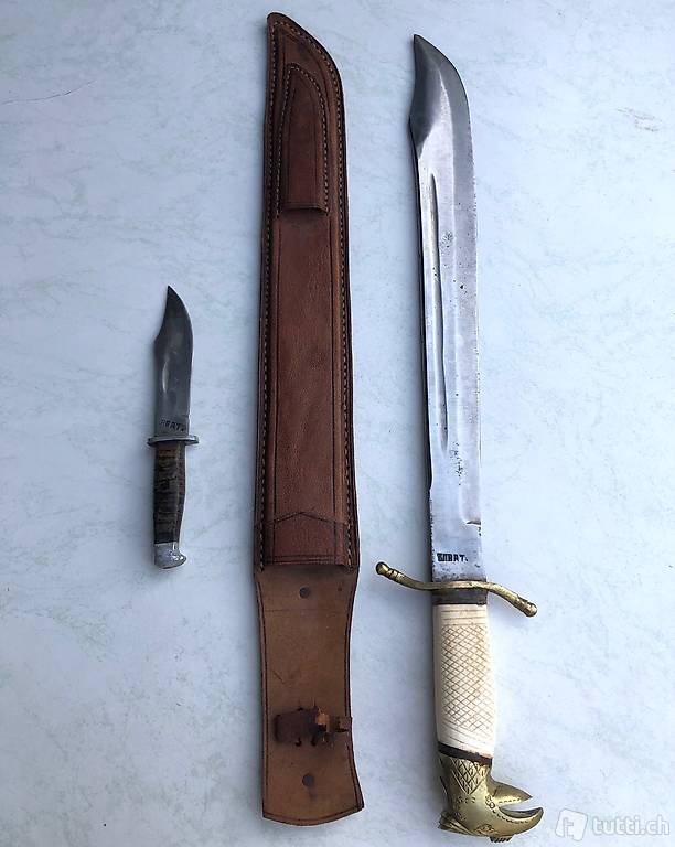

Good evening dear members,
I'd like your advice about this large knife/small machete ,
21,65 inches long ( without scabbard )
He comes with his ''small'' side knife,
looks like a xxl bowie knife with a latino american style
( I find...)
Maybe antique ?
Can you help me to fix it ?!
Kind regards

it certainly has a Mexican type of look.

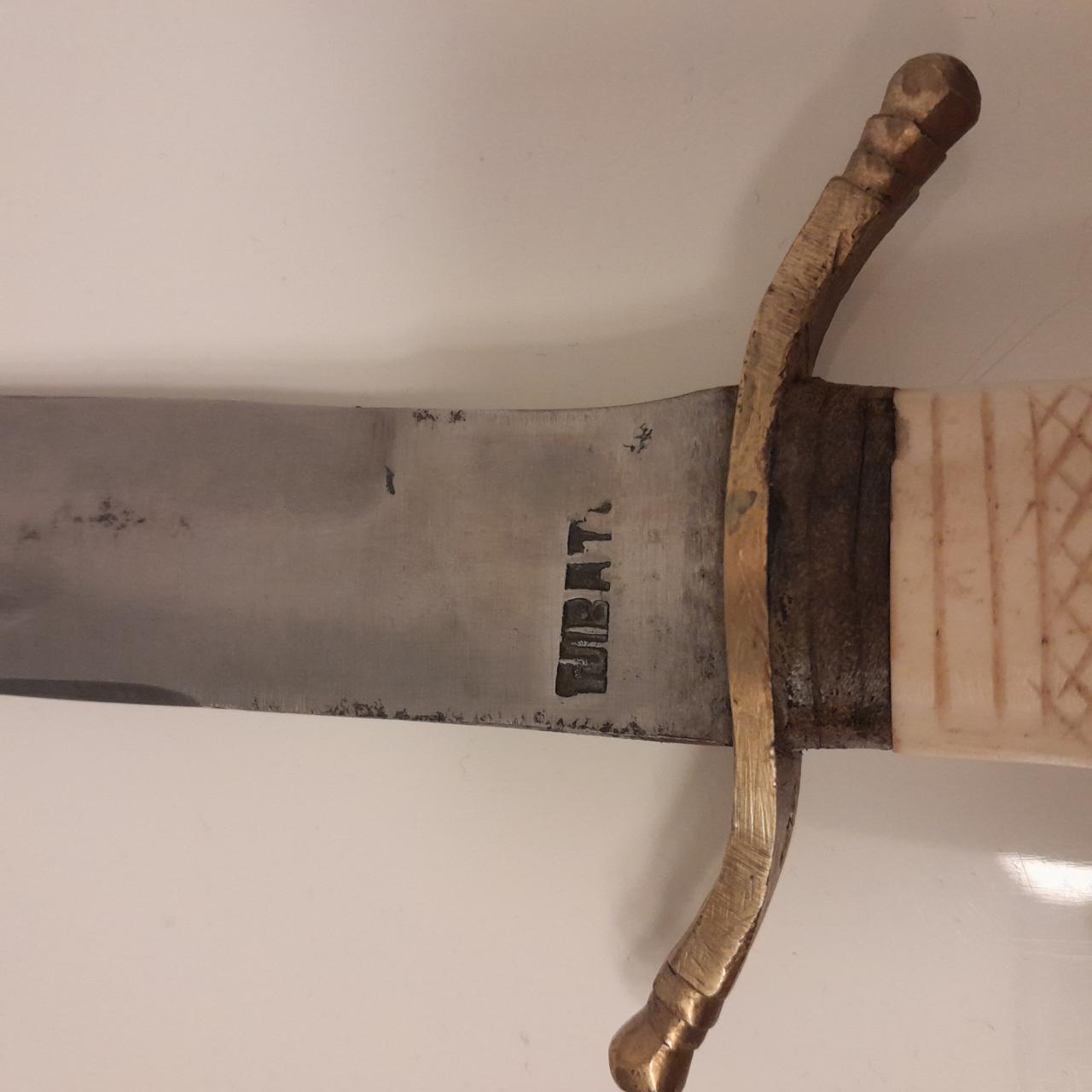

The eagle head pommel is a very common feature. The giveaway would be (if someone recognises it) the punch stamp which loos like ENBAT? EMBAT?

Interesting how much that blade resembles a short version of a klewang.

I agree with Werecow, there is something VOC colonies in the blade shape,
hilt looks more Mexican as Milandro says...
I will receive it friday I hope,
I could send better pictures of the stamp and of the blade
Kind regards

the clip point and the fuller do look similar and I have been also thinking that I had seen the pommel on some Indonesian made weapon , I think that the key to identify is in the identification of the punch stamped mark.
Please make a beter picture or ask for one
IF this is Indonesian made then it is probably Tjikeroe
if you look though this thread
http://www.vikingsword.com/vb/showth...ight=Tjikeroeh
You will find some similarities

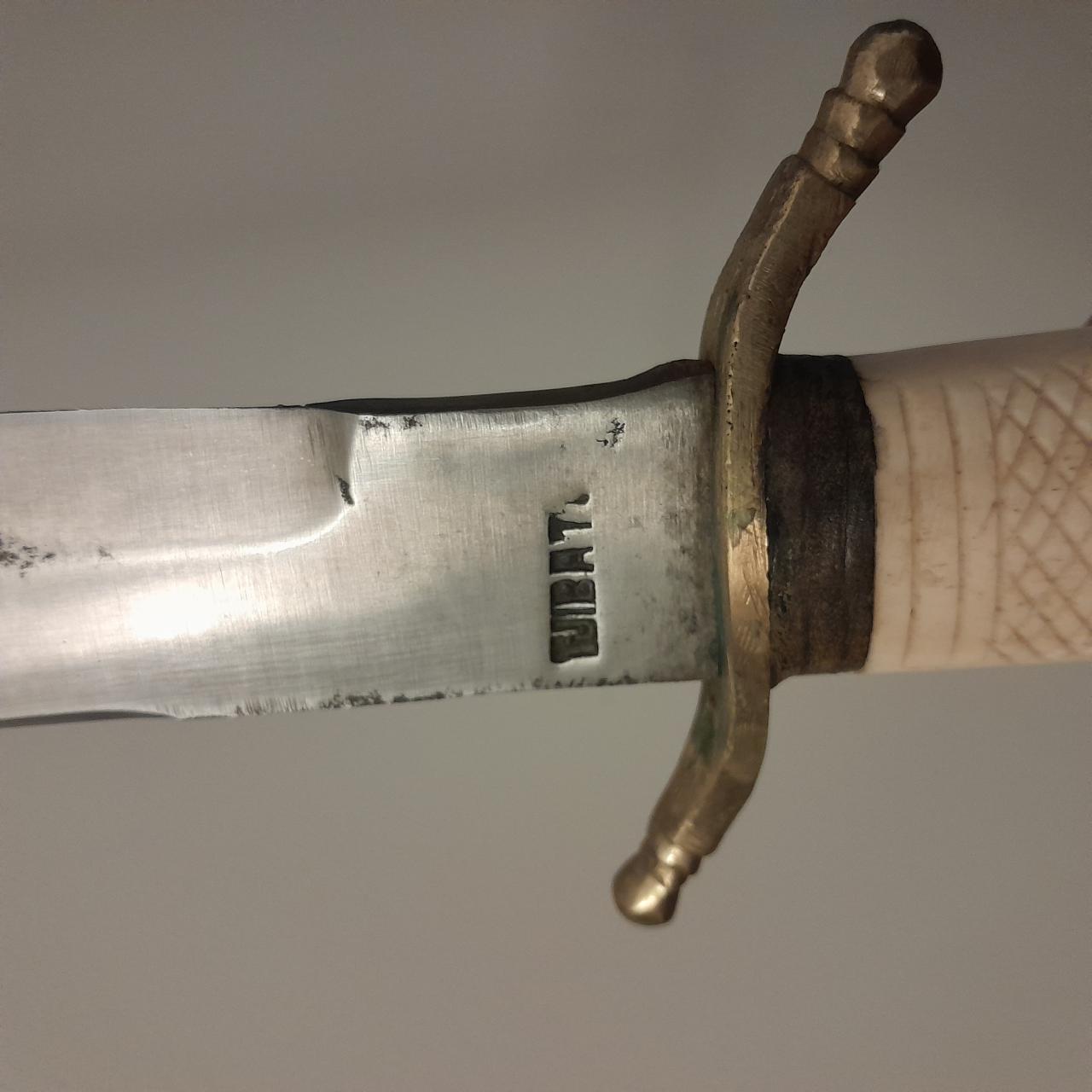

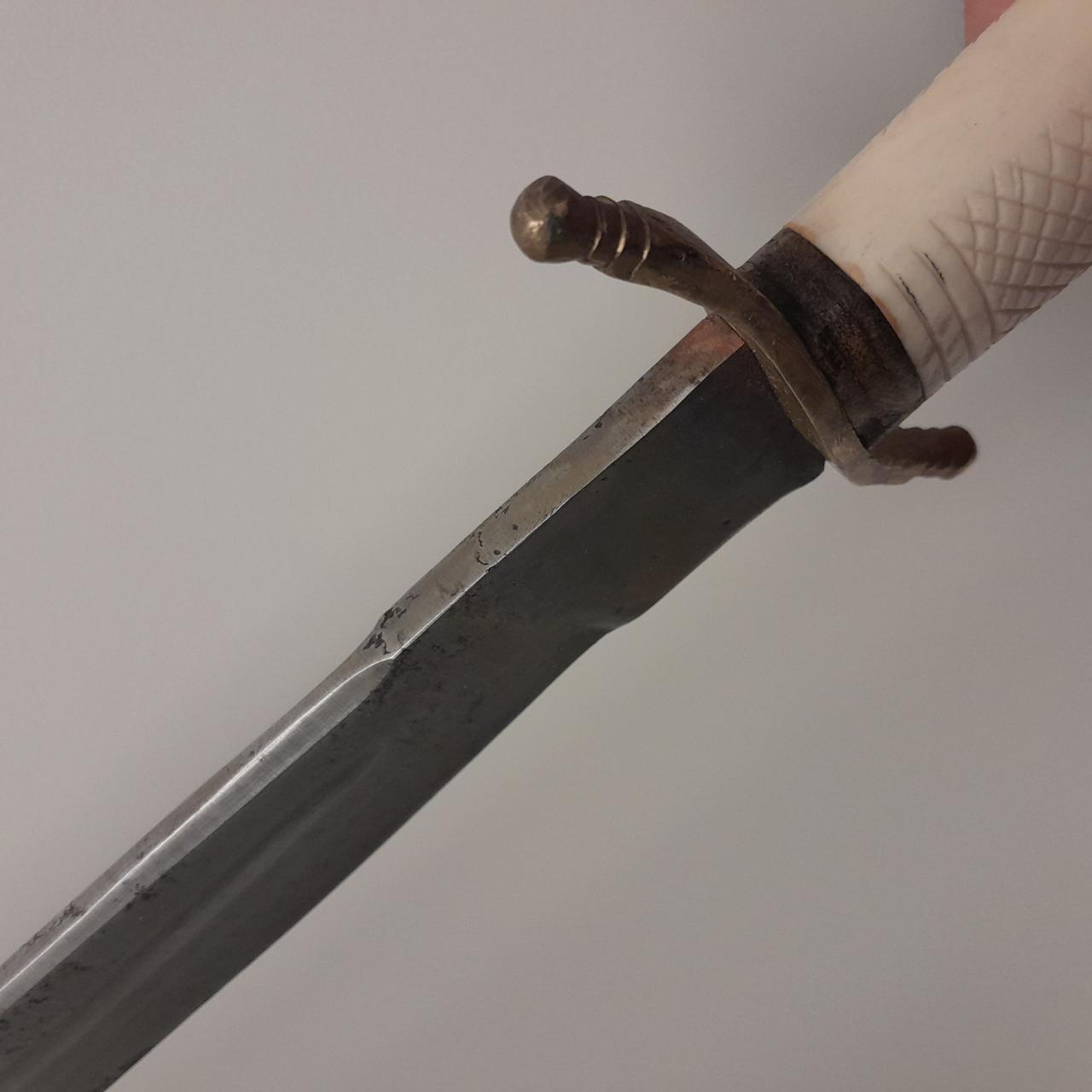

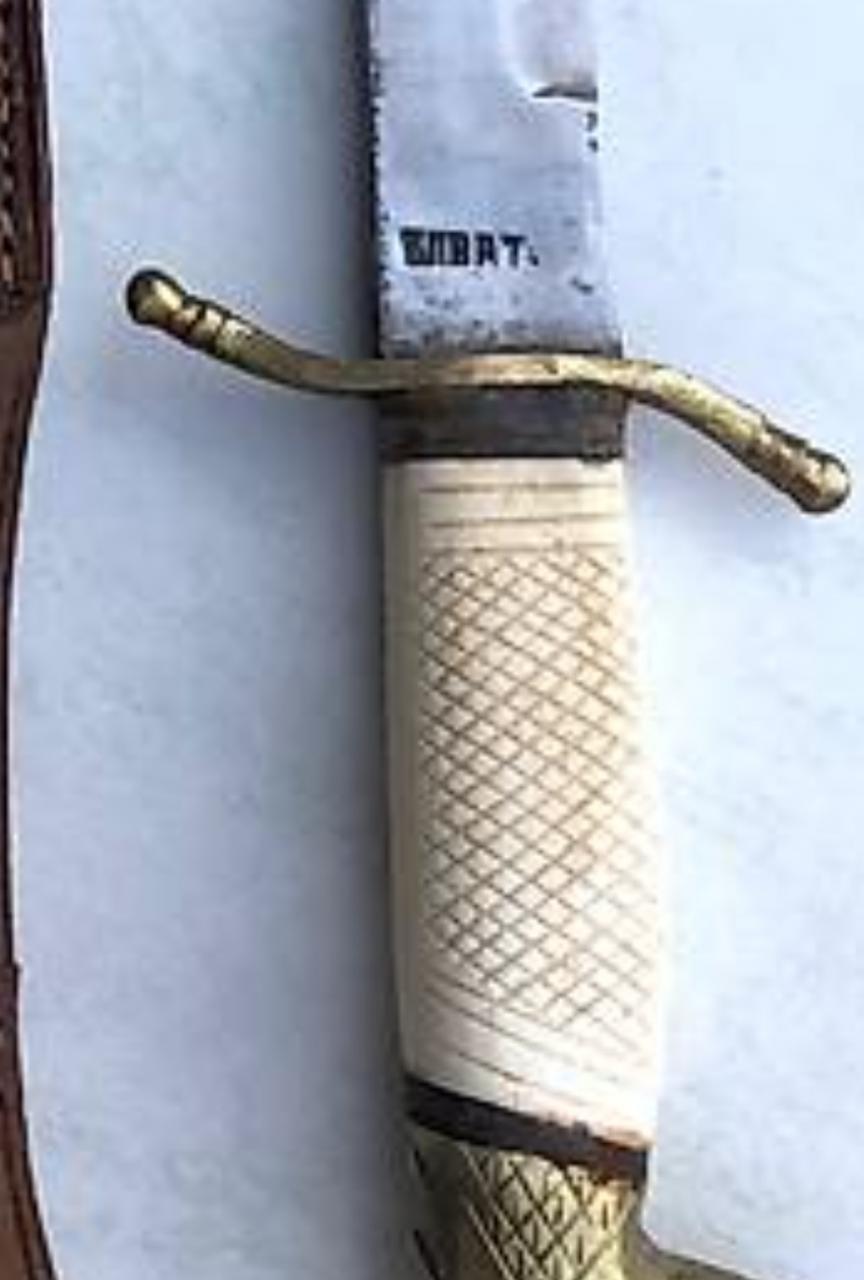

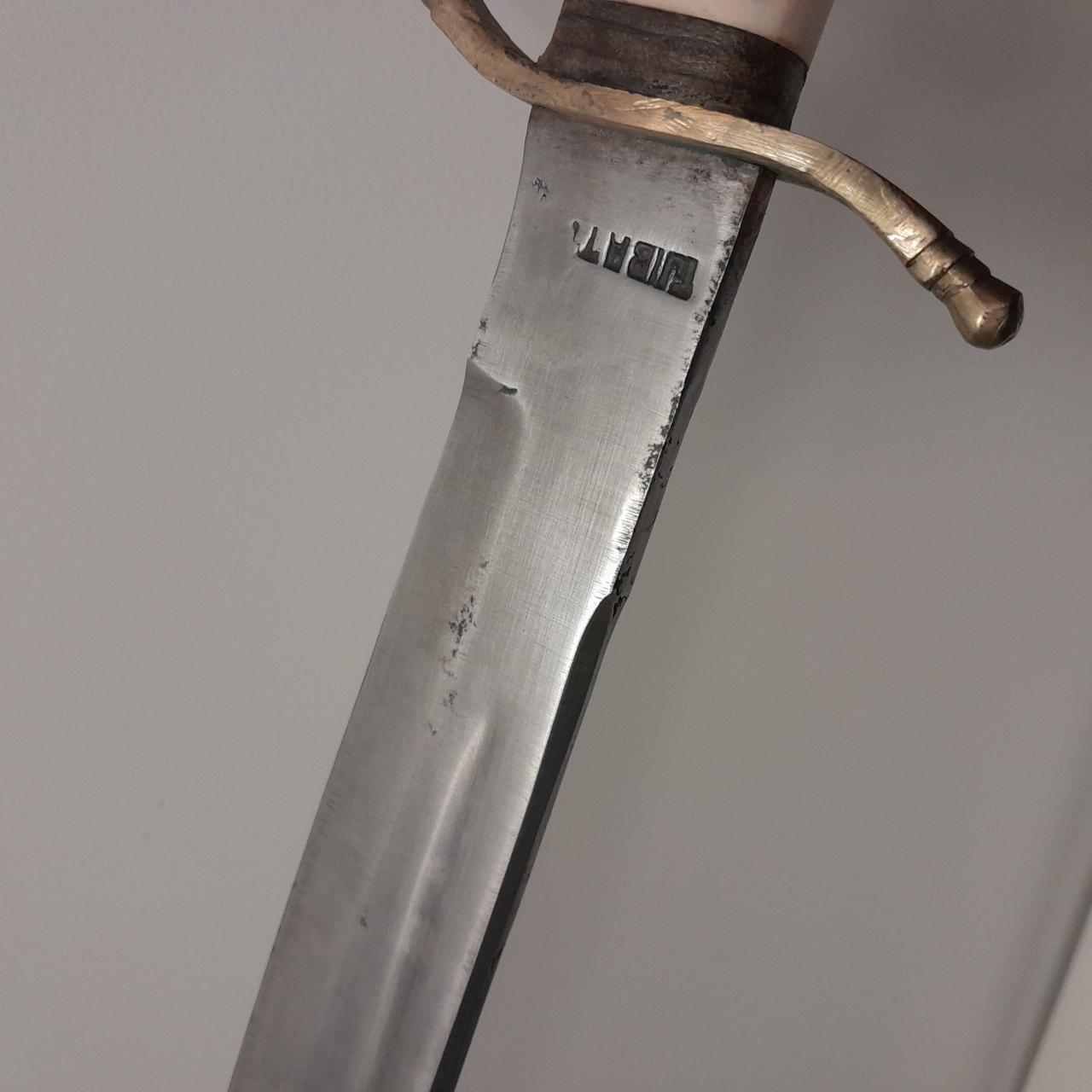

Hello everybody,
The Indonesian with Dutch influence clue seems the right one ,
Here are the other pictures I received,
I can read TIJBAT,
TIJ for Tijkeroe as proposed by Milandro ?
Marius66 is offline   Reply With Quote

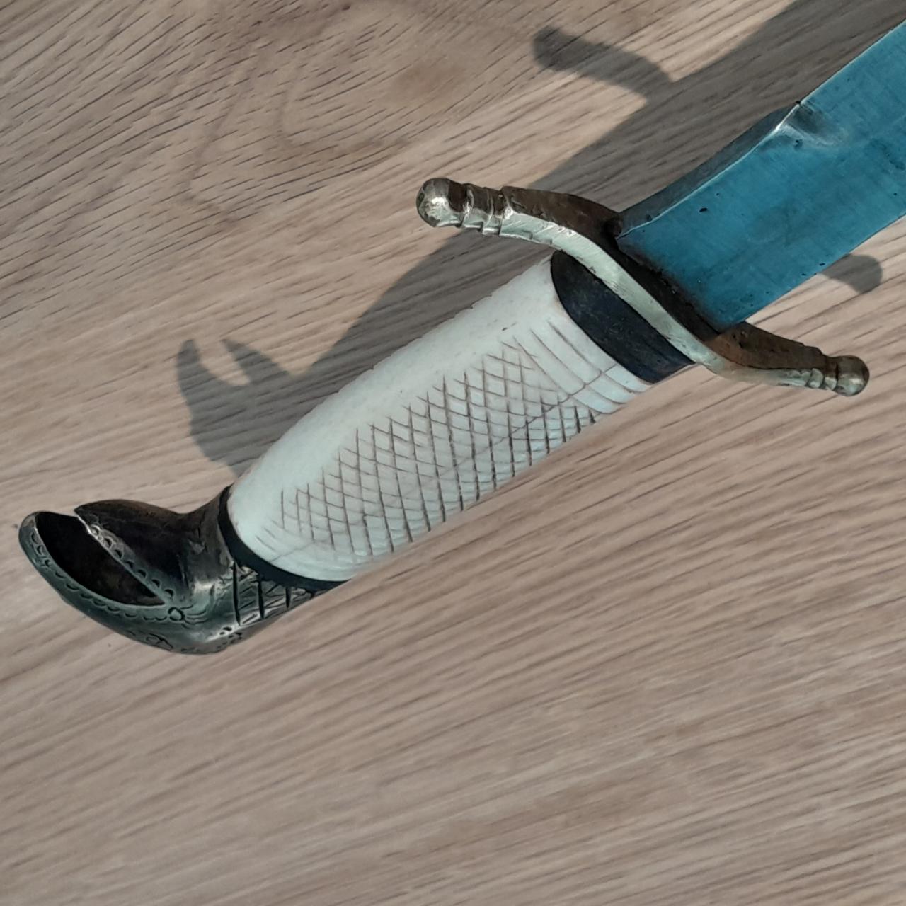

And the bird head pommel clearly looks like the Batavian model linked , thank you !
A garuda head ?!!

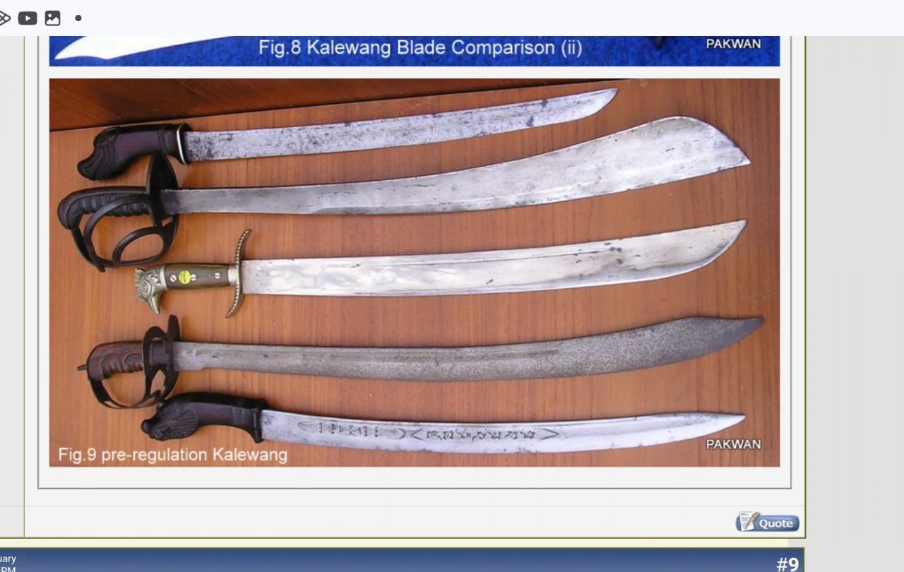

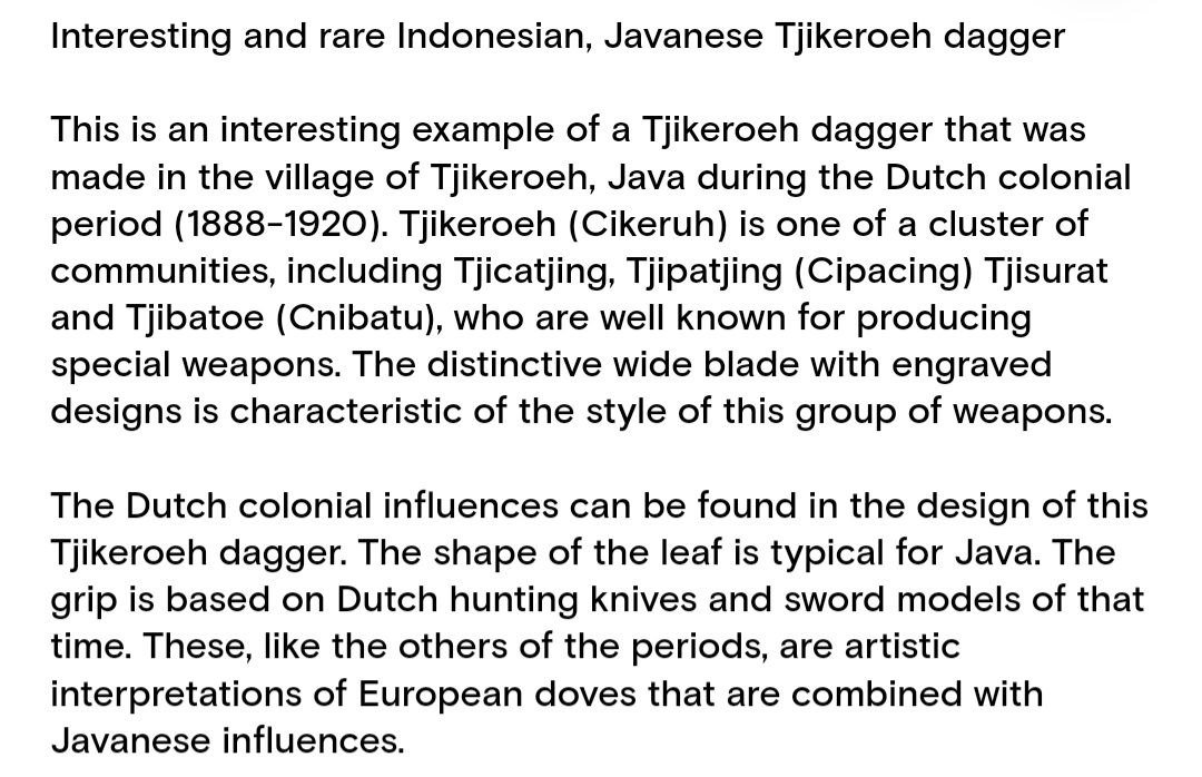

For comparison,
I found this ''similar'' one , the central piece , in another old post about klewangs/kalewangs and the regulation models
Old 26th October 2023, 08:07 AM   #13
francantolin
Posts: 969
TJIBAT simply for TJIBATOE... 😁
Old 26th October 2023, 08:16 AM   #14
milandro
Join Date: Jan 2022
Location: Netherlands
Posts: 500
thanks to the better pictures and the detective work on Tjbatoe look very conclusive to me.

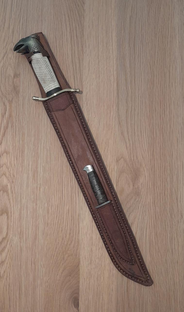

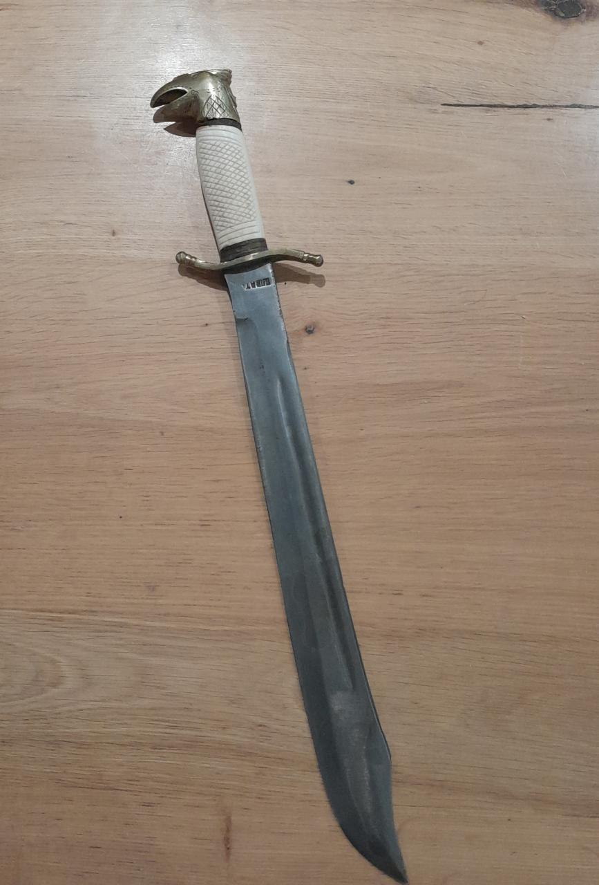

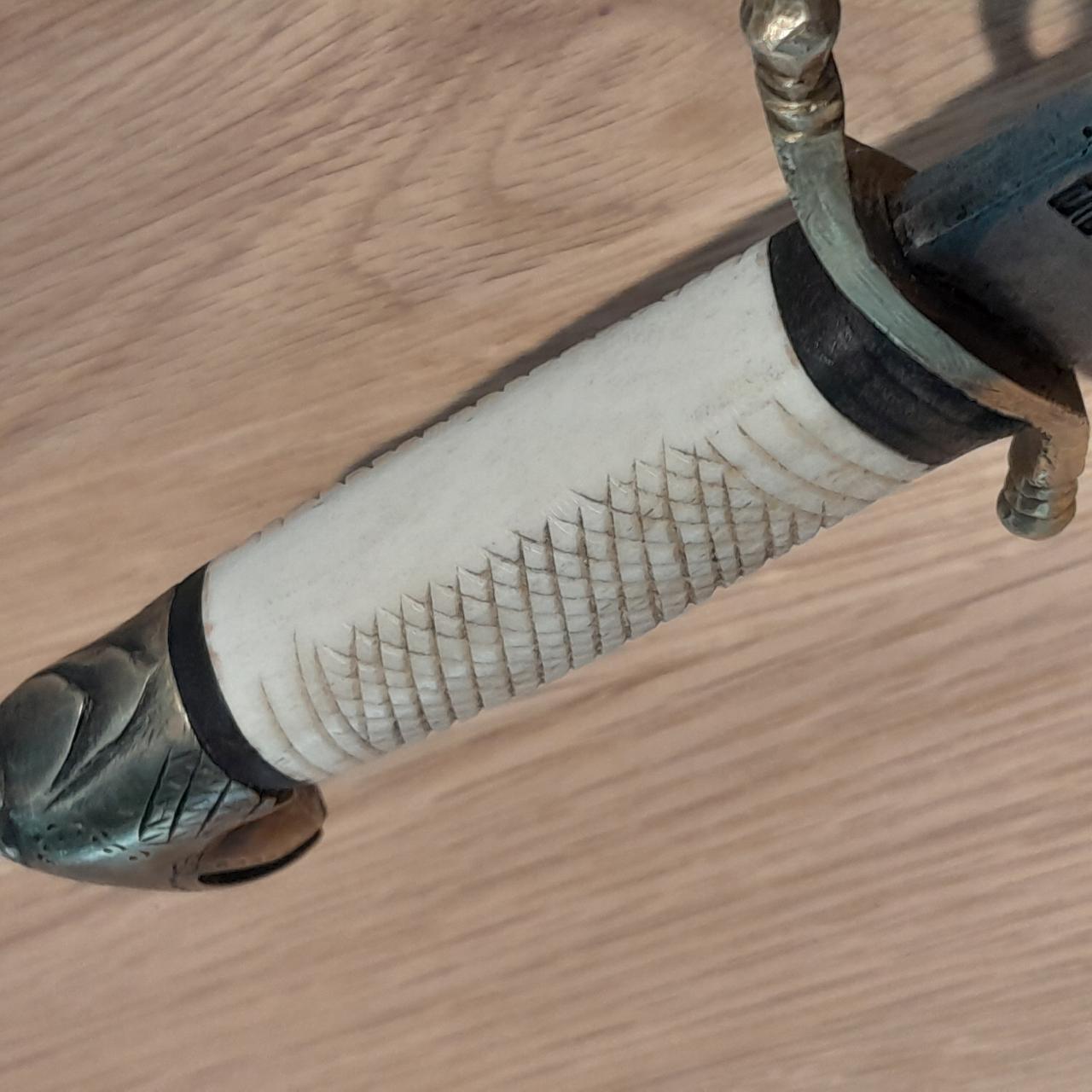

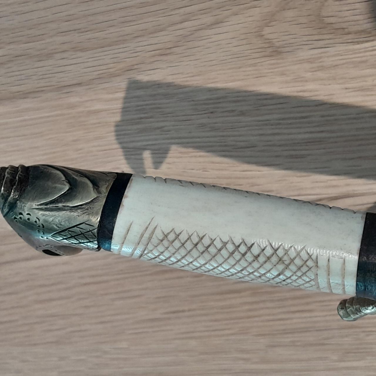

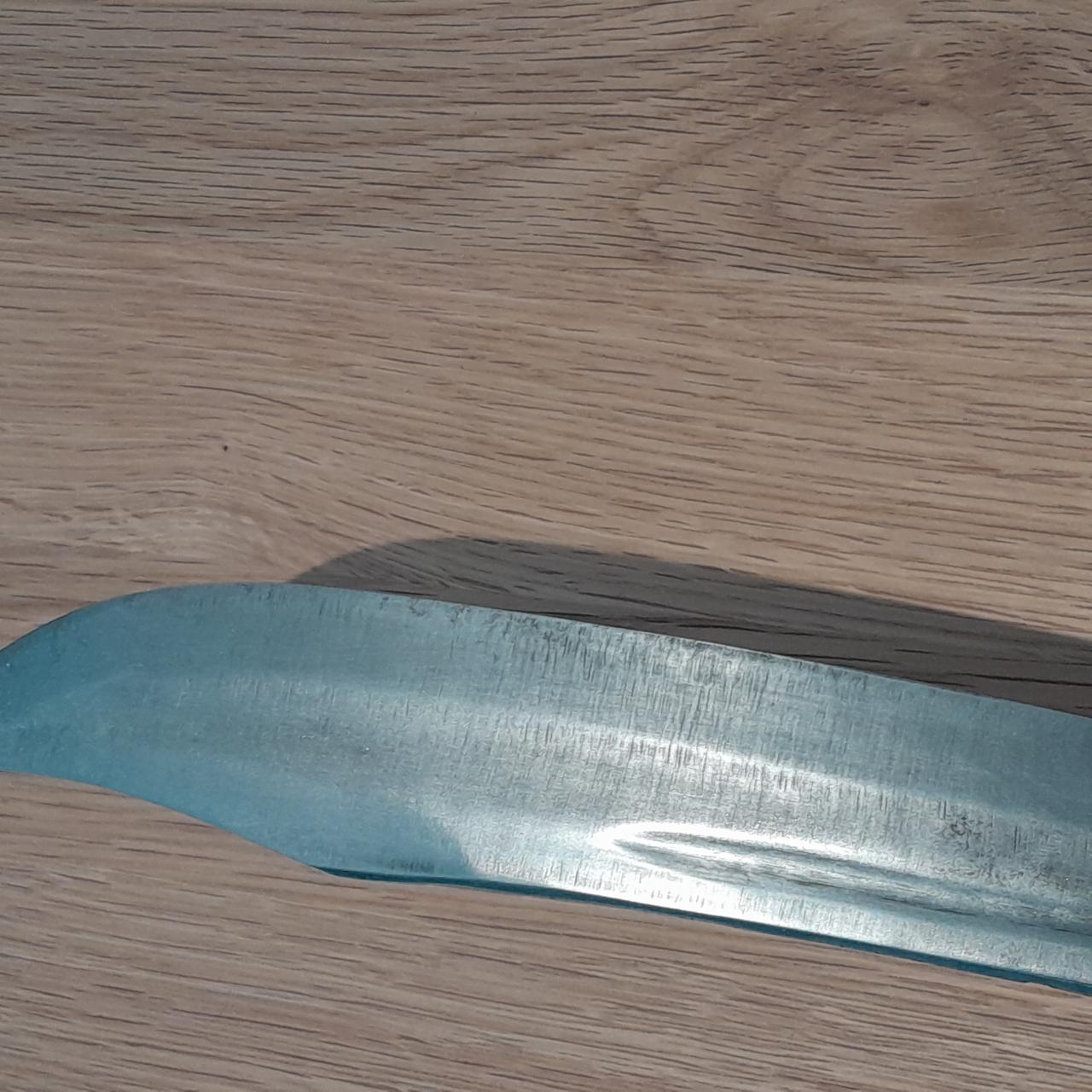

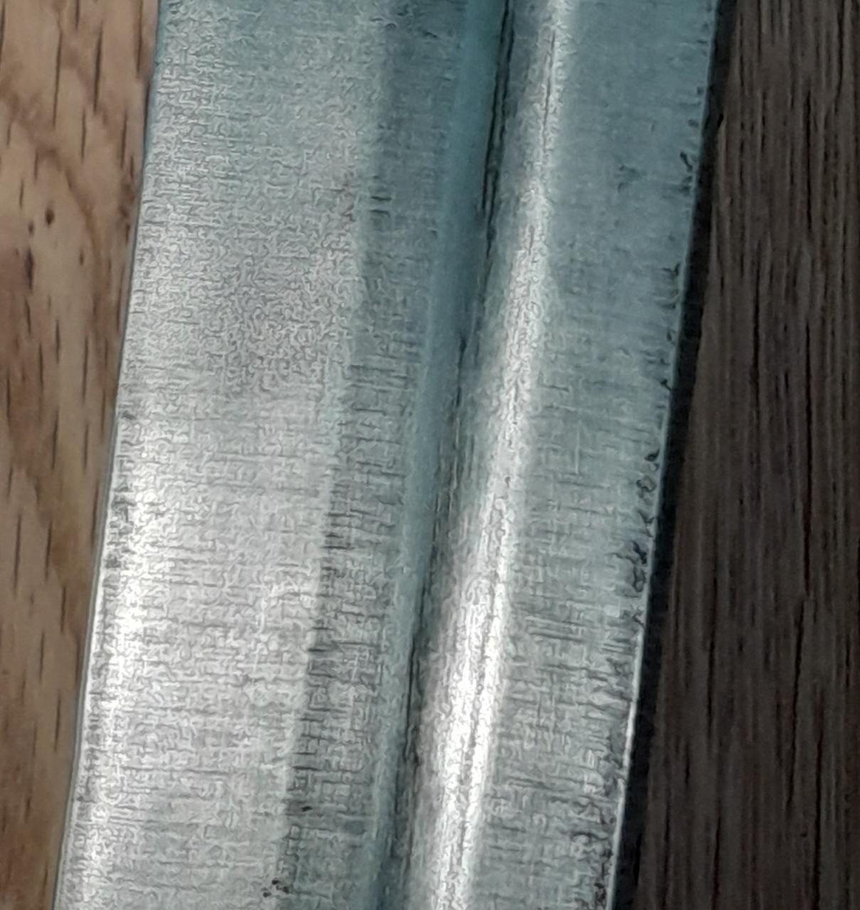

I finally received it,
Here some pictures, an heavy model, 800 gramms
/ 1,75 pounds just for the small sword/machete .
For the dates , I read that these ''VOC dutch models'' were made until 1920 but sure, it looks more something WW2
( reminds me Aldo Raine's bowie knife in the movie Unglourious bastards... )
The steel is good
Old 27th October 2023, 02:12 PM   #18
Marius66
Join Date: Jun 2019
Posts: 131
I wonder if the handle is more bone, ivory or any celluloid...
One side cracked when I cleaned it with just a little water/soap
Old 28th October 2023, 08:16 AM   #19
milandro
Join Date: Jan 2022
Posts: 500
the VOC no longer existed by this time and this is certainly not inspired to the time it existed, this type of knives made there always had bone hilts

Posts: 10,862
This interesting sword is of course IMO, a machete, and while the only thing about it that brings to mind the famed Bowie knife, is the distinct clipped point. The Bowie knife, became a prototype for heavy bladed knives across American frontiers through the 19th c. and naturally had profound influences on Mexican knives of these types. Naturally it was the presumed knife form that was the influence, not Jim Bowie himself.
There is not a real consensus on what the original 'Bowie' knife looked like, but later versions created the form we are most familiar with, having clipped point false edge blade, various hand guards etc.

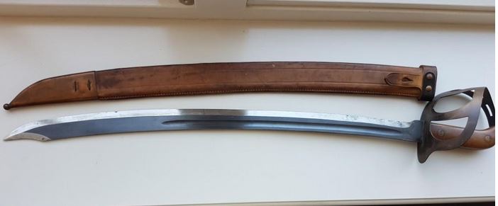

I think the Indonesian potential for this weapon, as proposed, is most compelling, despite the distinctly Mexican looking hilt, and TJIKEROE is the most plausible explanation for the abbreviated letters at the forte. As shown, the blade has distinct characteristics of the Dutch 'klewang', the military versions as 'cutlasses' used well into the 20th c.
Note the blocked forte and the distinct fuller.
As noted, the Dutch VOC was defunct in 1799, and the British controlled Dutch regions until 1814. Dutch trade of course continued and there was strong commemorative posture regarding the long standing presence of the VOC (Shaver Kool )
Adding to speculation already in place, there is always the possible cross diffusion of a Dutch blade in Mexican hilt through the ever present complexity of trade, particularly in Philippines with the clearly strong Spanish presence.
