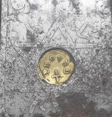

I've conducted quite a thorough test with aluminium foil and I have to say that it is effective although only in limited circumstances.
It is good for disguising light staining and does remove very light oxidisation, but I've tried this on a sword where there were actual encrustations on the blade and even the small ones are not removed by the Aluminium foil.
The foil coats them with aluminium but doesn't remove them. You end up with silver coloured bumps.
I've found that this foil technique is best for very minor staining or disguising light pitting.
To illustrate here are some pictures.
The small one shows the 'proved' mark on an 1845 sabre prior to cleaning. The aluminium foil technique isn't really like any other to be honest.

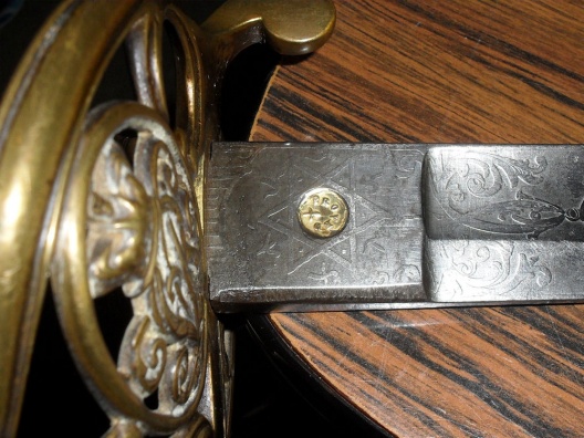

So, back to the illustrations. I found that the aluminium foil was having no effect on the visible encrustations, so I abandoned the foil and used an Xacto knife/scalpel with a 45 degree cutting edge, to carefully slice the surface rust off.
This is NOT a technique that I would recommend unless you practice it on worthless articles first as the surgical steel can leave horrible scratches on the blade if you are not VERY careful.
As I wanted to remove the rust without damaging the etched designs, it was perfect as it is 100% controlable and I could avoid abrading the high points of the raised design.
Once I had scraped/cut off the majority of the rust, I then used fine wire wool to achieve the result in the second picture.

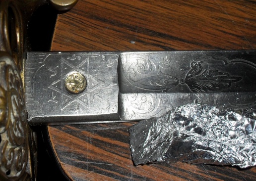

Finally (and I hope these pictures show in the right order) I used aluminium foil to give the blade a final clean up. As you can see the aluminium impregnates the sub-surface rust and almost 'fills' the minor pits.
I would recommend the technique as a final step in a cleaning process. Or for use on steel items to delicate for other processes.
Interestingly if you rub the finished surface with WD40 it sucks some of the aluminium back out of the surface. The result is still good though.
