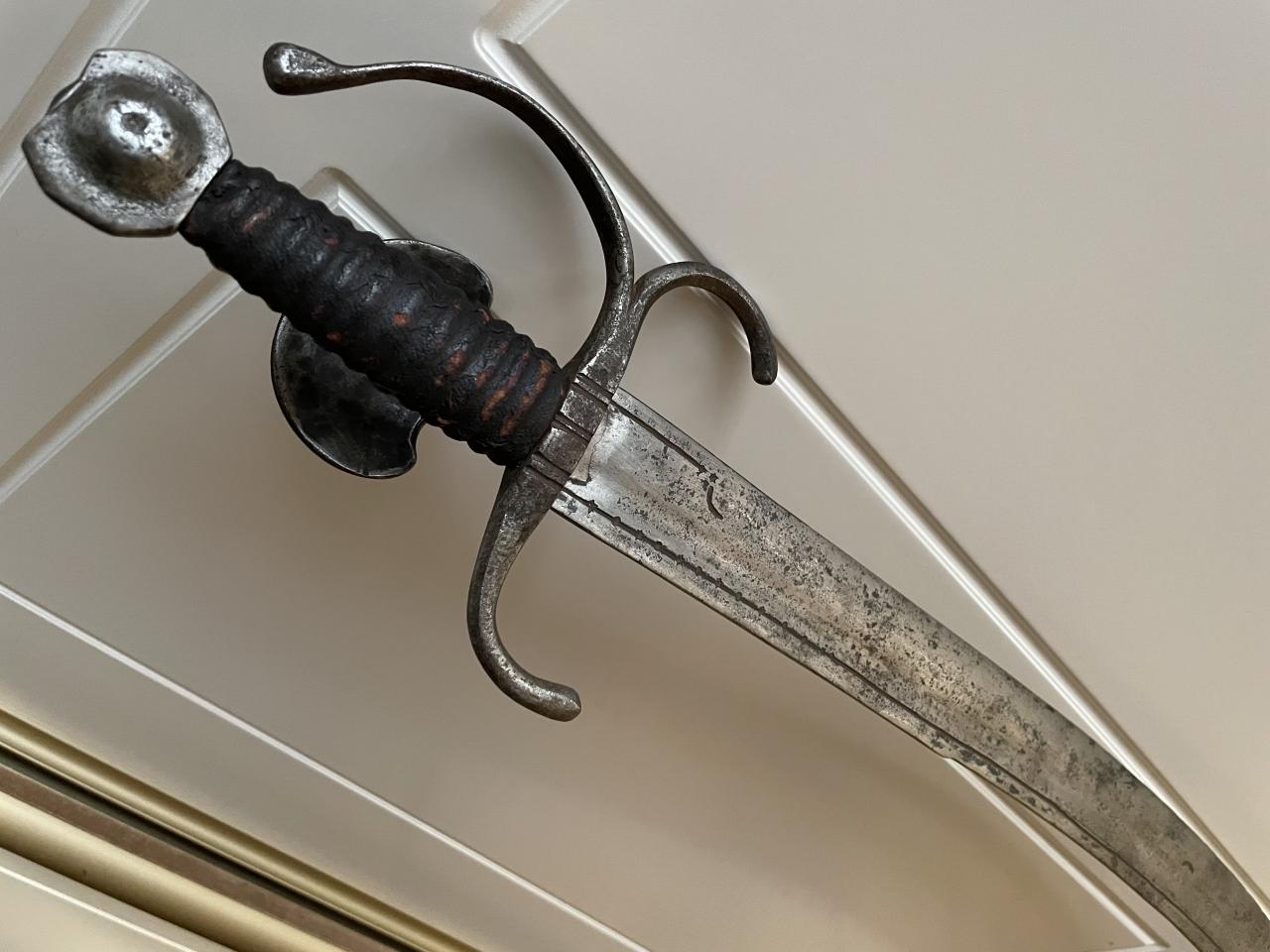

Default Italian Storta

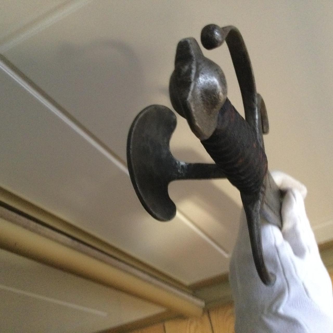

My Christmas present arrived late this year due to slow post service. It’s an Italian Storta (presumably Venetian Republic) from the end 16thC/beginning 17thC. The wooden grip is bound with rope covered with leather. It has a downward curved cross guard, from which a shell guard protrudes, and a curved knuckle guard. The flat octagonal pommel has a central boss and looks typical Venetian/Hungarian style. The single-edged blade is gently curved with a shallow fuller in its centre on both sides. The blade has three thicknesses with a slight recess after the first quarter and a 19cm false edge toward the tip. The blade is decorated with lines and moons and stars at the top and at the bottom. There’s a smith’s mark stamped on one side within three stars on either side. The overall length is 83.5cm (hilt 13.5cm and blade 70cm) and weight is 0.8Kg. The sword feels very sturdy in hand and handles well. Ideal for use in cramped conditions on a ship or galley.

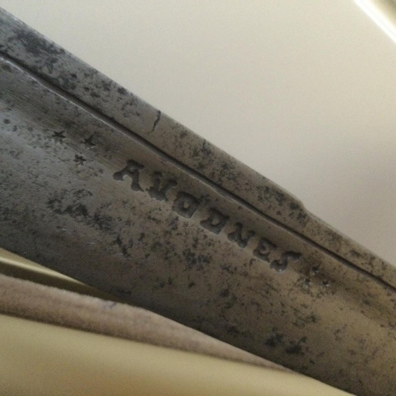

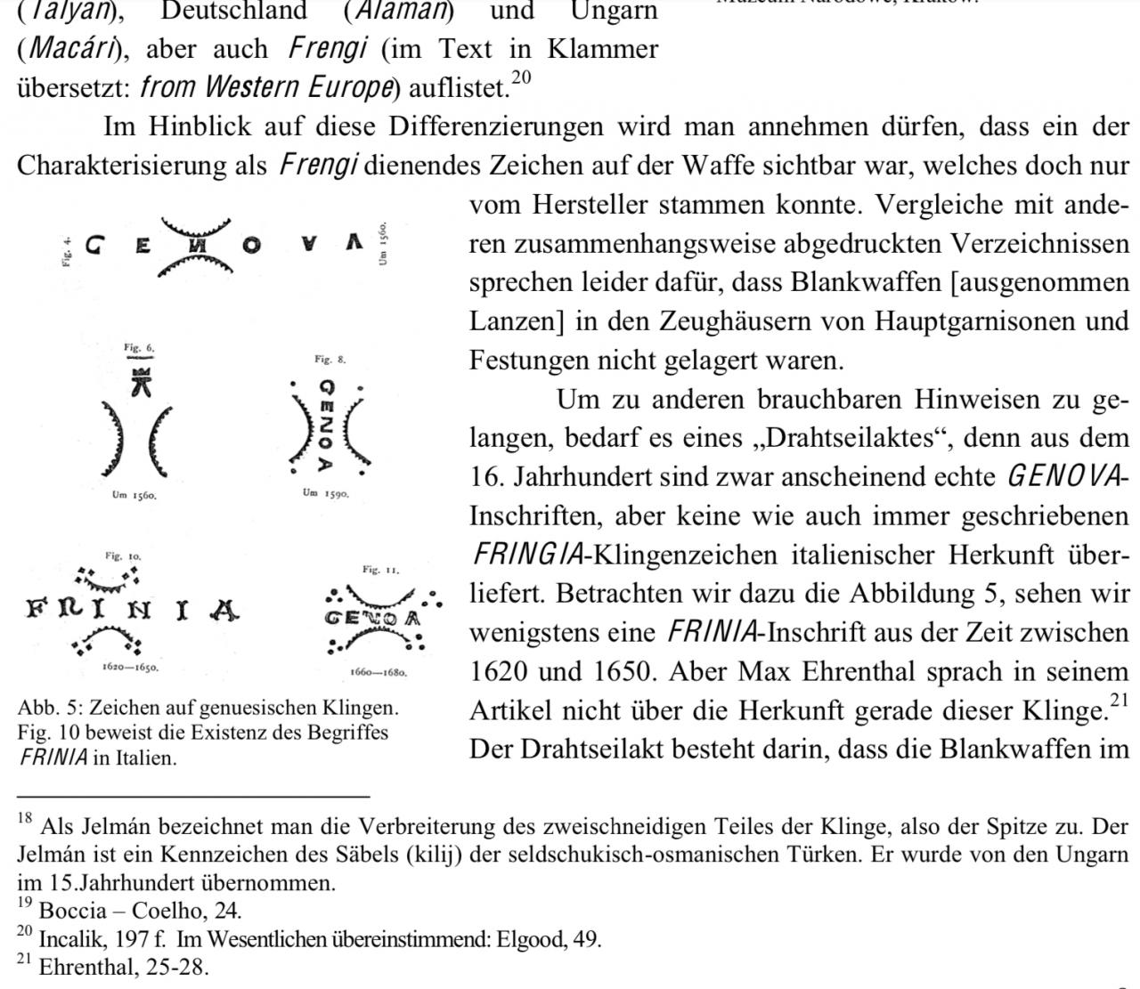

Posts: 790
I scratched my head to understand the meaning of the smith’s mark stamped on one side of the blade. It dawned on me that blade smiths in 16thC often had poor literacy. It seems to me that the letters are in reverse order (read from right to left) and the letter S has mistakenly been confused with the letter G (quite similar but with the lower loop closed). The text between the stars on the smith’s mark then reads G E N D O V A or GENOA in today’s standardised spelling.
In “Fringia Die endlose Geschichte einer Klingeninschrift” by Friedrich Jäger (2013) he mentions multiple Genoa marks spelled as GENOVA, GENEVA, GENEVE, etc.

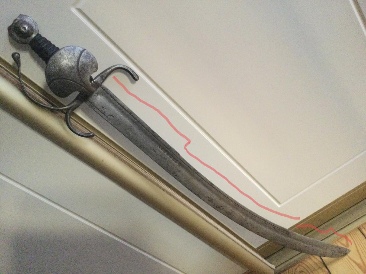

Sword #47 in the picture above is a falchion. The author Mario Kovac writes that in German this sword is called malchus. He writes that the purpose of the swords were different so they are built differently. He says the main distinguishing feature of the Storta is that this single bladed sword loses its spine near the tip where it forms a false edge like a sabre. The falchion is also single bladed but has a clipped tip. In “A Guide to the Arms and Armour Collection in Cesta Castle, San Marino” (1969) G. Giorgetti allegedly claims falchions were typical weapons of the guard of the Holy Inquisition but the author questions this. [I hope I got this right as I used Google Translate]
My sword, which is a Storta, has a fairly thick spine so I think it’s meant for some quite heavy cutting in close combat. The blade is wider than my 17-18thC hussar sabres. What’s interesting with this blade is it’s wider near the hilt for strength with a step decrease after a quarter of its length and then the spine disappears in the final 19cm into a false edge like a sabre.

Italian arms makers and armourers were known for their innovation and styling, and highly influenced arms not only throughout Europe, but in many cultural spheres through trade. It is interesting to see the guard system on this which corresponds to Arab sabres (known as 'nimchas') as well as vestigially in the Sinhalese kastane.
Also as you note the pommel which remarkably resembles those on schiavona with the central boss.
This is an amazing example of the storta, and as noted, it was meant for heavy blows in close quarters,. the marking on the blade too is remarkable. I have always understood that GENOA was often on blades regardless of what city or center had produced it as this was the port where they departed into trade networks.

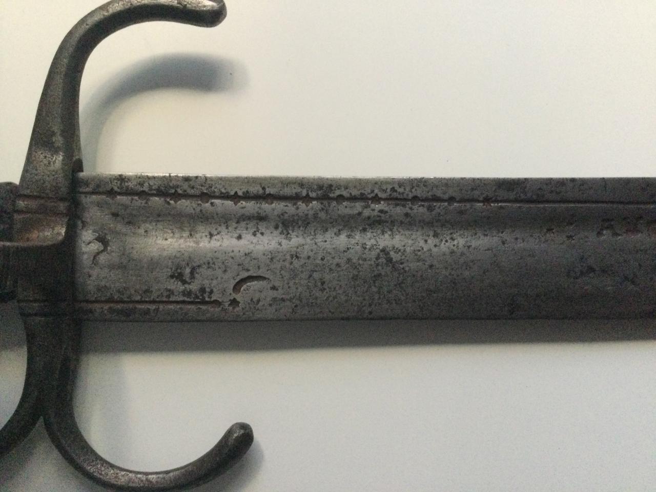

Originally Posted by Victrix View Post

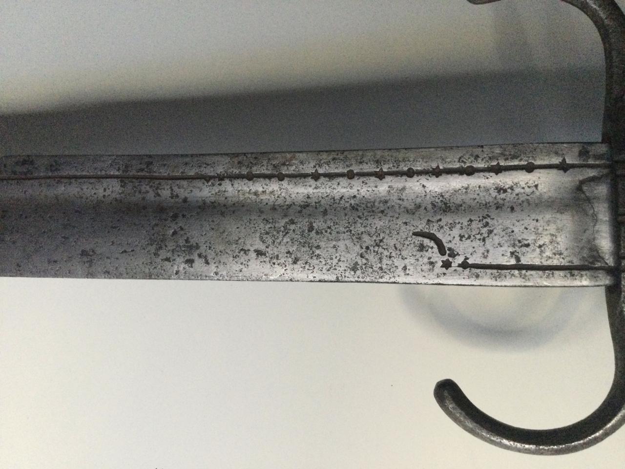

There’s also what appears to be a shooting star or perhaps it’s a star with a new moon. This looks oriental to my eyes and Venetians did a lot of trade with the Ottomans and so probably got some cultural influences from there in the process.
The shooting star is, I think, an elaborated variant of the engraved ornament appearing on the ricasso of many type XIX blades. Many of these are Italian (or Italianate), and the ornament first appears in the 14th century. If it was in any way inspired from a non-European style, the transmission occurred very early.
Usually the final detail is simply a point, or small circle, not a star. I can at least share a 16th-century illustration from Spain of buenas espadas antiguas, showing the "shooting star" style.
Thanks for sharing your handsome storta!

Old 31st January 2023, 04:04 PM   #12
Posts: 10,867
Thank you for adding the additional marking note, which is celestial in nature, a moon and star. These kinds of marking were well known on very early Italian swords, and I believe I recall one on the hilt of an Italian sword of this period.
The use of celestial markings on blades by makers or sometimes perhaps as a form of imbuement goes back well into antiquity, and of course there are distinct associations with astrology. While astrology was indeed popularized in Eastern context, it is not necessarily isolated to their use.
Because of the use of the moon and star(s) by the Ottomans, it is often assumed that these symbols indicate that context is specific to them.
Actually these celestial symbols were well known throughout Europe independent of that influence. For example, the Szekely of early Hungarian ancestry were known to have used the celestial theme in their symbology.
I do not have "Armi Bianchi Italiene" (1975) handy at the moment, but I feel certain similar markings are among the detail on Italian markings.
The moon and stars symbols, became well known in Germany as they adopted many markings and inscriptions etc. for their blades and sometimes makers markings.
This does not apply to this storta as it is clearly Italian, and again, IMO a superb example.
Interestingly, the attribution of moon and star markings as 'Turkish' is an often occurring trope in the west is seen in an article in "Man at Arms" magazine (" Revolutionary War Swords with Crescent and Star Blades"). A number of swords with markings comprised of these symbols are described as 'Turkish', when in fact these are actually German blades, and variations of these celestial elements.
In Kinman (2015, p.133) this exact marking is seen deeply punched on blades of two German broadswords c. 1530, so the early Italian source for the German markings is suggested.
* Mark, just saw your post as I entered this, very well noted! It is worthy of note that Italian observance of celestial phenomenon gave us the Tarot cards with their notable use of these kinds of depictions.
Mark
Mark, many thanks for sharing that information. I think it puts the decorations on the Storta in context. I assumed the symbols were oriental influence but look to have been used in Italy for centuries before the sword was made.

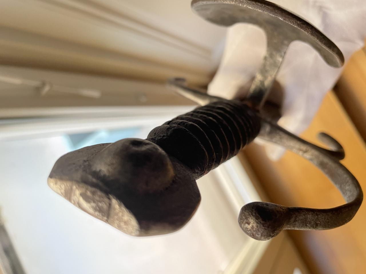

Originally Posted by Radboud View Post
That's a great-looking sword Victrix!
Thank you for your kind comment.
I attach a picture again (for all) which shows the spine of the sword and how it disappears into the false edge. As you can see the spine is quite thick. Strong sword. Feels great in hand.

There’s that shape on the blade spine again.
