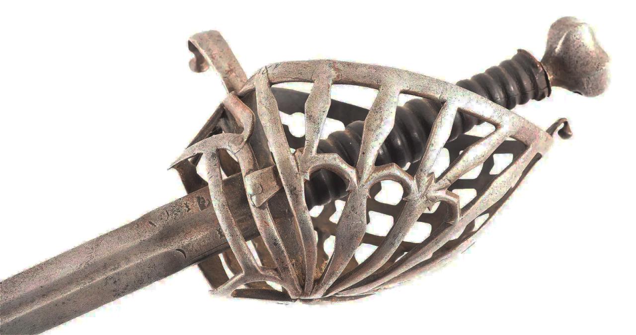

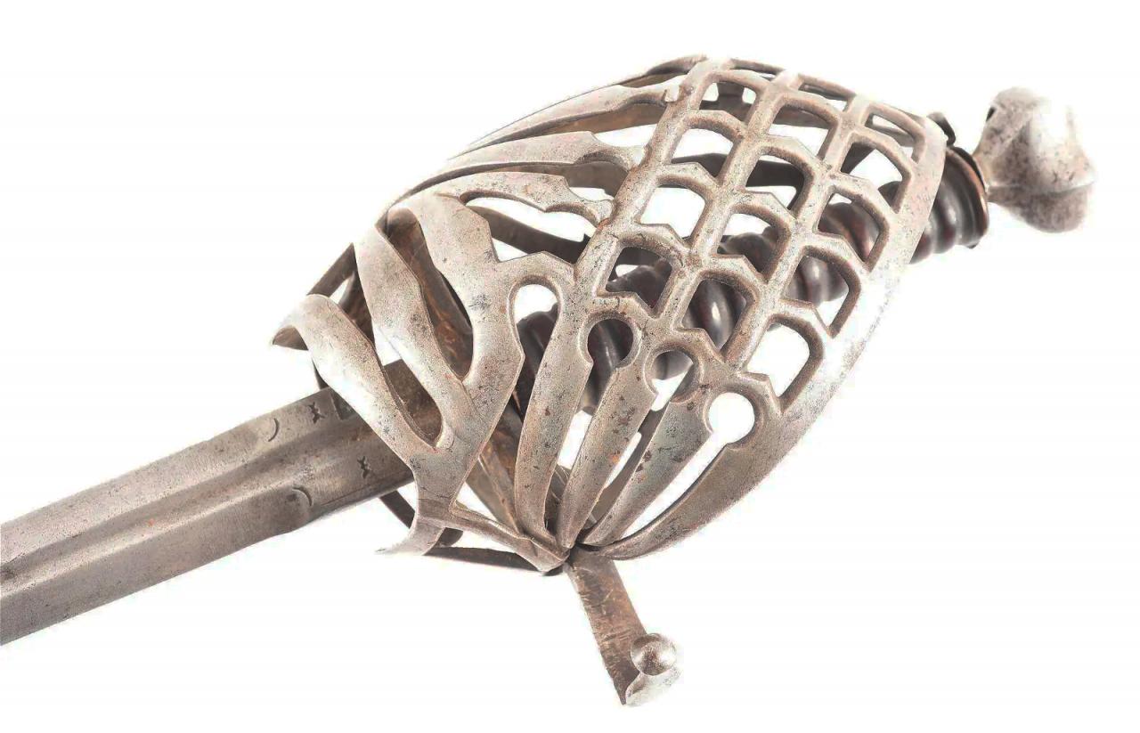

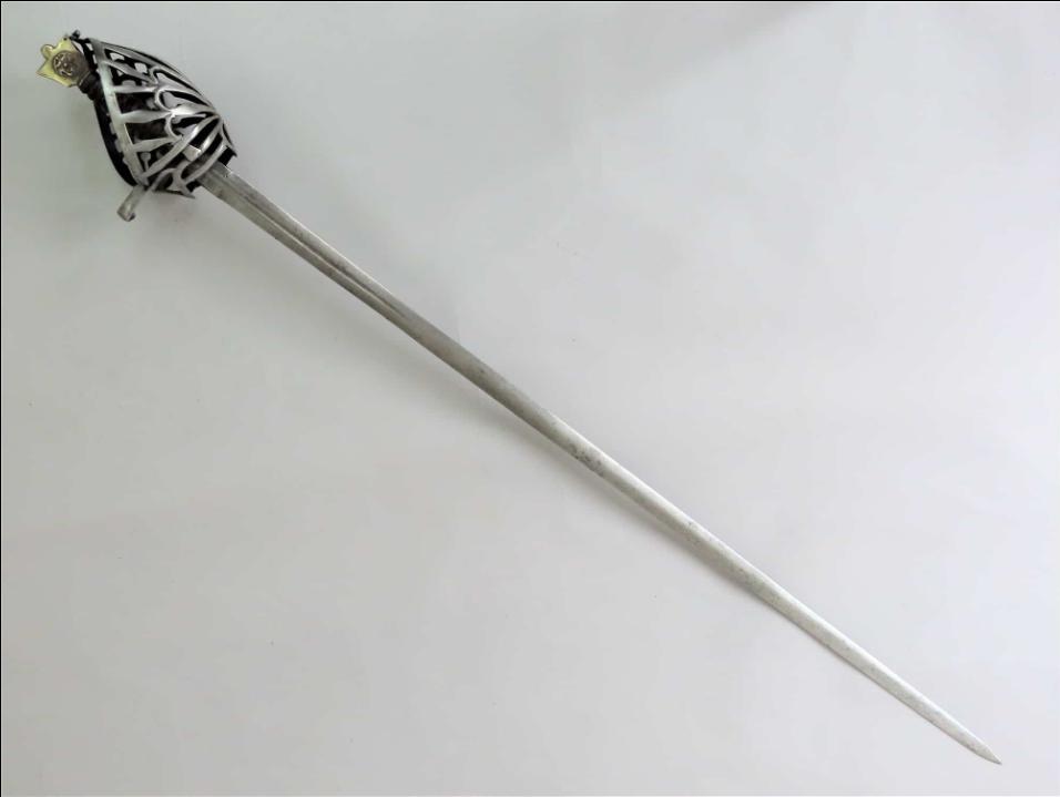

I finally found my schiavona and it is bought and paid for.
It has, however, some unusual markings - to my eyes anyway - and some very unusual markings too.
Can anyone cast any light on their provenance and meaning.

Congratulations, that's a lovely sword. I was also sorely tempted when I saw it on the sellers site.

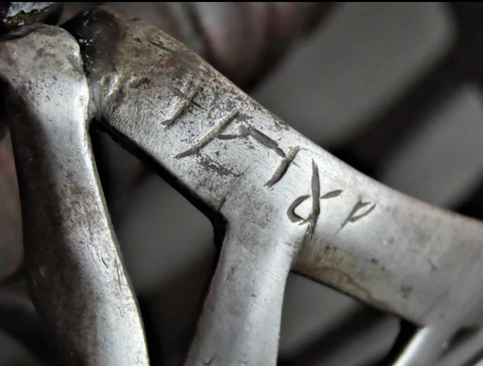

Congratulations on your beautiful sword!
I belive that the markings on the hilt is Medieval Bosnian script (now extinct) once also used in Dalmatia, which likely spells the name of the sword furnisher. See: https://en.wikipedia.org/wiki/Bosnian_Cyrillic. We have discussed this on the forum before.

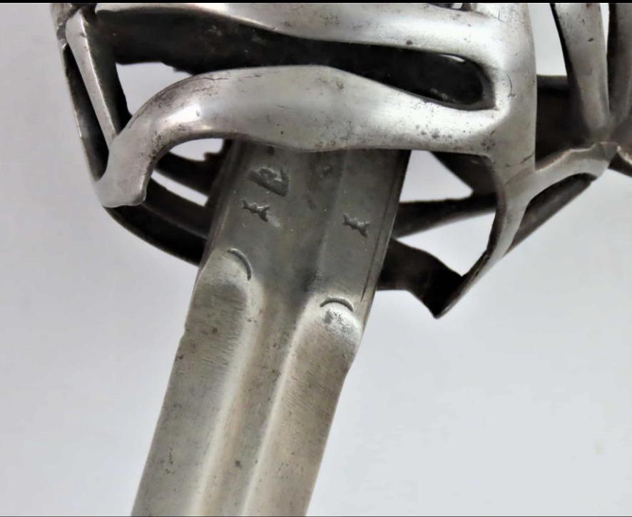

Well, thank-you all for that speedy resolution to those markings.
How about the blade markings? They are a mystery to me; can anyone shed any light on them.
Does one assume this sword had been made for the Venetian market?
Assuming further: if the sword is from around 1780, could the blade have come from Klingenthal?

the name Grgur is engraved on the basket of your schiavona. It is written in Croatian Cyrillic or the so-called Bosančica. Grgur was a Croatian master blacksmith who made these complex baskets. The schiavona you bought does not have the original pommel. This is a subsequently cast and patinated pommel. That schiavona had another pommel even before Albanarms resold it. :/

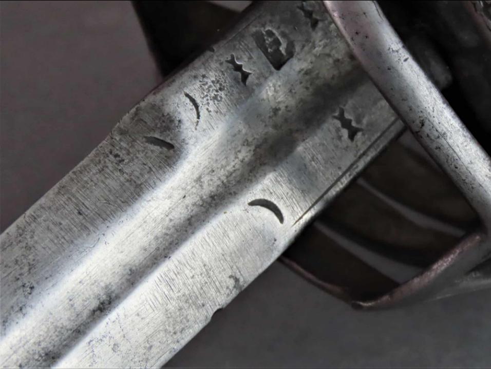

I realised the new pommel was a casting as it still retains some of the flash. Tony indicated this in his description.
It is obviously an Italian (Belluno?) heirloom blade re-hilted in the second half of the 1700s.
Do you know where Grgur worked?
Even accepting that the blade is much older than the hilt doesn't explain the markings.
Are you familiar with the blade markings?
Jim McDougall gave me some fascinating info:
The arcs seem to have been around since the late 1400s, at least on one example attributed to Pippo and C. so they were probably added here to pretend a venerable past as I assume there were no such blade types around back then.
The TWIGS, as they are sometimes called, also date back to a similar time and used to come in groups of three similar to here.
The sword Jim referenced came from the 'hall of the Council of Ten'.
It seems likely that all of this was done to exhibit reverence to a sword for a member of the Doge's bodyguard.
The blade has seen considerable activity as the edges show long curves of grinding in places to remove nicks: very nicely done.
Incidentally, the basket is rather small and is a snug fit even for my rather petite hands.

The markings, as I have noted, are distinctly Italian, and of varying examples of what Sir James Mann (Wallace Collection, 1962) terms the 'twig' mark. These often in subtle variation but always the triple lines across a horizontal bar, were common on Italian blades from the late 15th century, through the 16th and later continued as approximations spuriously as often the case.
"..these twig marks were commonly found on Italian blades, as well as occurring singly" (Mann, 1962, p.255 op cit), as he notes they often appear in groupings of three. It should be noted that these also occurred in various configurations and groupings with other marks (such as the indistinguishable punzone on this blade).
Mann (p.255) also notes "loop shaped marks at base of the blade" as possible (probable) variations of the well known 'sickle' marks typically (and incorrectly) distinguished as exclusively Genoan. It is noted that these marks (presumably the 'loops') and 'sickle' are often found on swords to the armory of the Doge in Venice.
Here I would note that markings on blades are not necessarily to a certain blade maker, though certain ones seem favored by particular makers. In actuality, while we cannot know exactly what these sundry markings meant or represented, it may have been as simple as a certain stamp being at hand or other. Makers either had their own forge and shop, or worked in those of others, in which case, the markings or their variations/groupings may have distinguished a certain worker and accounted for his work to his master.
Many markings may have had deeper, more complex talismanic or other origin, but over time they suggested quality that became associated with a certain makers blades, with the known meaning lost over time. Often markings are suggested to have guild associated distinction, and while this is somewhat correct, typically it was only registered punzones with this case.
Other markings like the sickle or 'Passau wolf' were simply long recognized symbols in the quality imbuement convention noted.
In all, a wonderful example with remarkable history to the notable State of Venice and its Doge's. While most examples to the notorious and feared 'Council of Ten' are typically marked, this example is with that context in degree.

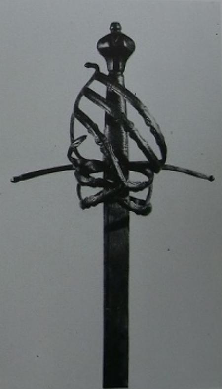

Looking through rapier hilts in Norman showed a few examples of that pommel (note the hole to accept an arm) so I wondered if the blade had originally had that pommel and a typical rapier hilt was subsequently changed for the schiavona basket.
I don't know if the spiral fluted, leather covered, wooden grip was ever used on rapiers in the early days; I have seen it frequently on schiavonas, so maybe that was added as well.

Following - again - Victorix' link to an early thread I came across this in post number 46:
