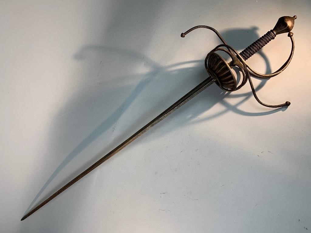

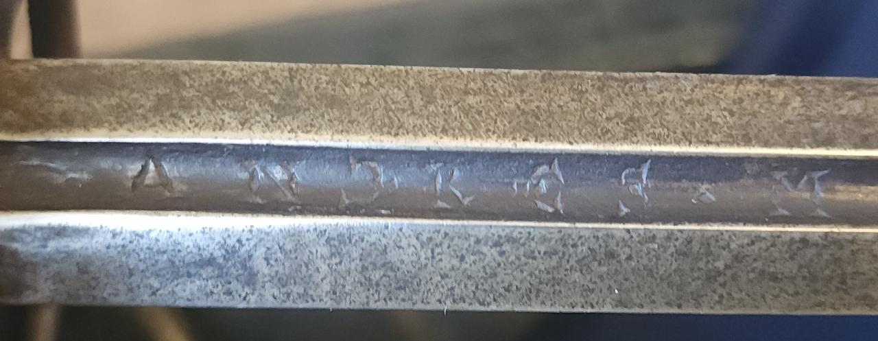

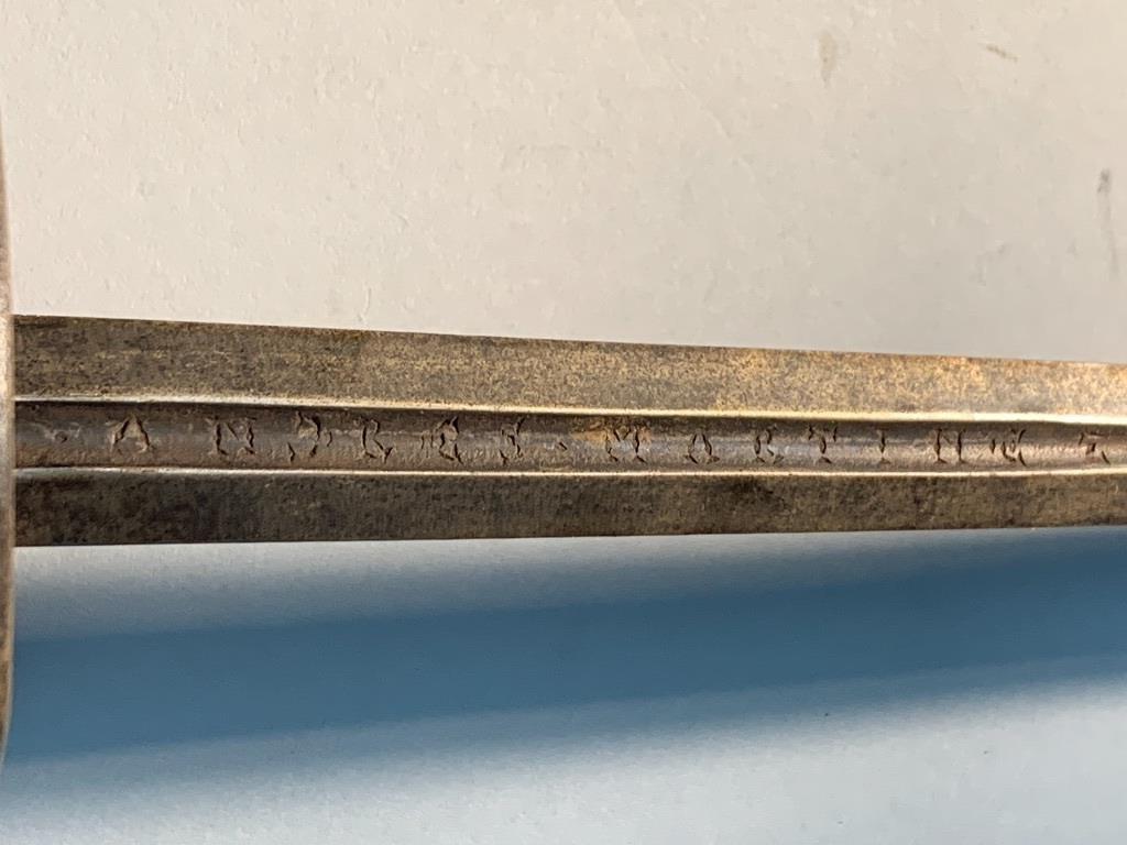

Good afternoon all, I am looking for information on a Spanish sword smith that signed "Andres Martinez". Does anyone know of other examples of his work, any details about his career, or what years he was active? I was able to match the name and marking on a particular sword of interest to one of the Toledo armory catalogues (Andres Martinez) but have not been able to find much additional information besides the fact he is the "son of Zabala (de Garata)" which is not super helpful as there seems to be a younger and an elder by the Zabala name. Would love to hear any thoughts y'all might have.

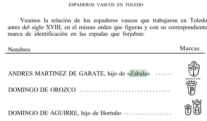

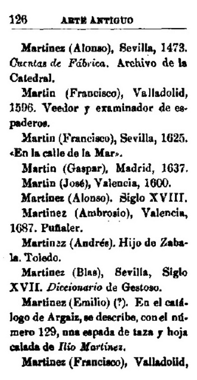

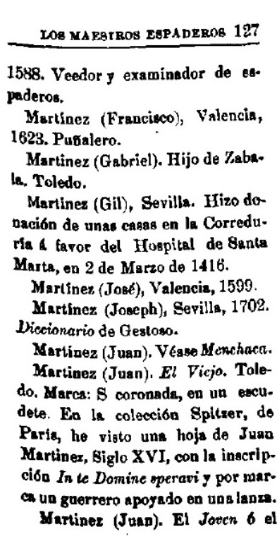

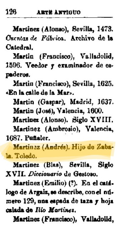

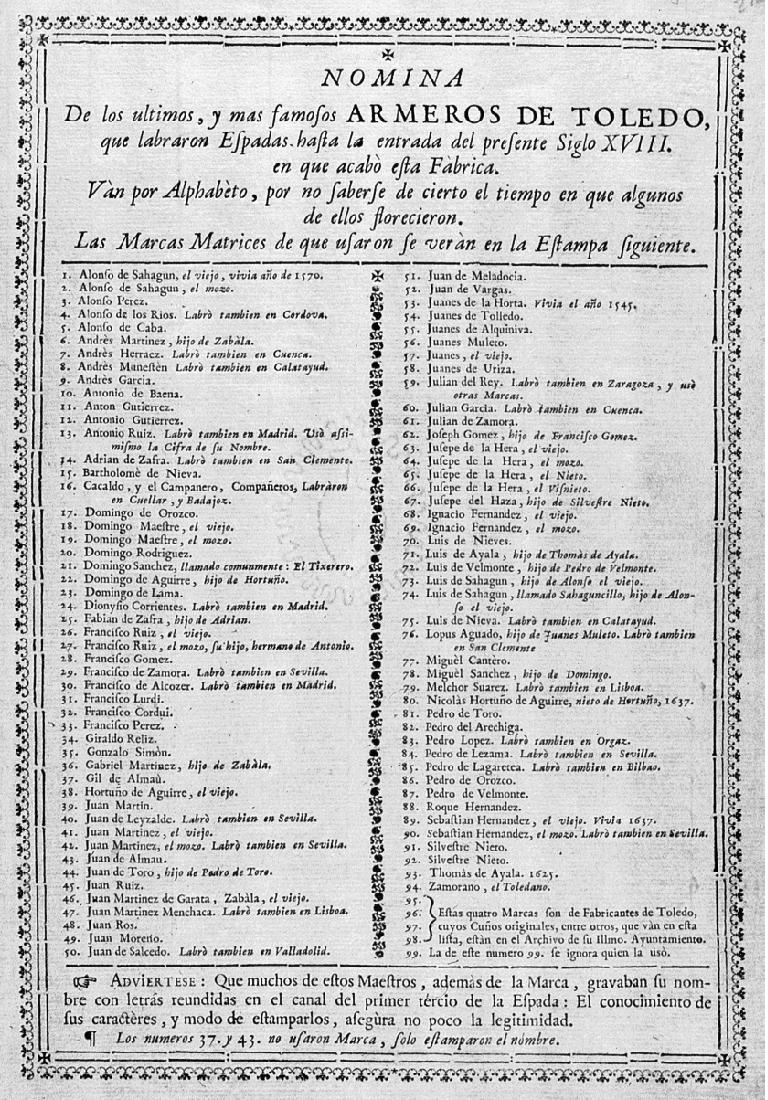

Welcome to the forum, Michael . A bit confusing indeed. in Ramiro Larrañaga's work he extends this smiths name to ANDRÉS MARTINEZ DE GARRATE. He and his brother Gabriel (36) are sons of ZABALA. It could be that their father was JUAN MARTINEZ DE GARATA, ZABALA (46). We could consider that he is called el viejo (elder) by Palomares, to help distinguish him from JUAN MARTINEZ el mozo (younger) (42) in the table by their age, but not because they were familly.
Note that this is not 100% exact. It is known that the Palomares nomina contains a few inconsistencies. One thing we know as certain is that of JUAN MARTINEZ, that was active at an early stage, as listed in Lhermite's work (end XVI century), whose marks he describes are precisely the ones shown nowadays out there. Yet in Palomares nomina we can find not right name neither his full marks, which i suspect is listed in the table as JUAN MARTIN (39).
Confusing indeed .
Other members will know more about this riddle.

I greatly appreciate the information Fernando, I never even considered that the two Juan Martinez's might not be related. Would also love to know what the meaning behind the words "Garata" and "Zabala" are.

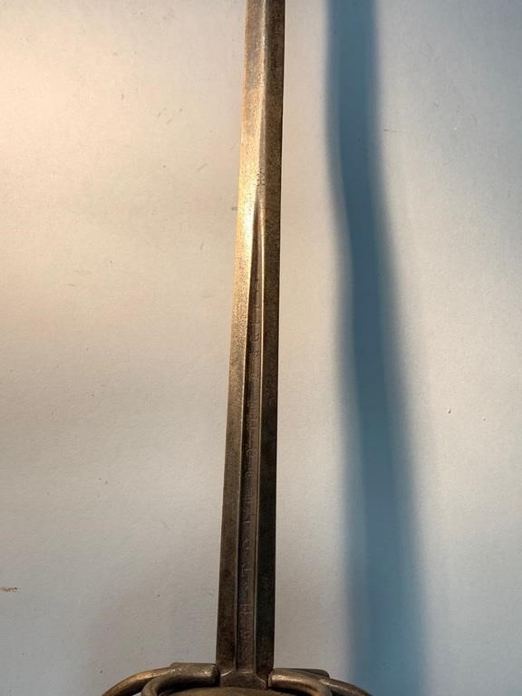

And for completeness sake I've attached the rest of the photos I have. Just based on my amateur knowledge it looks like this is probably a composite sword. Or maybe not, I've been looking at so many of these that they are starting to blend together. The total length is 48 inches. I believe the reverse side of the blade reads "En Toledo Me Fecit". I had not even noticed the tiny anchor in the last photo until uploading these images.

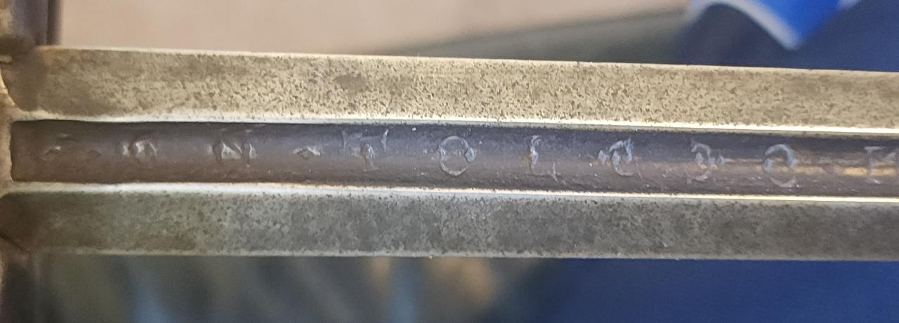

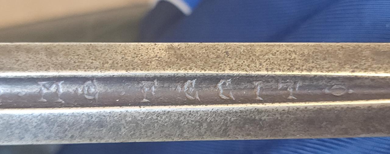

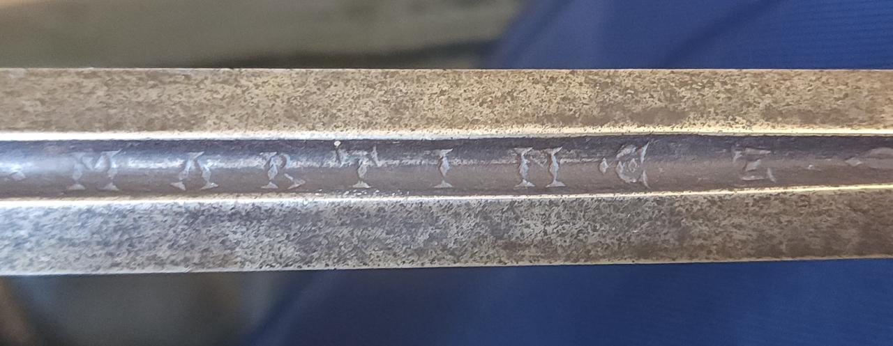

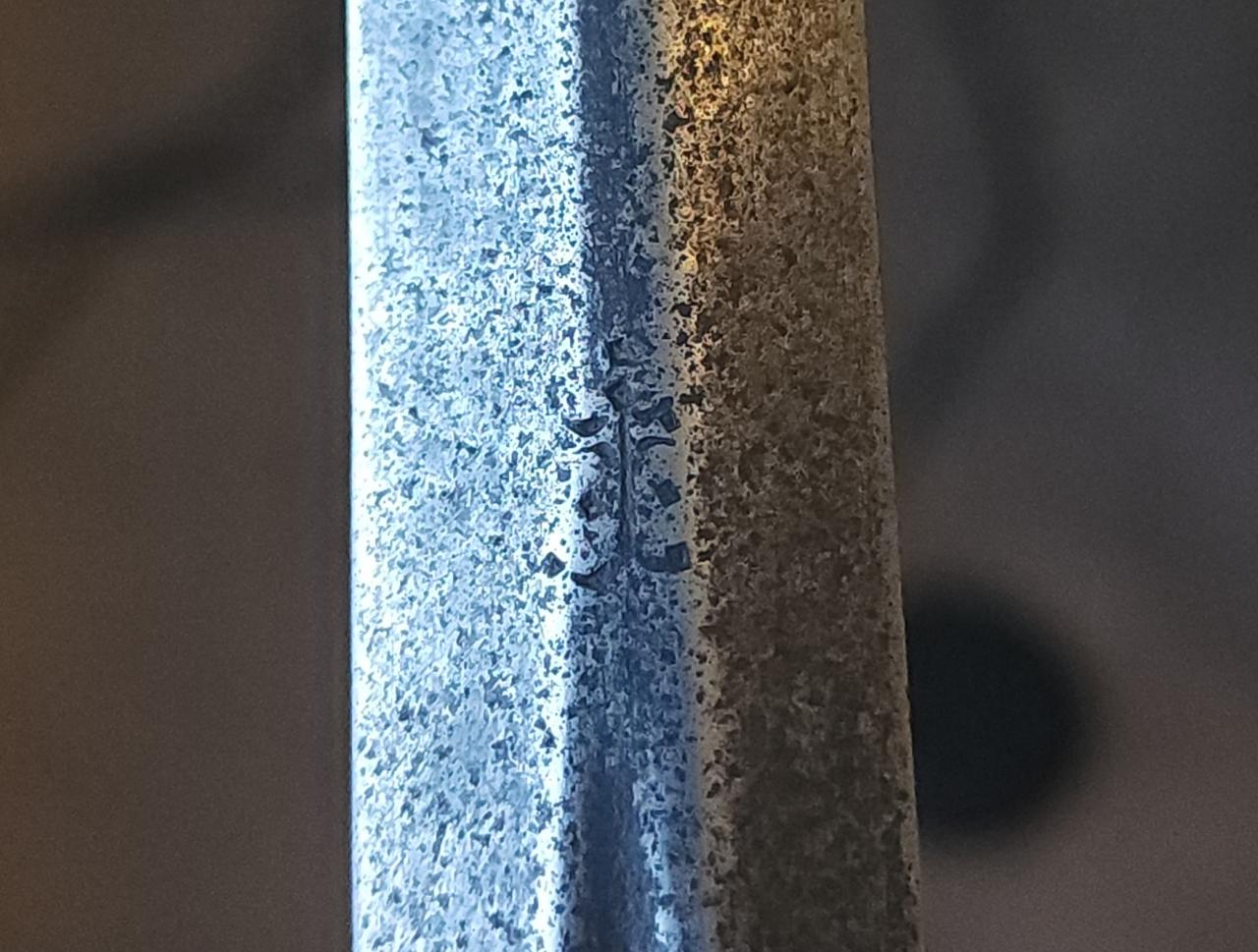

Are you sure it says EN TOLED ME FECIT ? Not a good sign. These "me fecit" inscritions are more seen in Solingen blades; you know, "Solingen me fecit" or "me fecit Solingen" .
Can you take a closer picture ?
Old 23rd March 2023, 10:01 PM   #5
10thRoyal
Join Date: Apr 2021
Posts: 82
Now you have me worried. It's definitely Toledo. I don't have it on hand to give a better photo.

No reason to worry, Michael. I reckon i was premature. This Latin inscription also appears in Toledan swords; maybe not so often, but it does. The smith marks in this blade are reprehensible. No doubt this is a genuine blade.
Whether the hilt is not from the period, hopefuly more knowledgeable members will pop in and give their impression.

I'm very relieved to hear that FINALLY I have found something that is not entirely a Victorian reproduction. I was on the verge of giving up honestly. As for the inscription, I'm hoping it looks a little less janky after some time with a tooth brush but clearly a calligrapher Andres was not.

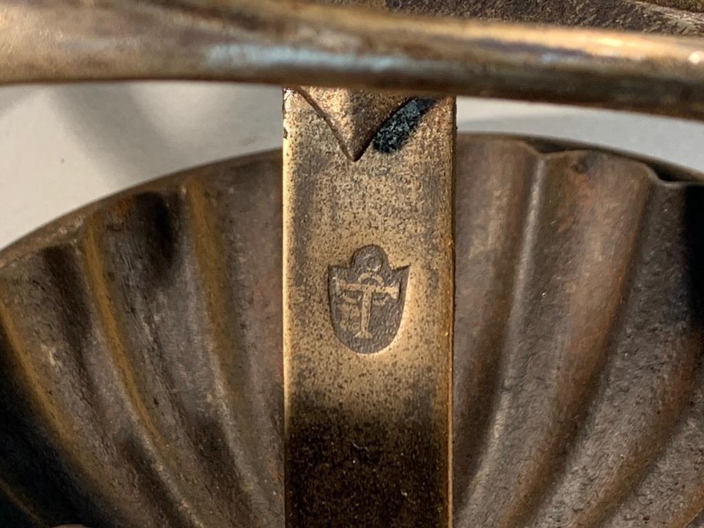

Something interesting I noticed from the armory catalogue I posted earlier, the mark on my sword seems to have been made with the same stamp as the example that was found in the armory. As in the exact same physical punch was used to make both markings. Not sure if that is actually interesting or not.

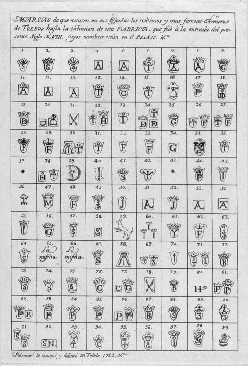

As Fernando has noted, it was not unusual to have this 'Latin' esque type of inscription on actual Toledo blades. There were a number of Solingen makers who actually worked in Toledo at times, such Henry Koll (Enrique Coel).
He has shown important detail on this maker from the remarkable resources that he has access to, so that seems well established.
I would point out that this punzone with the T is correctly placed as per authentic Spanish swords of 17th c. and Victorian replicas never had makers detail on them as they were not produced with deception in mind.
That mark with the hump over the T is interesting as it is unique, and it seems to this family. The T with other embellishment seems more often copied on other blades known produced in Solingen, often with incongruent Spanish makers names and marks.
Therefore, as agreed, yours has all appearance of the real deal, at least as far as the blade.
It is possible that the hilt was a later addition, and while replicas did occasionally use 'real' vintage blades, this was a common occurrence on authentically used rapiers as well. These were often repaired or rehilted in accord with changes in fashion or preference of owner through working lives, and to find an example not 'composite' is quite remarkable.

Meanwhile i have sent e-mail to two surces in Spain, to see whether they can untangle this Martinez knot ... but i am not sure if they ever answer .

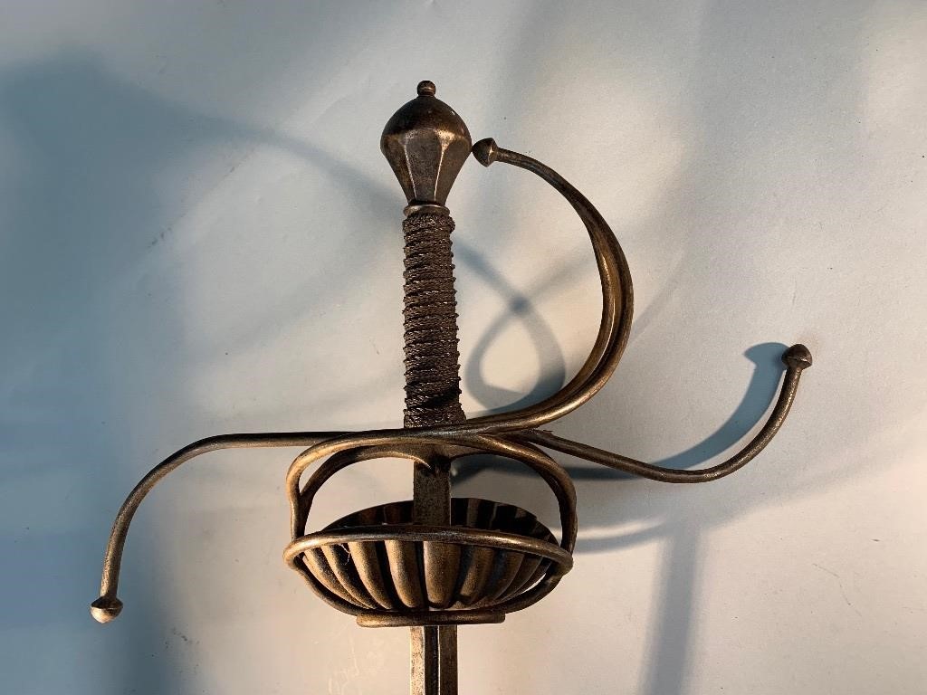

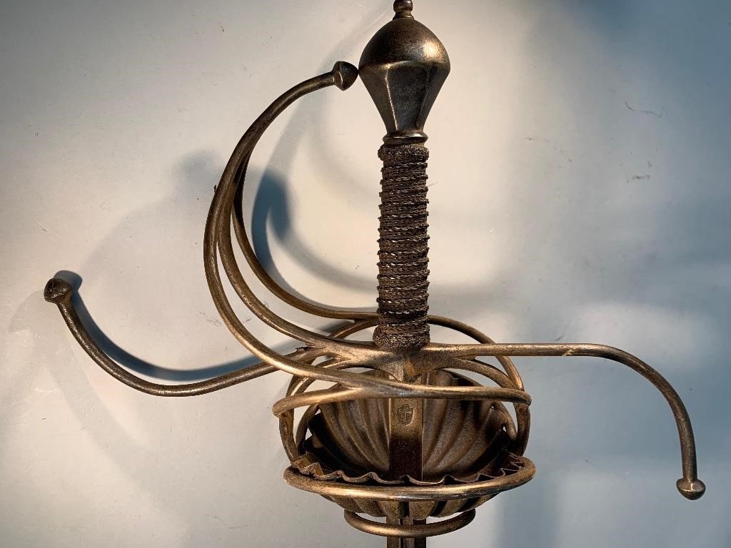

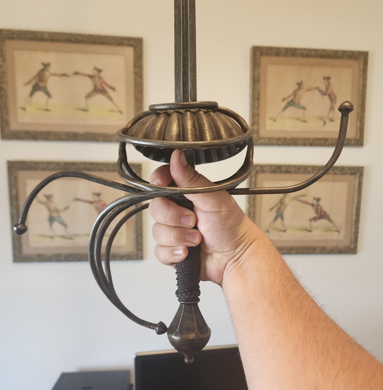

I finally the sword in hand and am amazed at the balance of it and just how massive the guard is compared to the blade. I've attached better photos of the inscription for anyone who comes across an Andres Martinez blade in the future along with the anchor mark on the blade that was not previously shown.

Nothing useful, i am afraid. One of them said that my reasoning on the fathers/sons sounded plausible but he was sorry not to be able to provide any further information.The other one, whom i had more expectations from, has never answered my email.
Sorry .

A fine blade is a valuable commodity, it is a product of those esoteric practices not common throughout a lot of history.
Fashioning a hilt was rarely fraught with difficulty, and consequently could be discarded and replaced at the whim of fashion and circumstance - as Jim said. This speaks volumes about trends in history.
I have two extremely fine rapier blades that have been converted to court-swords with very fancy hilts; for me, they are nearly as precious as my 1590s swept hilt, although nowhere-near as valuable on the commercial market.
It is all too easy to be caught up in the pedantic attitudes of some collectors.
The Arms and Armour Society presented a lecture this month on 'collectors and collecting' that was both poignant, amusing and precautionary, in that: "de gustibus non est disbutandum".
You should see the faces of coin collectors when they discover I clean my antique coins!
Fine Samurai swords are revered, and their condition is sacrosanct; why should the West be any different?
For me, a luxurious sword should reflect as much as possible of the quality and craftsmanship displayed when new. Munition's-grade battlefield swords are a different issue altogether though and are usually more inspiring when showing the patina of age and activity.
OK, I'm off my soap-box now.
ps
All this aside, your monster hilt looks amazing, regardless of its provenance.

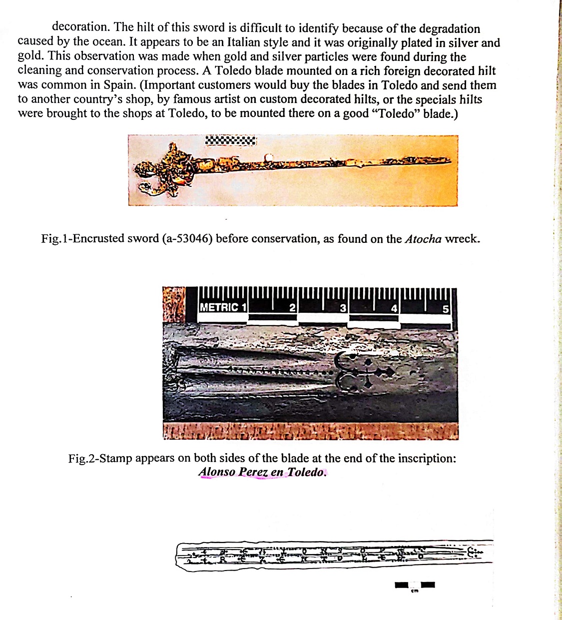

In an article by Abraham Lopez, "Alonso Perez, Sword Maker of Toledo'
it notes that Perez was one of the most prestigious artisans of late 16th c and worked as an officer in Toledo at shop of famed master Gil de Almau.
An important rapier was found on the well known shipwreck of the Nuestra Senora de Atocha (1622) off Florida. It was of course heavily encrusted but it was determined to be of Italian style, but with Toledo blade as commonly seen in Spain.
Attached is page showing the 'anchor' mark apparently associated with Perez and as seen on the blade of the sword here in OP.

10th, it is important to remember, that as Fernando has noted, these swords were not only mounted with blades imported from various sources, but also repaired using other batches of imported blades. In the Spanish colonies in America, boxes of rapier and dragoon blades have been found en masse in New Orleans and others. On one shipwreck off Panama, there were many boxes of blades only, most rapier using spurious inscriptions and Toledo marks. as the wreck(s) can be dated to 1690, we can see the period of the blades.
So what you have is an intriguing rapier with unusually large hilt, as was often the case having hilts tailored to the prospective owner, and in the fashion preferred locally or by period. It is mounted with what is most probably a blade using a spurious signature and could be from Germany in any number of shops, or possibly Italy. These were the most likely centers and remember that by the 1690s Toledo was literally defunct so only its reputation remained intact, still being used with the names of its former masters, which were often misspelled or improperly used.
The occurrence of the 'anchor' as used by Alonso Perez (found on the 1622 shipwreck) of course supports the theory of the spurious use applied to this blade. Often blades from Solingen had spurious names added along with Toledo markings which were not aligned with the names used.
