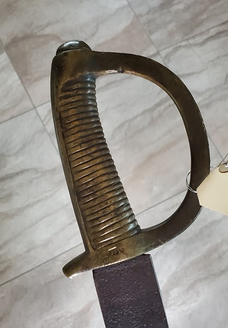

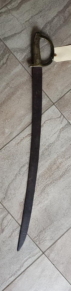

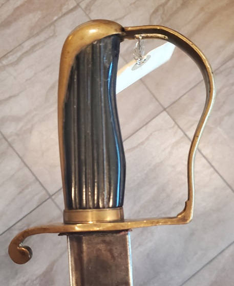

In 2020 I posted a thread on this munitions grade 'briquet' titled "The Lowly Briquet". In the discussion I had brought up the research over the many years Ive had this sword (since 1966) and the only declarations of classification by authors in resources claimed it was a British foot artillery gunners hanger.
One example shown had the name Trotter on the blade and it was seemed c. 1814 foot artillery as noted.
As we have been discussing naval cutlasses on the concurrent thread on the M1804 British cutlass, I did not wish to detract, so thought it would be good to post this on its own with posing this question.
The hallmark cartouche in the brass hilt in my opinion is that of Paul Storr, who was a renowned goldsmith and silversmith who fashioned wares for George III and IV, and first used the PS as his hallmark in 1792.
While these cartouches were typically used on in precious metals, it is known that Francis Thurkle (silver hilts) in 1790s placed his initials even in work regardless of metal used.
There was a distinct penchant for copying French designs in some weapons in the 1790s, and the French 'briquet' was of course well known, and had been seen as a naval cutlass.
As far as has been discovered, there is no reliable record of this briquet type hanger used by British artillery units despite the entries in a number of references showing these as such.
In the 1790s, there were concerns of French invasion even prior to the Napoleonic campaigns, and there were civilian efforts to establish 'home guard' type assemblies. There were also concerns to arm vessels for threat of attack.
As Paul Storr was not yet well established as the renowned silversmith he became in the 1790s, but did have facilities for casting metals (Bezdek notes he was a cutler and hilt maker) perhaps this might have been an early 'ersatz' cutlass for arming British vessels?
While obviously thinking 'outside the box', this is the perfect place for the knowledge base here to come together on this conundrum.

Thank you Capn!! I hoped you'd enter this foray into the mystery of this anomaly. As you agree this curious old 'briquet' might well have to do with this period of pre-Napoleonic times in England, which seem never to have been well documented.
When the early writers on British swords such as Ffoulkes had little clue on these, which later were carried forth in Wilkinson writings (and again by Claude Blair) claiming they were British 'foot artillery hangers......these became the classification Gospel for collectors, at least in degree.
Actually these were never a highly collectible item, and most that were ever seen were of course French, which were well known (hence the colloquial term briquet). It was noted later in an article that no British example of 'briquet' was ever known that had substantiating markings identifying it as such, had ever been seen.
It was that several examples had been seen in the Tower dated 1830 which gave the impression these had been British.
However, as I had explained in that previous thread (thank you for the link!) the cartouche on this example with the distinctive cartouche with initials PS is compelling. It does NOT coincide with any type of marking used in weapons of other countries, including France.
It does however correspond to the early hallmark stamp of Paul Storr from c. 1792+. While this type stamp of course was used only by artisans using precious metals, it is known that in cases some did place stamps with initials regardless of metal used.
In these 'times of concern' where there was a notable civilian movement of ersatz defensive measures, it is noted in one reference that workers and artisans in many trades joined in to produce needed supplies and even weaponry.
It seems quite possible that Paul Storr, already working with other artisans closely aligned with the Royal House, might 'do his part' by creating a number of these hangers for 'the cause' and proudly place his well earned mark as testament to that.
The paucity of examples of these munitions grade weapons is directly related to their commonality overall, and that they were 'in bulk' excellent source for much needed brass metal, and were likely scrapped in huge volume.
A rather grim note on the post war use of the materials and other was recently found when I was researching the battlefields of Waterloo and other actions associated. It is well known that huge numbers of casualties were buried in huge mass graves there, however recent excavations revealed there are virtually no remains to be found archaeologically (save several noted graves of several individuals).
The horrifying fact seems to have been that these huge caches of remains were dug up to be put to use, with bone ground into fertilizer which became in scale a commodity much in the way Egyptian mummies were unceremoniously used.
While most weaponry found on these fields was of course taken as surplus, many more common items became of course smelting fodder, which would include of course these kinds of solid brass hilt swords.
With regard to the anchor stamp, in review of the previous thread on this topic, it seems that was a known Swedish mark used generally and not specific to naval items.

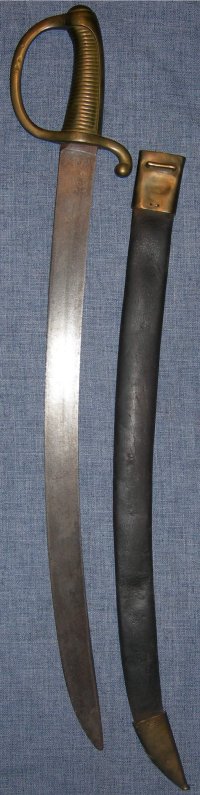

These munitions grade hanger/swords were basically infantry/grenadiers weapons in France which were made with cast brass hilts and were well known prior to Napoleonic period and after.
Apparently the term 'briquet' was derisively applied by cavalrymen toward the shorter infantry weapons being compared to the sticks (lighters) called briquets used to start campfires.
It seems these were copied throughout Europe by their infantry units mostly but they seem to have been used in rank and file options as required.
These seem invariably to be the solid cast, ribbed grip brass hilts on varying form short blades.

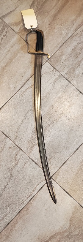

So...this brass hilted double edged recurved blade ~yataghan-ish variant qualifies.
I believe it's Prussian - possibly an experimental version.
(Sharp in both edges).

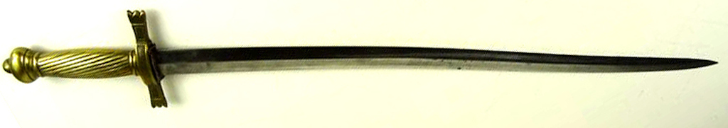

Actually the example of the French hanger I posted , with the characteristic ribbed brass single piece grip in its distinct shape is the only thing termed a briquet. It was a colloquial nickname as described, and while it was first applied in French context.....it came up, probably as usual by collectors to refer to any of these swords that looked exactly like this.
The example you posted would not be deemed a briquet in normal perspective, does that make any sense? Perhaps by the very loose description of the term you could call it that, but we get into the famous name game.

Hi Jim, was just pushing the boundary - I don't really think that one is a briquet. Maybe the definition should include 'post french revolutionary', 'ribbed brass grip and rounded D guard, 'short single edged hanger blade'.
