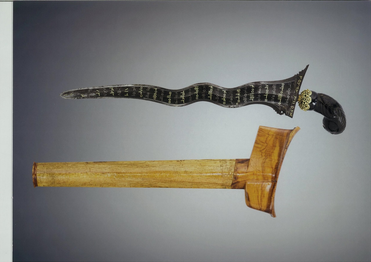

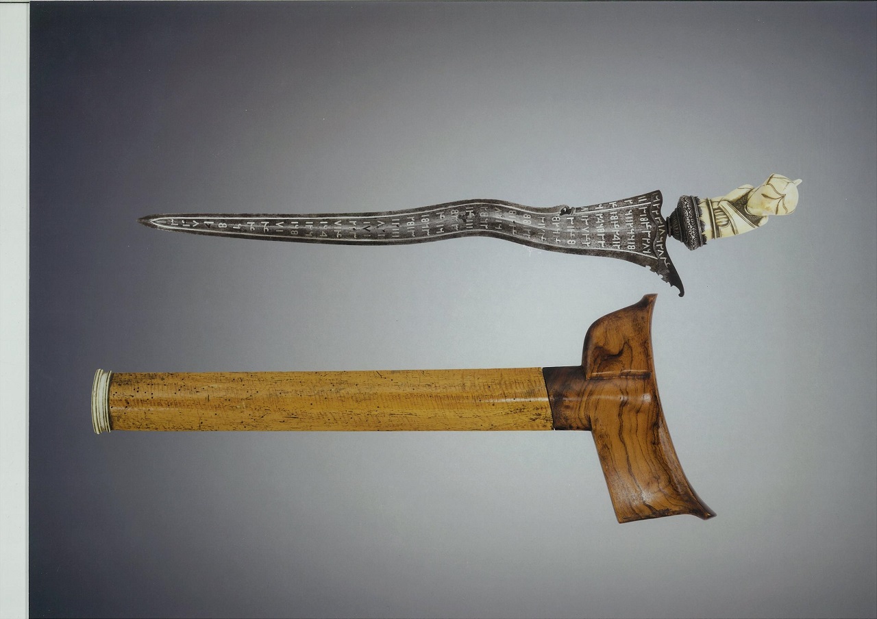

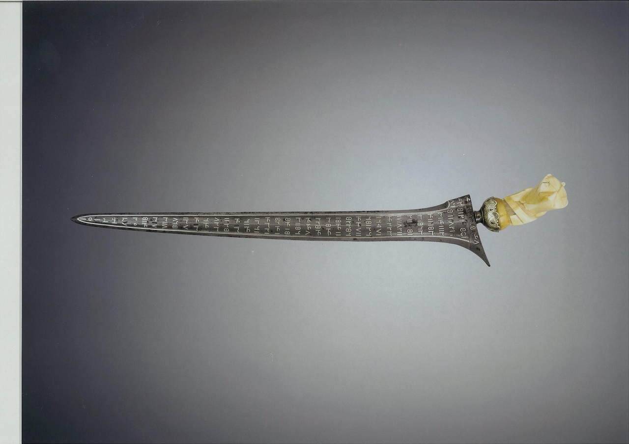

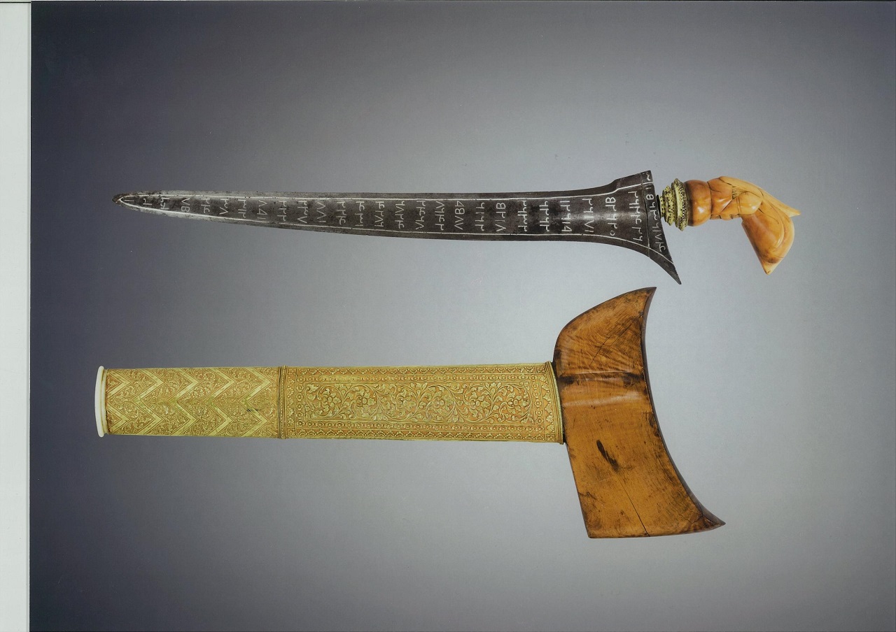

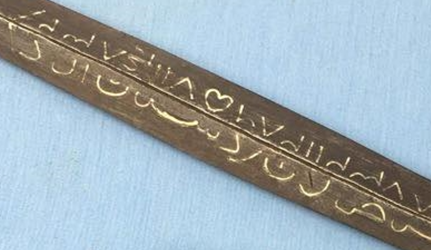

Greetings everyone,
I am in a midst of doing research on Keris an stumbled upon 4 keris with almost identical talismanic numerals. I am quite profound with the Jawi writings but this these inscription also include an "inverted B". Anyone familiar with this style of inscriptions or perhaps provide any references on this topic for me to start with?
Are all 4 currently in the same collection?
The 2nd and 3rd keris went through the hands of Robert Hales and are featured in his book. I believe I saw pics of similar (or possibly the same) keris elsewhere but a quick search in my files failed to retrieve anything of note. Maybe Gustav or our Malay forumites are willing to chime in here?

Some nice and interesting examples presented here. I am not very adept a Jawi writing so i am not particularly certain about the symbol that looks like a reversed "B". Perhaps it is so variation on the Jawi number 9, which i don't see otherwise presented in these sequences, but that is nothing more than a guess.
These are, of course, as you have noted, talismanic in nature. I believe they are much akin to magickal squares that can be found throughout Western magickal histories. Not to discourage your research, but deciphering such talismanic sequences would be a near impossible task. These undoubtably had a very important and personal significance to the person who placed them there, but their exact meaning is not really intended for anyone else to know, i'm afraid.
BTW, i must point out that while you describe these as "almost identical numerals" i believe it is quite the opposite. Yes, the numerals themselves are all similar, but the numerical sequences on each of these blades is quite unique, nothing like the other, and would have completely different personal talismanic meanings to their original owners. We could not say the "War and Peace" and "Anna Karenina" are almost identical simple because they both contain a sequence of similar letters strung together in a similar format.

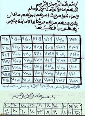

I strongly agree with you, David. My approach is merely to understand the influence of these talismanic numerals from perhaps other region - Arabia or India. It would be great if any of the forumites who happens to have talismanic inscriptions on their keris to share & discuss about this topic. I have seen talismanic elements in medallions, coins and azimat.
Below is one sample of azimat (tangkal, charm) and it happens to have similar elements as found on the blades.

Apart from the "B" symbol, I am curious about the the "4" and "O" symbol as well. I originally thought the "O" represents the number 5, but since the numbers are probably written in Persian/Urdu, then probably "O" is actually zero (0) ? The picture bellow summarises my thoughts. Do you think this is logical?

Dealing with topic talismanic, azimat (jimat), charms is not easy coz it need understanding the practice itself - @David was right. What I can conclude is for this particular type of charm cannot be deciphered, although it is possible for magic squares or rajah. Yes it created beautiful pattern add character of the blades, but it is also not just mere decoration- only the scribe knew what it is intended for. It is something like recreating pamor, but just in the principles. Just like actual pamor, we can only guess or relate their actual meaning and capabilities.
And this ,i believe, is the form of art of the 18th century onwards where in the early days was limited to royal families. My basis is where Islamic world decorative techniques really absorbed and implemented in the region as seen on the blades. Interestingly, this collection of Peninsular keris were actually from the East Coast, once owned by a royal blood kerabat before it went to the hands of several European collectors.

I just want to share a recent finding on the content of a kitab that might shed light on the keris abjad and the inscriptions. There is sort of a formula for it and there is a commentary written in Buginese Lontara towards the end. And this manuscript is about traditional healing - adding more mystery.

An inlaid Malaysian spear of robust fighting size and form.
Both sides are inlaid in this manner, total variations to each side.
The side pictured with the Alif" pamor, nil pamor to the reverse.
A point I particularly notice is;
This spear and other keris with Inlaid scripts I hold, they all well raised above the surfaces like the Mughal Lucknow ZarBuland method
All these keris in the discussion with repeated motifs/scripts, the inlay is all flush with the metal surfaces.
