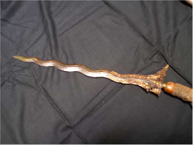

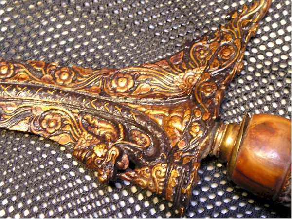

Hi guys,I would like to ask opinion about a Keris that my father has (picture attached). He asked me to find out any information about the Keris, so I read a few books and I try to search information about Keris in the internet. Then I found this discussion forum from Google search engine, and hope that you
guys can help me give any information about my father's Keris. I'm a complete beginner but based on what I have read, even though I'm not certain, I would say that the Keris has Dapur Nogososro, 11 luks. I can't tell about the Pamor. The Keris is probably from Cirebon, West Java.
Thanks in advanced.

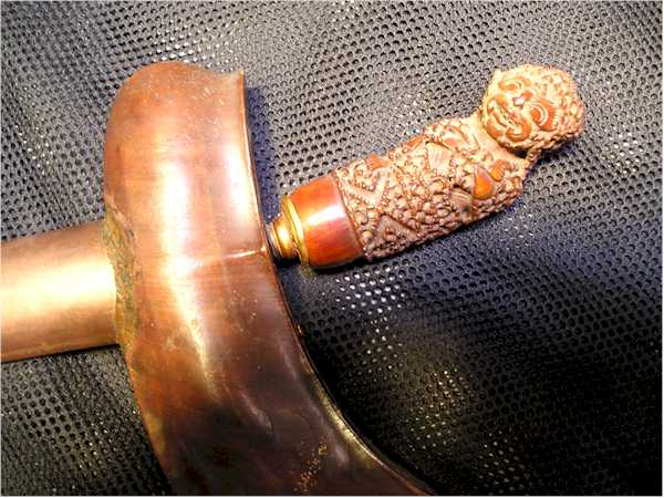

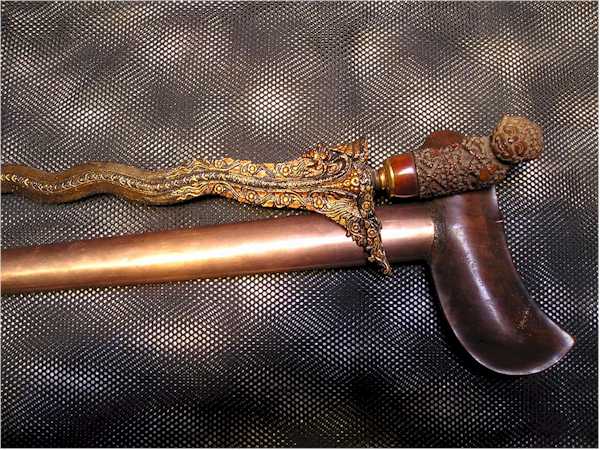

Im sure some of our more knowledgeable keris collecters will be of more help but my initial impression is that Java is probably the country of origin,but to my unexperienced eyes it also has a lot of Madurese influence.
As to dapur and pamor I wont even hazard a guess,there are infinate variations of both so it can be very difficult to accurately identify the dapur and pamor of a keris.
To me it looks like something isnt quite right with it,the sheath looks far too plain to me for such an ornate keris,although the metal covering the sheath {pendok} looks like it could be swassa {Indonesian rose gold} but that ofcourse will have to be checked by a jeweler.

Thanks for your comment Justin. Indeed that when I asked my father, the sheath is not original. My grandfather got the Keris in return of someone in desperate need of money, but without the sheath. So he collected bits of gold, and asked someone to made the sheath for the Keris.

Please post a few full blade pictures? With a full picture of the keris blade, other details can be posted. In my opinion, the sheath does not do justice to the blade.

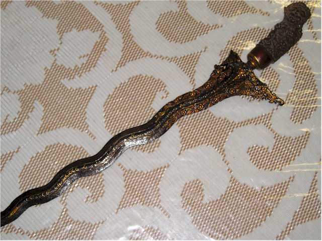

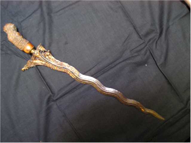

Ok, here is what I've got at the moment, almost full picture of the blade. I will ask my father for another full picture of the blade, but it may take a couple of days, since I don't live with him and he probably cannot send it via email to me.

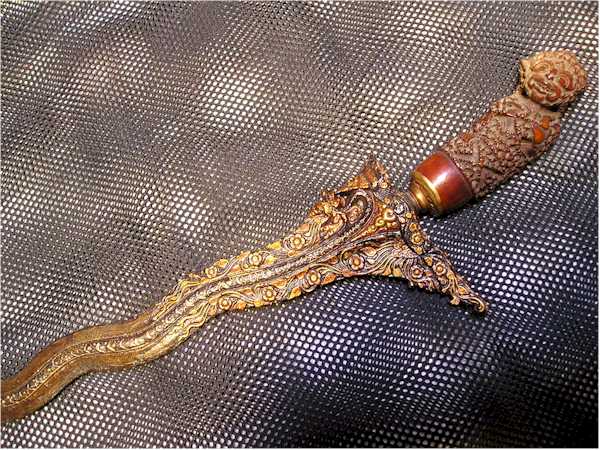

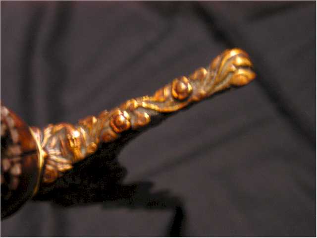

few added photos

Sorry to bring up this old thread. A few weeks ago, there was a Keris exhibition in Jakarta, Indonesia. My father went there and there was a stand for Keris consultation. So my father brought his Keris with him and this is the result according to the consultant:
Keris Luk 11
Dapur Nogososro
Tangguh Mataram
Kinatah Kemarogan
Pamor "Persi Dewata" Segoro Muncar
Perabot Gayaman
Hulu (Hilt): Gading Putra 1
I don't know exactly what each of those means and I cannot translate it properly to English (except probably for Hilt). Appreciate any comments.

A little explanation about the consultation remarks:
Keris Luk 11 = The blade has 11 meandering curves known as luks.
Dapur Nogososro = The blade design, is in the Nogososro (dragon) form.
Tangguh Mataram = is the estimated period when it was made.
(For more info: http://old.blades.free.fr/keris/intr...n/kingdoms.htm)
Kinatah Kamarogan = is the gold/brass-works, relief decoration on a blade with.
Pamor "Persi Dewata" Segoro Muncar = is the pattern found on the blade.
Perabot Gayaman = is the sheath form, meant for everyday use (not for officail ceremonies).
Hulu (Hilt): Gading Putra 1 = is the ivory carving design of the hilt (ukiran).
Hope that helped.

Good job to explain the various terms. I think this keris is from Cirebon, and not Madura. Sorry that for me the photos are not sharp, and it would be good to also see the peksi.

Hi Okhba, welcome to the forum. When your father gets a chance i hope he might be able to make some clear, in focus and up close images of this keris. It appears nice, but i am not convinced it is of the age of 17th or 18th century. Keep in mind also that tangguh is an estimate and a classification. It could be problematic if we attempt to apply it to any specific dates. Sometimes blades fall into a particular tangguh, but weren't crafted until some time after the historical period of that kingdom. It is not necessarily correct to equate tangguh with the actual dating of a keris. Also, there is often an overlapping of influences in most keris. Experts judging tangguh often need to weigh whether a blade is more one tangguh than another when coming up with their assessment. Often experts will disagree. Sometimes even the same expert will give one tangguh at one time and a different one at another. I don't know enough about how to judge tangguh to know if that is the case with your father's keris. It does appear to be a nice keris though.
Have you seen this keris yourself firsthand. I ask because in the photos the kinatah looks very coppery. I wonder whether the color might be off on the photos, or if this might be gold with a very high copper level (rose gold?) or whether iot is gold at all. I suspect it has gold in it, but from the pictures i just can't tell. Better pictures would be helpful.
