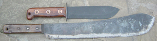

There are indeed. The chevron blades I have not seen close up. Is the chevron iron scale or a stain? to me it looks like a stain. Obviously decorative and clever. These picture of a ww2 machete and a NATO survival knife are black possibly for two reasons. Anti reflection and cheap finishing, though the finish on the NATO knife does not look cheap. The anti reflection is surely in many cases a good idea. I have a North African knife, well made but strangely left dull but deliberate fine use of a file. If fighting in a jungle environment the last thing you need is a shaft of sunlight giving away your position, untill you are ready for your ambush or charge on a village.

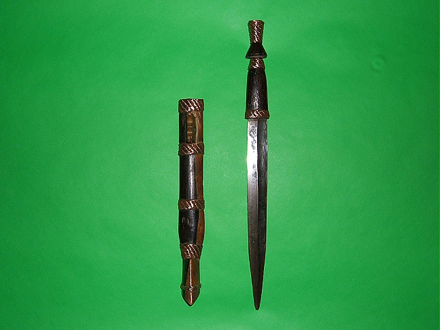

Here is a Shona dagger circa 1930s with a black and white blade.

Posts: 6,000
The very sharp contrast here must be purely decorative, very pretty.

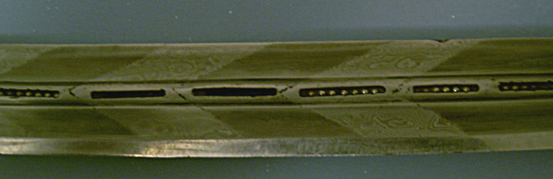

I think the chevrons on this blade of Jen's. Are obtained by the use of clay, applied to the blade as a heat resist. Rather like the Japanese do to protect the cutting edge while still working with heat on the rest of the sword. Look closely and you can see the edges of the chevrons are quite uneven as it must be rather difficult to get nice sharp edges on the clay that covers the white parts of the blade. The clever part is in the eye of the smith, to know just how much heat is needed to form the black iron scale without over heating the whole blade.
Iron scale is the thin black film which forms on the surface of iron/steel in the process of forging. It is magnetic oxide of iron, Fe 304, apparently, I am no boffin.
I would think it most unlikely that the blade is made black and then the white exposed by removing the scale, as what appears to happen in the case of African metalwork.
As for a wax resist, I can only see that work when using chemicals as a stain or when using acid. Wax or laqueur resists facilitate fine work. The chevrons are not what you would call fine.

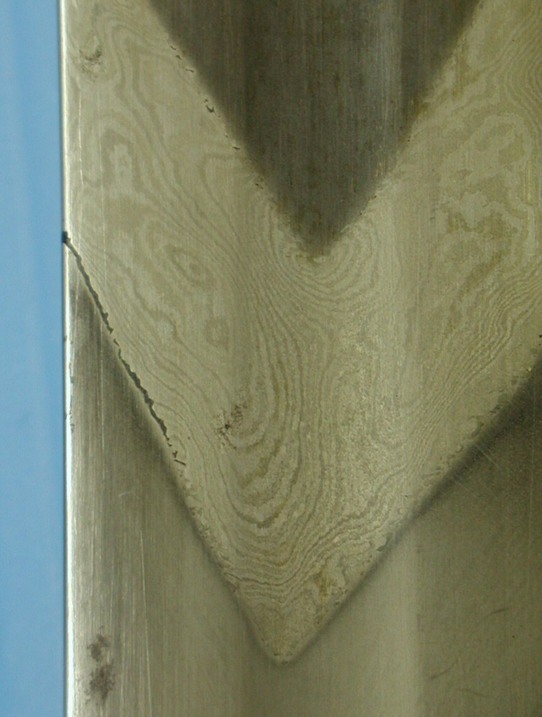

hi,
on the chevron blades, i would have to disagree with what has been said (also that stated by rawson/pant/fiegel). all the examples i have seen have been made from seperate billets of steel and pattern-welded steel, skillfully joined together. these all seem (in my humble opinion) to be 19thC, and not any earlier. both fiegel and pant took their dating from rawson, who placed a 17thC date based on the excample in the V&A. there are no accession records, nor further info on this particular sword, so the dating was based on his own opinion. i dont think that particular blade can date any earlier than 19th, and it clearly shows evidence of being constructed from these seperate pieces, as do all the others i've seen. i cant speak for pants example, but fiegels definately was. hopefully jens will tell us how his piece is made.
attached is a sword i once owned, which shows the join.
i am sure that if any of these swords were used as a sword should, they would shatter into pieces (an expensive experiment). they were a bladesmith showing off and made for decorative use only.
of course, tim could be right in his theory, but i have never seen evidence of it so far. the only time i saw something close, was from a disreputable english dealer who attempted to mask off chevrons onto a pattern-welded blade, in an attempt to decieve. luckily, the job done was as bad as his reputation :-)

Posts: 6,000
The chevrons on this blade appear quite different to the first example. Much tighter in form and there is less contrast. As we can see seperate pieces of steel. However I still think the first example is iron scale, remember I did suggest this was more of a decorative/display sword in the original post. The use of clay as a heat shield is a fact in Japanese sword making and I can see no reason why under the right skilled hand it could not be used to make patterns, after all Japanese swords are not known for shattering.

you may be right, that this process was used, but i still dont think it was in this particular case. it has been some time since i saw the sword that jens owns, but i am sure (almost positive) that if it was of a different construction to the pieces i consider 'normal' chevrons, then this would have stuck in my memory. no, i feel it too was made from different billets. it is unusual, in that the first section is 'lengthened' and the chevrons are not even all the way along the blade. also, i played with the image i posted, in order to enhance what was blurred. from a distance, you would not notice these join marks. also, with age and polishing, they tend to disappear.
as far as i am aware, clay heat treatments were not really adopted in india, but this isnt my field (metallurgy) so maybe i am wrong. all the accounts i have read tend to concentrate more on wootz, as this was particular to india and so of recordable interest to the europeans over there. the indians infuriatingly used a traditional approach to bladesmithing, which never changed throughout centuries (annoying from a dating point of view). these chevron swords were completely different to these traditions, which is partly why i date them to the latter half of the 19thC, when the bladesmiths began to be recognised within the durbars and european led 'competitions'. these events brought out the best and gave these smiths a chance to show their true abilities.
in my last post, i was more critical of the dating used for these pieces, than the process (or meant to be). but, this too, is just a specualtive opinion.
as i said, hopefully jens will pipe in and let us know for sure.

Posts: 2,718
Detail of the blade attached. I have heard about the wax treatment, but I have never heard about the clay treatment being used in India - to be quite honest, I have never heard about the clay treatment.
Old 14th July 2006, 06:01 PM   #19
Posts: 6,000
Thanks jens that is a great picture. I think is remarkable the skill in welding such irregular chevrons. I do not know much about the use of clay except that it is done in Japan and although very clever people the idea seems to practical to be exclusively theirs.
