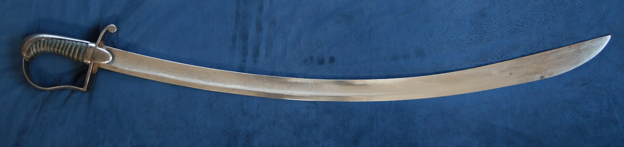

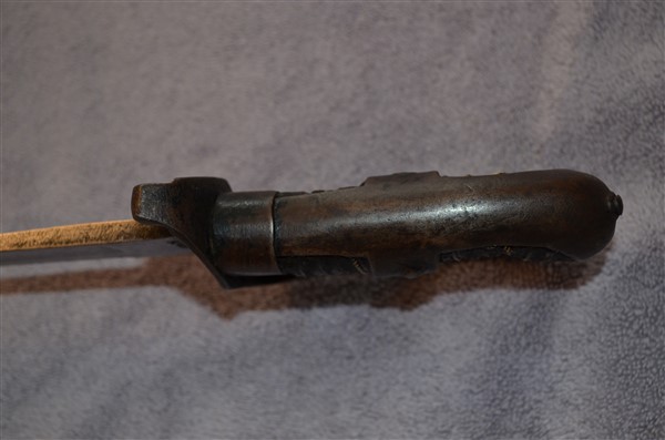

Funny, as things go in Batches; I just acquired my second Lion-headed sword in a month and what I believe to be a British 1796 Light Cavalry Officer's Sword.

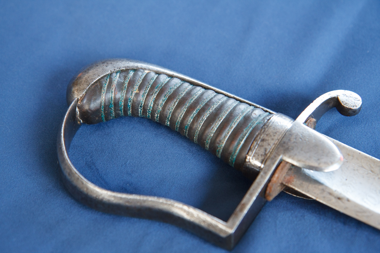

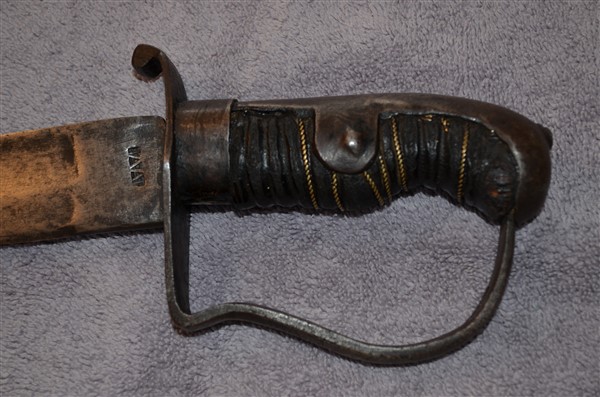

The first questions are on the 1796 sword; am I correct in its attribution and does anyone recognize the maker's mark? I can not make heads or tails of it.

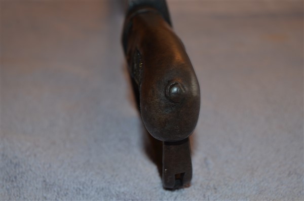

The second sword is unknown to me; I am assuming that it is also British, circa 1790-1812, but I can not find a similar example.
Any help would be appreciated!

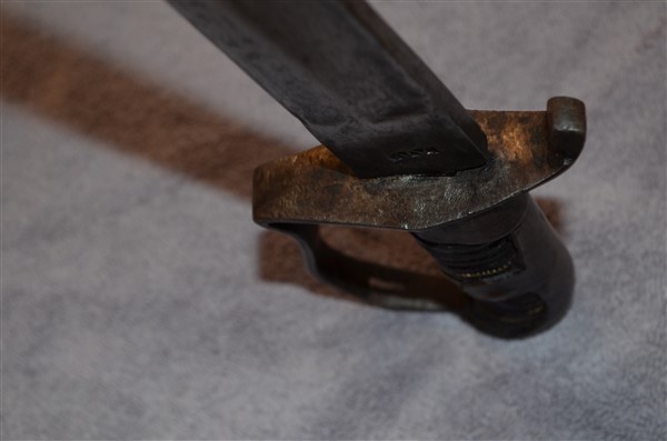

I don’t think either of these swords are British.
The top one isn’t a 1796 LC in any case. The blade shape is wrong, the ricasso too large, the guard too thick and it’s missing the langets… to name a few of the issues.
The hanger might be British, but I suspect it’s more likely to be from one of the German states. Especially with the marking on the grip furrell.

Thanks for your response Radboud, but I'm pretty sure that the long sword is the 1796 Light Cavalry Sword. It measures 33.5" long, it has the hatchet type end and as per "Swords of the British Army," by Brian Robson, there are examples without the langets.
I think that you could be correct in attributing the lion-headed sword as being German.

I'd be inclined to agree with Radbound that it looks slightly off for a 1796 LC. The heavier guard is generally an indication of the Prussian Model 1811 Light Cavalry sabre which was a copy of the 1796.
But there is still that very short quillion and long ricasso that seem off even then.
That makers mark could be the clincher but I haven't found it in any of my references.

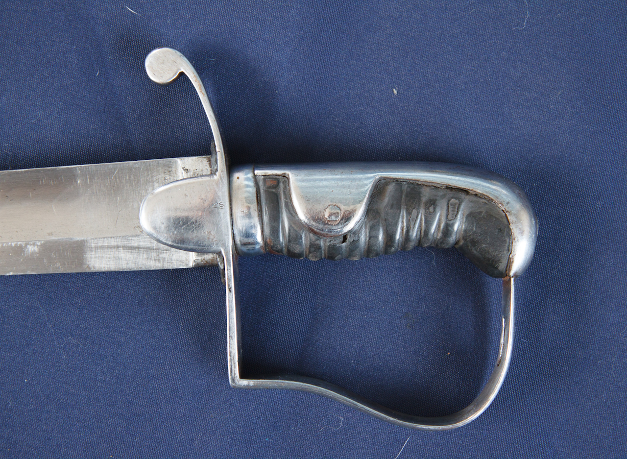

The '1796' could be a British officer's private purchase sword. Doesn't appear to be a Prussian Blucher 1811 variant. Officers ones vary considerably, have different grip 'ears' and even languets shapes – or missing them entirely. Officer ones were lighter and quite flexible. The Indian Army liked them, and made their own versions, I'd bet with larger ricassos. Officer ones frequently had the Mfg.'s name on the spine. Trooper ones were mostly all marked with regimental/troop/rack numbers.
I'd guess German (Prussian) officer ones also would vary.
With no markings other than that on the ricasso, no bluing, or blade decorations, unless someone else knows whose it is, you may be out of luck for more details.
What is the weight of the 1796 lc? My officer's one weighs 698 grams and the balance is about 6 inches in front of the guard. It also has no markings surviving.

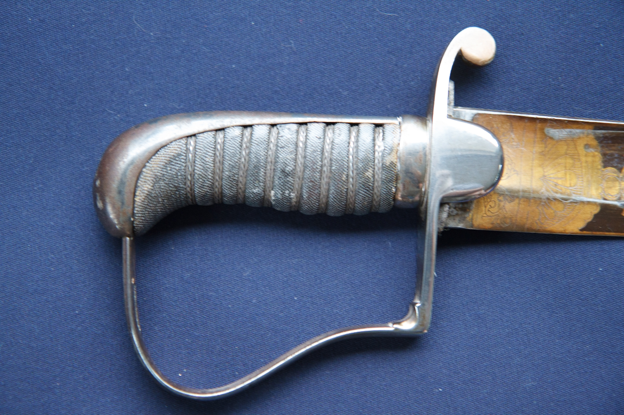

I agree with the previous comments that neither sword is British. The top sword isn't a British 1796 LC sabre. Can you please post a better photo of the hilt?
