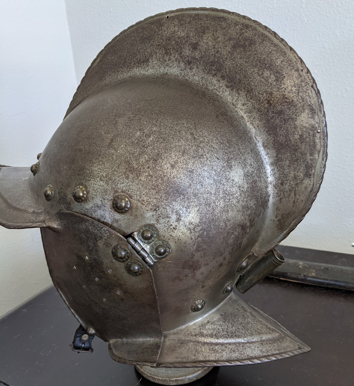

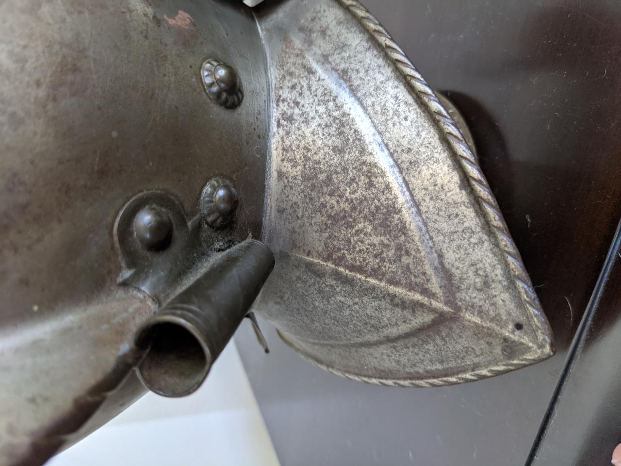

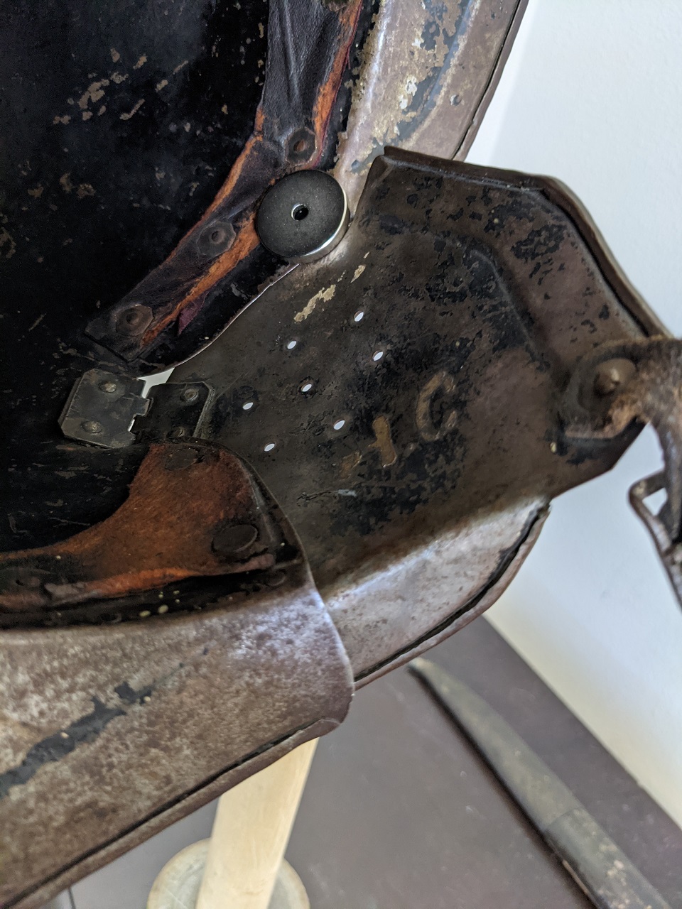

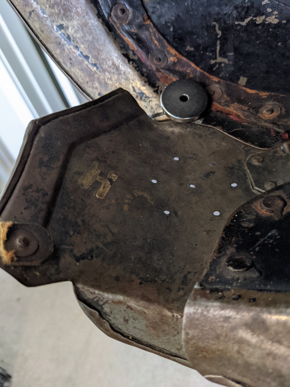

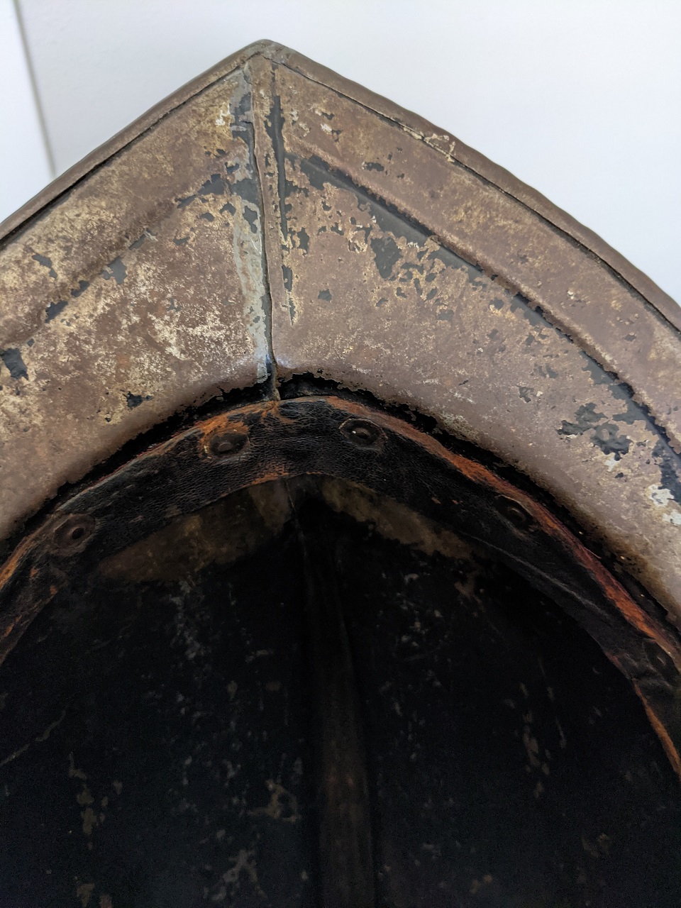

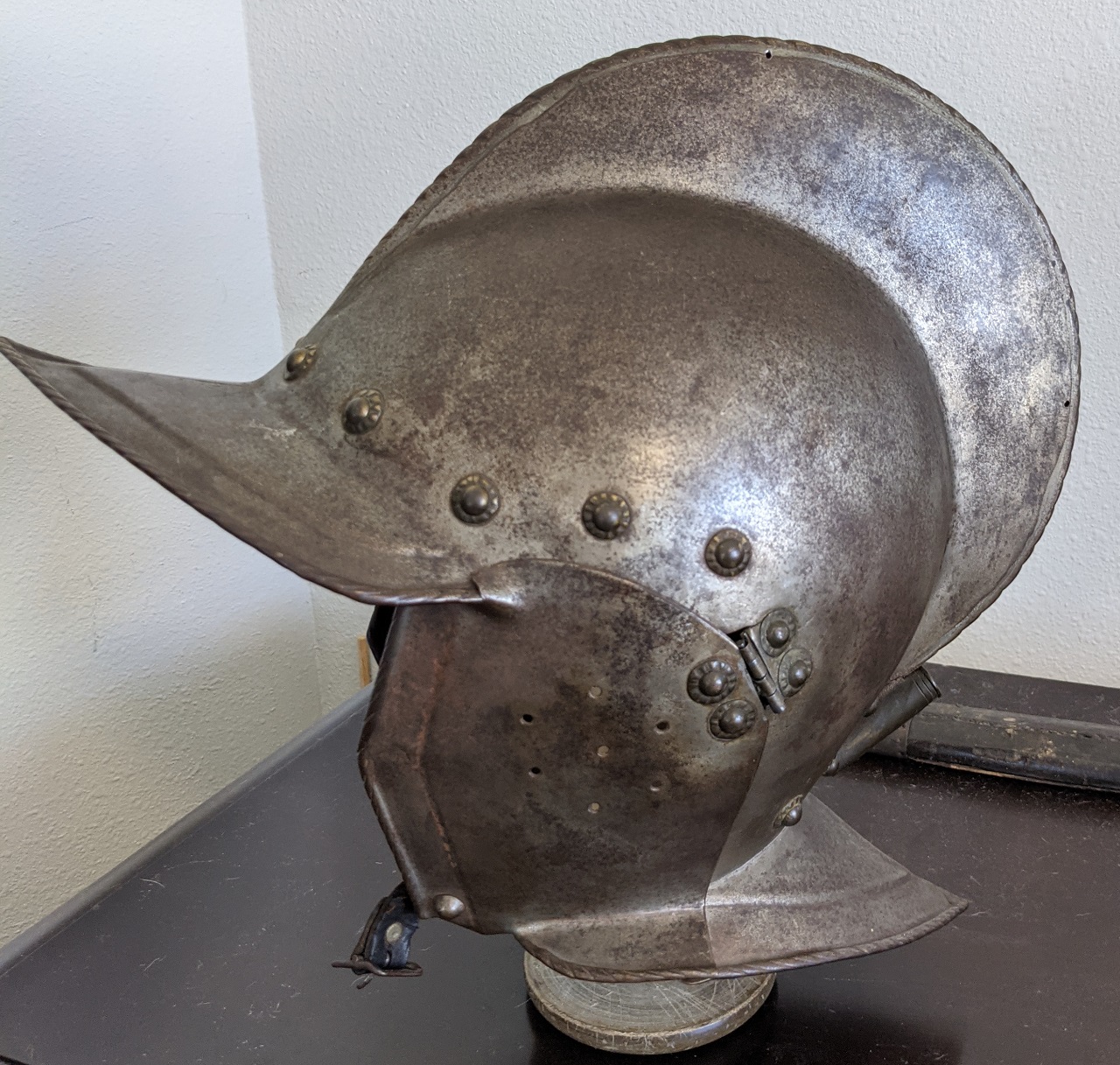

I recently picked up a burgonet at an estate auction that was simply labeled as a "metal helmet" but it looked more interesting then the name suggested. The construction is a bit interesting with the helmet formed in two pieces plus the neck lame. The two halfs are rolled at the brim an folded and brazed at the side of the comb which I found odd. The interior is painted black with a bit of leather lining still present around the crown. Only markings I have found are a "2" stamp on one half of the helmet and the letters "HC" painted on each of the ear pieces. I believe it is a legitimate piece from the late 1500's or early 1600's Germany but am curious what y'all think regarding age, authenticity, and origin.

that is pressed metal, not hammered, I'm afraid its 19th century.

Now learn me this, what are the painted letters on the ears? Now I am just plain curious.

A lot of these items are not only baronial smoking room decorations, but often can be theatrical props. There was quite an industry of making these costume and prop items in the Victorian period, and before the use of plastics etc. many of these were quite well made.
The letters and numbers may have been administrative and/or inventory numbers etc.
I have researched a number of items which had all appearances of authenticity which turned out to be in this category.
These still make great decorators, and as often noted, they are still antiques in their own right.

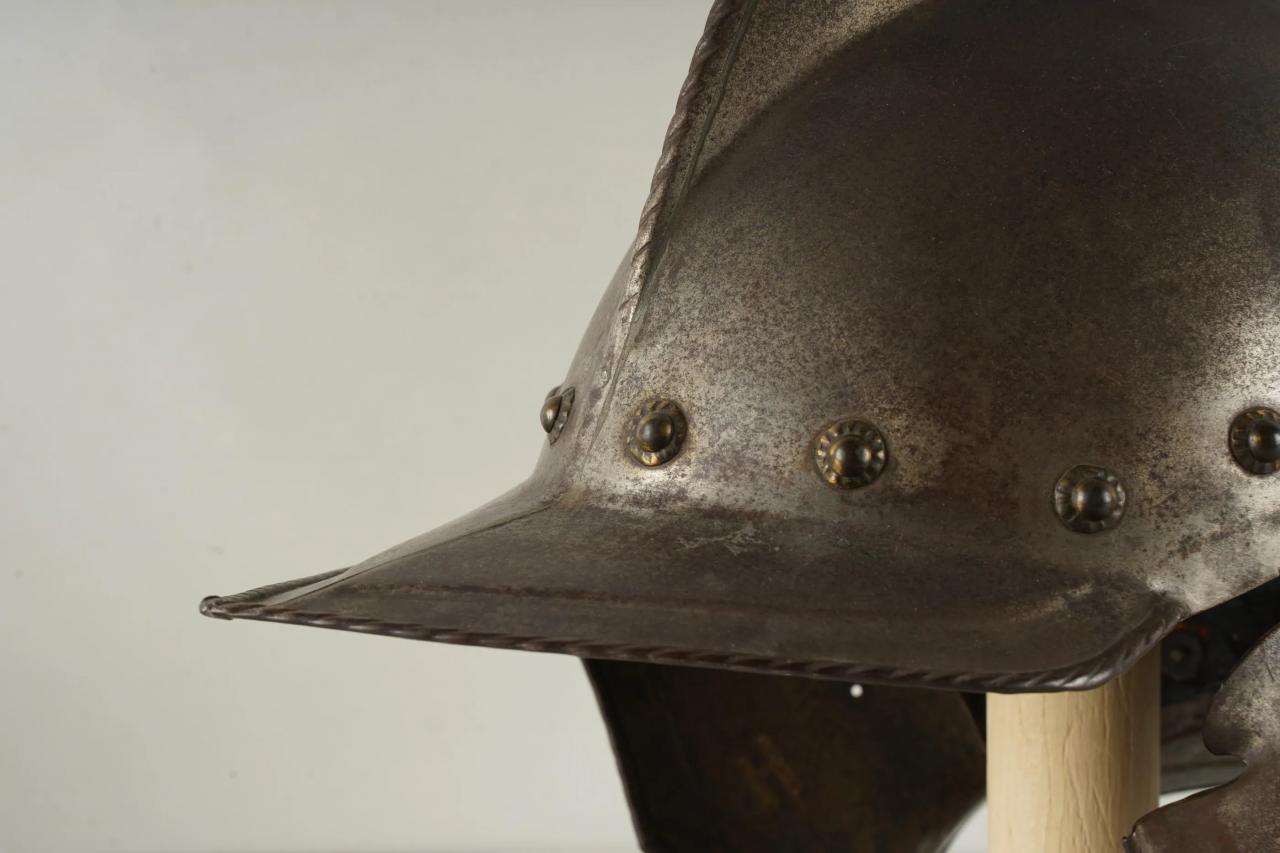

Many of the Victorian reproductions by Ernst Schmidt of Munich were so well done they ended up in museums.
I think you could turn this by representing it in accord with its genuine antiquity as there are collectors who are interested in this type items.

It's more than just a steel helmet, and a nice model to in close resemblance to the original one. As for the letters in the ears, it could very well be from a stock of a theatre or prop rental.

I ended up getting in contact with a museum curator to talk about ways to identify Victorian repros from originals. It seems that ulfberth was right on focusing on metal texture and signs of forming method, and that yes lettering on armor can be arsenal marks but they can just as locally have been added by a theater production company. I also didn't consider how "modern" the calligraphy of the painted lettering was. So all in all a good educational experience. I found it funny that he agreed that my piece was most likely a reproduction.... but he wouldn't put money on that unless he got to see it in person. So no matter what, it is always a bit of a gamble.
