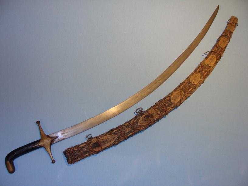

This is a saber which seems to correspond to Sudanese character with kaskara like langet, but the terminals on the guard of course seem Ottoman. The 'pistol grip 'of bulbous form as with Ottoman kilij/pala.
The diamond cross hatch is similar to these patterns on Darfur kaskara hilts of Ali Dinar period, and there were glass type festoons inserted at one time in each lozenge.
The flared scabbard tip is of course as found on kaskaras, but we see this feature of course on the sabers in Mali. The curved blade swords of takouba form in the Sahara are termed aljuinar, but do not have this feature.
Would appreciate any ideas.

Very interesting find Jim, thank you for sharing. To me it does indeed look like a Sudanese interpretation of a shamshir with an Ottoman style hilt. We know such swords were quite popular in Egypt prior Muhammad Ali's destruction of the mamelukes in 1811. Some of the mamelukes in fact escaped South to Dongola, with the sultan of Sennar helpless to do much about them until they were finally wiped out in Muhammad Ali's conquest of Sudan. These mamelukes certainly brought a good number of swords with them, so there would have been examples for local artisans to copy. Alternatively, Muhammad Ali's invasion force consisted mostly of Turks and Albanians from the original army with which he went to Egypt, and many must have carried Ottoman hilted shamshirs with them as well. It is not hard to imagine a situation in which a shamshir blade needed new fittings and local craftsmen did their best to copy the original hilt form, while decorating in their own way.

Here is a shamshir from Gavin Nugent's sold items, which based on the python(?) skin cover on the scabbard appears to have been used in an African, most likely Sudanese context at some point. Persian arms were imported and imitated in Sudan, but as discussed German imported blades were preferred, probably because of the ratio of cost to quality.

This is purely speculation, but could it simply be an Ottoman (Egyptian or Hejaz) shamshir that has found its way south and has been 'sudanised' to local taste.
I would really like to know what is under that bulbous brass encased hilt. Is there any way of finding out?
It could be a pleasant surprise.
Richard

Here are some curved examples I had posted some time ago, but yours is more along the lines of a much more Ottoman-influenced sword.
http://www.vikingsword.com/vb/showth...curved+kaskara

Wow Charles!! Forgot those! THAT firmly places this in Sudan along with those great examples, thank you so much, and its great hearing from you.

The scabbards shape for both your & CharlesS sabers are virtually identical including the reptile skin of the strap attachments. Also, the diamond motifs on both grips and the dress on your scabbard (raised diamonds) are inverse kin to the same motif on many later kaskara including those from Ali Dinar's workshop (raised center with dot). I discuss the diamond motif in my Kaskara in Silver Dress paper.
