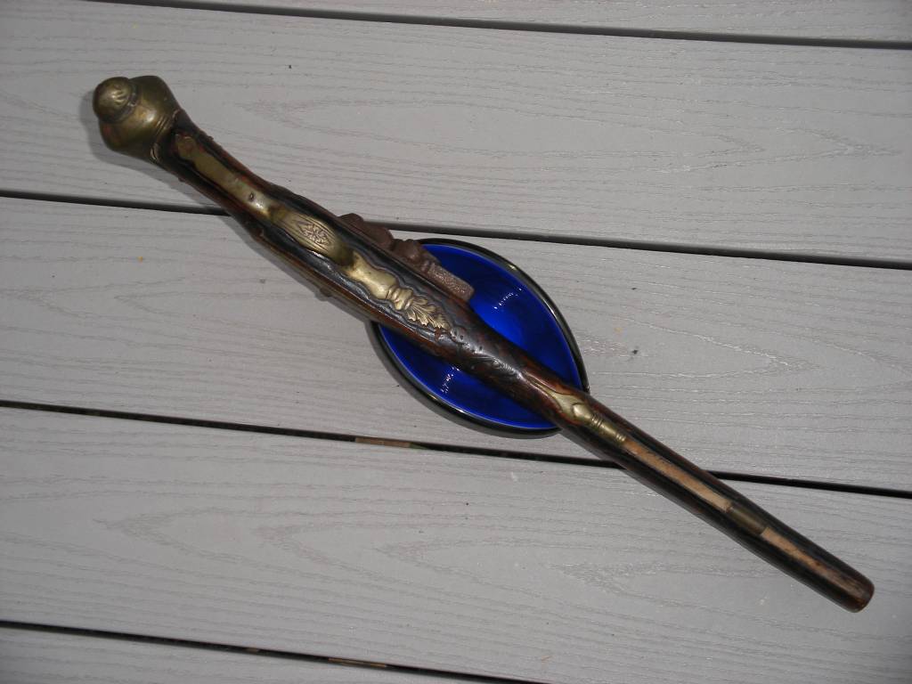

Can any one of our newer firearms loving members tell me something about this pistol .
I haven't seen a lot of these guns; but I have yet to see another barrel like the one shown .
Any help is much appreciated; it's an old family piece .

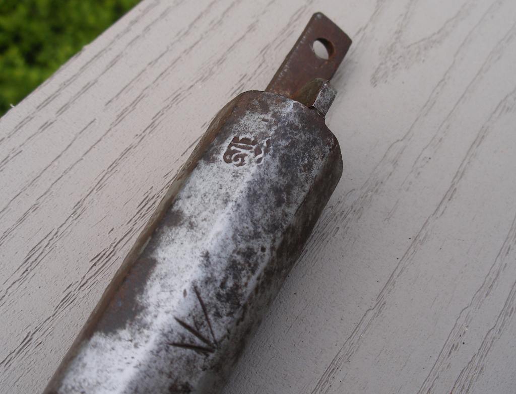

Does anyone recognize the stamp under the barrel ?
And this barrel having no band/s would have been seated in the stock with some sort of resin/tar ?
Hi,
One of the marks looks suspiciously like the British Govt. broad arrow acceptance stamp though how this could be as surely the decor must have been cast at the time of manufacture. Perhaps a better image of that mark may be a help. On the other hand I have a Greek kariofili rifle whose barrel has markings for the Mutzig castle armoury in Alsace that I'm pretty sure didn't leave the factory with the incised decoration on the top. I'm of the opinion that the barrel was captured/looted/reused and decorated thus as an 'aftermarket custom job'.

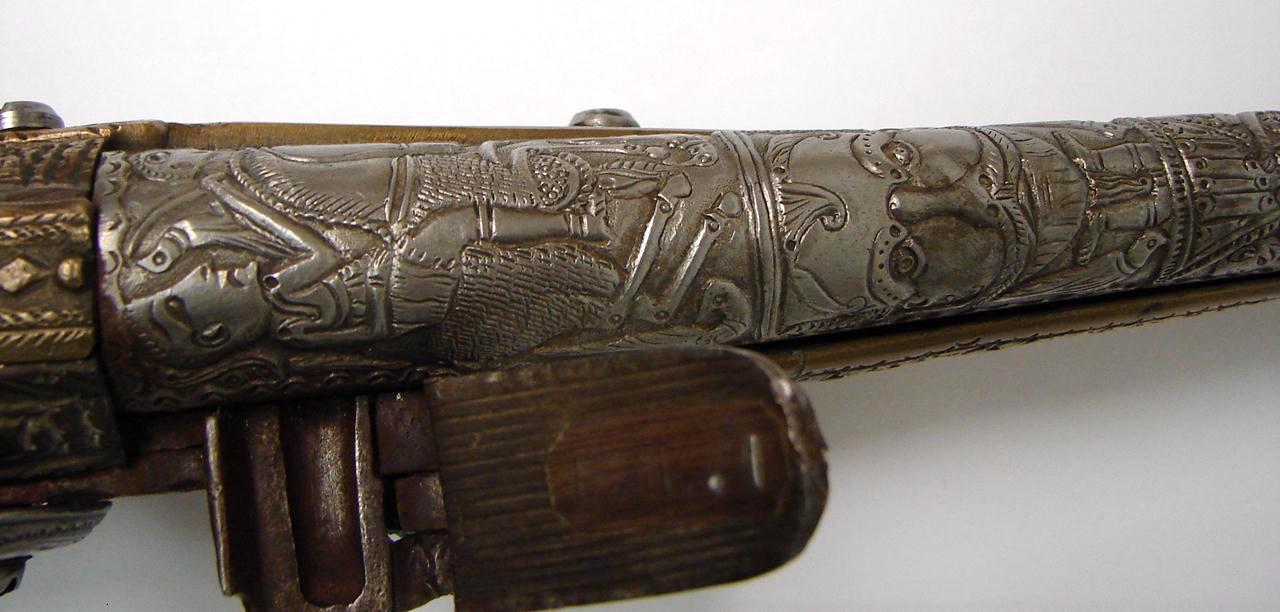

Hi,
This is a section of one of the guns Kubur posted, it does look like stock removal has been used to create the decoration.

Thank you Norman .
I think you're right when you figure that barrel was done after-the-fact; this one looks the same under the rust; it took a lot of work; I wonder when and where .

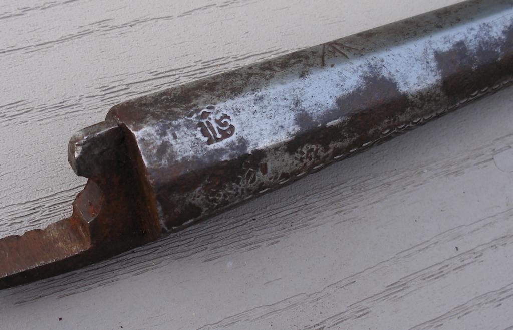

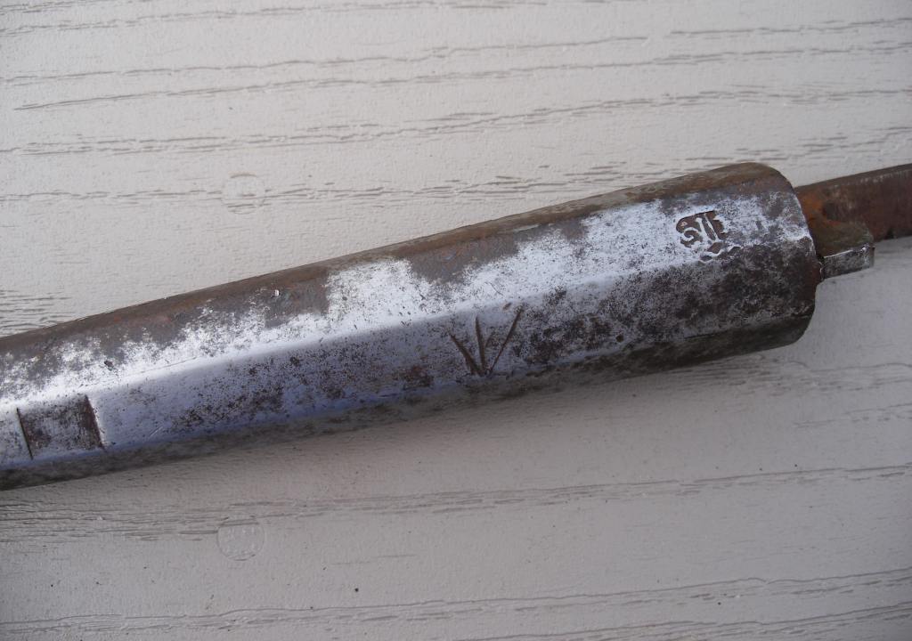

Here are some better pictures of the mark struck in the barrel .

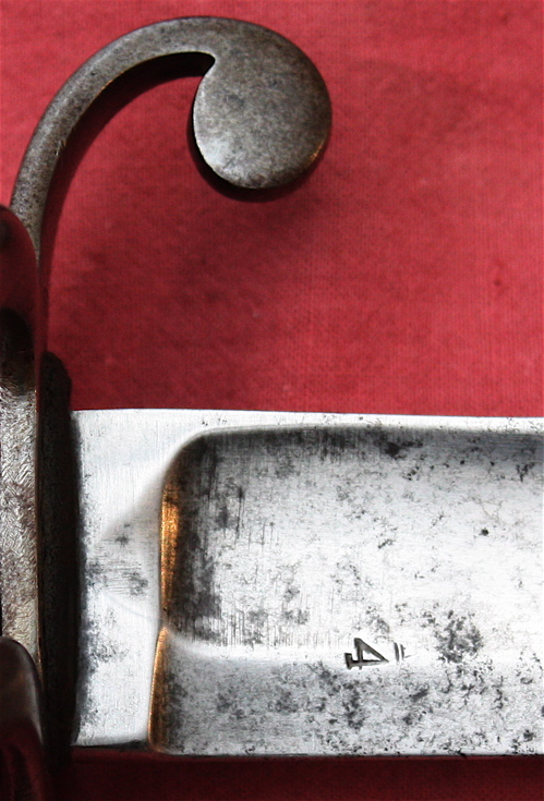

Hi Rick,
There looks to be the numeral 4 inside the broadarrow, if it is it may be an inspectors stamp. The attached photo is of an P1821 L.C. troopers sword of mine, probably early 1830's, with an inspectors mark.

No thoughts on the Maker's stamping ?
Norman, I'm not sure about the figure being a 4; it is far from clear and very light; in fact it looks more like a 4 in the picture than under magnification by eye .

Since the only other arm that came down to us from him was a 'Wedding Nimcha' ; I would think that this places it as being acquired in Algeria or Morocco .
Now I'll have to get the courage to remove the lock and look for marks .

Can you make anything out of the stamp under the barrel ?

2) Unfortunately, "markings" are not one of my strong suites. But it does look like the numeral 4 from the photos, and does look like a stamp. But the proposed broad arrow doesn't appear to be a stamp (?). Looks more like a cut or engraving. The same with the two straight marks just ahead of the arrow. I've never seen one of these pistols with an English proof. Unless Afghan made. Seen Belgium, Italian, and even one German marked barrel, and of course locally made barrels. But not English. Or at least any proofs.
The other stamp, that looks locally done, I have no idea.
