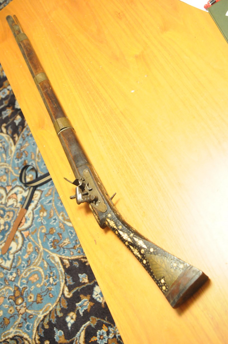

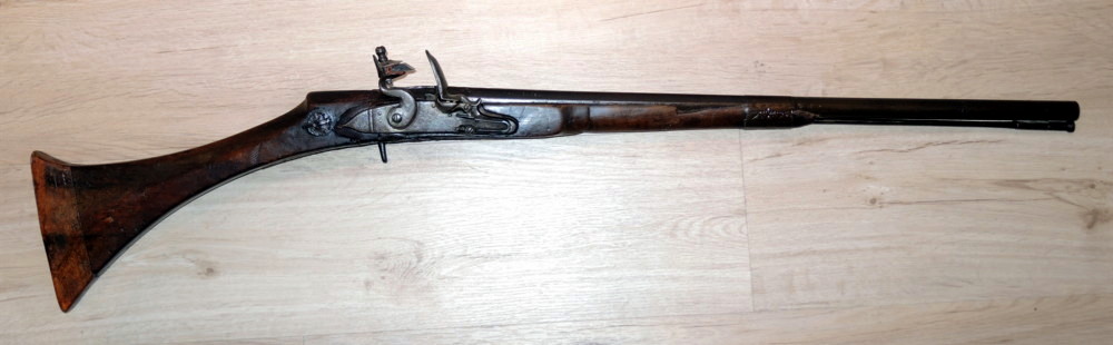

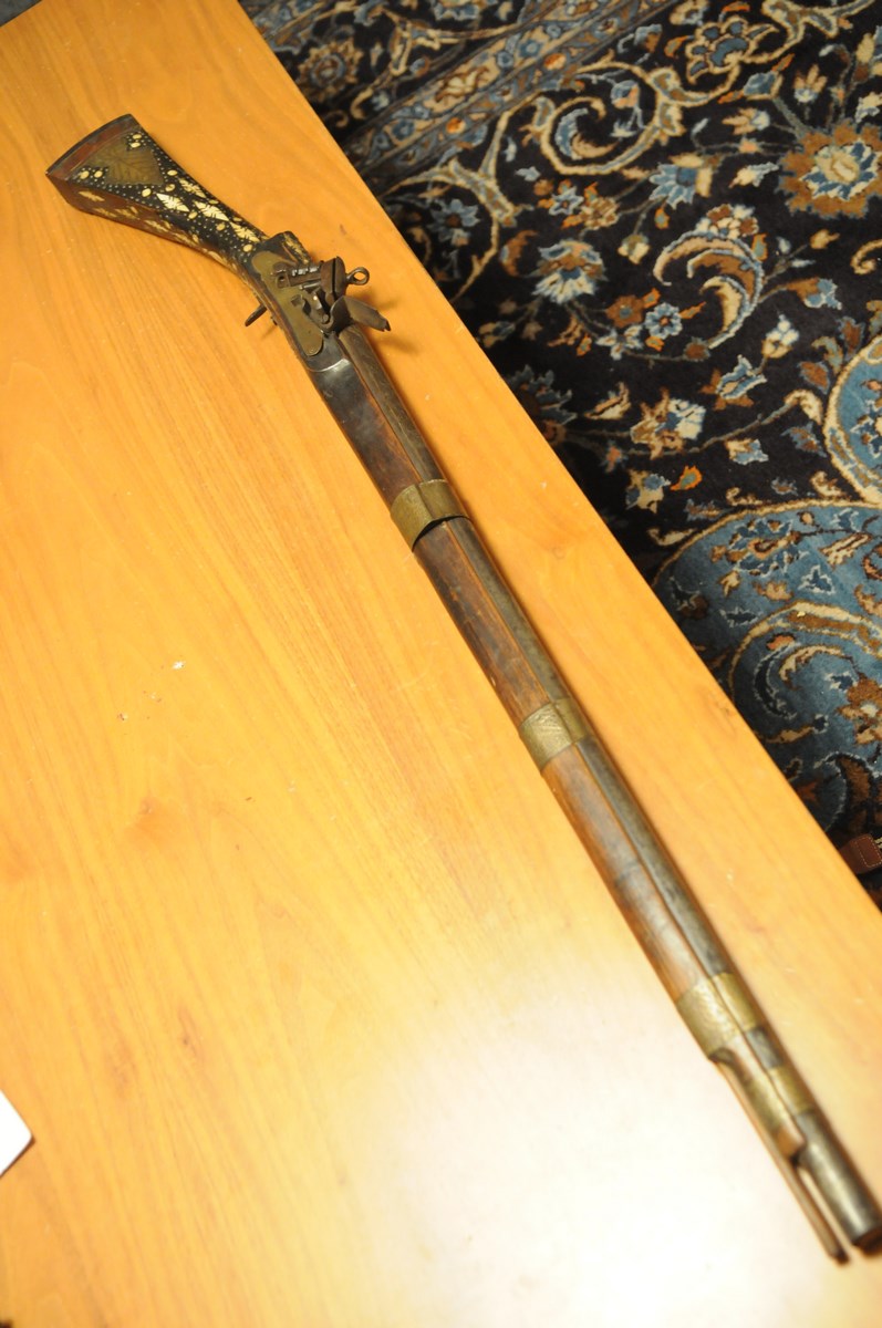

Do you have any ideas about the specific area of the Balkans that this musket originated?

Oh yes
100 % Tunisian / North African
look in our forum with these key words
plus the lock looks very Spanish or Portuguese to me

Old 10th December 2018, 10:16 AM   #6

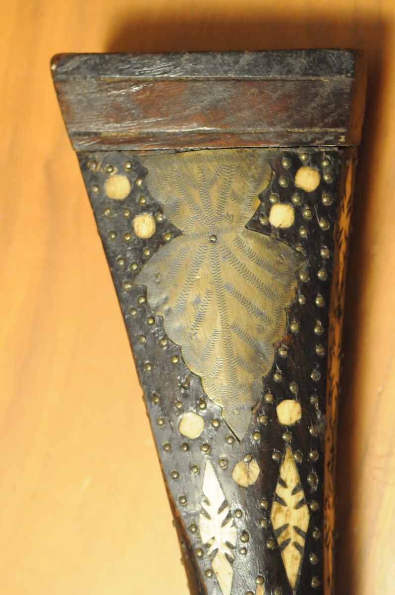

Just to add something the butt is very Ottoman and i'll place your gun in the 18th c. not the 19th c.
Tunisian as i said and you have something similar in Tirri's book...

I do not believe that this gun is Tunisian or in fact North African. The "boxy" butt profile IMHO is all wrong for that region.
Stu
Old 11th December 2018, 09:37 AM   #8
Stu
Ok I own you some explanations.
Yes the butt / stock is probably Turkish or from the Balkans.
The lock is Sardinian according to Tirri but I think more at a Spanish or a Portuguese lock. The decoration is pure Tunisian.
Now if you don't have it, buy Elgood's book on the Balkans, he explains how Ottoman guns were exported to North Africa and Tunisia and fitted for the local market.
So yes this gun is Tunisian but with some pieces from all over the Meditteranean. Look at the so-called Ottoman Balkans guns they are fitted with Italian lock and canons, but they are not Italians...
I hope that I manged to convince you...

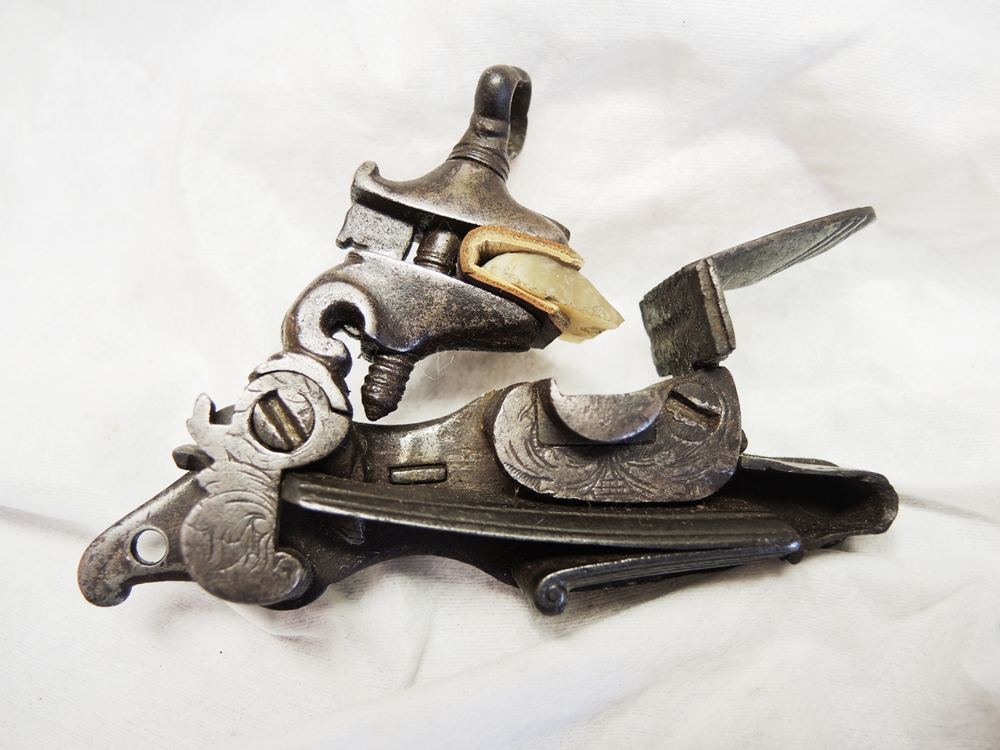

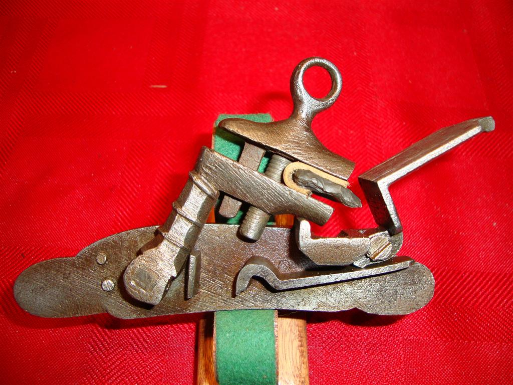

Here is an image of a sardinian lock, already uploaded in this forum
Affectionately

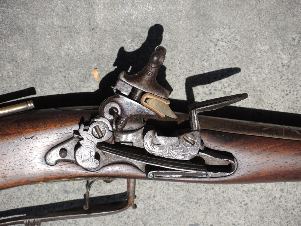

That is a very interesting musket. As Stu mentioned, the stock shape is done very much in Ottoman/Turkish fashion. But as Kubur mentioned, the decoration does indeed remind me of Tunisian. The lock is definitely a Portuguese variant. Probably made for export. And the Link provided above which included Philip's comprehensive post is most helpful.

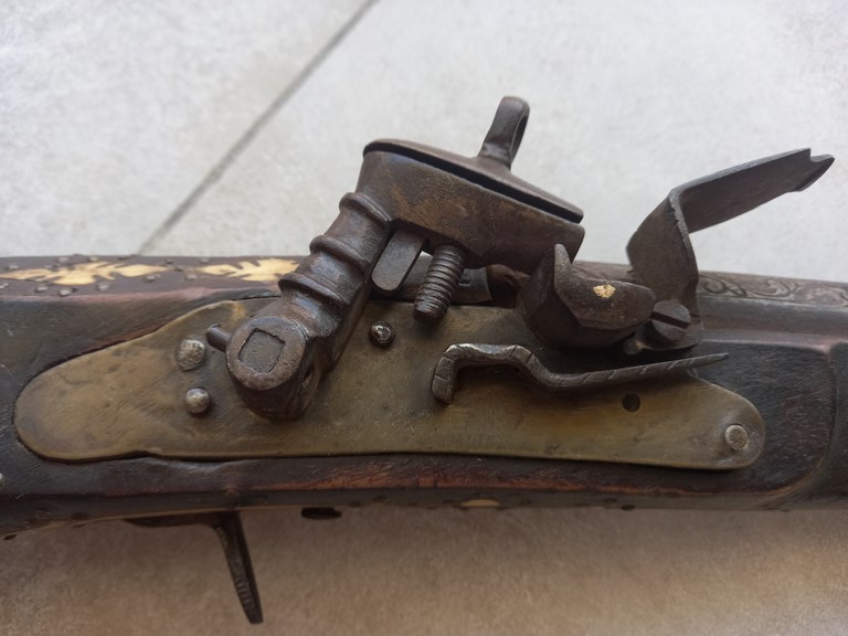

Eftihis: Could you post a close-up photo of the lock ? If possible, an outside, inside, and top views ?
Again, a really nice and interesting shoulder gun. Could have been made for a Tunisian customer using a variety of parts available.

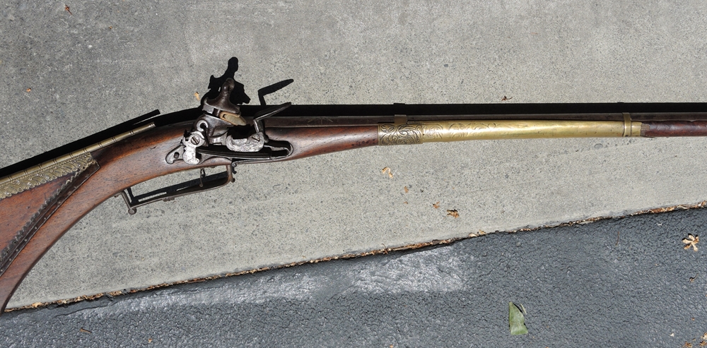

Here is a pic of the later made, cheap quality copies made for the African continent. This one is in working order, but took some work. LOL

The lock presented by Ricky is not exactly a copy. because the half cock is achieved by the little piece that is in front of the cock. In change in the weapon presented by Efthis, the half cock is achieved by a notch in the tumbler, as in all lock with vertical shooting system

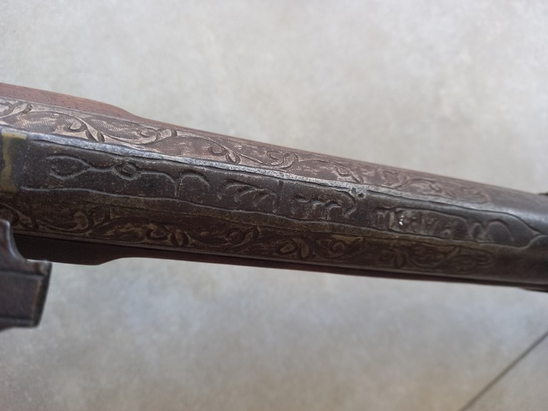

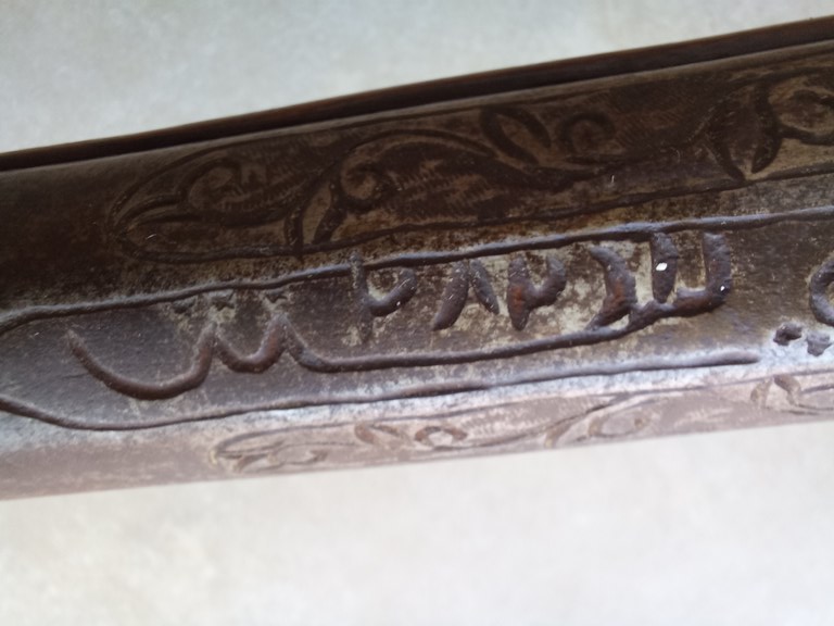

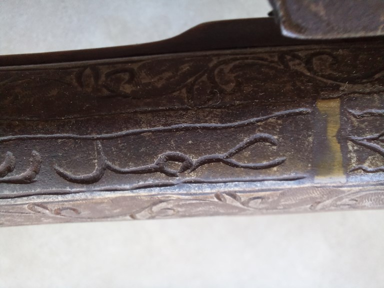

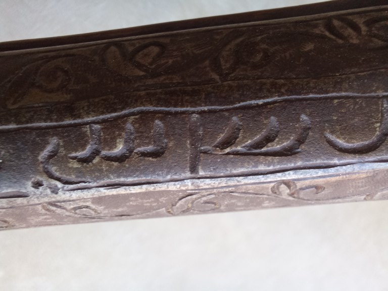

Somehow, when posting, i missed to mention the inscription that is on the barrel. Hope someone can tell us what it is!
Old 17th March 2021, 04:57 AM   #19
Philip
Philip's Avatar
Location: California
Posts: 1,036
Could you please share a photo of the INSIDE of your lock? I might have some more info on it if I could verify what the internal mechanism looks like.
Old 17th March 2021, 09:11 AM   #20
kwiatek
Join Date: May 2019
Posts: 156
The inscription on the barrel says
ستة ٢٨٢
“Year (1)282” which is equivalent to 1865-6
The other inscription is more tricky. I think it says
عمل ساسي
“Work of Sassi”
Sassi is a name common in North Africa. I am not sure if it derives from a place, in which case it could be understood as having been made in that place. It might also come from Awlad Sassi, the name of an Algerian tribe

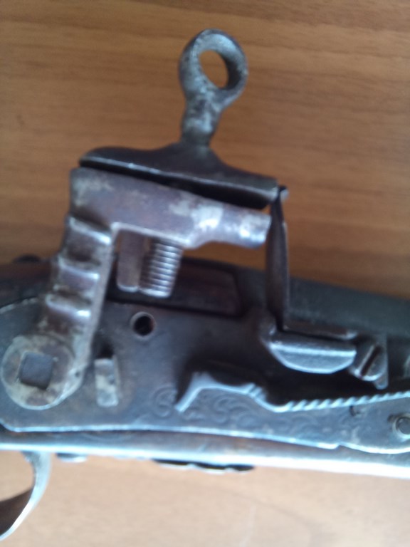

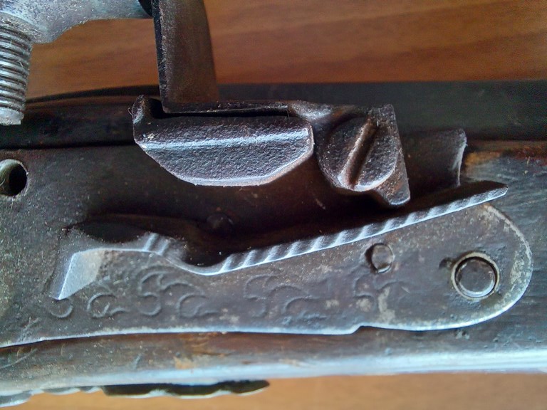

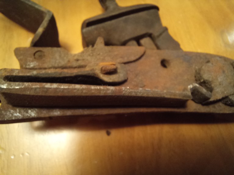

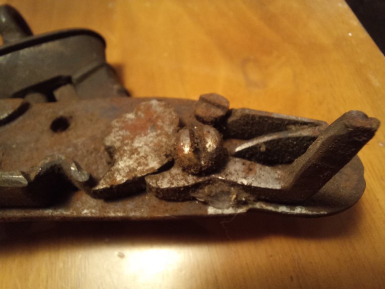

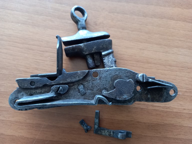

Thank you very much for the translation kwiatek! Dear Philipp, here is the back of the lock.
Old 18th March 2021, 06:38 PM   #22
rickystl
Join Date: Jul 2010
Location: St. Louis, MO area.
Posts: 1,633
Hi Eftihis
Thanks for the lock photos.
The lock looks Portuguese to me also. One difference I notice is that the tumbler has to notches. One for safety and the upper for firing position. The Portuguese locks I've seen have only one firing notch on the tumbler as shown on the lock I posted. There is usually a thumb piece in front of the hammer neck that can be rotated to engage a slot in the neck of the hammer to act as a safety. Maybe yours is a different variant (?)
Philip can address these Portuguese locks better when he returns.
Again, very interesting gun with a mix of cultures.
Old 19th March 2021, 01:10 AM   #23
Philip
Philip's Avatar
Posts: 1,036
Default two varieties of Portuguese locks, explained
Thanks for the additional photos showing us the lock interior.

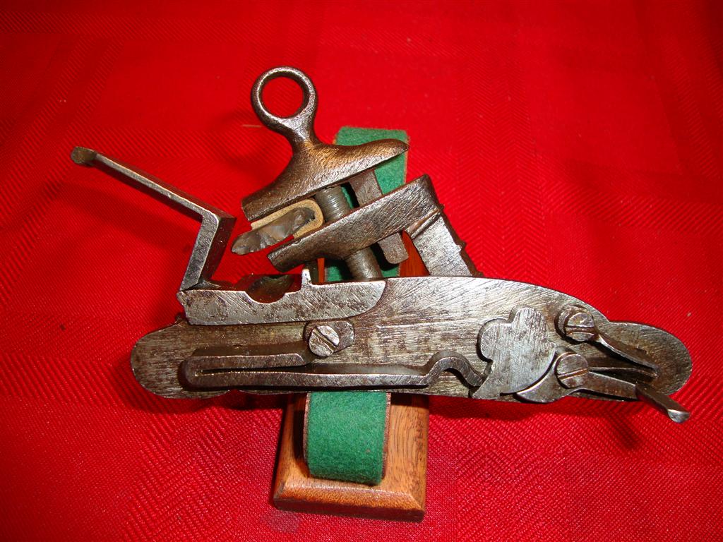

What you see is perhaps a North African- made version of the most common of the Portuguese-designed flint mechanisms. It's called a fecho de nó or "knot" lock. I can't explain the significance of the term, it appears to be period nomenclature and not a later collectors' neologism, like "miquelet" or "mortuary sword" coined generations after the fact.
Be that as it may, the essentials of the fecho de nó are a typical flintlock tumbler and sear system with half- and full cock detents. On a lock with external cosmetic or stylistic features that are typically Portuguese.
Rick points out that there is a similar-looking one that has a gravity- or thumb operated pivoting stop on the outside of the plate that serves as a safety, engaging a notch at the base of the cock. That type of lock is called fecho meio à portuguesa e meio à francesa, or lock half-Portuguese and half-French. It has a French-style tumbler and sear arrangement (though without half-cock notch) and the Portuguese pivoting safety which is seen on yet further variations of flintlock mechansms from this country. Please refer to post #14 for the late export example that he shared with us.
It's important to note that despite the Portuguese preference for these pivoting safeties, the behind-the-cock "dog" that was popular in parts of northern Europe (especially England) was not favored here.

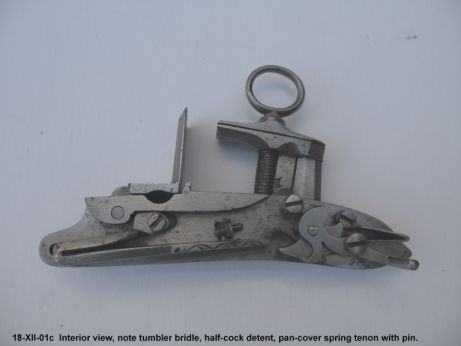

Default an export Portuguese lock for comparison

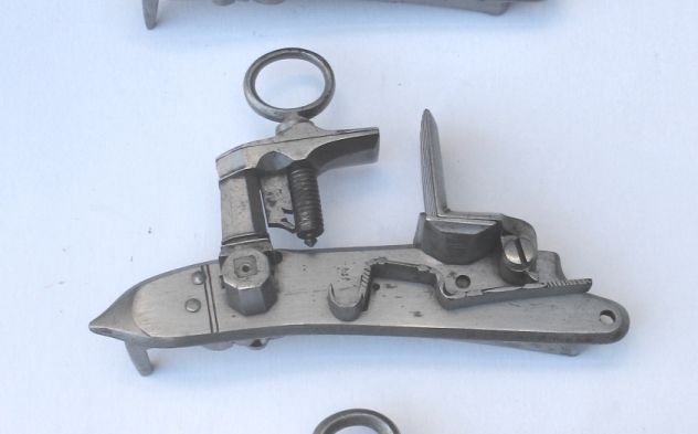

Attached are a couple of photos showing an example of a fecho de nó made in the 19th cent. for export, probably at Braga (Portugal) or Liège. It is "in the white", unused and most likely never installed on a gun. Compared to the obvious production shortcuts and fairly crude finish of the example already on the gun under consideration (not to mention late-production export trade guns from Belgium), the build quality is quite good on this one and the mechanical essentials are the same.
There was quite a market for flintlock guns in Africa down to the eve of the First World War despite the growing use of percussion systems worldwide. Because of the long Portuguese presence in some parts of the continent, there was continued demand for archaic flint systems such as this due to the strength of tradition. The complete guns varied a lot in quality; the typical trade musket was cheaply made, often with a red-painted stock studded with brass upholstery tacks and incorporating a small mirror on the buttstock. (again I refer you to Rick's post #14 showing the extremely rough quality of the locks used on such guns, and his mention of the effort needed to tune it up to work properly). However, one occasionally sees very well made ones, obviously for sale to persons of means. The popular name for these guns in Portuguese style was Lazarinos, in tribute to the Brescian family of barrel-makers who flourished a couple centuries earlier.

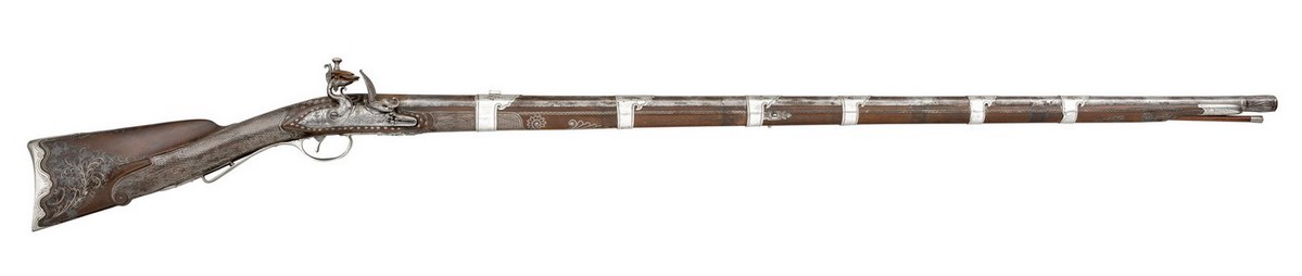

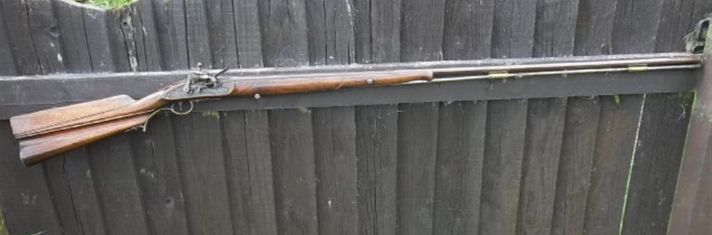

Here is a higher-class example of a 19th cent. Liège-made fowler in Portuguese style,of better quality than the average "trade" musket, with a hybrid Portuguese-French lock as explained previously

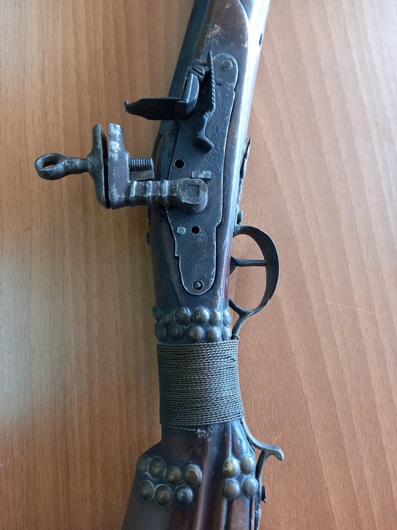

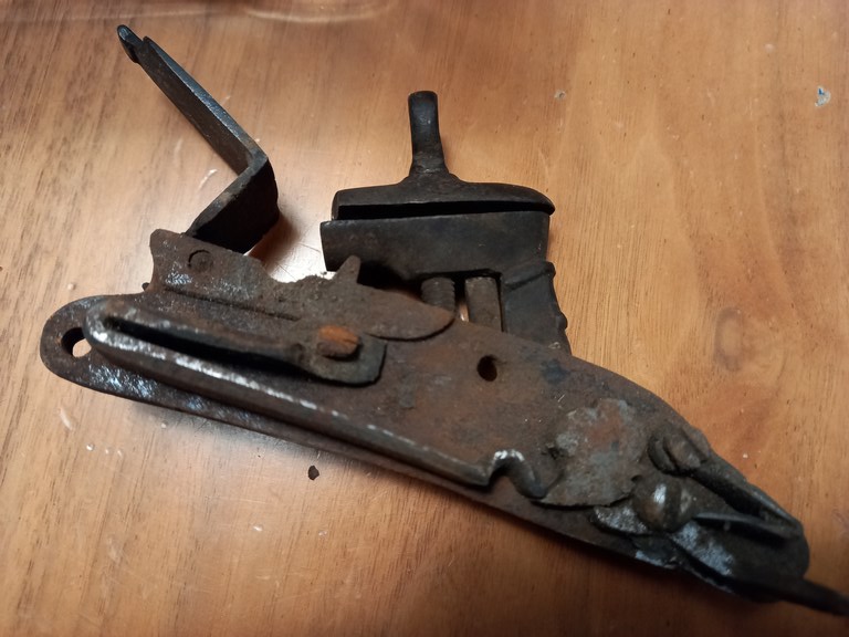

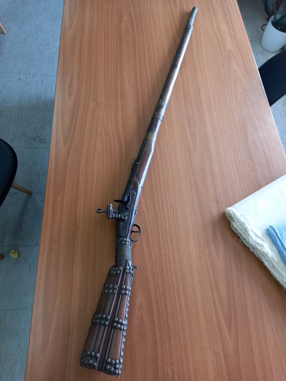

Default Another similar lock
Again, a north African musket.
