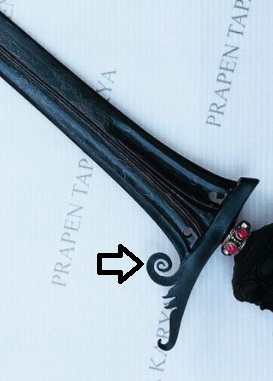

Default Meaning in a Balinese keris
Hi fellow members, anyone knows what does this symbolize where the arrow is pointing? Is this consider keris Ligan and who usually owns such keris daphur? Priest?
photo copyrighted of the owner.

According to the book "Keris Bali bersejarah" page 74, this is supposed to depict a cock comb? However your specimen is much more spiralling than in the book picture.

what does a cock comb means in Bali culture?

I thought i remembered either reading or being told that this form of gonjo was indeed reserved for priests, but i cannot find the reference point at this moment.

Keris ligan is also known as "Keris Pedang", it is a form of keris with a warrior association.
The first time I saw a similar treatment of the greneng to this one was in Mario & Vanna Ghiringhelli's Little Red Book --- the original "Invincible Keris". This keris was a cengkrong style and the caption stated that keris with this blade style, ie, cengkrong, was worn by preachers & scholars of religion & theology.
Note:- blade type, not gonjo type
The first time I saw a keris with this extremely exuberant spiral ornamentation to the greneng was in the courtyard of a very well known Balinese m'ranggi and keris dealer, it was a recently made Madura keris, and it was hanging from the exposed framework of a small pavilion. When I asked why it was hanging there, along with a large number of other newly made keris I was told that all these keris were there to permit them to age naturally.
I have not seen this type of gonjo ornamentation in an old keris, only in recently made ones.

Thanks Alan for sharing. I am clear now about my doubts. Cheerios.

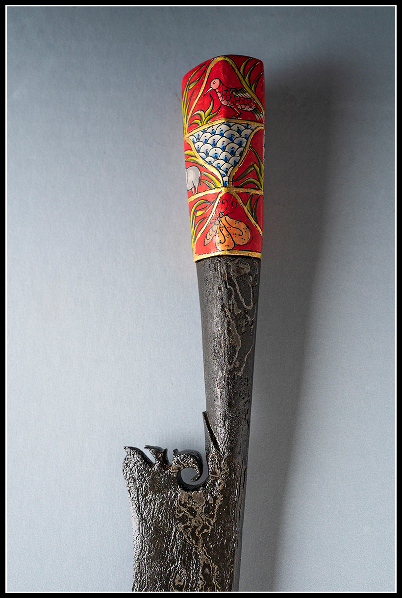

Thank you Alan, and I attach the pic of the kris in question from Mario & Vanna G.
Ha ha, RIP Wayan Ritug! I agree with you that the kris from Anthony is most probably a recent creation.
