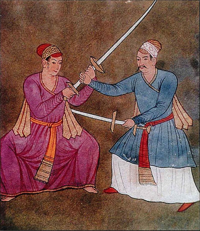

This illustration from the Nihang-nama shows two combatants using mel puttah bemoh in what seems to be half-swording technique. This got me wondering if this sword was based on Portuguese montantes, specially since it seems mel puttah bemoh did not appear until before the 16th or 17th century. Anyone have info on this?

This is a most interesting question, as noted, these are most rare swords, and as you have mentioned the term 'half sword' you must be familiar with this sword technique. These do not seem associated with Portuguese styles of sword fighting nor swords, but German two hand (zweihander).
The only possible Portuguese connection might be the blades that came frm them, often rapier blades.
These appear to have been known in 16th century and referenced by c. 1620.

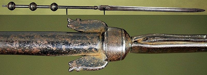

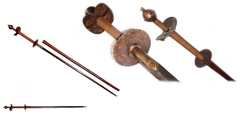

A picture always helps for us novices...The two gentlemen mentioned above are apparently Sikh Nihangs.

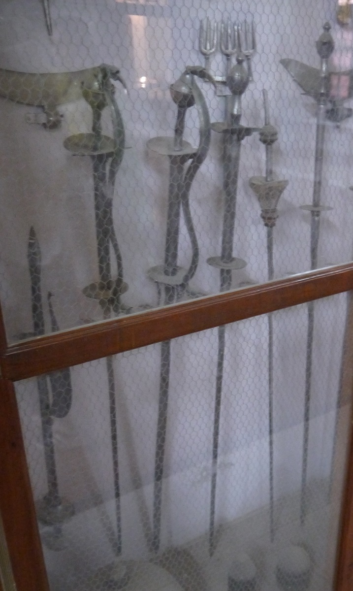

Unfortunately, or rather fortunately, not everything is so simple. This sword had a name. So far, we can say for sure that it is very likely that such a sword was used by "Banabaz" troops by analogy with "Shamshirbaz". The point is, in order to accurately understand the term (and the subject itself), it is necessary to understand the etymology. Even now, the names of objects are not given without any meaning ("smartphone" f.e.) especially in ancient traditional culture. I would not like to publicly voice something that I am not completely sure about, it takes time to clarify this, but it is very likely that in India such a sword was presented as consisting of two parts and and could be named by analogy with how "an arrow" could be named by the name of one of its parts.

Wayne, thank you for the illustrations! As always, especally in this case, a picture is indeed worth a thousand words!!!

Wayne, thank you for the excellent illustrations! As said, a picture is worth a thousand words, especially in these kinds of situations!!

You are welcome, Jim. I note in Mercenary's photo a pair of these two handed weapons that have a snakelike double finger guard, each 'wiggle' protecting a section of grip below the corresponding disk guard, I'm assuming for parrying. (And an elephant proboscis 'hook' on the pommels)
