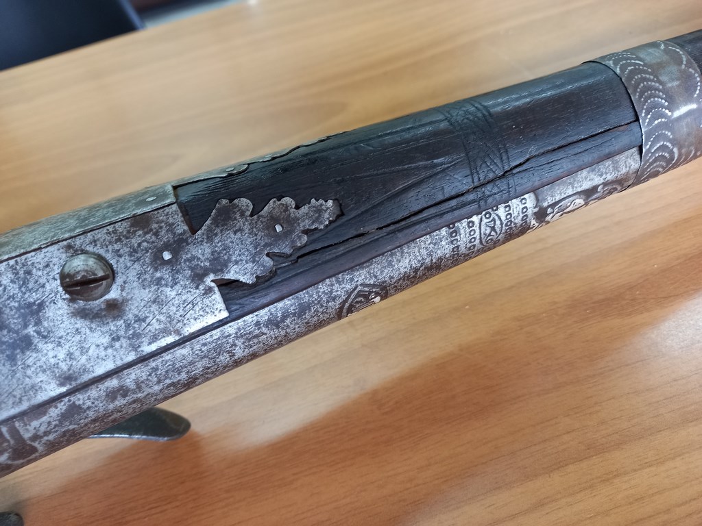

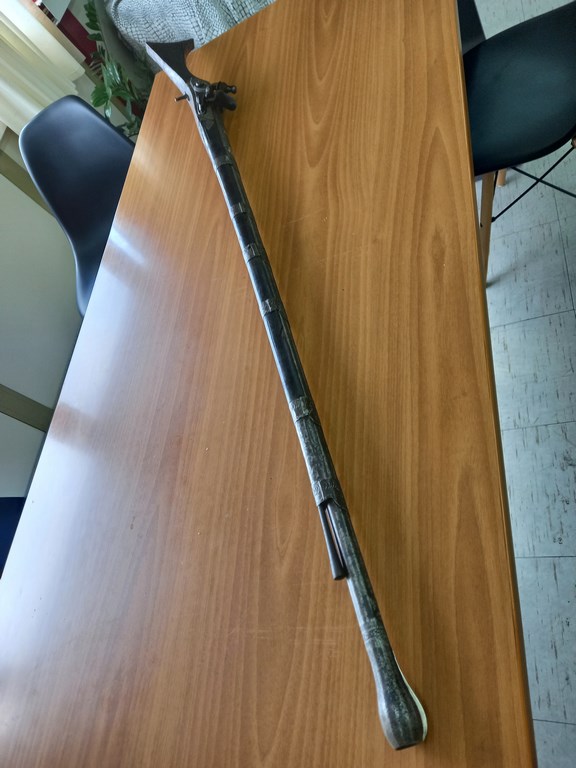

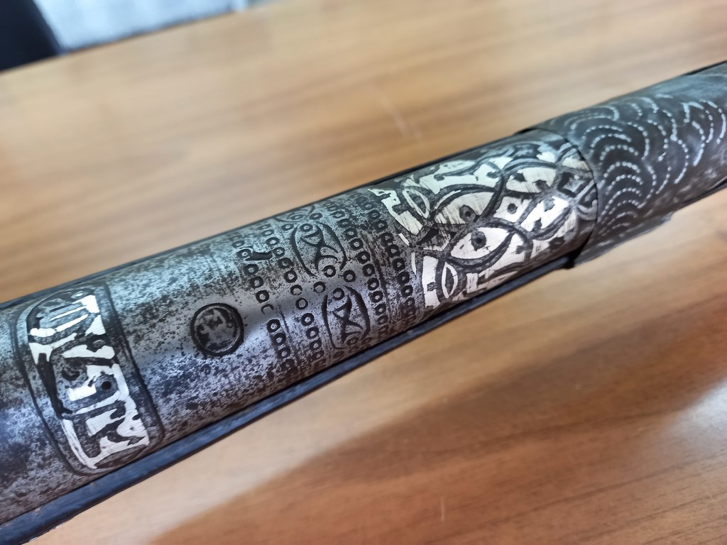

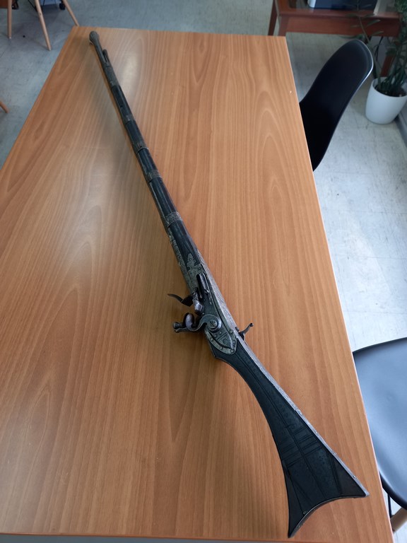

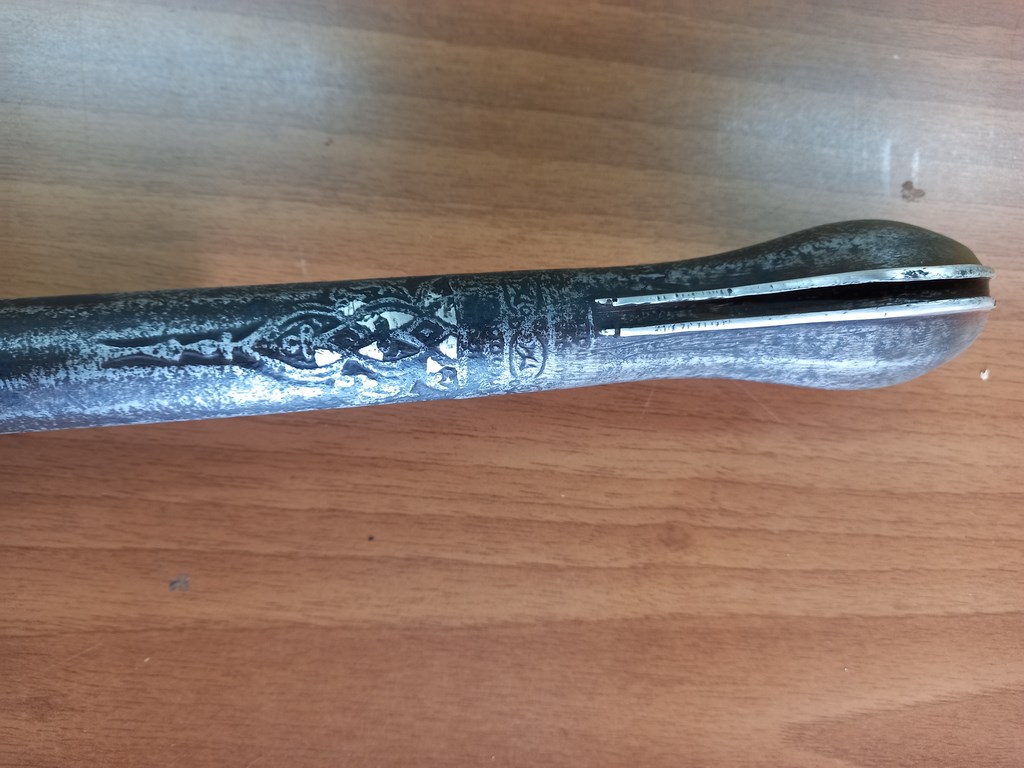

This balkan gun "kariofili" is a blend of 3 elements. The stock, which was usuall in Albania, Greece and other balkan areas,(known as "kariofili" in Greece or "rasak" in Albania), the lock, which is stamped with the "venetian arsenal" stamp, and the barell which is an early ottoman one, and obviously started its life as a matchlock. If i read correctly the inscription says "Allah" and the year 1517!!! (923) There has been a repair in the stock evident from the different colour of the wood in both corners.

Thanks for sharing this! The barrel is a standout feature on a gun that is quite nice overall.

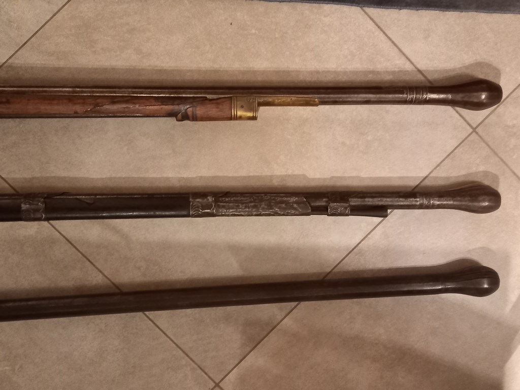

I am most captivated by the shape of the muzzle, a very bulbous form, one might say tulip-shaped. It's a quite early design, derived from English prototypes, late 16th cent. (there is an exceptional example of an English snaphaunce petronel whose barrel has a similar mouth, inv. no. 10428, Nationalmuseet Kobenhavn, published in Brian Godwin's article "Some observations on the decoration of English snaphaunce guns 1584-1622" in the Handbook of the Spring 2015 London Park Lane Arms Fair.) The author notes that this muzzle shape is of a general form "strongly associated with English firearms of the period 1580-1620".
Of interest is that once they went out of fashion in Europe, these bulbous muzzles became popular in the Maghreb, where they are sometimes found on Moroccan snaphaunce muskets made until the end of the 19th cent.

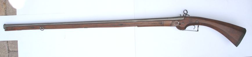

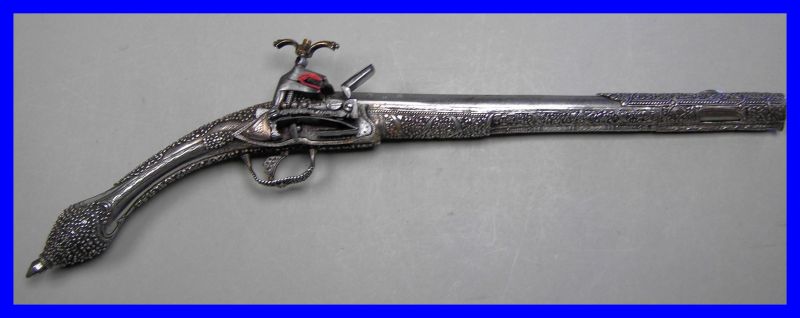

Default image
Here's the piece I referenced in the previous post. This example has an inlaid band at the point of maximum expansion, but the concept is unmistakable -- a marked but gradual flaring of the exterior contour of the muzzle, then a more abrupt reduction down to a diameter close to the bore diameter.

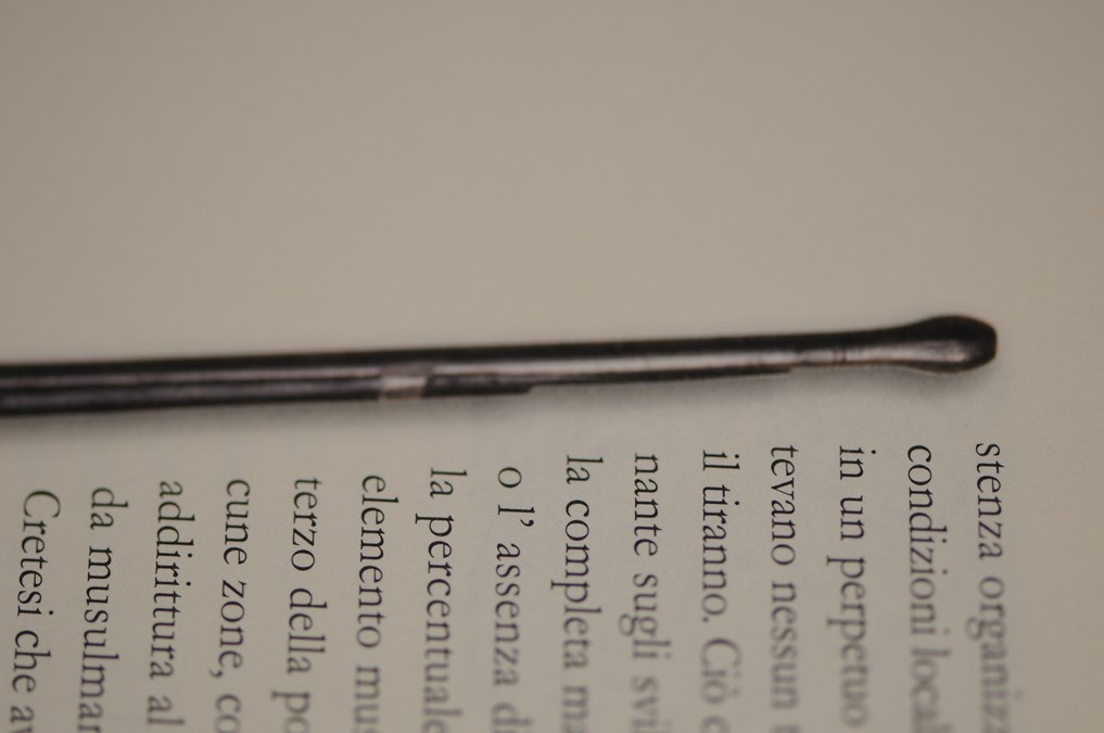

Thanks Philipp! The question is when the first "tulip" ottoman barell was made? Was it inspired by the english one, or the opposite happened? BEcause if i read well the barell's inscription has a date that corresponds to "1517"! Here are some more similar ottman barells.

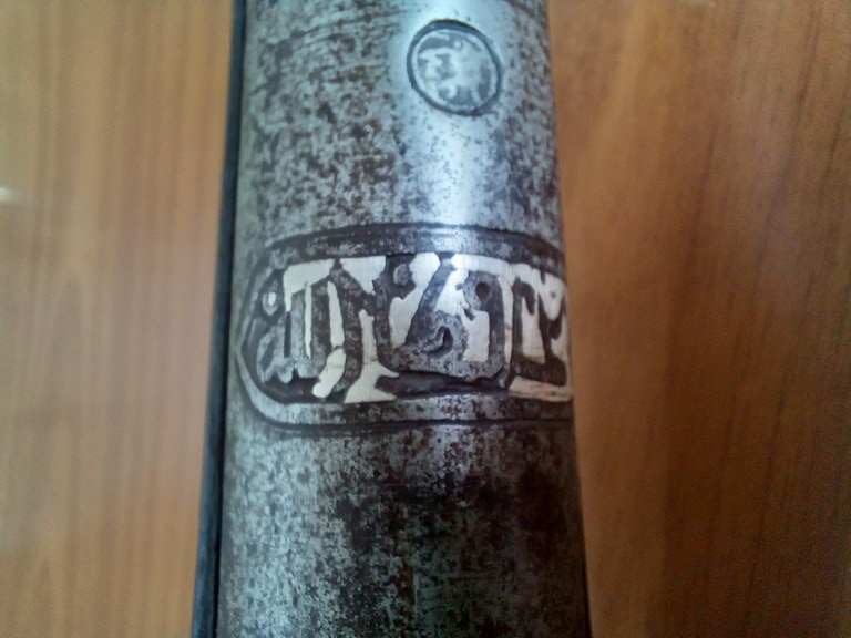

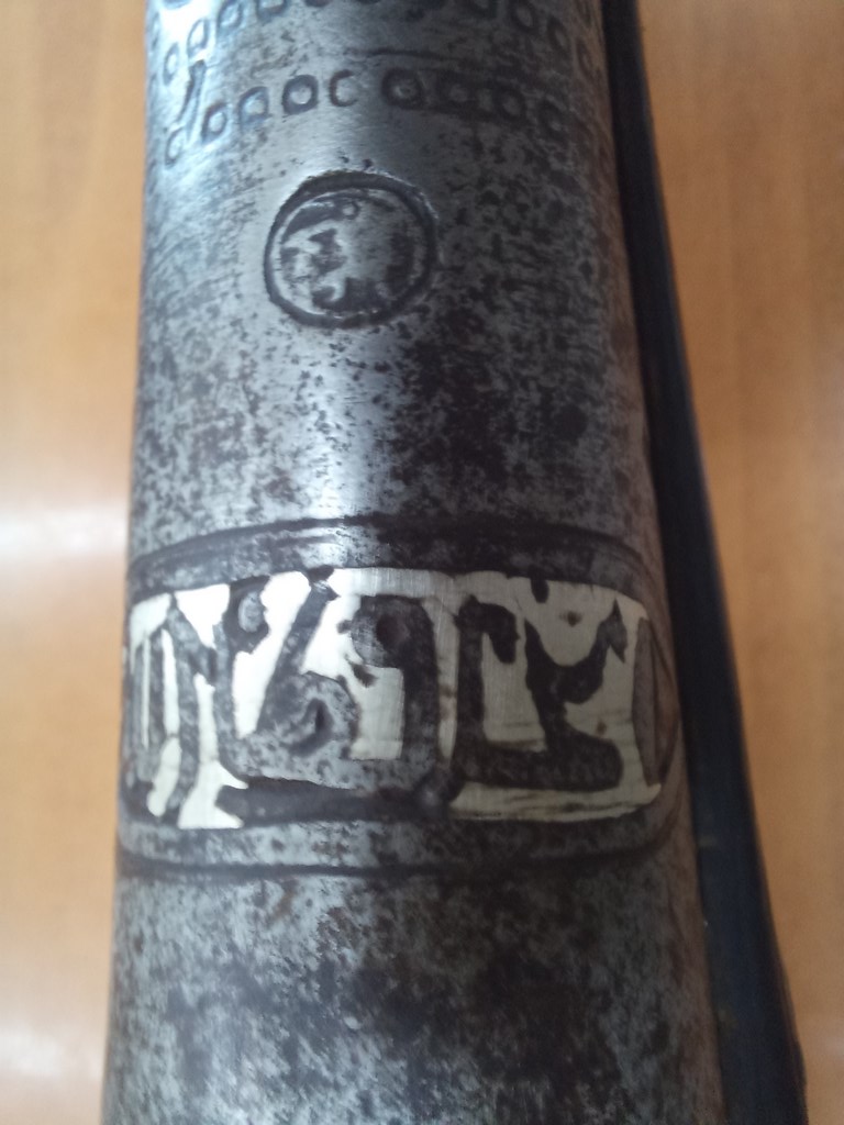

I cannot read the date, but the barrel sure looks very early. Very nice gun overall, but that barrel has the potential to be special,
Teodor
Old 10th March 2021, 10:45 PM   #7
kwiatek
Join Date: May 2019
Posts: 156

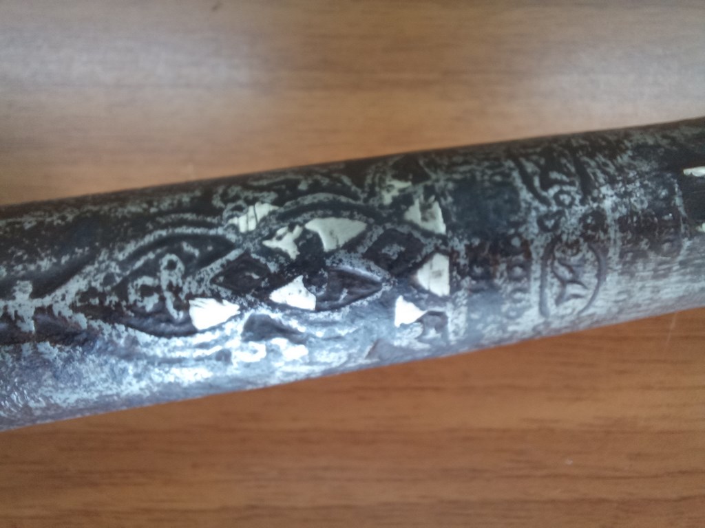

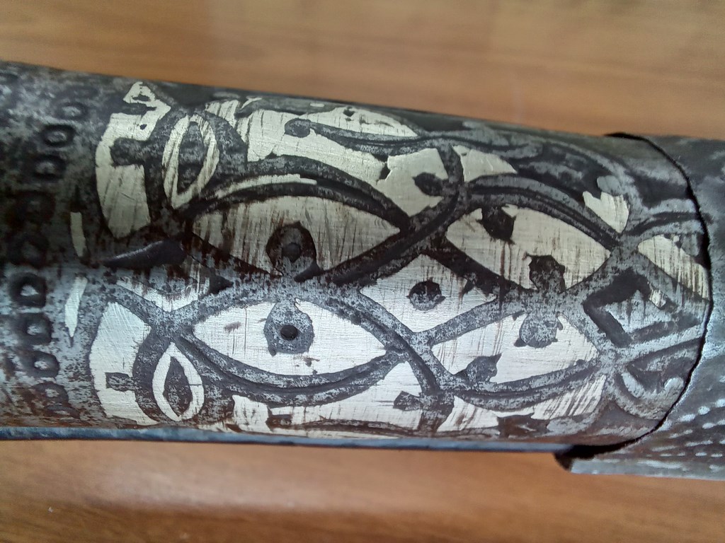

Very interesting piece. I don’t think it’s a date. It looks like, with a slightly strange spelling
الحافظا الله
“The Protector is God”
You would instead expect it to be
فالله خیر حافظا
“And God is the best of protectors”
The latter is Koranic (12:64) and common as an inscription on weapons.

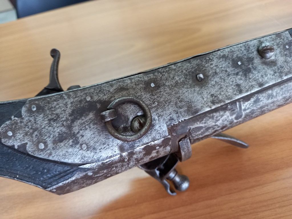

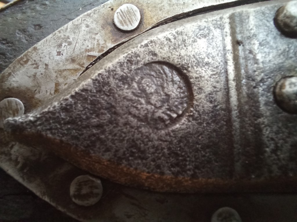

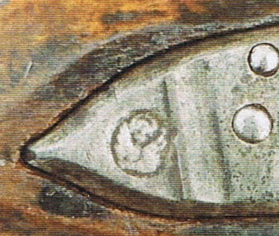

The lock bears at the left side the lion mark of Venice. Probably this gun has been made in the bay of Kotor Boca Kotorska), which stood under Venice government and where have been lots of the well known and wonderful Ledenica all metal pistols

As mentioned, the barrel would likely be of Turkish origin. I've never personally seen one up close. You do see barrels from Moroccan snaphaunce with the smaller bulbous muzzle as Philip mentions above. There is a good possibility the barrel is indeed older than the rest of the gun. That would not be surprising. And as Philip mentions, it's a feature that came about during a much earlier period. But, other than aesthetics, I can't come up with a potential reason for the large, over-sized tulip shaped muzzzle (?) I'll have to think about this for a while LOL Also, the decoration and inscriptions on the top of the barrel are most interesting. Don't recall seeing a similar pattern.
If you get a chance, maybe you can take a pic of the bore at the muzzle and a couple pics of the lock.

Thank you all for your comments! For me the most possible scenario is that this musket was built in a Venetian controlled area, using a captured ottoman barell and a lock from Venetian arsenal. However, the problem is i cannot trace this form of barell in manuscripts and icnography of the period (16th-17th c). Also althought this tye of barell is for sure early turkish. i cannot find it in Askeri museum objects. Also Turkish collectors whom i talked with, they dont know this design! Is it possible taht is a desigm manufactured somewhere in teh Balkans after the ottoman conquest? Here is another musket that uses this type of tylip barell (i thinh in a second use). It belonged to a Cretan revolutionary and is held in the historic-ethnological museum of Athens.

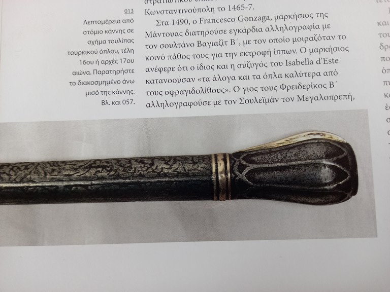

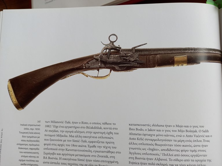

Here are some more examples from Elgood's book "the arms of Greece and Balkan neighbors" The last photo is sypposed to be an Italian gun with a turkish tulip barrel, but the photo shows only the stock.

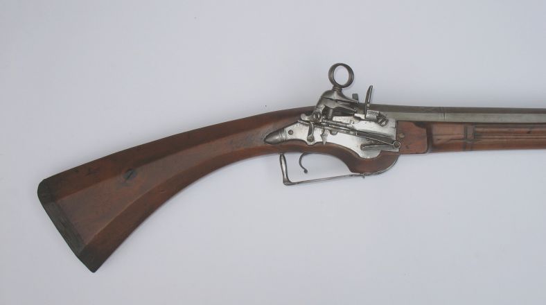

Here is an example I have, of Brescian manufacture ca. 1630, built on a non-tulip, non-damascus smoothbore Ottoman barrel. The faceted buttstock has a profile that resembles that of the later Balkan guns called dzheferdar. Here, the incised designs are typical north Italian. The interesting thing about this stock is the prominent bulge ahead of the angular trigger-guard, which is a holdover from earlier wheellock guns, whose mechanisms had an outward shape determined by the size and position of the wheel but which was irrelevant with the now-novel miquelet lock.

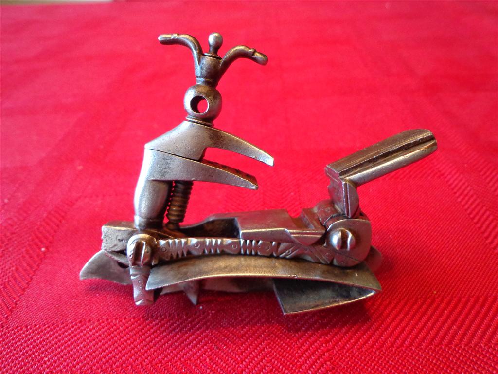

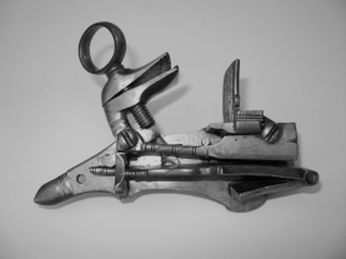

The earliest surviving examples of these "Spanish" locks dates from the first quarter of the 17th cent., corroborated by signed examples in museums. This one is believed to be made in Brescia, ca 1630, and the gunsmith would have been working with a new, imported technology. There are stylistic elements carrying over from the wheellock era, but more germane to the students of early Ottoman firearms is the long "bridge" linking the cock pivot screw to the priming pan. This is a characteristic of virtually all miquelets made in the Ottoman Empire, the Caucasus, and Iran down to the 19th cent but is something seldom seen on their European antecedents, except for a handful of published, early specimens.
Other characteristics in common with the later (and much smaller) locks made in the Balkans are triangular jaws clamping the flint in place, and an excessively stiff mainspring. Mature versions of European locks (whether Spanish, Neapolitan, Portuguese, or their German imitations) have narrower jaws and a much more efficient mechanical design using a lighter mainspring but resulting in faster lock time due to reduced inertia in the moving parts.

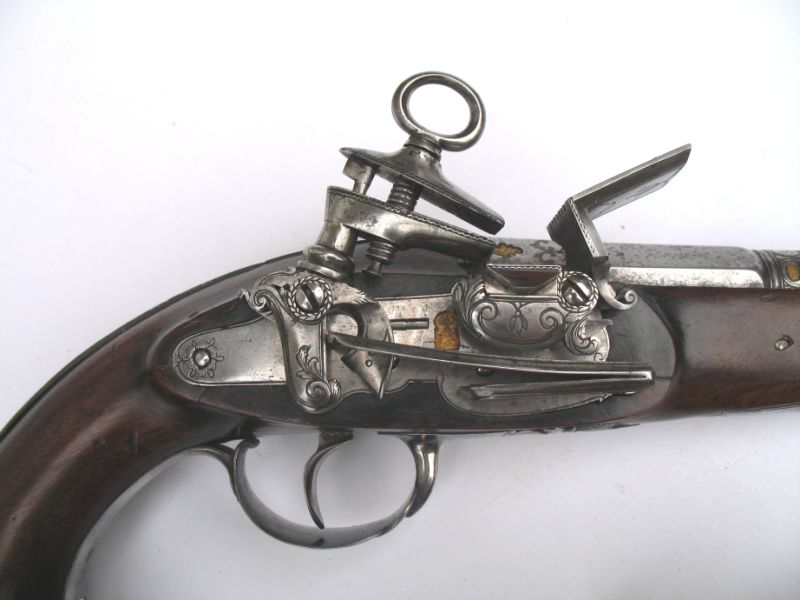

Just to add some context, here is a mature example of a miquelet lock (in this case from the Eibar region of Spain, ca. 1800-1810, to compare with the early example in the preceding post.
Note that the "bridge" connecting the cock pivot and the pan is absent, and the cock jaws no longer have the triangular "duck foot" shape seen on earlier wheellocks. In contrast, Eastern locks remained extremely conservative, and although some are quite lavishly decorated, little or no effort seems to have been made to improve their mechanical design, or build quality, to keep up with Western versions of essentially the same style of lock.

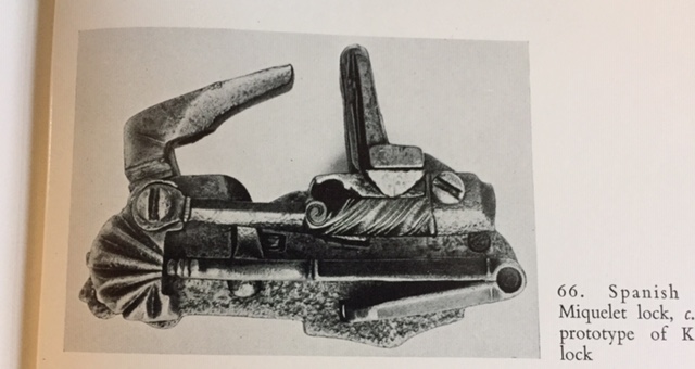

You have an impressive collection of these things! Thanks for linking me to the other thread, I have already posted a dissenting opinion with pics in regards to comments made by someone else.
I am looking thoroughly at the images you posted on that thread, and for the sake of addressing your questions directly, am bringing up some points on this thread, so perhaps readers will get an added perspective on the general topic.
I believe that your lock is European but very early, a transitional model of perhaps the mid 17th cent. I attach a photo from W Keith Neal's classic Spanish Guns and Pistols of a very rare early Spanish miquelet, he assigns a 1640 date to it. You will find some parallels to yours with the profuse and well-executed filework on the parts (Mr Neal's example has deco in the style of the gunsmiths of Ripoll, Cataluña). AND of course the characteristic "bridge" that was to become normal on Eastern miqs but soon vanished from Europe. However, your lock, with the graceful "swan neck" curve to the cock's neck, is more Italian in flavor, I see it repeated on other early transitional snap locks from north Italy, and it's quite common on the later "Roman" style miquelet common in central Italy. Ripoll gunsmiths preferred a short, straight, column-shaped neck on the cock.
Further, the buttstock of your gun shows distinct Brescian style. But please see your other thread for my discussion of this, so readers will not get confused.
There is no question about the barrels, they are of Ottoman or Balkan make but the tulip muzzle is a stylistic imitation of something that originated outside of Italy. So far, I've only been able to pinpoint England as its origin and area of popularity (and this, for a short period of time only based on surviving examples).
