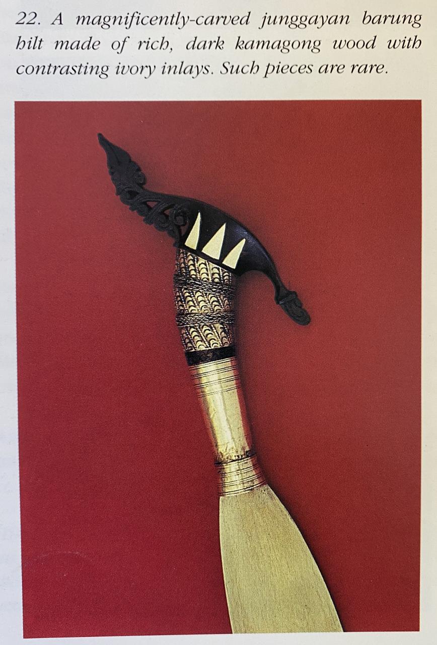

Posts: 534
With a minimum amount of due diligence, I found this from p. 38 of Cato's Moro Swords. Interesting in that in this version the crescents go in, and the dots were punched from the other side and protrude out. Now we all know that Cato was not infallible in his opinions but let us assume that this example has age and represents a pattern with at least a little bit of history. All 3 have very similar ferules and sleeves. One has a junggayan pommel, and another seems to indicate that it at one time had type of pommel. BUT the original post items to me do not seem to indicate silver though the incomplete example's sleeve does have a rosy undertone which have made me wonder what alloy it is. I can't tell if the brass I smell is from the bands towards the pommel or from the whole ensemble. Are these dresses 1890, 1920, post WWII, or after 1970? What culture or ethnic group made this pattern of decoration. Both of the blades from the original post seem to have decent lamination. I will continue to look for more examples and information.

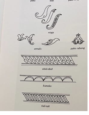

Posts: 1,036
I believe it’s kianoko - fingernail impression.
You’ll see these repeated on Baka-baka’s and asang-asang’s
I’ve seen it on early 19th century Kris’
Thank you. So this is a style dating at least to the early 1800s. Is this date for the horizontal bands as in the diagram or the diagonal elements as in the three examples shown earlier, or both? Do you think it is called fingernail impression because of its shape or its method of manufacture? On baka-baka it would surely need to be a punch. Once I got looking and thinking I now see this basic shape as a ubiquitous element in Moro design being utilized in many different patterns. I appreciate you posting the diagram with the vocabulary.

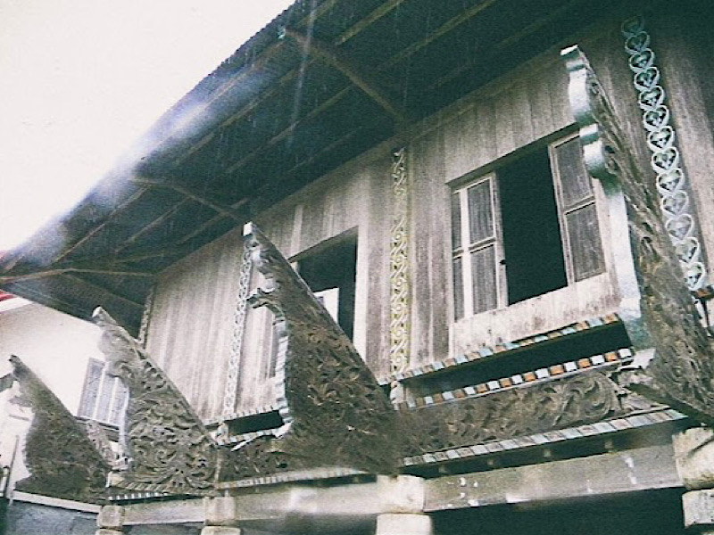

Kianoko also appears on architectual elements of a Maranao Torogan (a Datu’s large house).
I don’t know if the horizontal predates the diagonal.
I leaning towards the shape of it being called kianoko, not the method.
