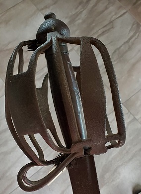

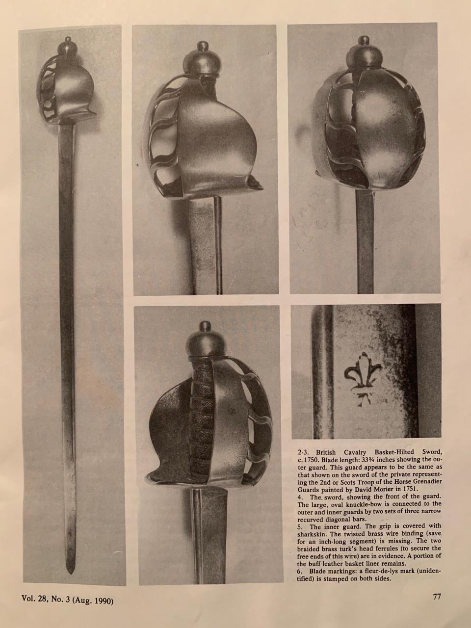

Default Pommel Ring on British Dragoon Swords 18th c.
With the dragoon swords that evolved for British cavalry from the basket hilt forms of Scotland in the first part of the 18th century, it seems that the guard shields were welded to a ring, which then mounted UNDER the pommel in many cases.

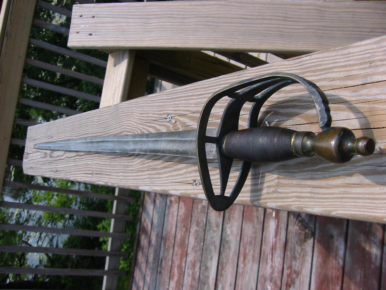

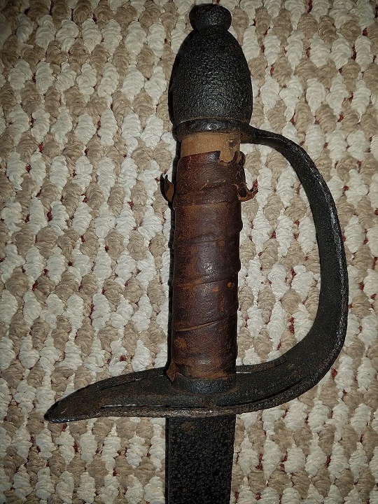

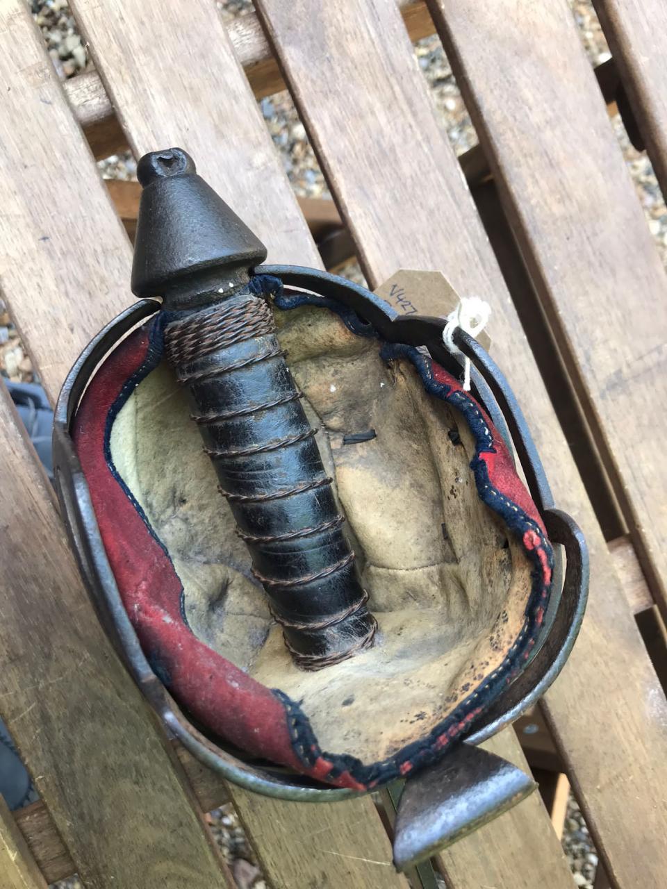

I have a stirrup hilt 'four slot' sword which has this ring guard type setup (I posted it about two years ago) but did not resolve more on this topic.
What I am wondering is when did this means of securing the guard end? and go to the knuckleguard or guard assembly going into the side of the pommel begin?
It seems by 1759 these type swords were being made by Jeffries in London, with the pommel side mount (apparently number of these were made in 1759 for 21st Light Dragoons, who disbanded in 1763).
These were apparently produced in 1756 as a 'test pattern'? for light dragoon regiments being proposed, and I believe first issued to the 15th Light Dragoons.
As this has the pommel ring fixture, I am wondering if possibly this one might have been of these early prototypes (loosely termed pattern 1756)?

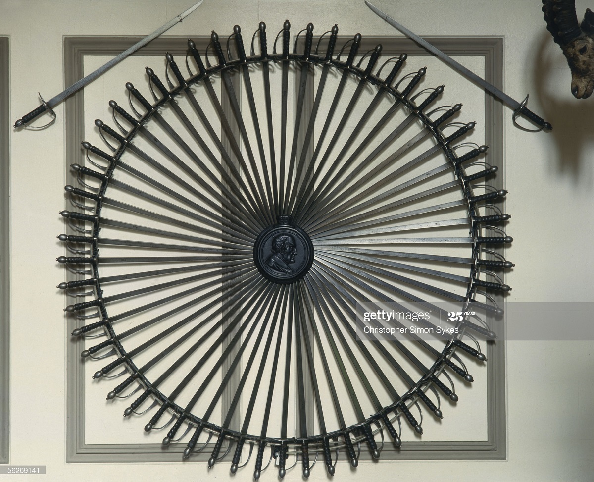

In Belvoir Castle, the swords of the 21st Light Dragoons are displayed in a circular panoply, and are of the form described of the 1759 with the pommel side mount. (thanks to Bryce for the photo).
In 1778, the American swordsmith POTTER made cavalry swords designed after these British light dragoon types, and notably included the pommel ring method.
As always, Bryce, Radboud, Will, Glen, I would really appreciate insights.

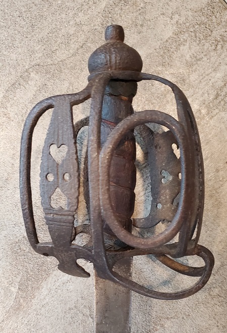

An interesting sword, are you sure that the unique pommel ring isn't unique to the American-made example?
It might be me, but I don't see it represented in any of the other photos you post. It looks like on those, the guard terminates in the pommel.
Possibly an American variation? I'll see if I can dig up similar examples in my copy of George C Neumanns' book.

These pre 1788p swords become less likely to have a fixed beginning or end date for use of the ring for the guard.

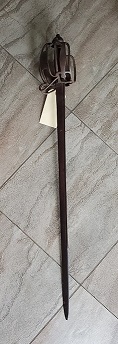

I have a British 17760's to 1770's cavalry sword with the ring to secure the guard.

No, the American (Potter) in 1778 was unusual in copying the earlier British form. These rings were on many British basket hilt types shown in Mazansky, Darling, Neumann et al. up to about mid 1750s it would seem. That was why I was showing these other examples 1759+ as they no longer had the ring.
I got this sword in London about 1978.

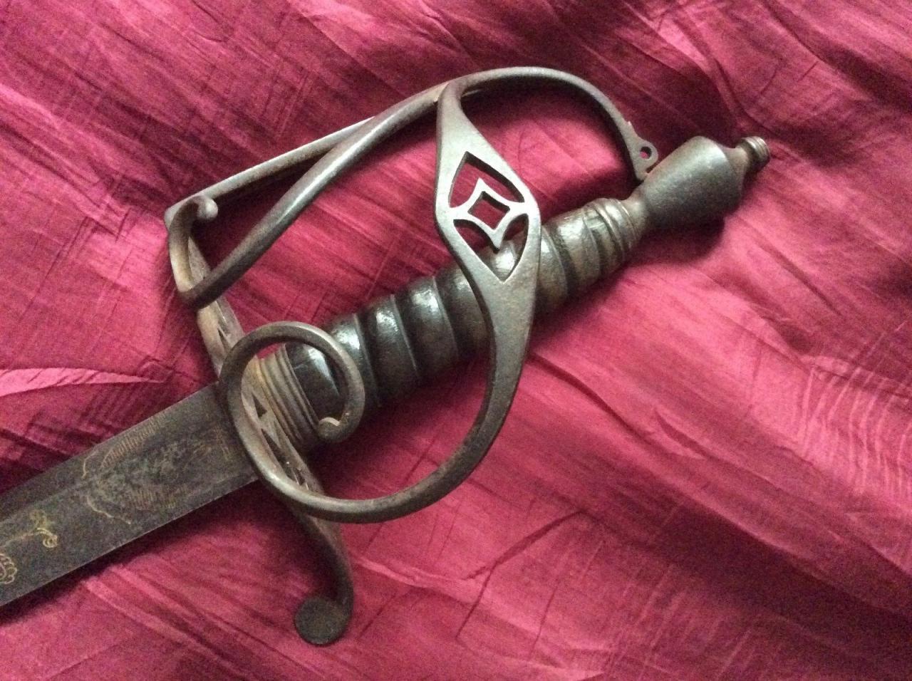

Interesting, thank you for the share. It looks like a transitional design from the ‘screw in the pommel’ to the later, simpler join of the slot-hilts you show.
I hadn’t noticed it before, so went back to my catalogue of basket hilt photos and you can almost see the transition of the earlier ribbon hilts to these ring joins and later ones that follow.

I think that is a pretty likely possibility, and while I am far from being a metal fabricator, it seems logical that rather than the individual placement of guard components into a slot in the pommel...joining the entire assembly with a ring and placing it under the pommel would be an easier bet.
I'm not sure offhand when the ring method began, but these are seen on many of the 'garrison' town versions of basket hilts for British dragoons of first half 18th c. They are clearly seen in Nuemann, Darling, Mazansky et al .
"..in 1755, in common with the three regiments of dragoon guards and four other regiments of dragoons, it was augmented by a seventh, or 'light' troop".
-""The Princes Dolls", John Mollo, 1997,p.8
This reference concerns the 10th Light Dragoons (later hussars) which were the regiment belonging to the Prince of Wales (later George IV).
The author goes on to explain that the 'light troop' was disbanded after return from Seven Years War, and that in 1759, the first entire regiment of Light Dragoons was raised, the 15th, followed by 16th and 17th, and 1783 the 10th.
It would seem that this attraction to the potential of these light cavalry units came from primarily French influences, though German military influence overall was certainly well known. Infantry sword patterns that developed in first half 18th were of German form.
The French 'light' cavalry were a fashionable and effective force, which seems in turn to have developed from their interest in Hungarian cavalry units, some of which were actually factored into the French army.
Further interest in the 'exotica' of these influences may have been the fascination with the 'pandour' phenomenon, which was a key element in the Austrian forces, made up of Hungarian and Croatian cavalry.
One of the features on my sword posted in OP is the 'clipped point' of the blade. This particular feature is of unusual character for British swords, but was known in Europe as the 'pandour point' (Seifert, "Schwert Degen Sabel",1962).
It would seem that the interest in the 'light dragoon' concept, as noted of 1755, would perhaps bring about the notion of a lighter sword resembling the sabers of these European units. Keeping to the existing style of the basket hilt dragoon swords, but keeping the 'ring' and adapting the straight backsword blade using the 'pandour point' , seems a logical 'styling' move for the swords of these new units.
As noted previously, there seems to be some notation of this type sword as a 'pattern' or model of 1756, but this of course is not widely recognized.
We do know however, that in 1759, the swords apparently supplied to these 'light dragoon' units, at least for certain to the 21st, were by Jeffries of London largely, and of this same 'four slot' guard form.
These no longer use the 'pommel ring' method and a side entry mount for knuckleguard is used.
This is basically why I am suggesting this example of four slot sword is quite possibly a prototype form for the first units of light dragoons, and from 1755-56 reflecting the influence of the European light cavalry as noted.

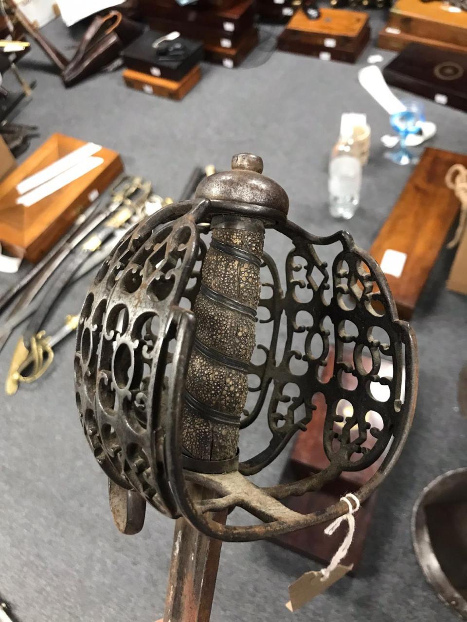

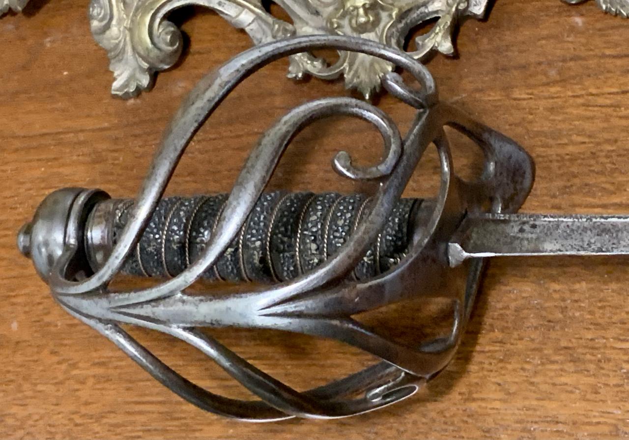

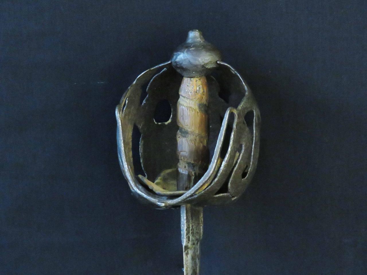

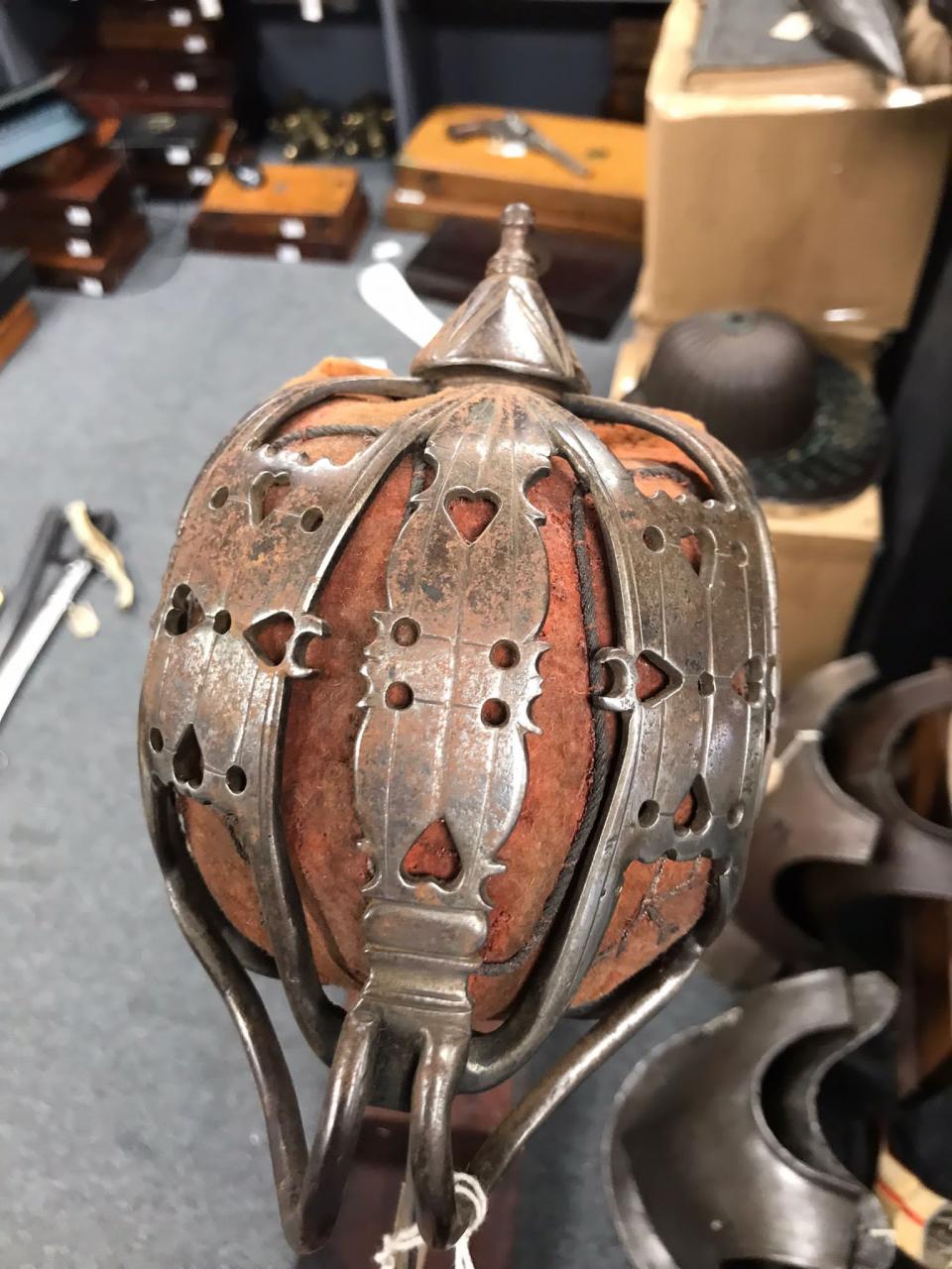

To add to hilts already shown with the pommel ring, this is a Glasgow hilt, often associated in references to Royal Scots Greys (Royal North British Dragoons pre.1713). The notable feature in the guard structure termed the 'horsemans ring' has been pretty much resolved to have been for holding reins while discharging firearms while still holding sword.
It was long thought this feature was after 1750, however it is now known to have been used in British dragoon hilts much earlier, possibly the early years of the century.
The pommel ring is seen at top of the guard assembly to rest just below pommel, and in the manner I am noting in the light dragoon sword c.1756 (?).
There are numbers of other British dragoon basket hilts with varying guard structures , but all using this pommel ring.
It is of course possible, perhaps likely, that a number of hilt makers of 'old school' still held to this manner of construction, but largely this seems a convention that was popular in British dragoon swords first half 18th c.

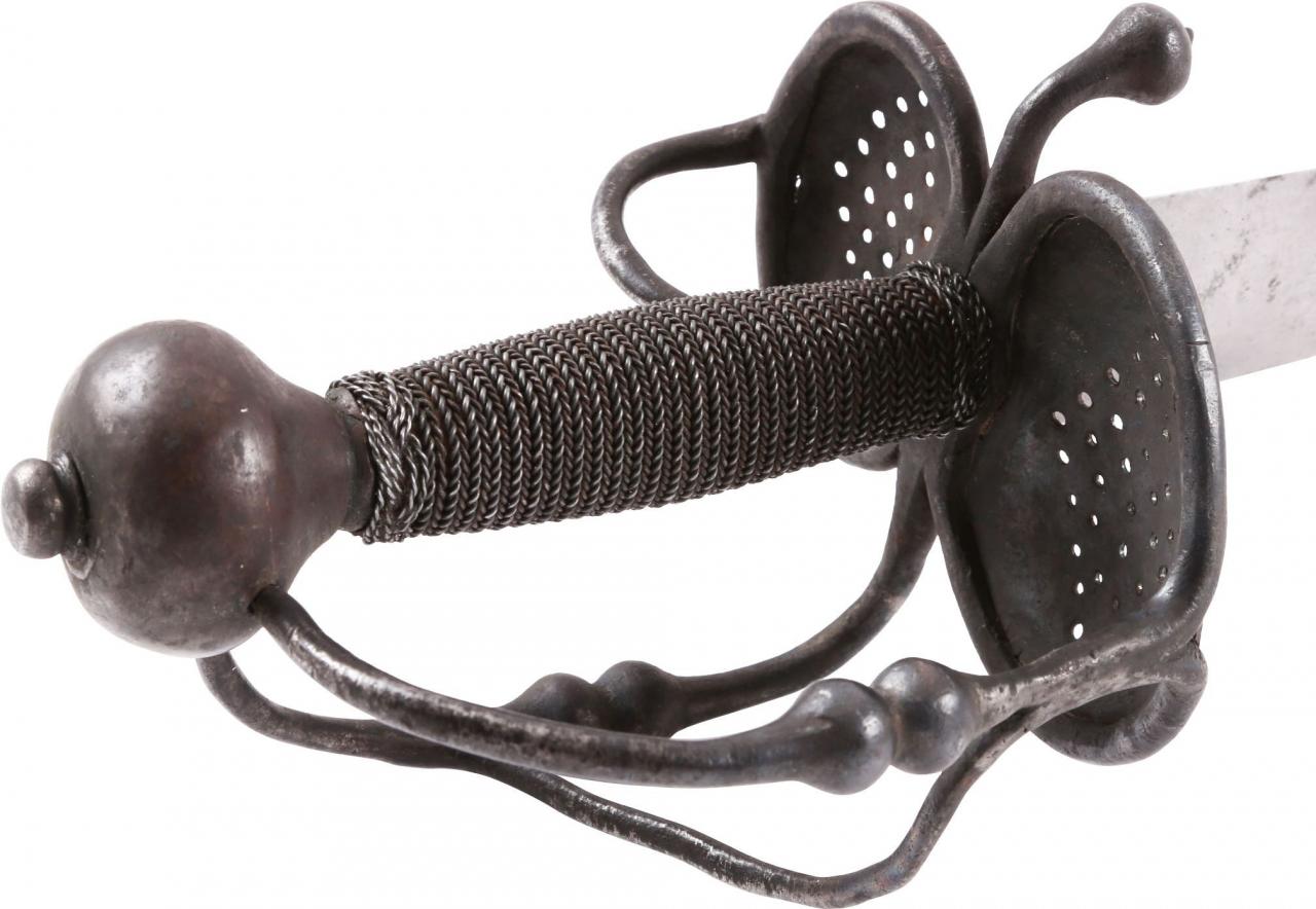

If we look at the English 1788 as the 'beginning' of a pierced pommel, in the sense of a four slot hilt, then the AR would be the end of the ring.
Yet, we can go back more than a century to find compound hilts piercing pommels along with screws instead at the same time.
I would believe that the ring assembly adds significant strength in a blow and how a backstrap was also a means to an end. Curious then that the 1788 heavy was inherently weaker

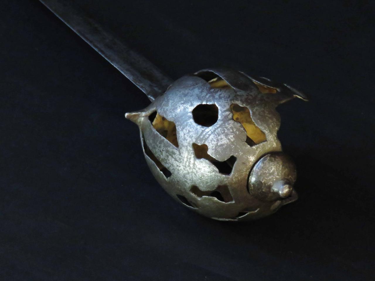

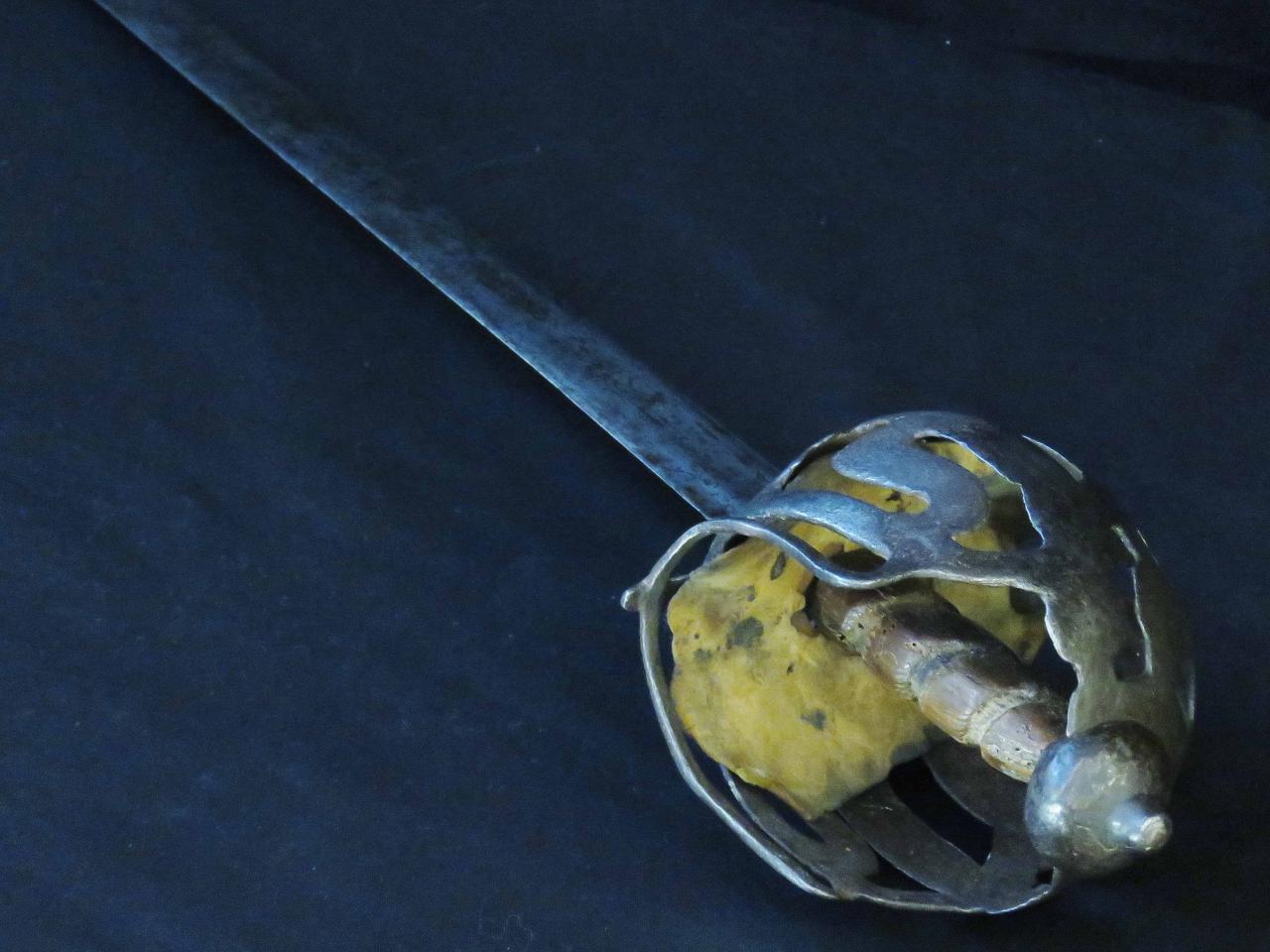

The 1798 Pattern Highland Regiment officers' swords are interesting because the ring pommel appears to be used regularly as part of that pattern. Probably not exactly what you're after, but it shows that the design continued to be used on basket hilts after it disappeared from other swords.
Looking at the examples, it wouldn't be a stretch to say that the form is a hangover from basket-hilted swords, which remained as the cavalry officers' hilt form changed in the mid-18th century and finally fell out of use with the advent of pattern swords with a solid backstrap in 1796.
Of course, with all things of the period, there will be exceptions, but the popularity of a solid backstrap likely was the end of the 'pommel ring' for cavalry officers' swords.

I think what we see here is the transitory situation, and all great examples of that.
The one from Wilkinson-Latham (45) is indeed identified as c.1780 dragoon officers sword and appears in Blair as noted. I recall getting this around '78, and it had a brass hilt. I was surprised in seeing other examples being steel rather than brass. There never seemed to be a consensus on what these were...in a rather bizarre note Stone (1934) has one of these among several other swords and listed as Italian! ?
I no longer have it, wish I still did.

I found this picture in Canadian Journal of Arms Collecting but not the RA sword I gave the link to though I should come across it.
Old 13th December 2022, 04:02 AM   #26
Posts: 10,862
Thank you Will, this publication was one of my favorites, and Jim Gooding, the publisher, was a great guy. Sadly after he was gone, it ended. The issues are virtually treasure.
This is an excellent example, and again the 'pommel ring' clearly seen.
Interesting is the typical straight blade with this single back fuller typical of the period and it seems turned up on most forms of hangers, cutlasses and of course these basket hilts.
The fluer de lis is seen on many blades of this type (as found on some of the blades from the terrible Twickenham fence with Culloden blades) and from late 1730s-40s.
This is my example of a dragoon of that period, with fluer de lis, but in this case the guard attached in the 'Scottish' manner rather than pommel ring, which of course shows that one method was not exclusive to these sword variations.

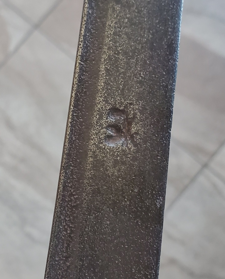

As an aside, if anybody is interested in the Flour de Lys stamp on the blade Will posted No 25 and the one Jim posted No 26 this discussion may be of interest.
http://vikingsword.com/vb/showthread...ighlight=fleur
